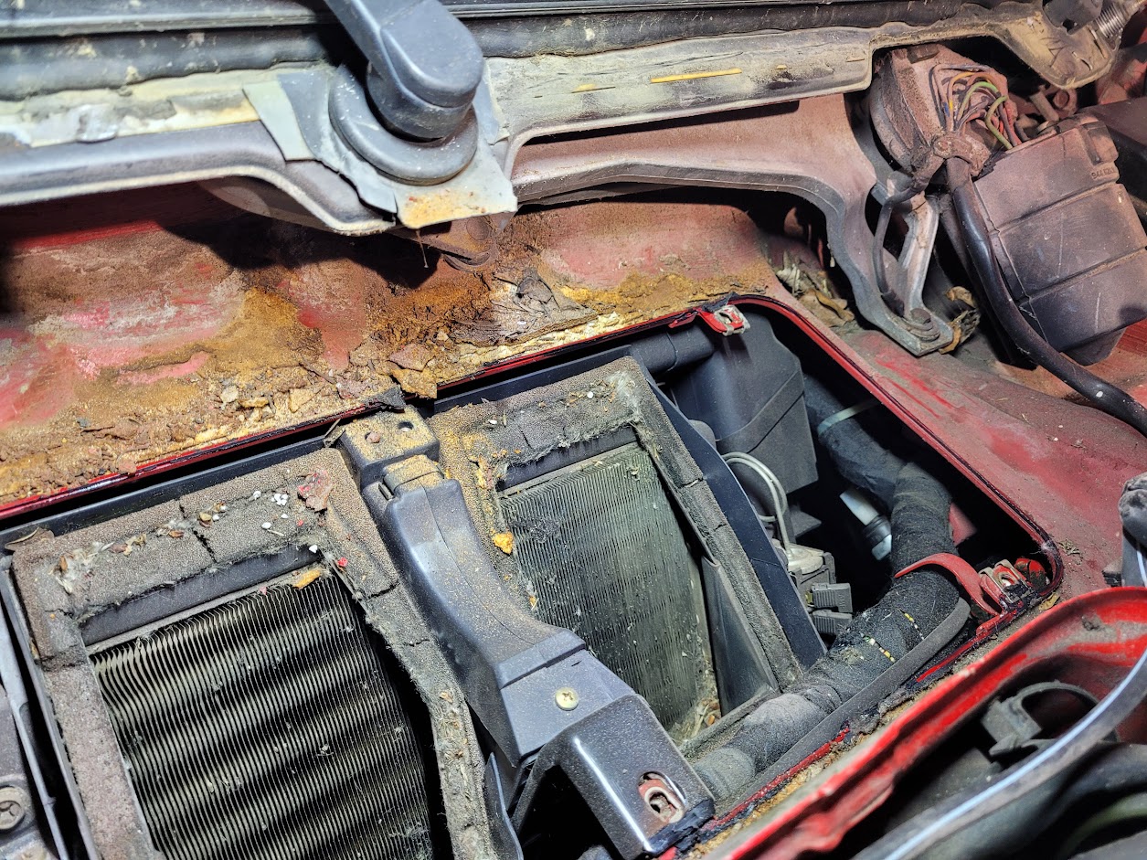

Thanks guys, I got that stuff from Amazon. So anyway, here's why I wanted to pull the blower motor assembly:
Looks like the car is falling apart with rust, right? That's what I thought too. But then...
Tada! Gone. Years ago I had a really badly rusted battery tray and I had to get some serious repair work done there. The guy did some kind of media blasting. I'm not sure what he used, but it looks like a lot of it accumulated behind the blower and eventually turned into that rust colour. But it also hardened into these solid chunks that perfectly mimic a rusty body. A couple of minutes of gentle scraping and vacuuming and it's as clean as a whistle.

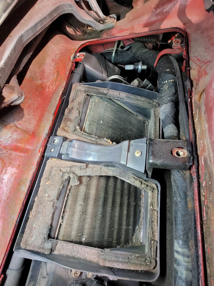

Next question: any suggestions for what to use to replace the foam around the evaporator? It looks similar to the stuff used to seal the intercooler. Years ago I replaced that stuff with foam tape, but it would be tricker to do a clean job on this with the same tape. If anyone has done this before, I'd love to know what you used!
