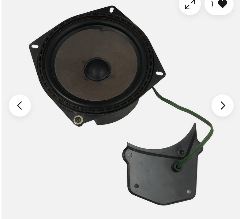

I think this is the stock round rear speaker and adapter. Is that small plastic piece on the bottom all that's needed to get any 6.5" speaker to fit? I saw this on ebay in the EU. From what I can gather, there is a L and a R side adapter plate. But, you're right that it wouldn't be too hard to fabricate your own, but the real piece is nice too.
Is this what you bought from Germany?

Yep it's just two small pieces of metal like in your photo and both sides are different.chrischrischris wrote: Wed Jun 17, 2026 7:29 am I think this is the stock round rear speaker and adapter. Is that small plastic piece on the bottom all that's needed to get any 6.5" speaker to fit? I saw this on ebay in the EU. From what I can gather, there is a L and a R side adapter plate. But, you're right that it wouldn't be too hard to fabricate your own, but the real piece is nice too.
