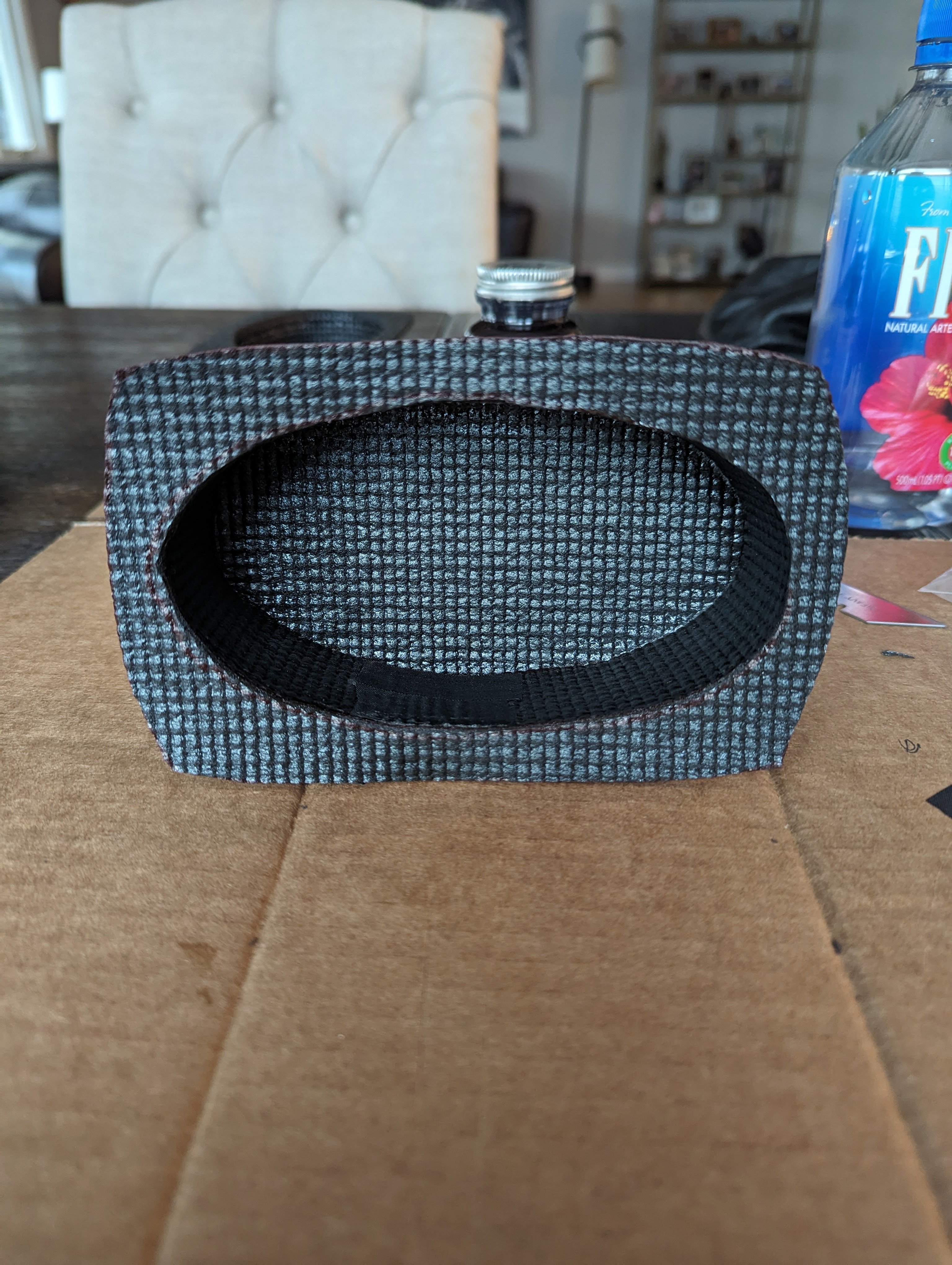

4x6 in the front, although they can't be super deep unless you want to shim them out.

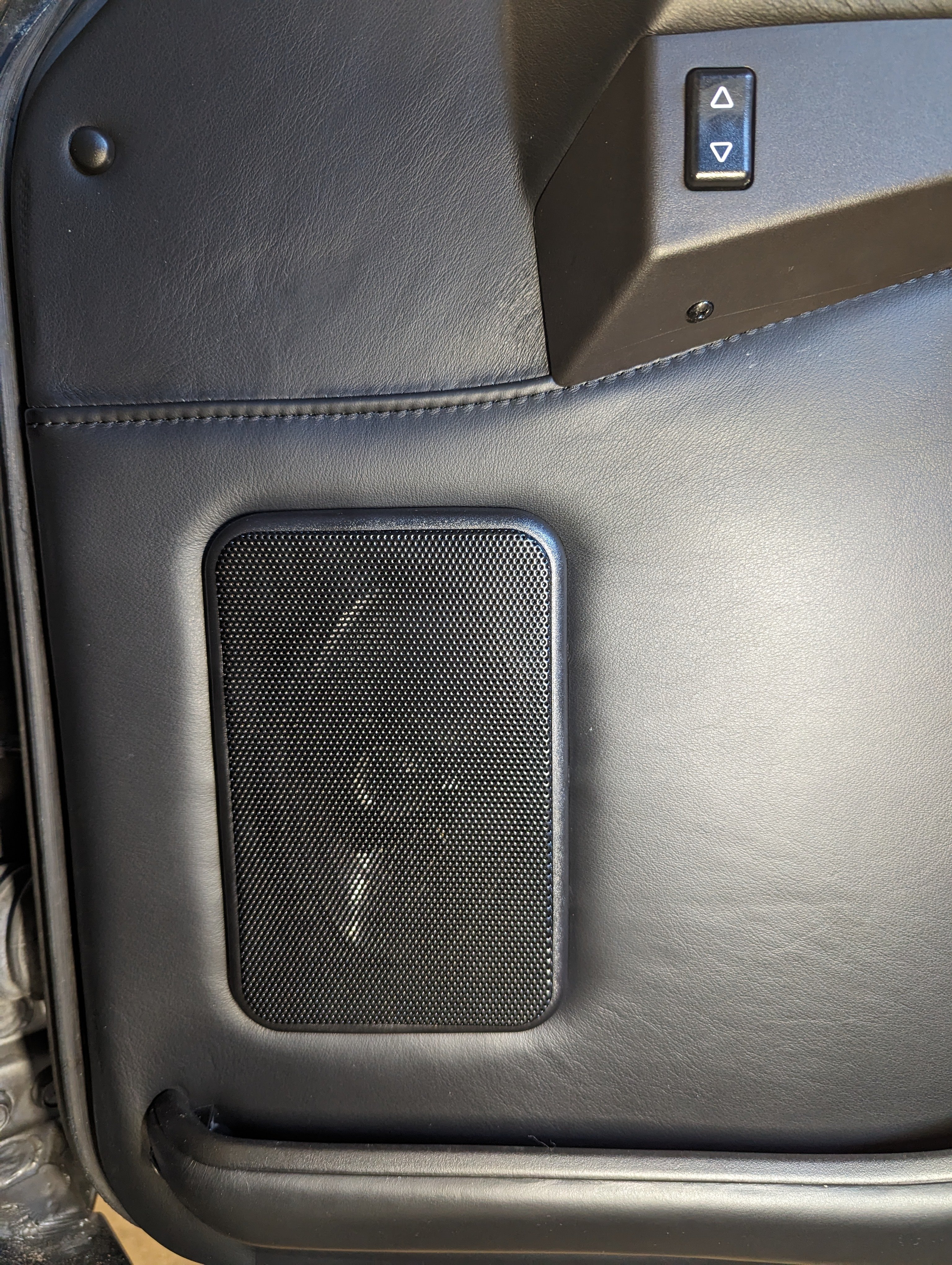

Low and behold, I happen to have a spare set of both! I have a pair of infinity reference 4x6 speakers and the Porsche 6.5 inch rear adapter plates. I would be happy to sell both to you at a loss. I had to order the plates from Germany and I ended up just 3d printing the plates out of impatience. I also ordered two pairs of the 4x6es for front and rear before I decided to go 6.5" in the rear. So I did install one pair of the 4x6es is the front and they sound great. I posted pictures on rennlist if you want to look.

I wanted the stock look in my 944, so I fit RetroSound 4x6's in the front doors. The neodymium version fits well (it's quite shallow), but the sound is a bit meh.

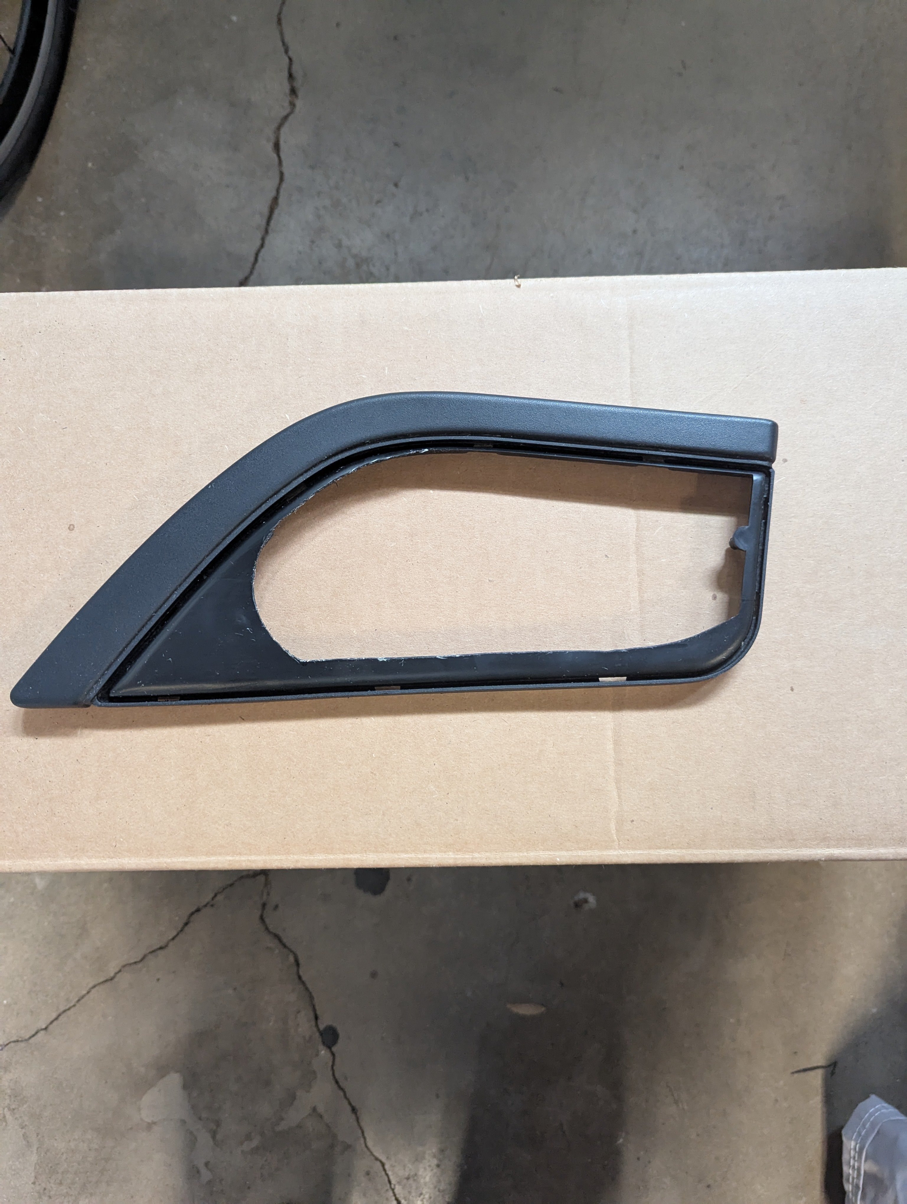

I think this is the stock round rear speaker and adapter. Is that small plastic piece on the bottom all that's needed to get any 6.5" speaker to fit? I saw this on ebay in the EU. From what I can gather, there is a L and a R side adapter plate. But, you're right that it wouldn't be too hard to fabricate your own, but the real piece is nice too.

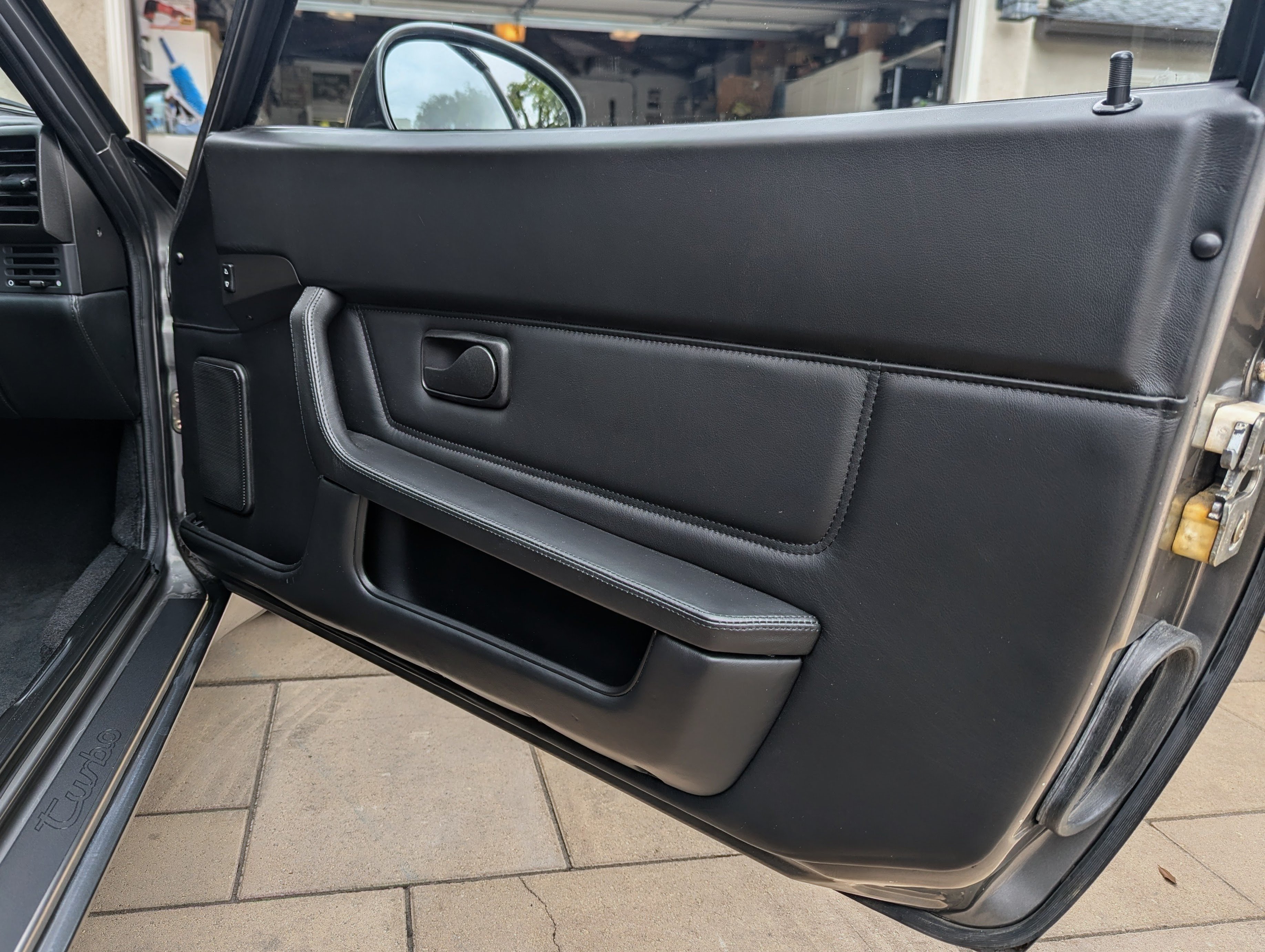

Regarding the front speakers, I struggled with many that didn't fit nicely so I just ordered directly from Porsche dealership. They sound fine and fit perfectly.

Yep it's just two small pieces of metal like in your photo and both sides are different.chrischrischris wrote: Wed Jun 17, 2026 7:29 am I think this is the stock round rear speaker and adapter. Is that small plastic piece on the bottom all that's needed to get any 6.5" speaker to fit? I saw this on ebay in the EU. From what I can gather, there is a L and a R side adapter plate. But, you're right that it wouldn't be too hard to fabricate your own, but the real piece is nice too.

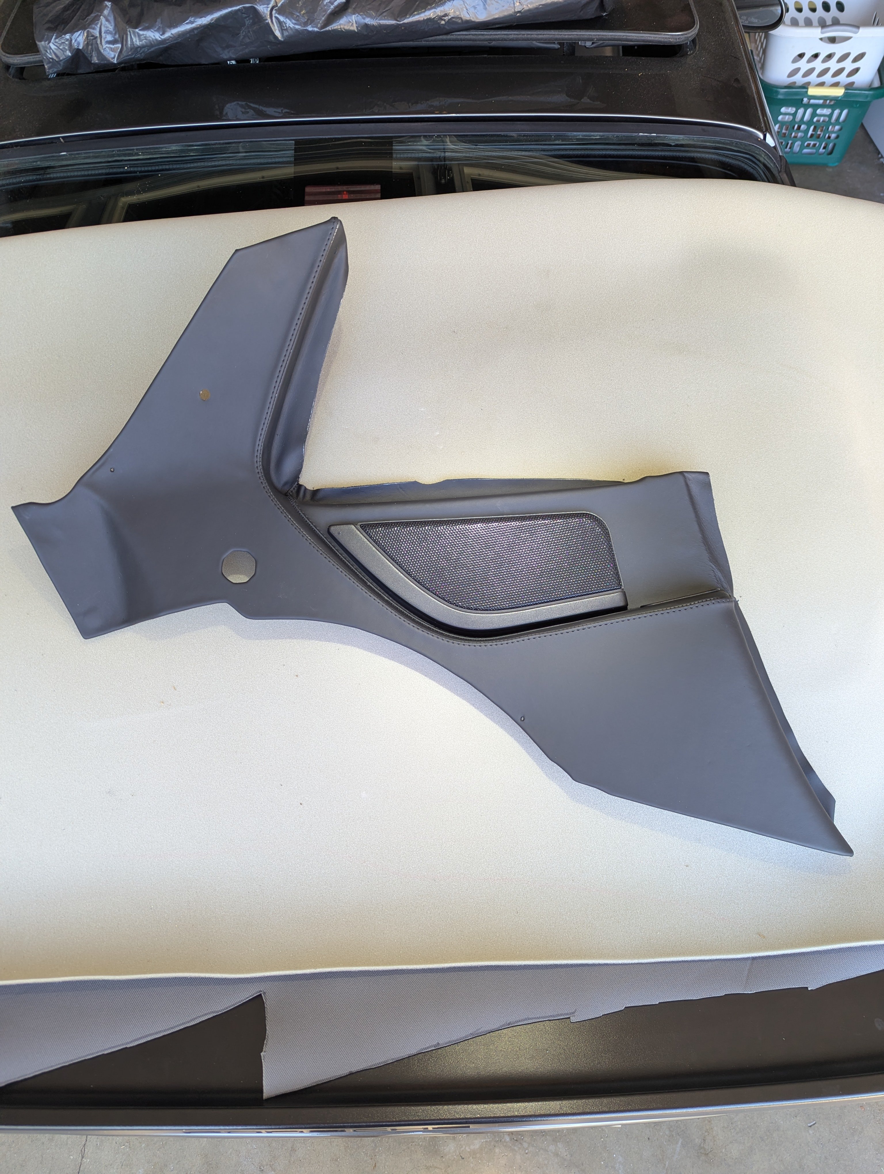

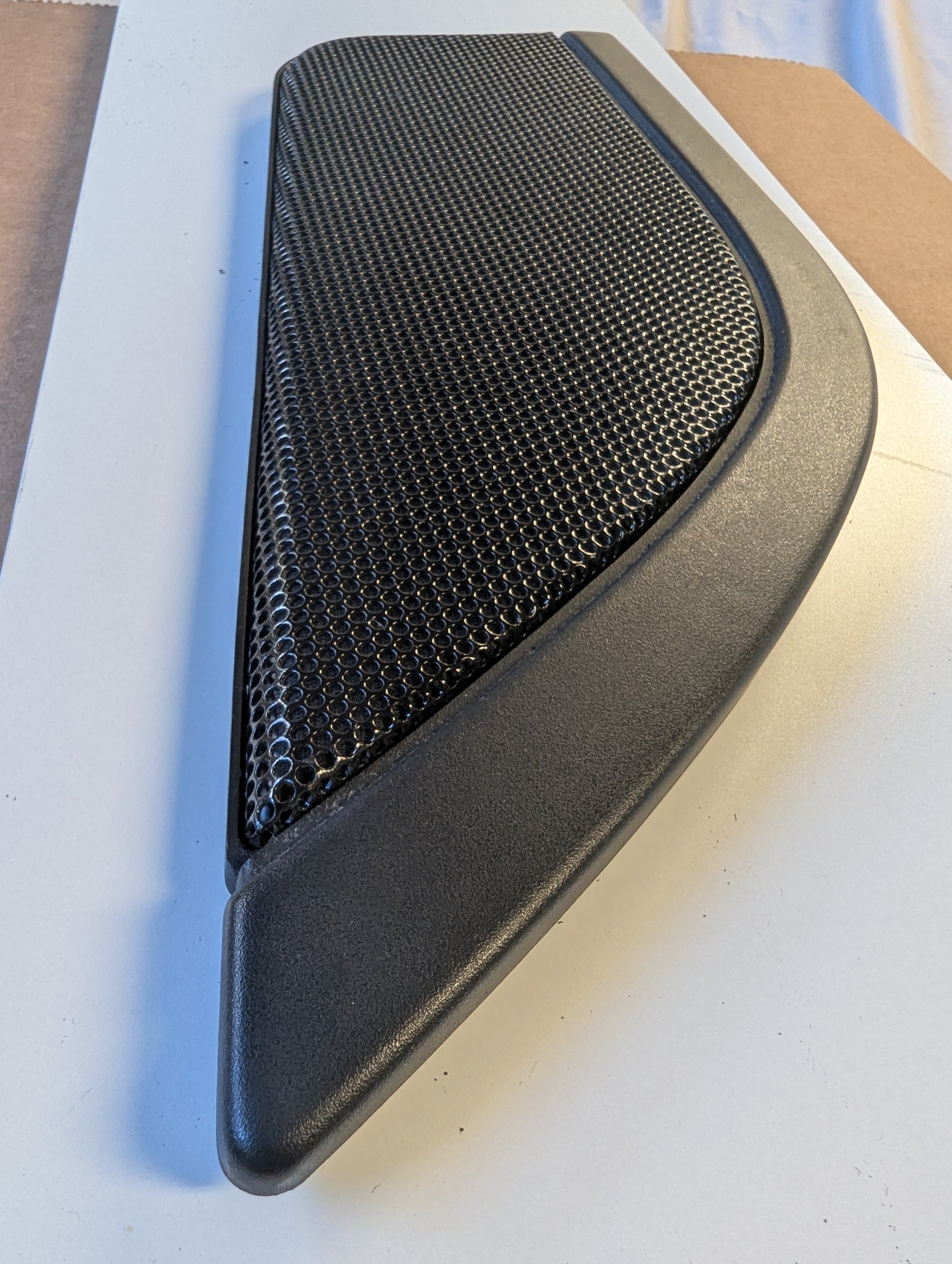

I recently redid my ten speaker system. I removed everything (left stock wiring in place) and put Focal 135AS up front and AS165 in the rear along with a Impulse 4.320 amp an Focal ISUB active. Great sound. Effectively I now have a 9 speaker system which is a greeat sound for a relatively good price.
You can gain some space for the fronts by using 993 frames and grills. Gives you more speaker options and still has an OE appearance. I even think it looks cleaner than the original covers. I also replaced the flimsy rubber water guards with some covers that I made; it definitely helped improve the sound.
For the rears, I have an 86 so I had to stick with the 4x6's. So I purchased some grills from a later model and cut out the tweeter and excess plastic, then refurbished them. That opened them up and allowed more sound to pass through.
I also added the KLA 8" speaker box in the rear passenger cubby. That really made a difference and elevated the entire system. Would highly recommend it.
