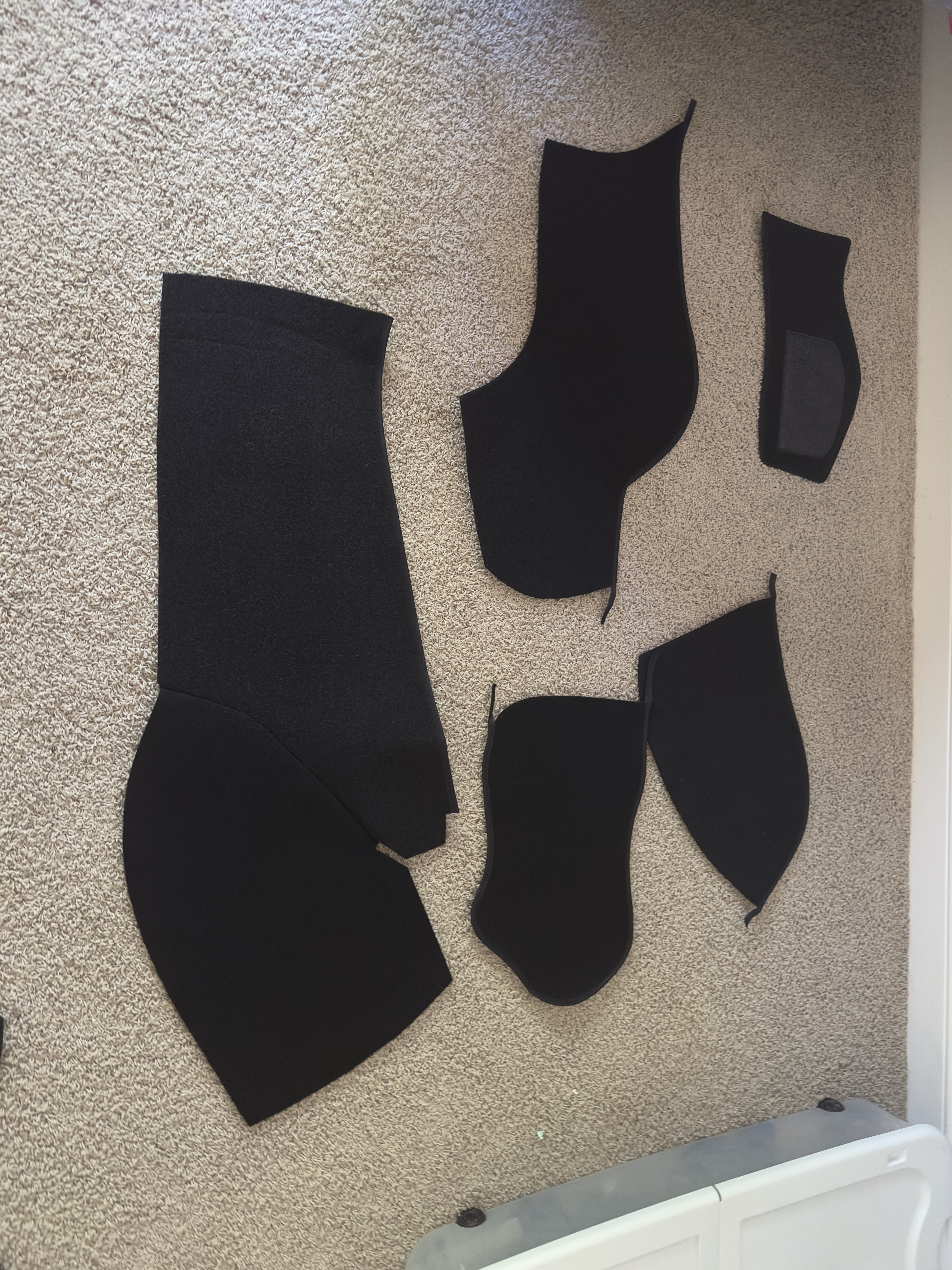

Hi Folks,
This seemed to have good reviews so I bought the kit and now installing it. The instructions from the 1st customer in 2008 are about the only reference and they leave me with a few questions - ie I can’t figure out where some of the pieces go and there are some spots where none of the available pieces fit. Bob at appbiz still makes batches of these kits, didn’t have any other guidance since it’s been 10+ years since he did any installation work on these.
I’ll post some pics later, but if anyone has any more info beyond the mh951 .pdf file I’d much appreciate it!

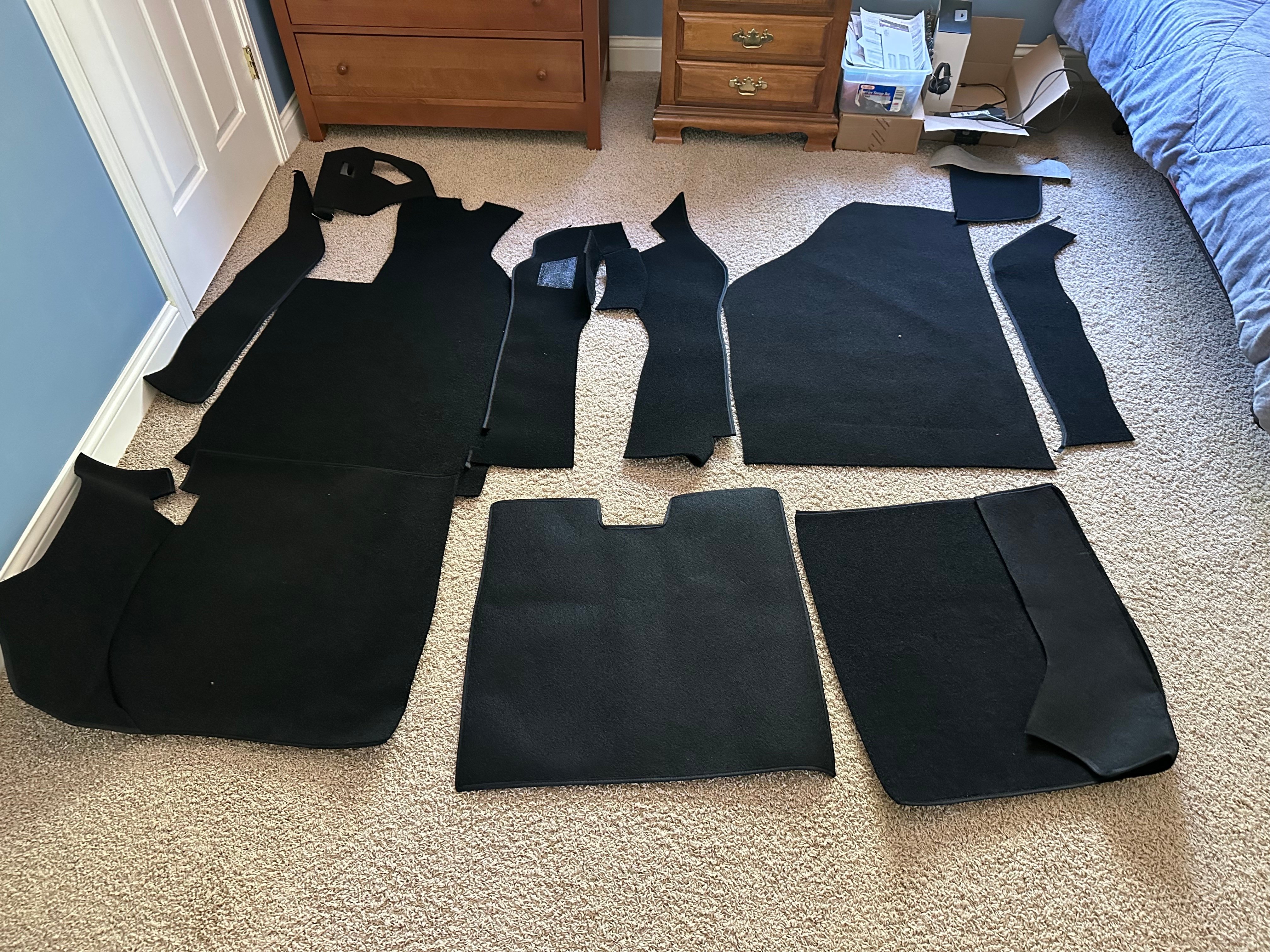

Ok - Here goes.

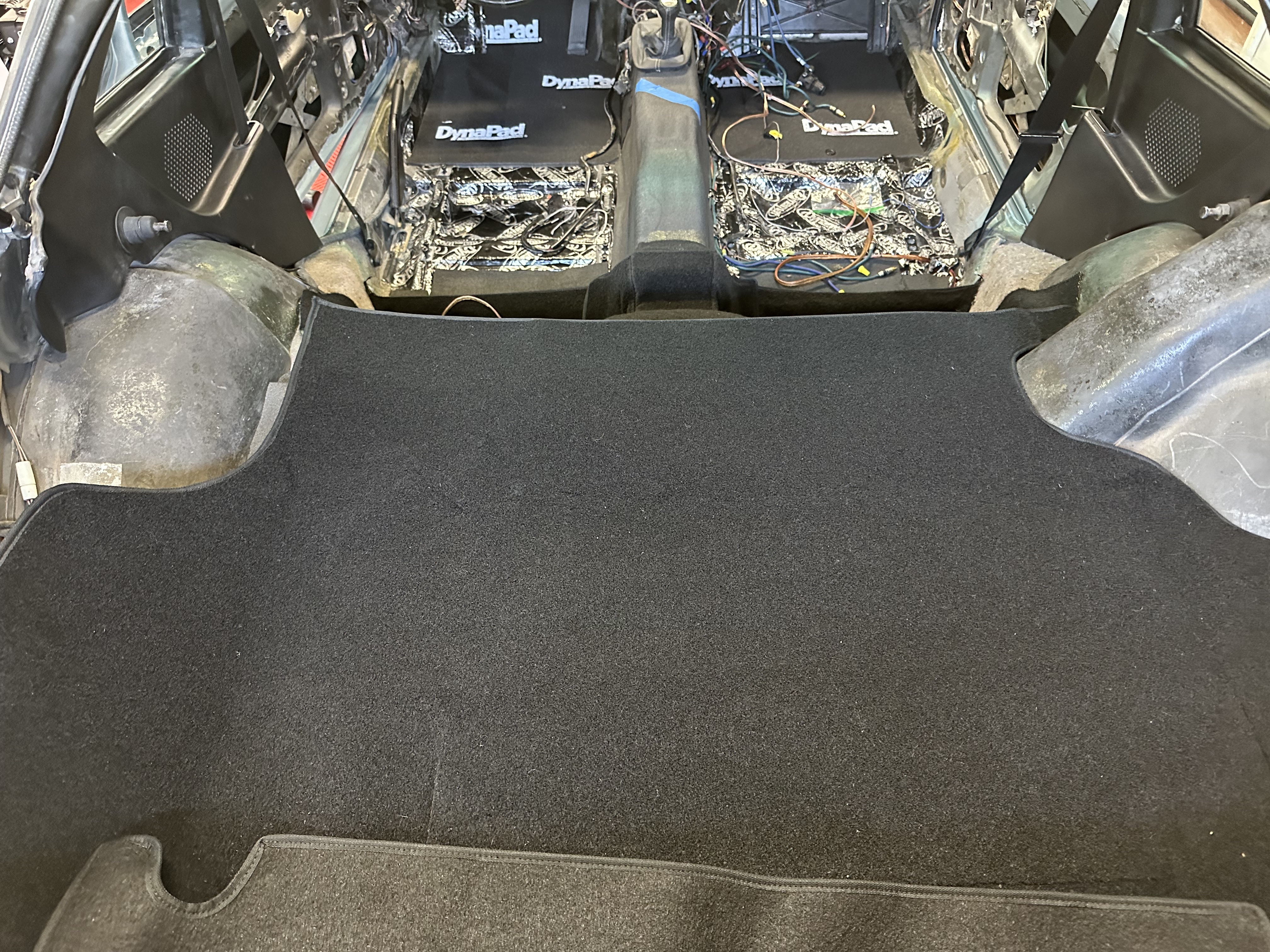

.pdf is the original instructions. I have put in pieces 1,2,3a,3b,4a,4b,5 so far. Those were obvious. 12 (which now includes 10) is also obvious.

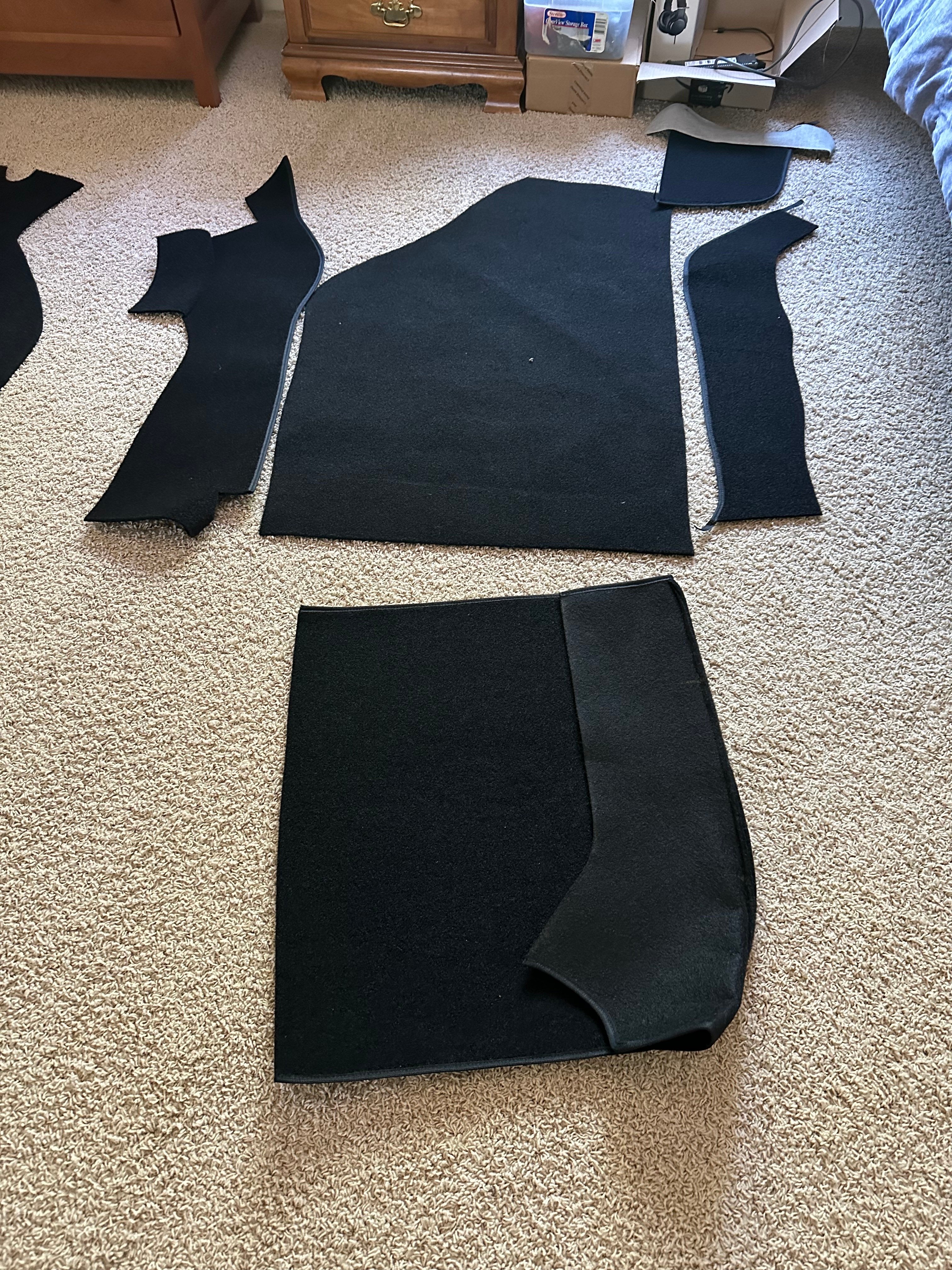

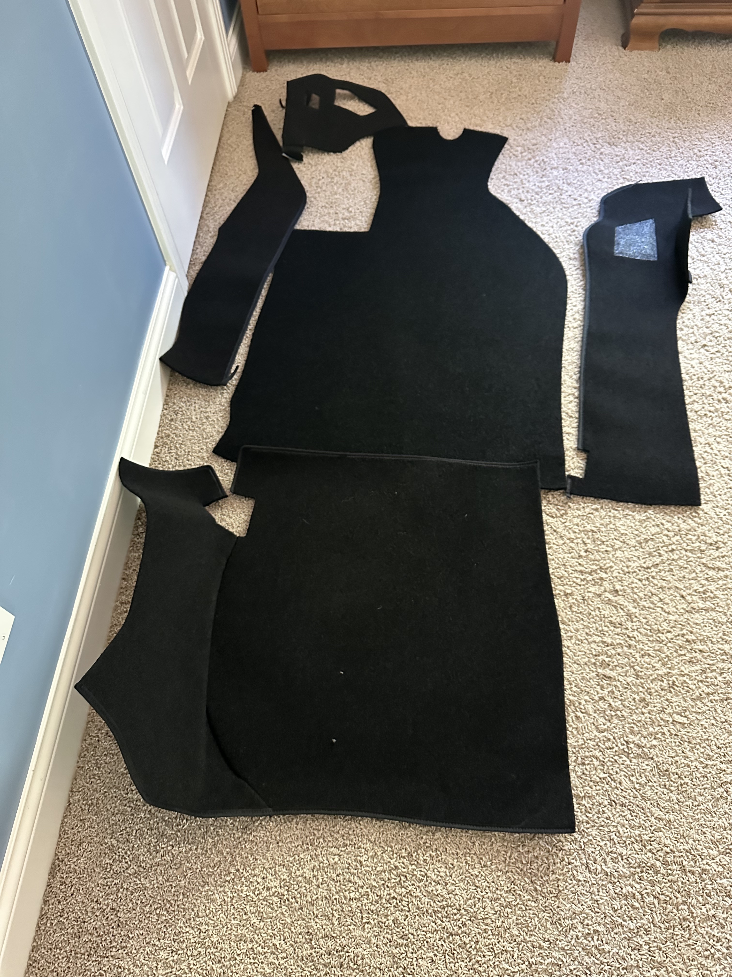

The instructions don't show all the pieces for the driver/passenger footwell areas - see pics driver + passenger. I think I have those laid out correctly. I also think I have the right piece for 9 (far left piece in pic unknown1.jpeg).

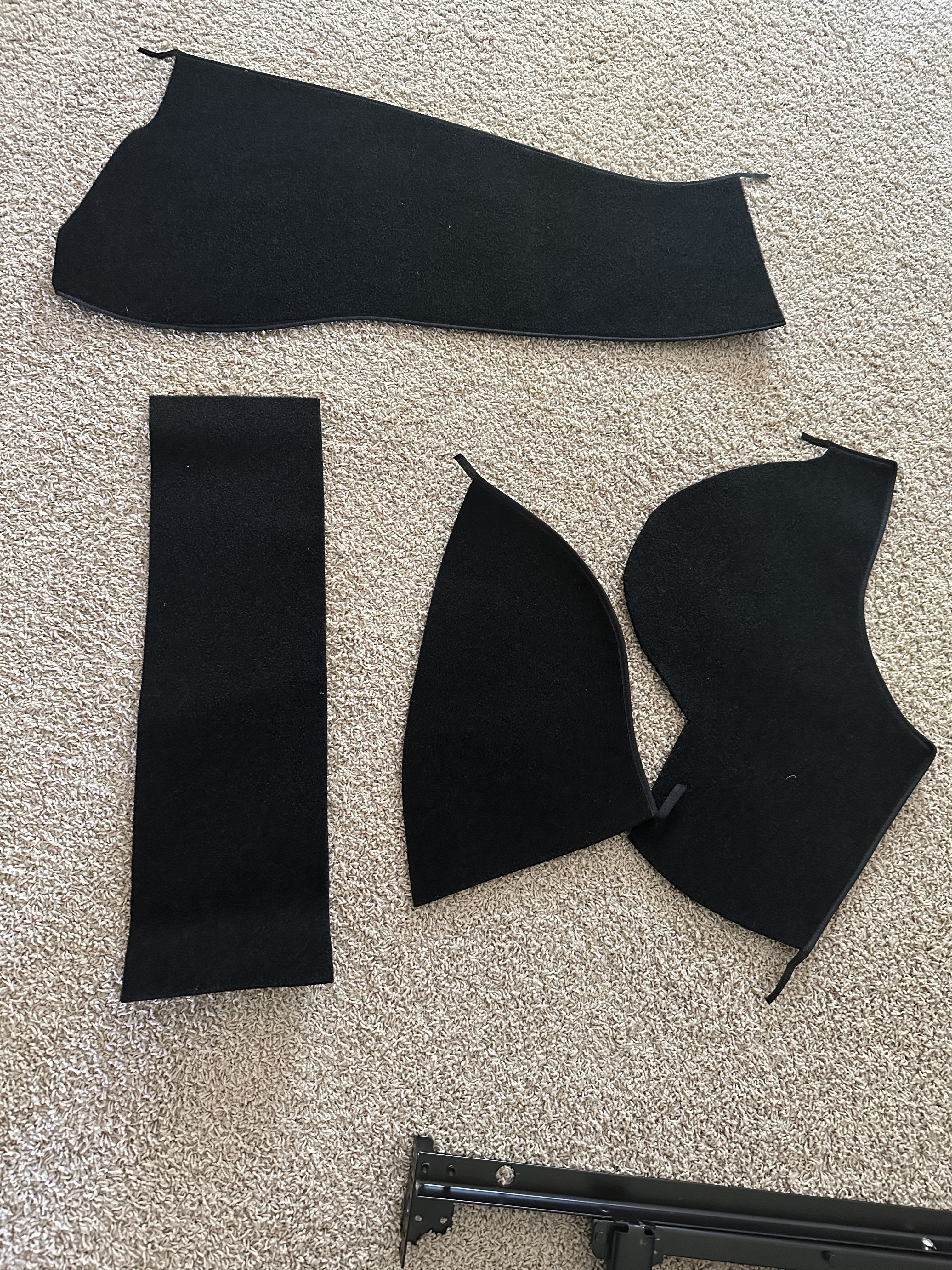

I am having issues identifying which pieces 6,7,8 and 11. See pics unknown1 and unknown2 for the pieces that might go there. Some of the pieces look like they go to 7 & 11, but they don't look quite right when I try to place them.
installed 1_2_3_4_5.jpeg (3.18 MiB) Viewed 2339 times

Yeah, those pieces don't follow the factory pattern -- as I'm sure you know... I'd think you are down to trial and error on the remaining pieces. The picture in the instructions seems incomplete? You're welcome to come look at my carpet if you think it would help....
