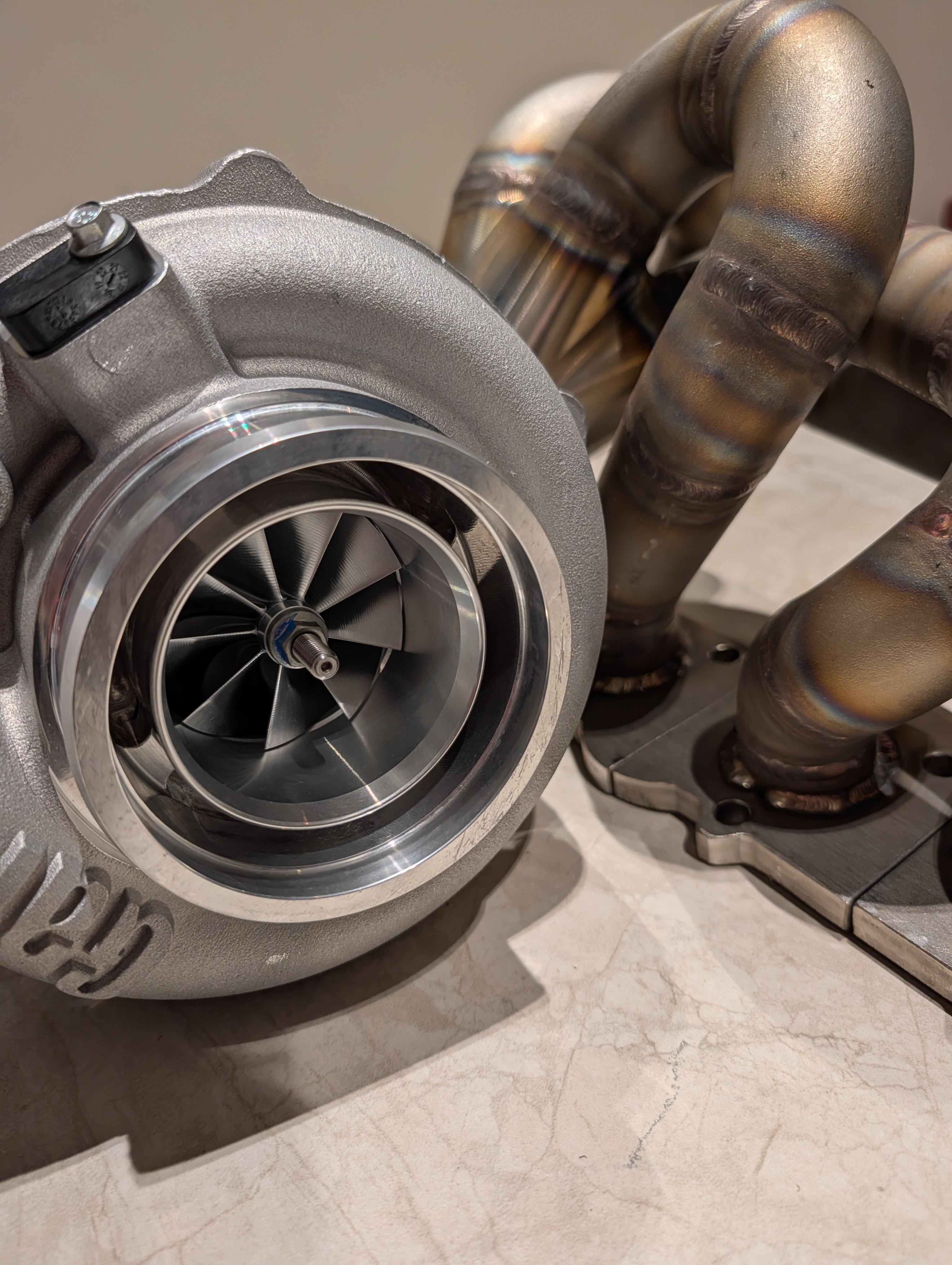

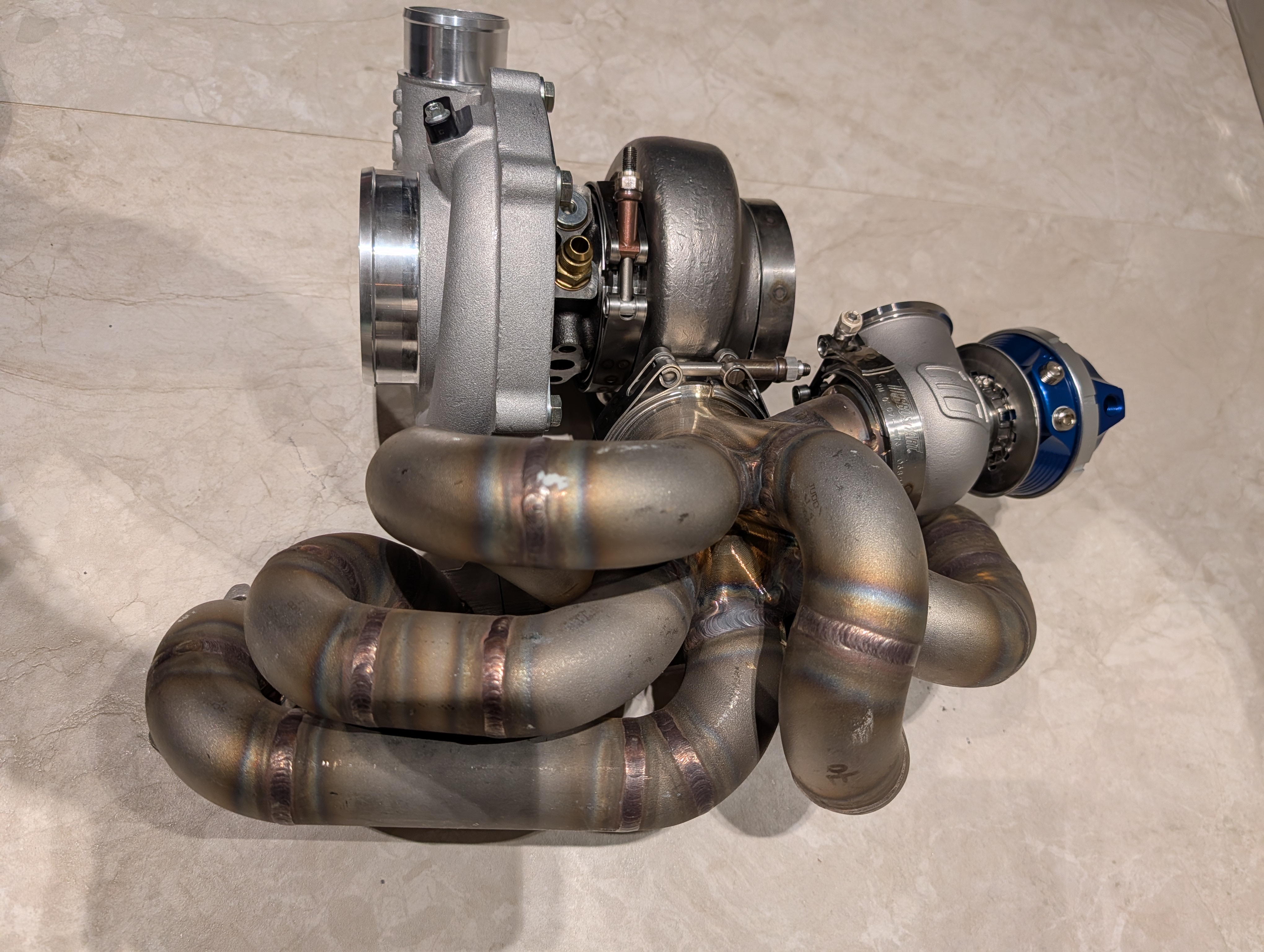

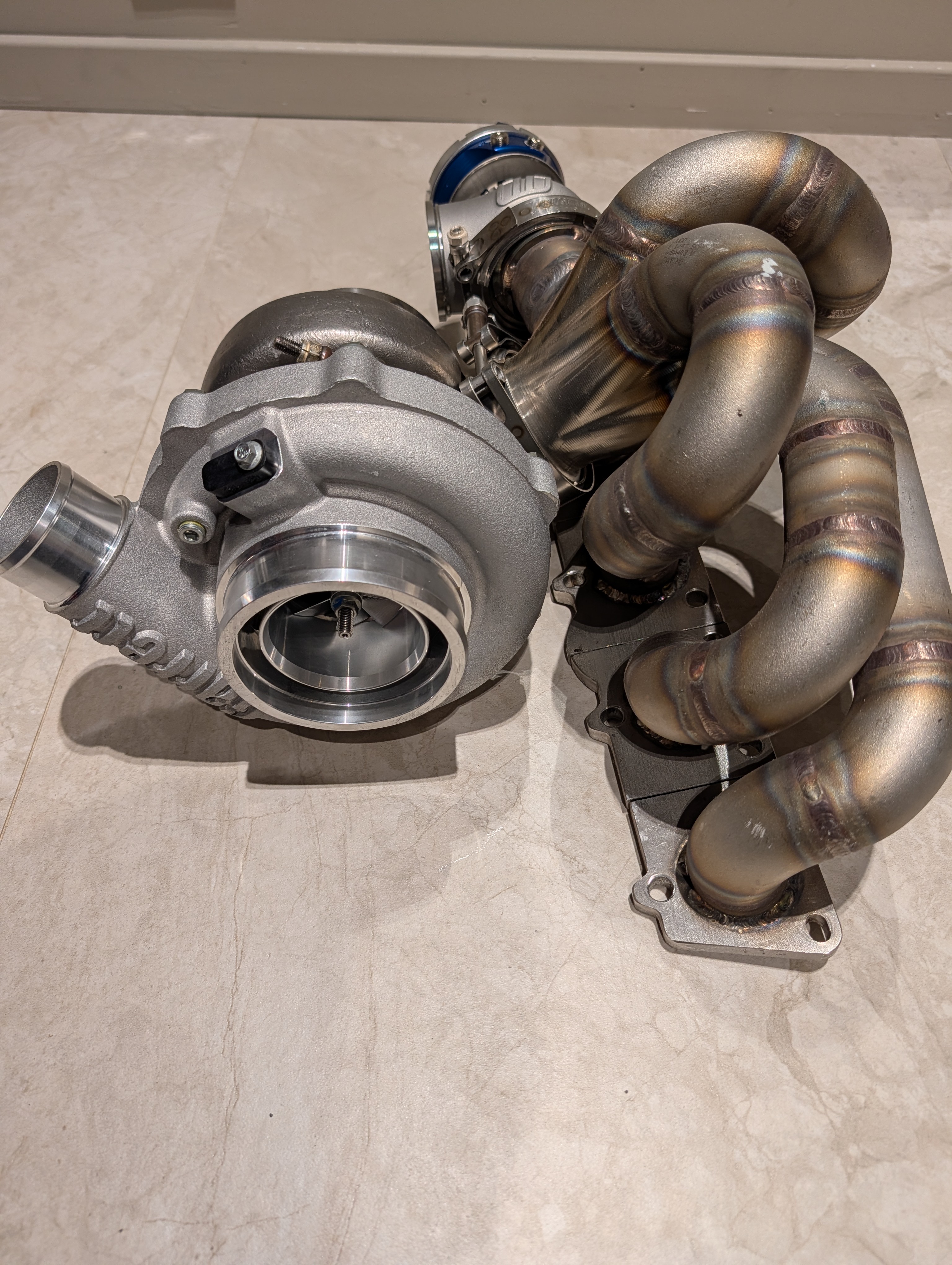

5 sylinder turbo side.
Garret G35-900
Turbosmart pro gate 50.
#45
Posts: 8969
Has thanked: 943 times
Been thanked: 4028 times
ealoken wrote: Fri Feb 27, 2026 9:34 pm 5 sylinder turbo side.
Garret G35-900
Nice, who made the headers?
#46
ealoken
Posts: 106
Has thanked: 46 times
Been thanked: 52 times
Tom wrote: Sat Feb 28, 2026 10:49 am
Garret G35-900
HE services, European 07k Specialist.
