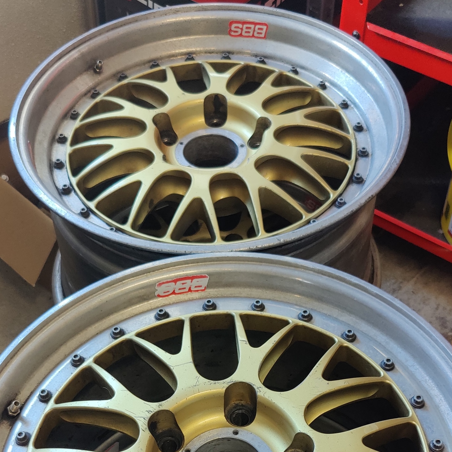

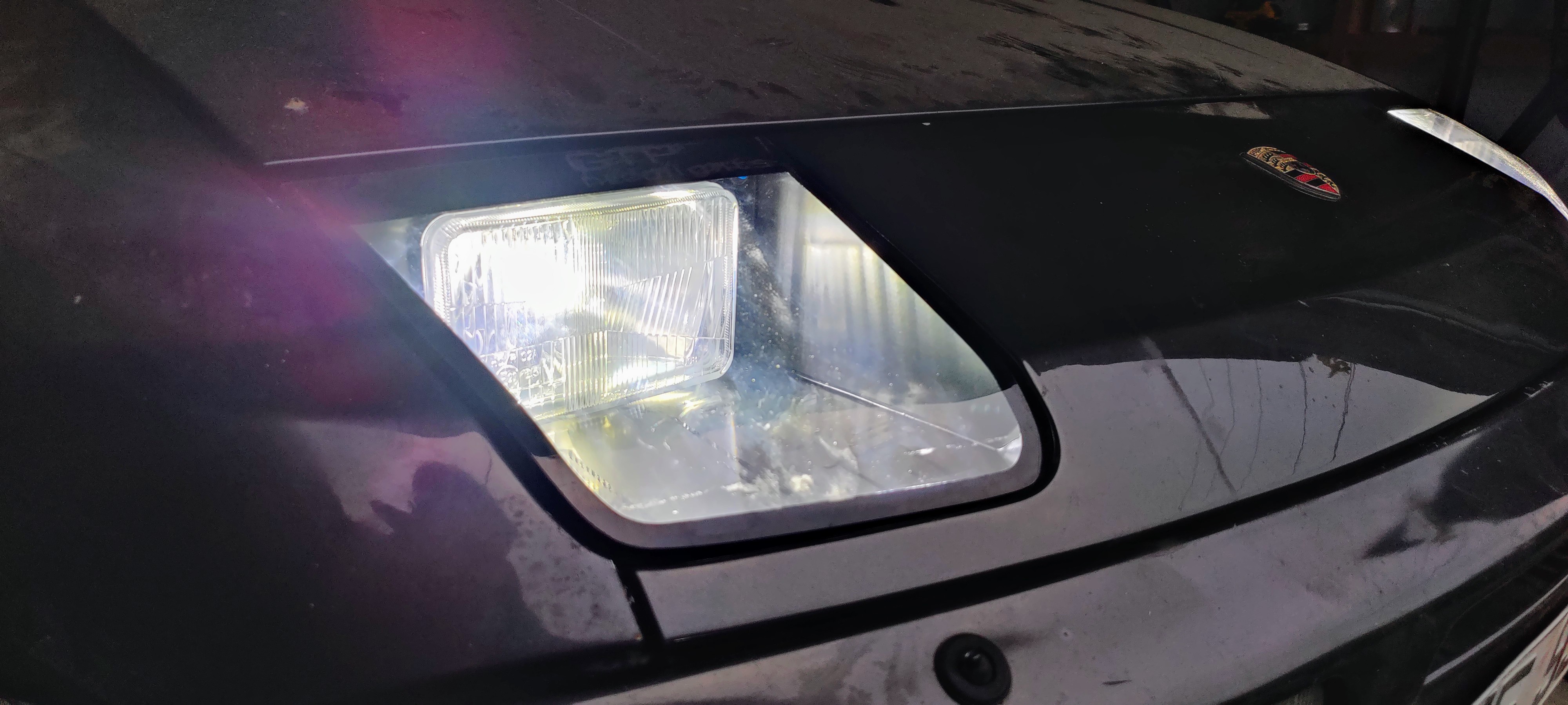

Some updates, new wheel project, LED bulbs in headlamps and my 07k engine for a later swap.

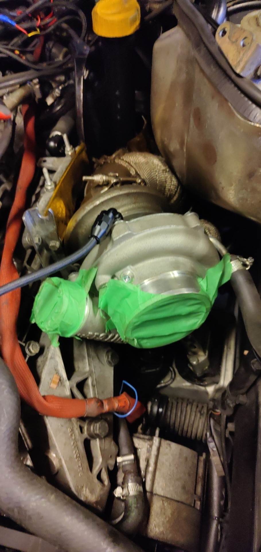

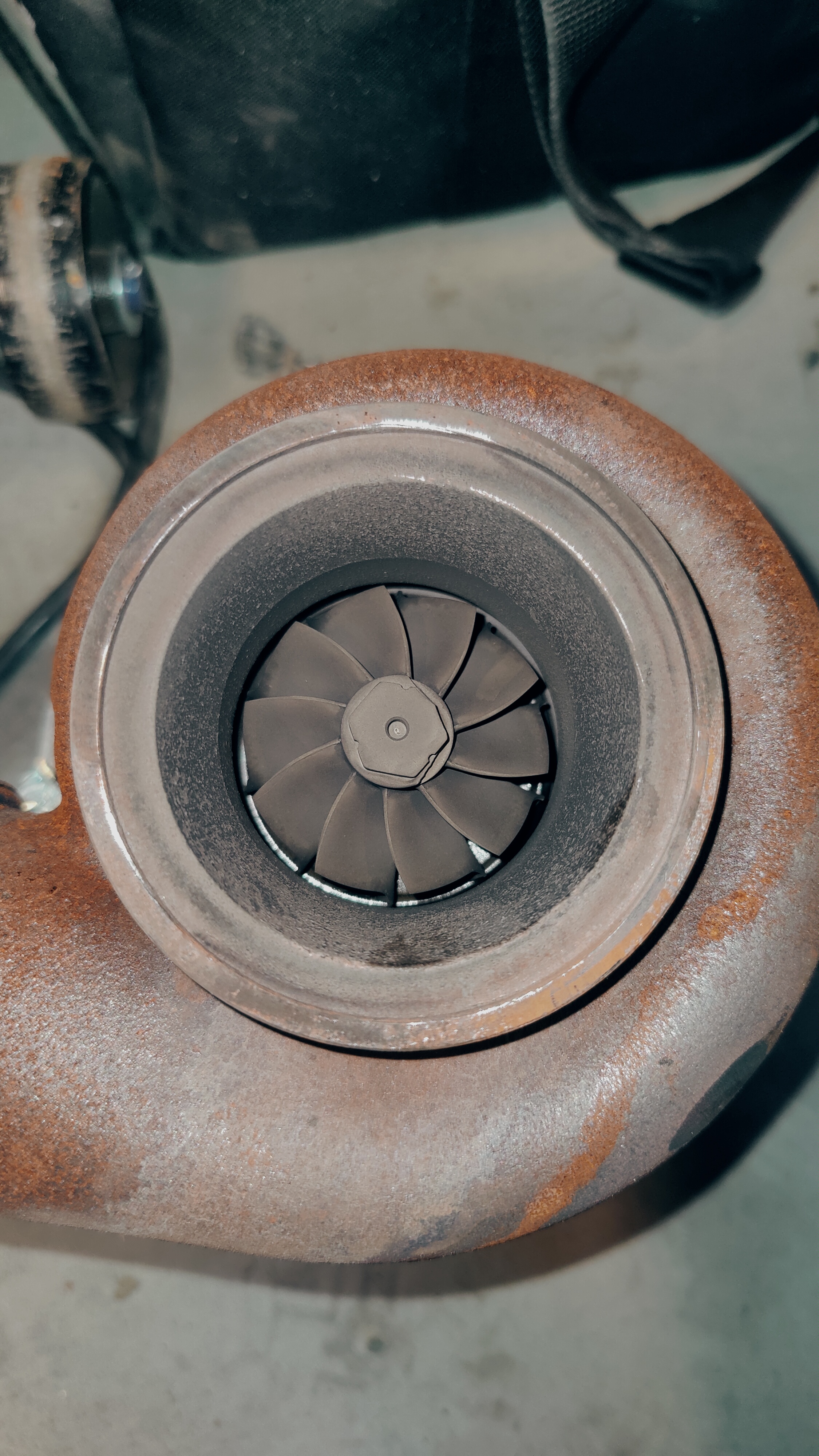

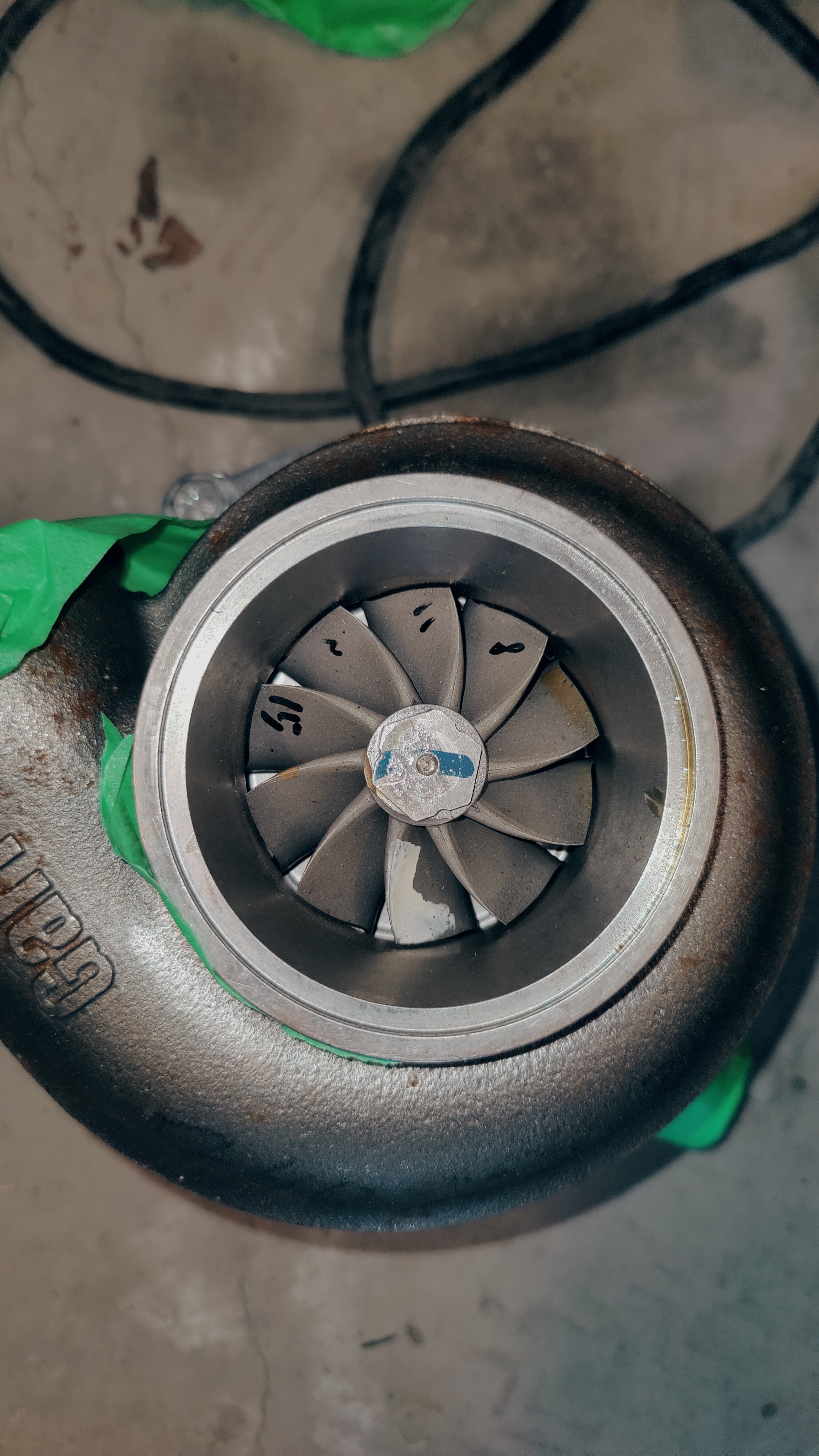

Update:
My brainfart on slow spool is found, china exhaust housing on my gt3071.
So i swapped in the bigger gtx35g2

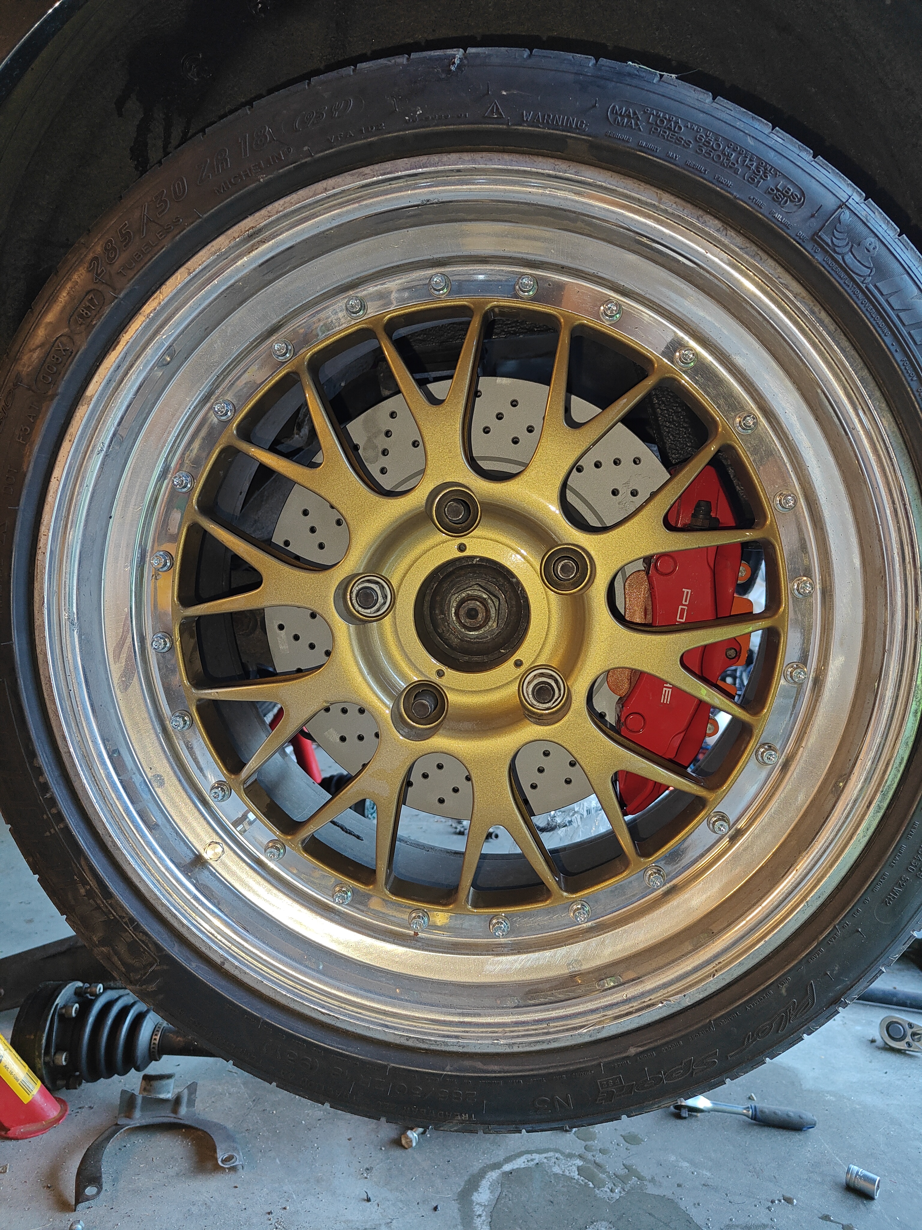

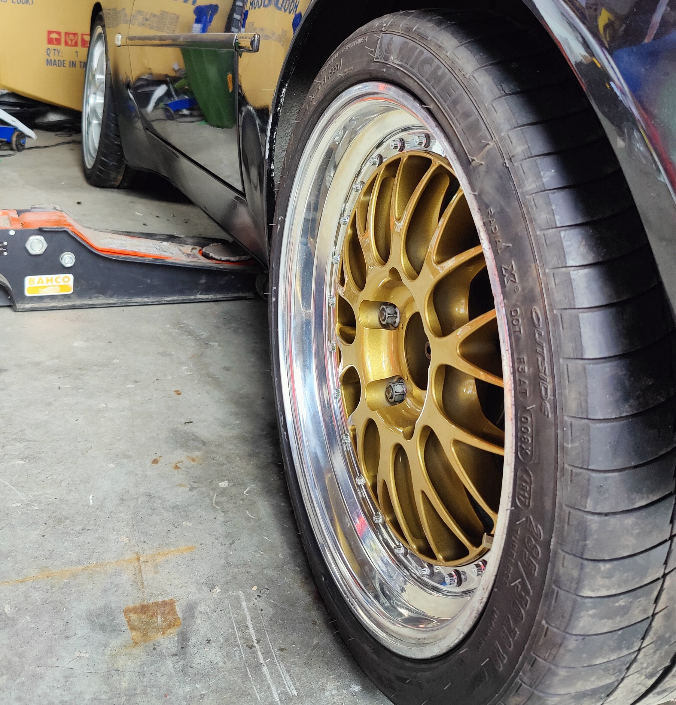

It's been 700km of driving this summer.

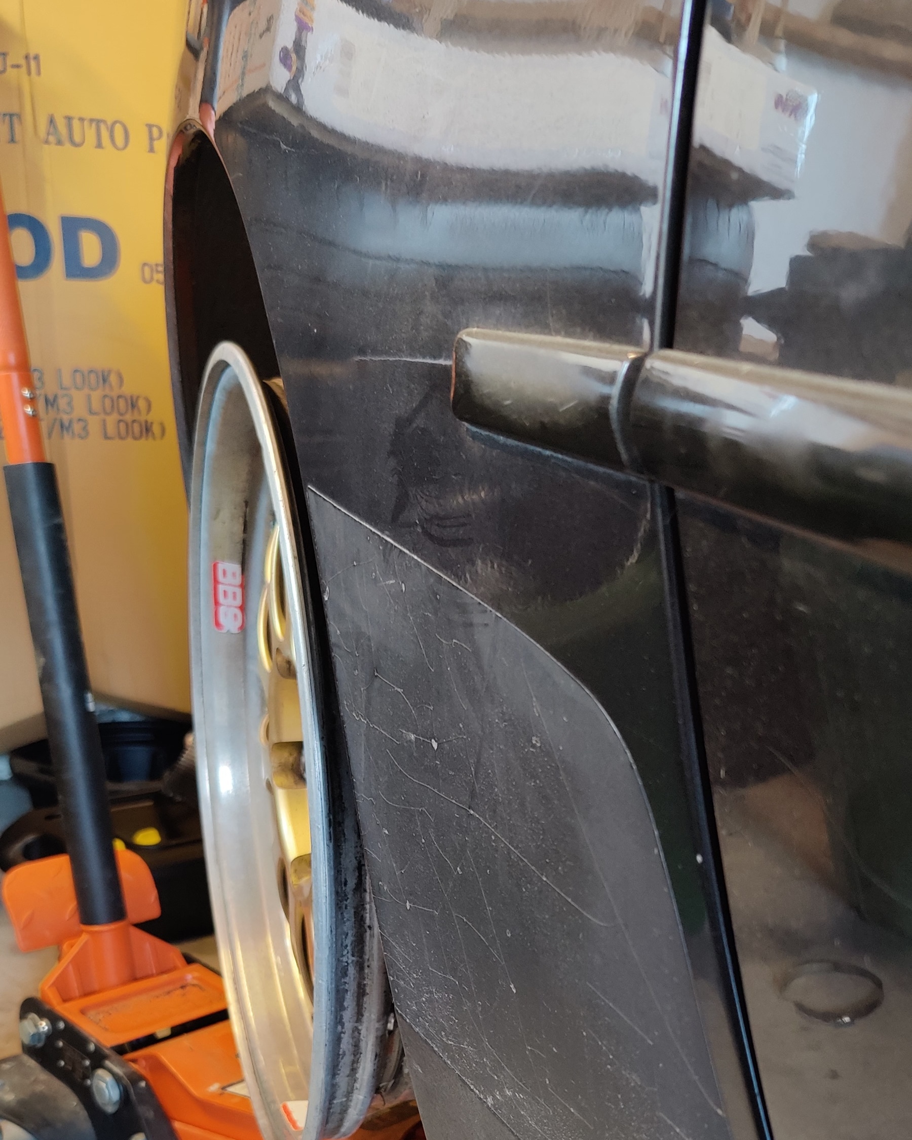

Now I got the big brake setup mounted on the rear.

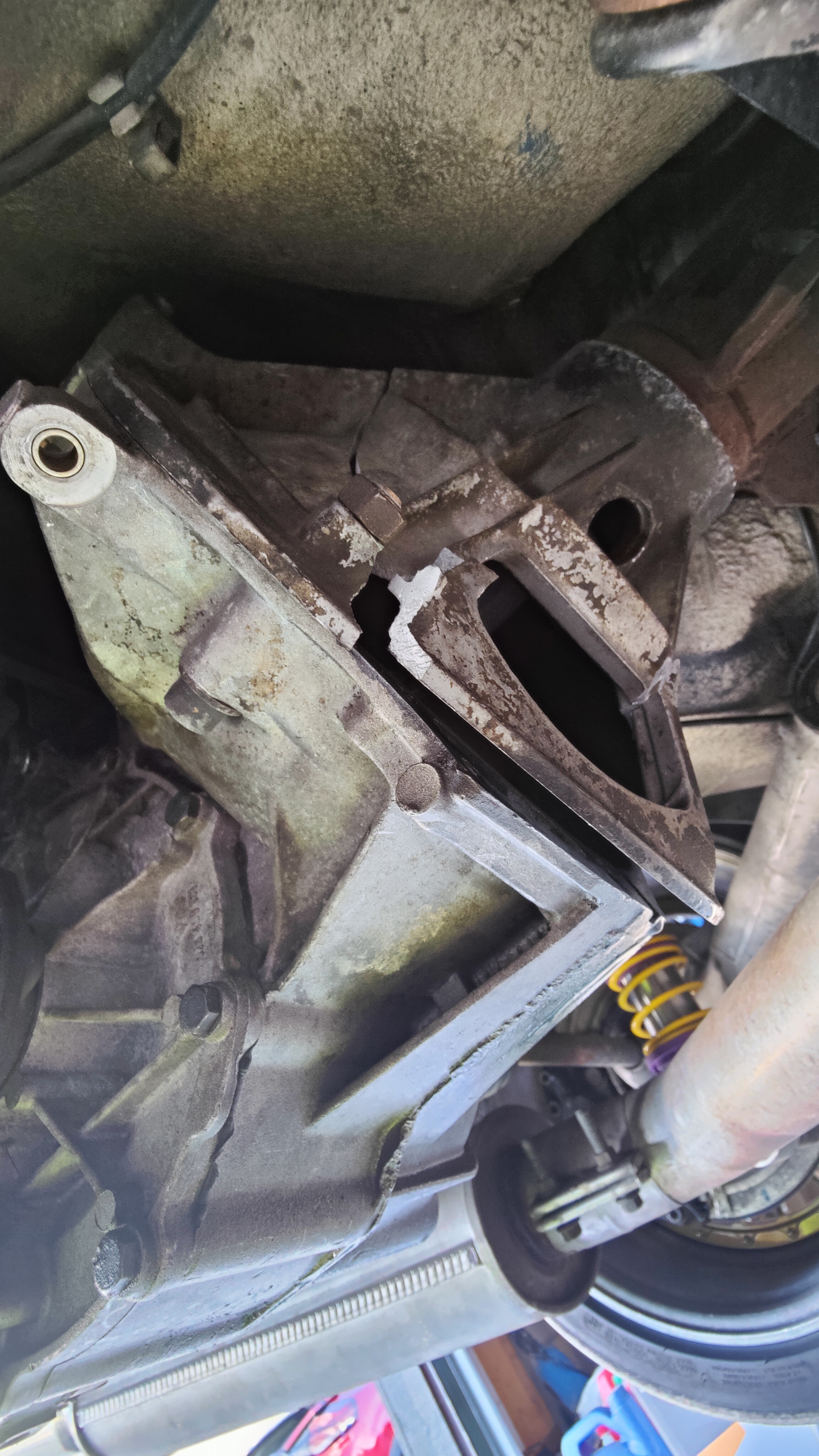

Gearbox mount broke, so torquetube broke.
New parts has arrived.

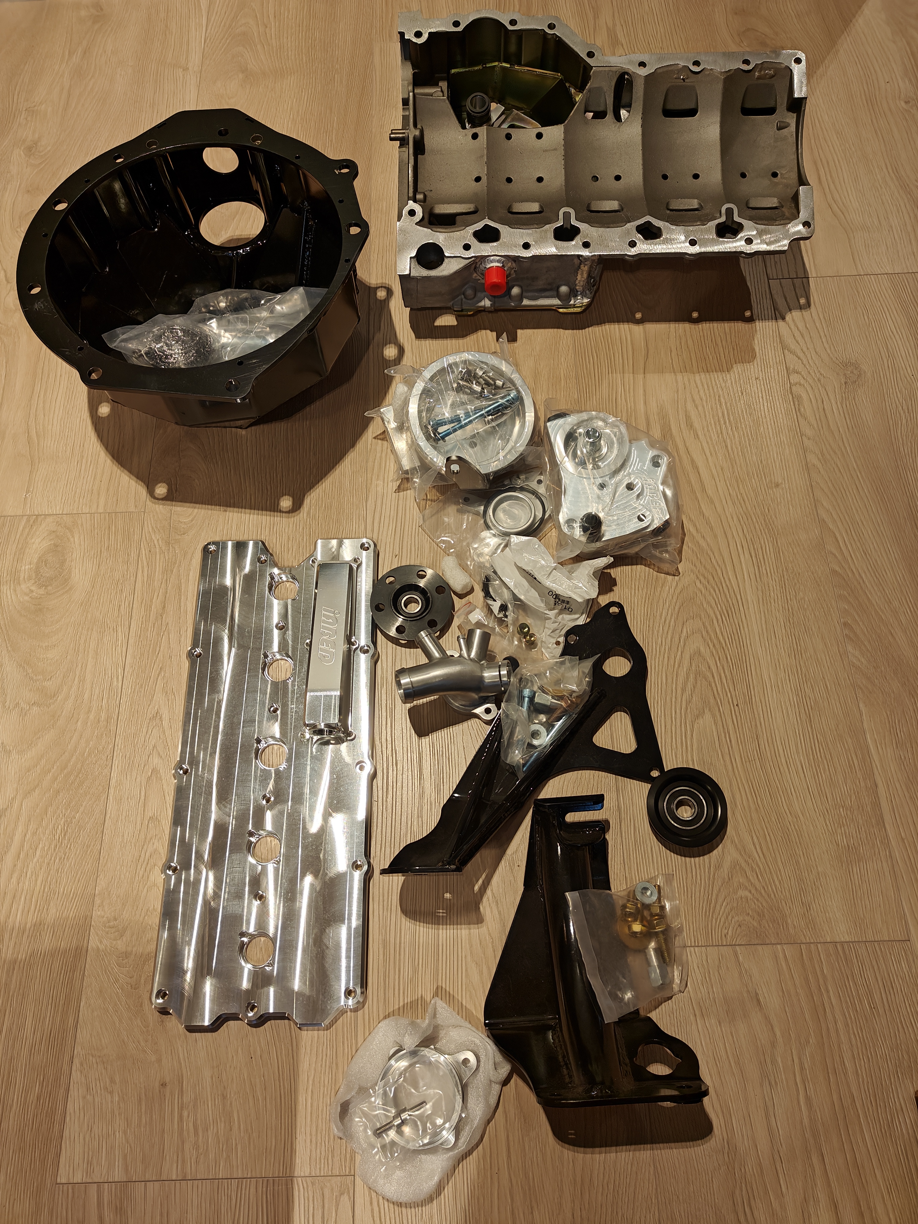

07k builders kit received
