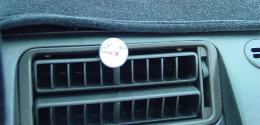

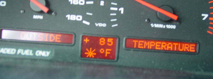

Similar compressor in the 928, AC converted to R-134a, cruising west across central California on 46 headed towards the coast. Anti-freeze switch jumpered to support an un-tinted black car in Los Angeles. Cabin setpoint at 72º F, Ambient 85º F, center vent 20º F.
You can get the system really really cold, like freeze your fingers on the steering wheel cold; it's certainly possible with some care and diligence.

So if nothing turns into a pumpkin at 20F, why does the system even have the freeze-over switch? Frostbite risk? Now I want to bypass my freez-over switch so I can finally get started on that super-conductor stand-alone system I've been mulling. 8-)

Important to manage expectations on car AC performance. Relative humidity, and specifically the related dew point have a huge effect on vent temps. Lowering the air temp 1º below that dew point number takes about 1000 times the heat removal as it does to move the sensible heat the last degree down to that dew point number. A soggy 30% RH day in the desert climate in most of California, or the high desert of central Oregon where we are now, is way different from a soggy 90%+ RH day in Tennessee or most other southern states. So 20º or even 40º vent temps may not be attainable on those days there. Look at the dew point temp where you are, and decide if it's close to the center vent temp you are seeing. If so, you may need to increase the system heat transfer capacity by 1000x, give or take.

The anti-freeze switch is there to help avoid ice buildup on the evaporator. Important in humid conditions and on longer drives. The perfect switch setting would be right at freezing, with minimum deadband. The mechanical switches have a bit of hysteresis, and that only gets worse as they age. There was a discussion in the last couple years about using a smarter sensor-plus-relay for the duty.
Even a little ice buildup acts as an insulator, heat transfer drops as the fins clog, air vent temps go up even faster as more ice builds up.
