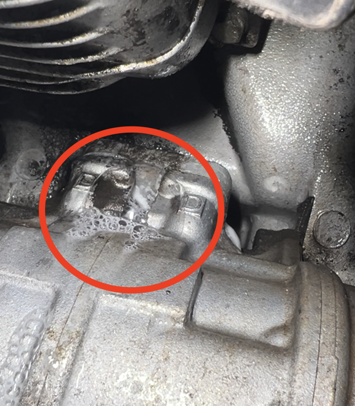

The AC on my car never worked since I got it, after checking pressures I found the system completely empty. I pulled vacuum but that lasted about 5mins, so major leak somewhere.
I put about 100lbs of air and started to look for a leak with water and soap, and of course it couldn't be a simple o-ring somewhere, instead the compressor is leaking. Looking under the car from the center of the car I can see bubbles from the top area of the compressor. I am attaching a picture that shows the location.
Any ideas? Is this a new compressor deal, or is there something up there that can be tighten.

I don't have your car, but do have the same compressor. If that's the hose manifold connection, it bolts to the compressor and does seal with o-rings under the manifold plate, so it's a relatively easy fix. Use modern green o-rings of course.
Over 25 years ago I did the R-134a conversion on my car, and didn't realize there are o-rings there. The initial AC charge was great for almost a day before there was a pretty spectacular discharge at the mounting flange. The new POE oil pretty much decimated the old buna o-rings from its R12 days. A lesson not easily forgotten. Fixed with new pieces, properly torqued manifold plate, another evacuation and refill, and its been reliably cold ever since with not a lot of attention.

I agree the leak appears to be stemming from the compressor's bolt-on manifold connection. The original o-rings were made of black rubber that hardens over time.
Check out part number: 94412693501, often listed as "A/C O-Ring (20 X 2.5 mm) for Compressor Service Fittings."
If you're going generic, the o-ring specs are:
  • Inside Diameter (ID): 20.0 mm
  • Cross-Sectional Diameter (CS): 2.5 mm
  • Outside Diameter (OD): 25.0 mm
Green nitrile is best when converting to R-134a. Pelican Parts and FCP Euro have them for about $1.00 apiece, you'll need 4 o-rings total. Coat lightly with refrigerant oil during installation. The A/C compressor should be removed for clear access to the hex key bolts, so you might as well replace the o-rings for the barrier hose connections and add in a new receiver drier while you're there.

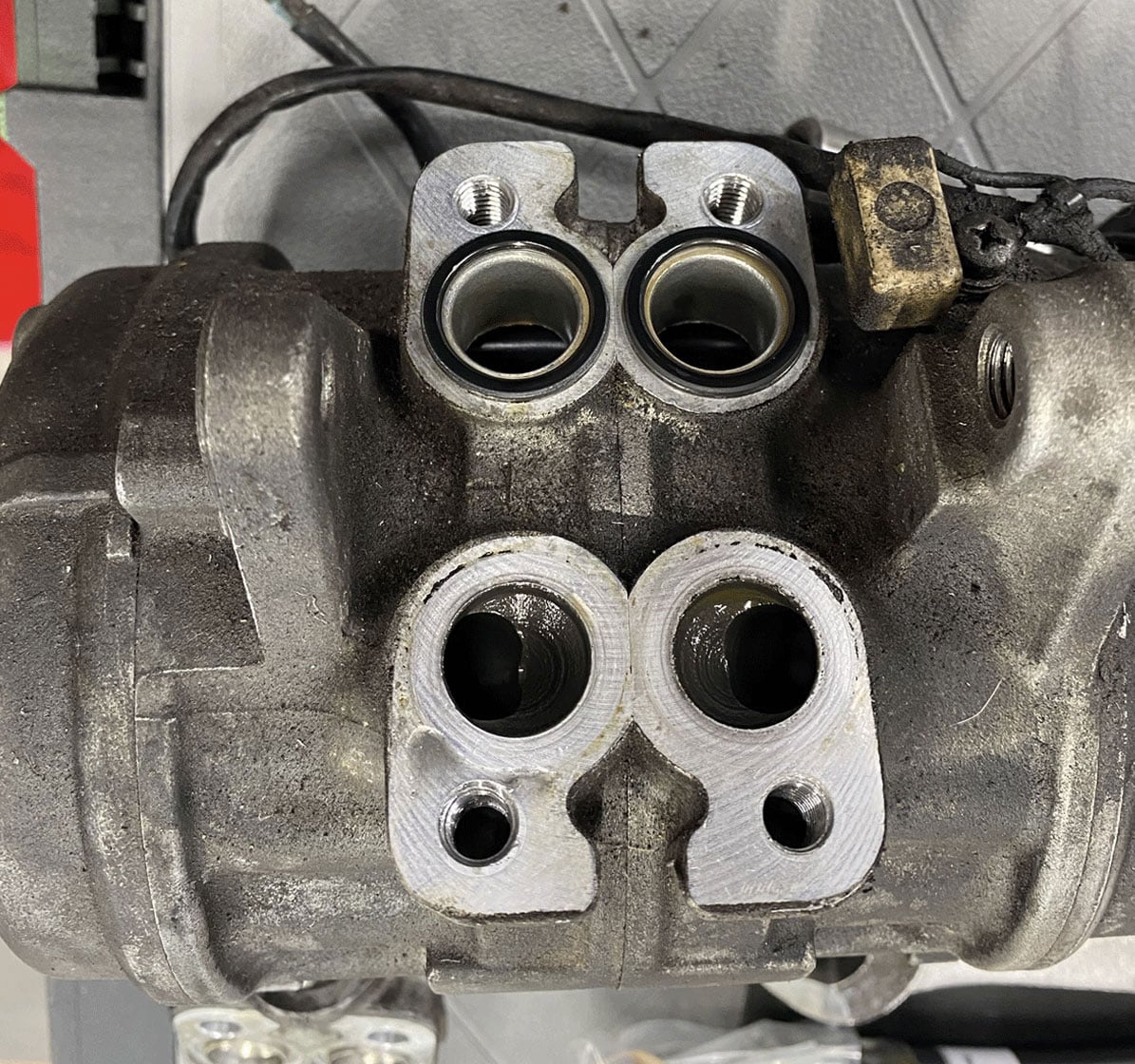

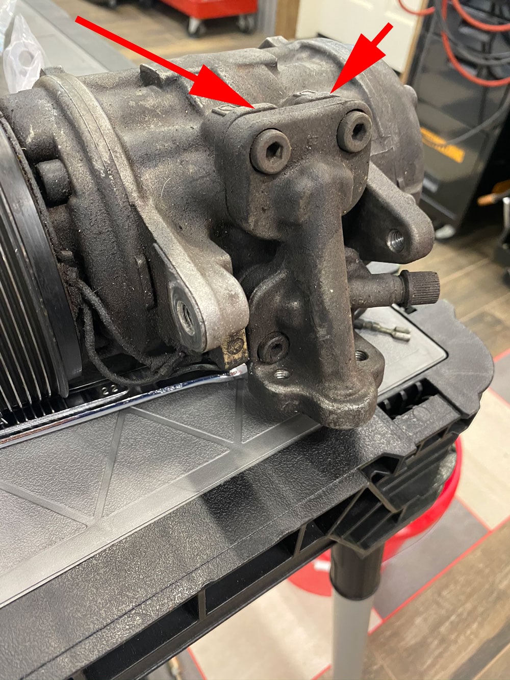

See pictures from my old compressor. Your leak is almost surely from the o-rings under that bolt-on manifold -- which I always think looks like an elephant's face :angel:

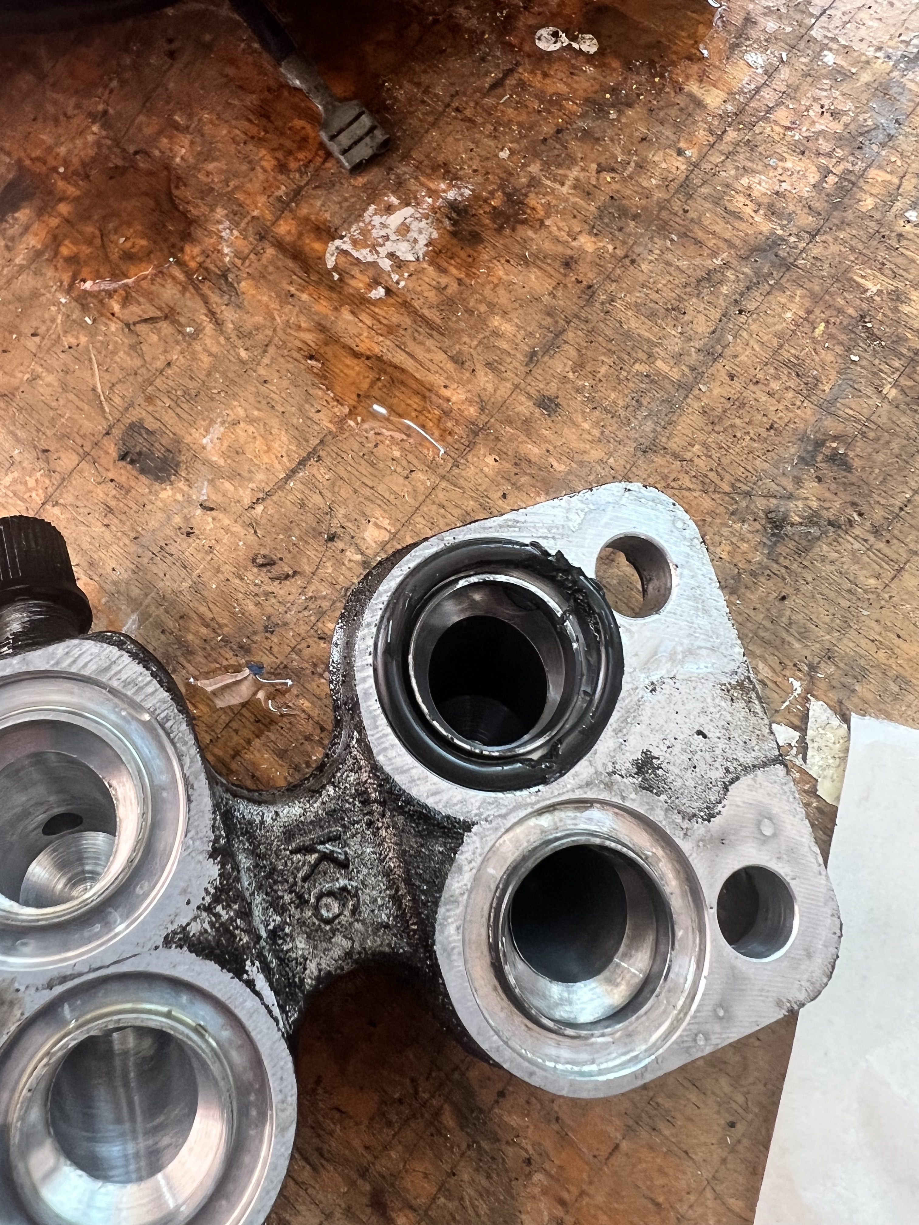

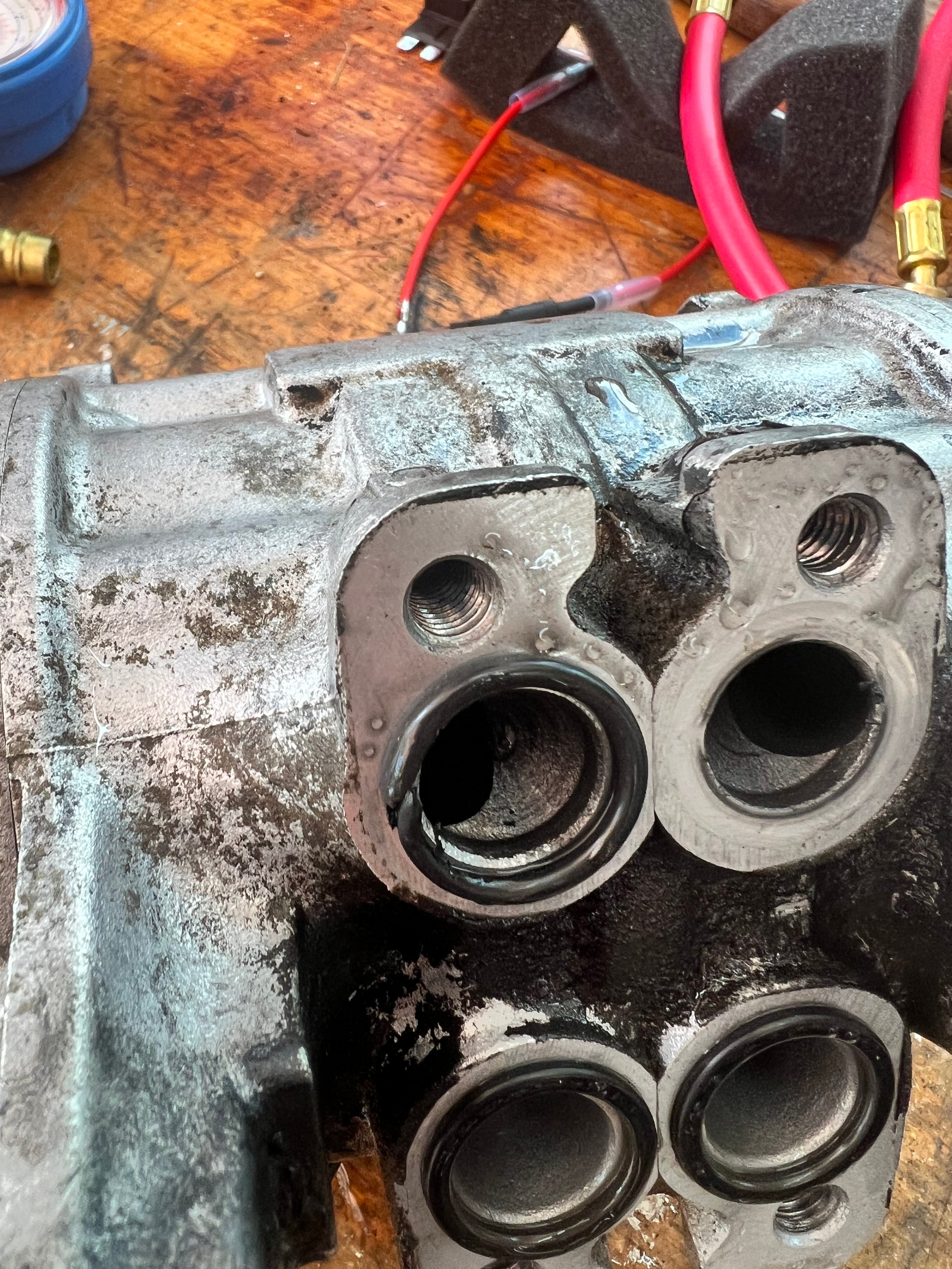

Well sir, you were right on the money. Take a look, two of the four o-rings were completely destroyed.
