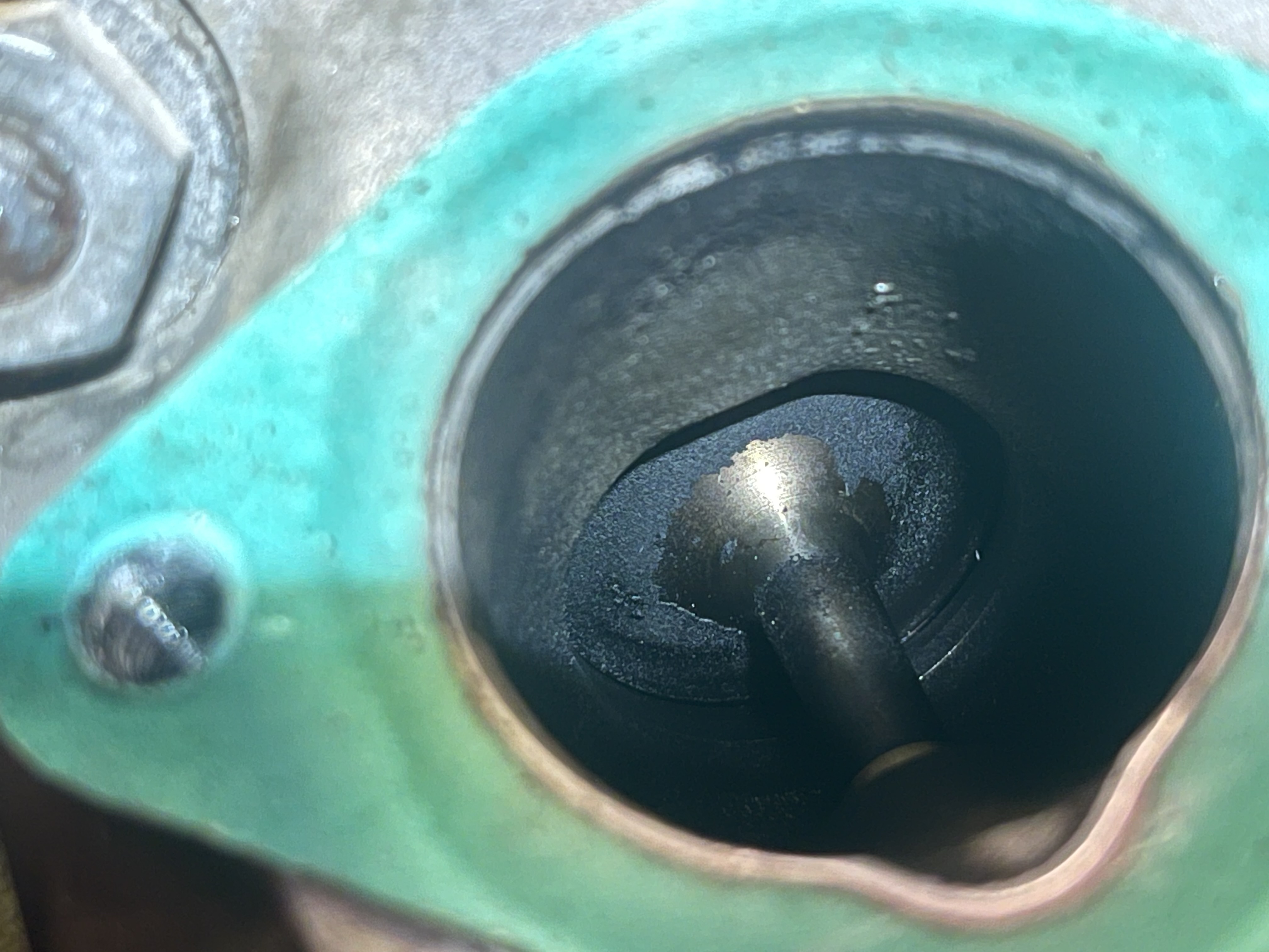

Here is the valve, not closing completely. There’s a small sliver of something on the lower right.

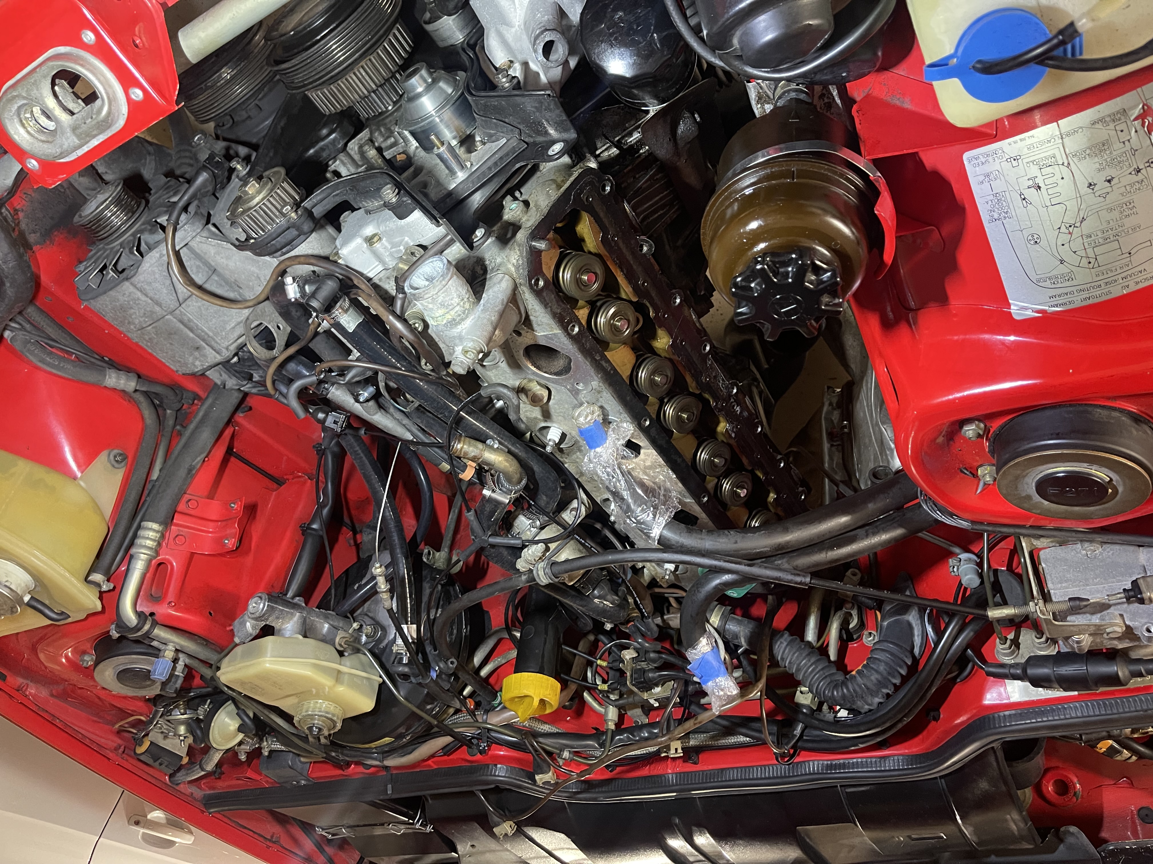

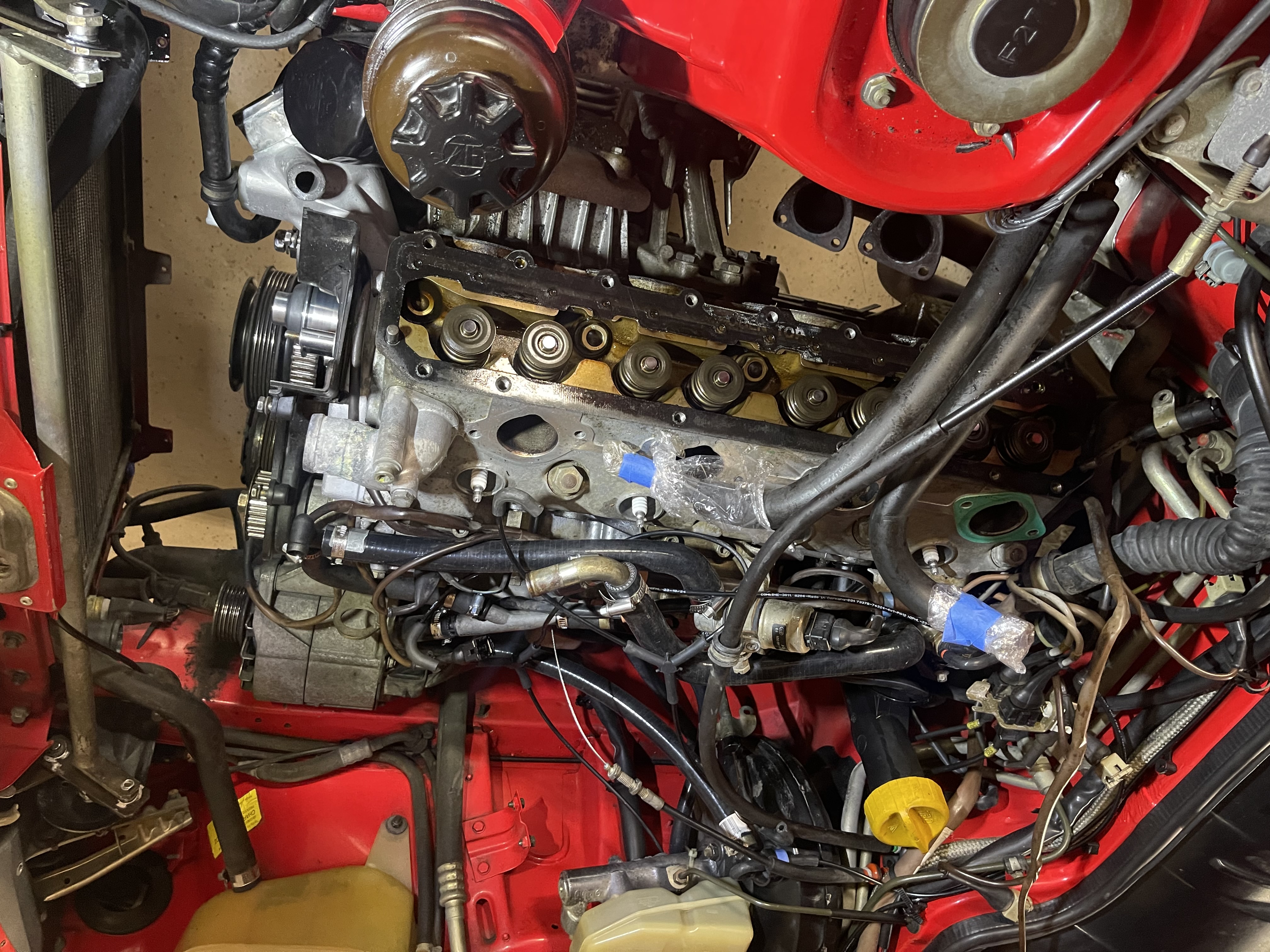

Stopping here for the night. Head ready to come out first thing in the morning.
#19
Posts: 8961
Has thanked: 936 times
Been thanked: 4025 times
Good work for one day! Now that the cam tower is off, did you inspect that valve spring/stem from above for anything obvious?
Looks like a very tidy, original engine bay. I worry about any car with original fuel lines, however, as those appear to be. Consider installing the Rennbay fuel line kit while you're at it....
