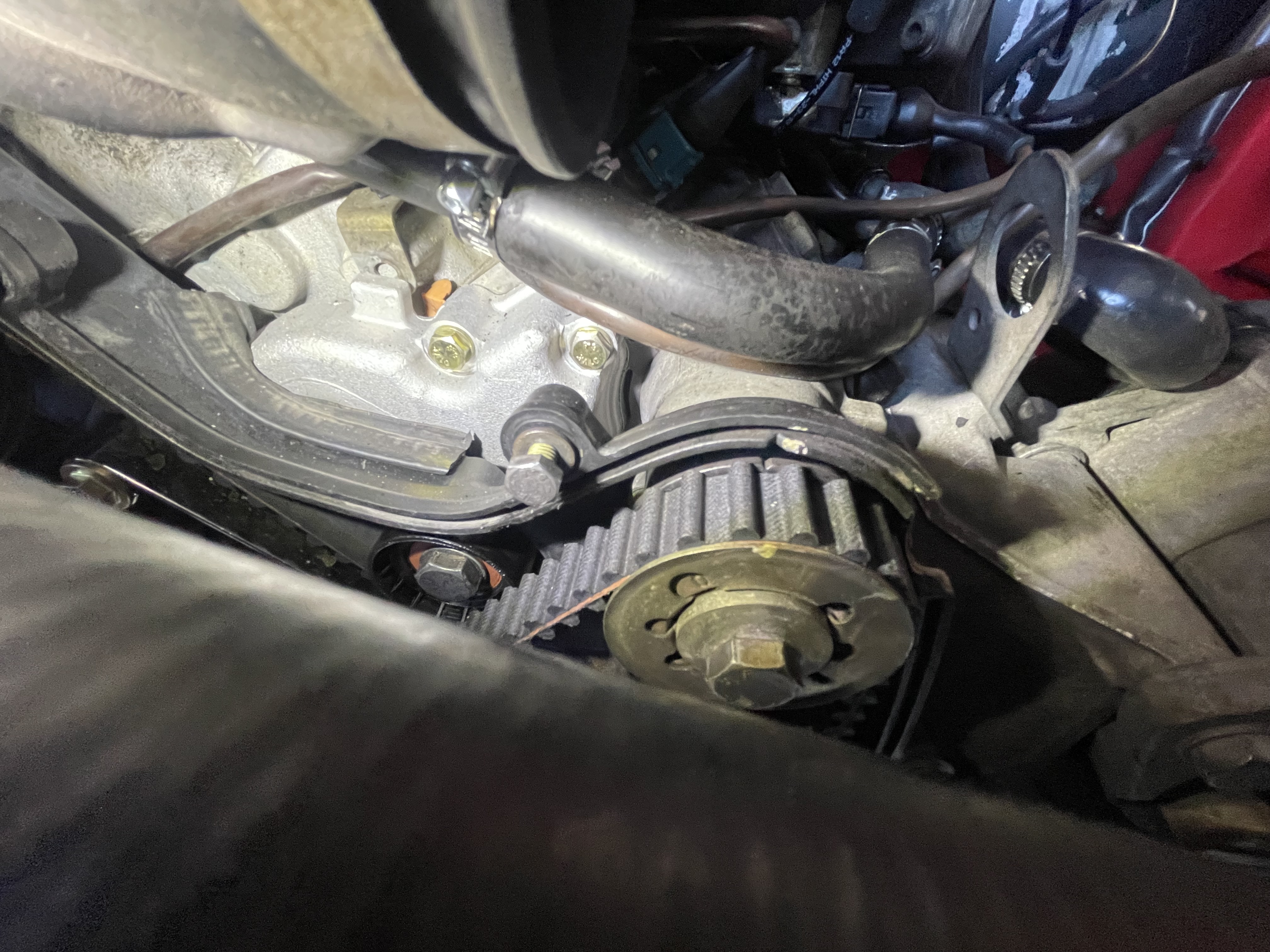

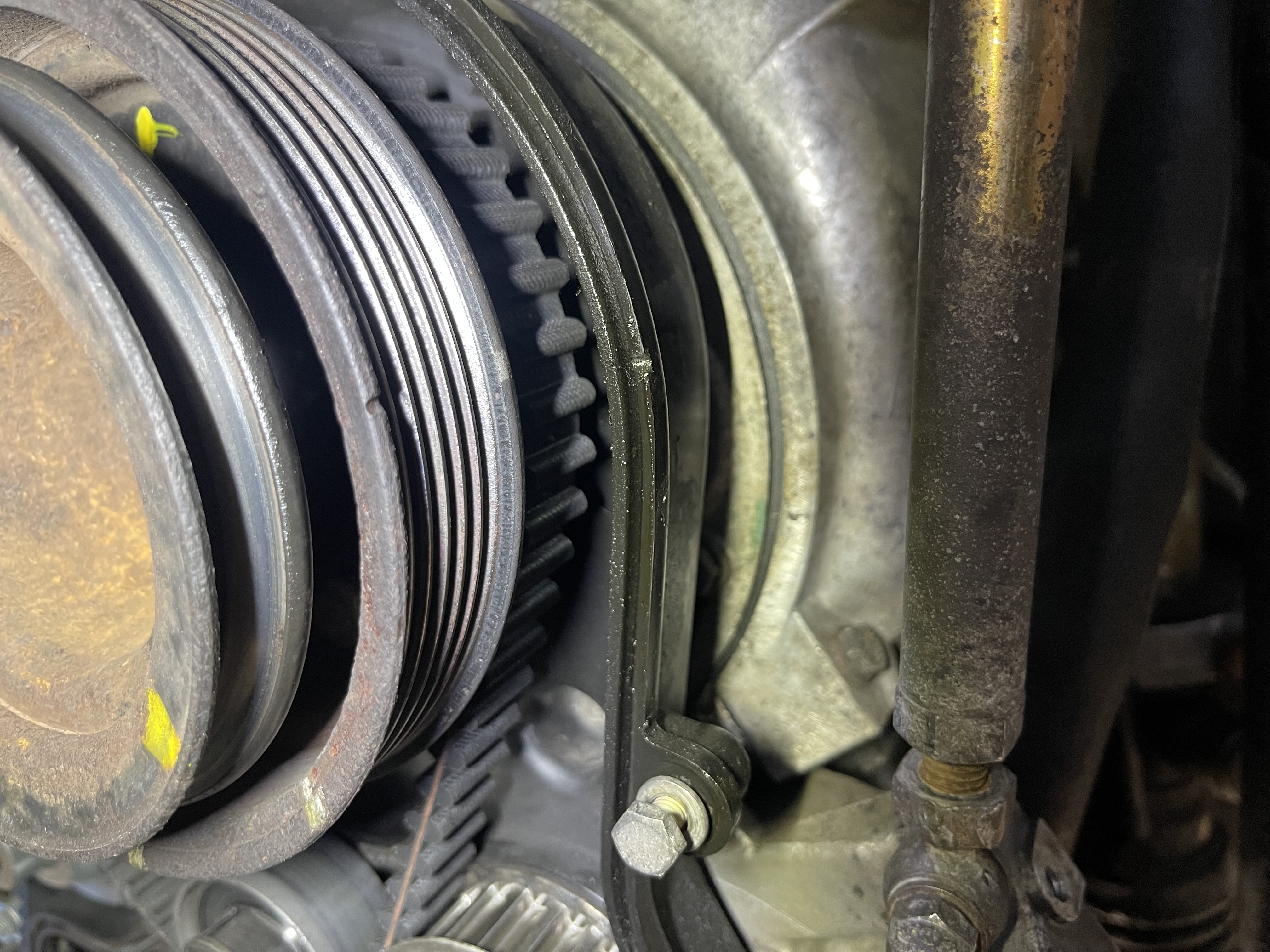

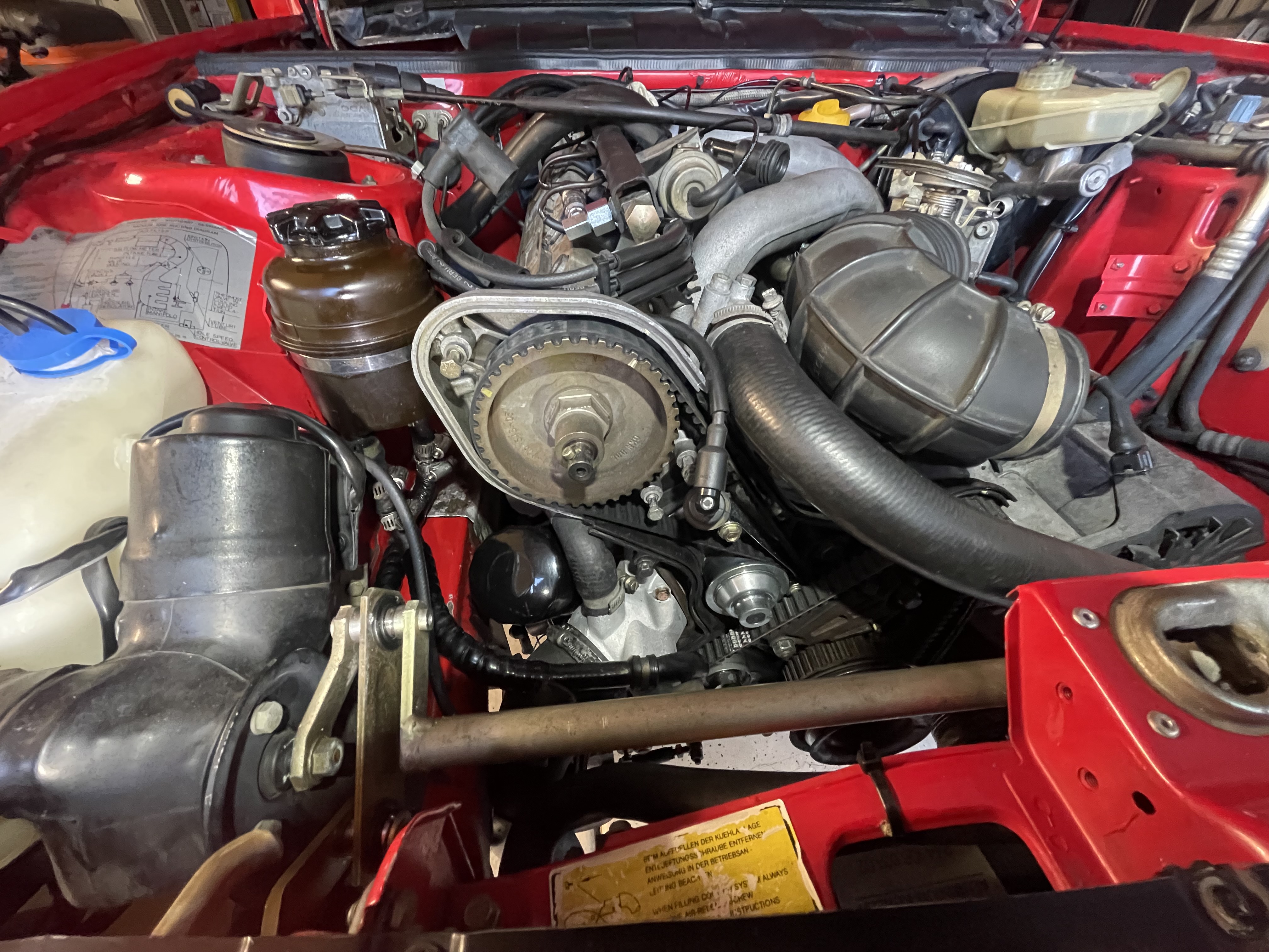

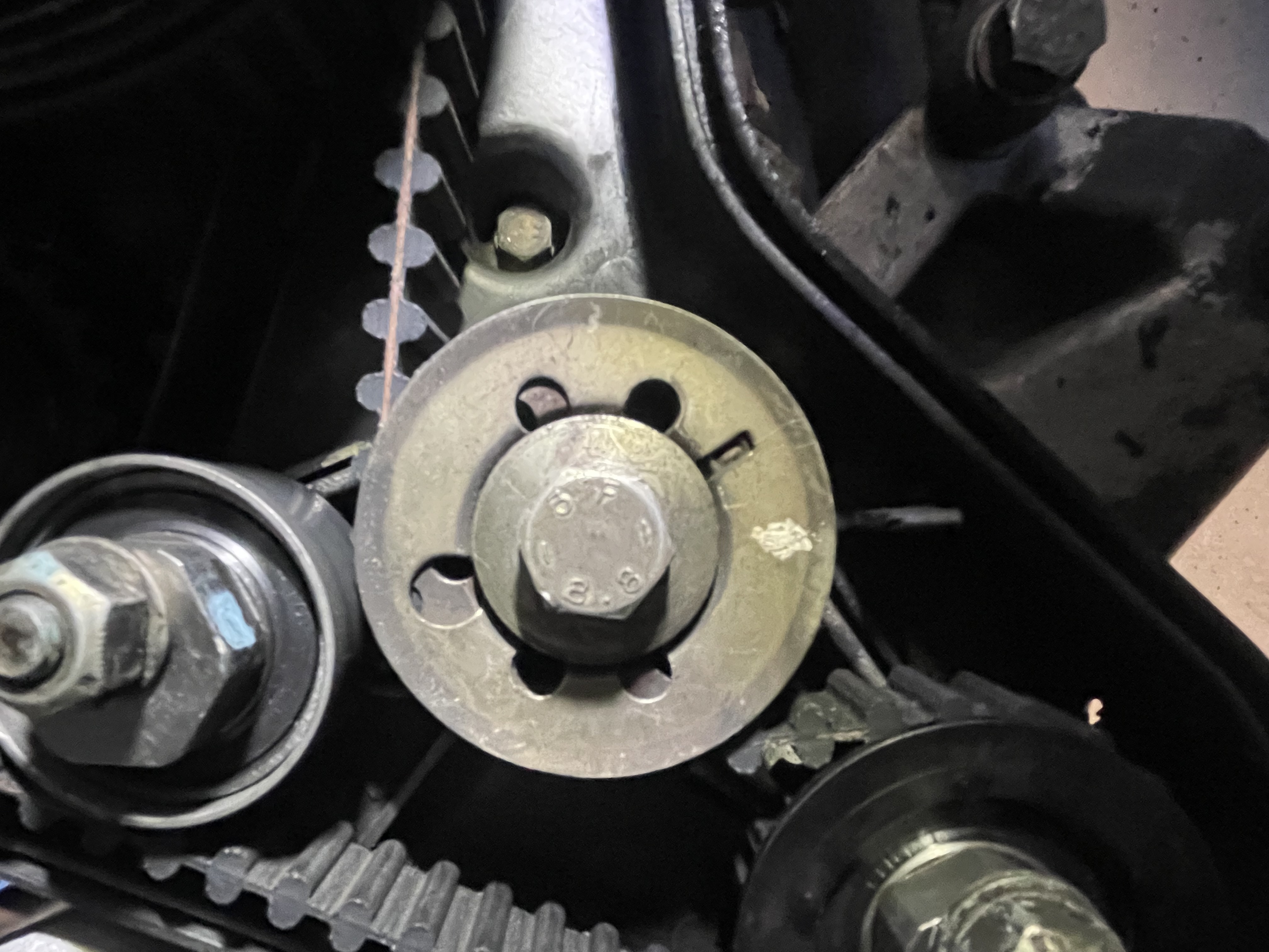

Got it torn down enough to check the timing, looks spot on.
Will stop here until the air compressor arrives to do the leak down, I’m sure I’ll find other uses for it :)
