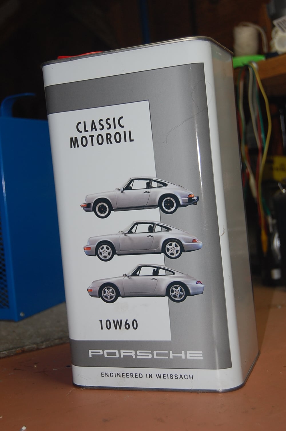

I use Porsche Classic Motor oil, specially formulated by Porsche for Air Cooled 3.0L and above.
My 911 told me she loves it !
