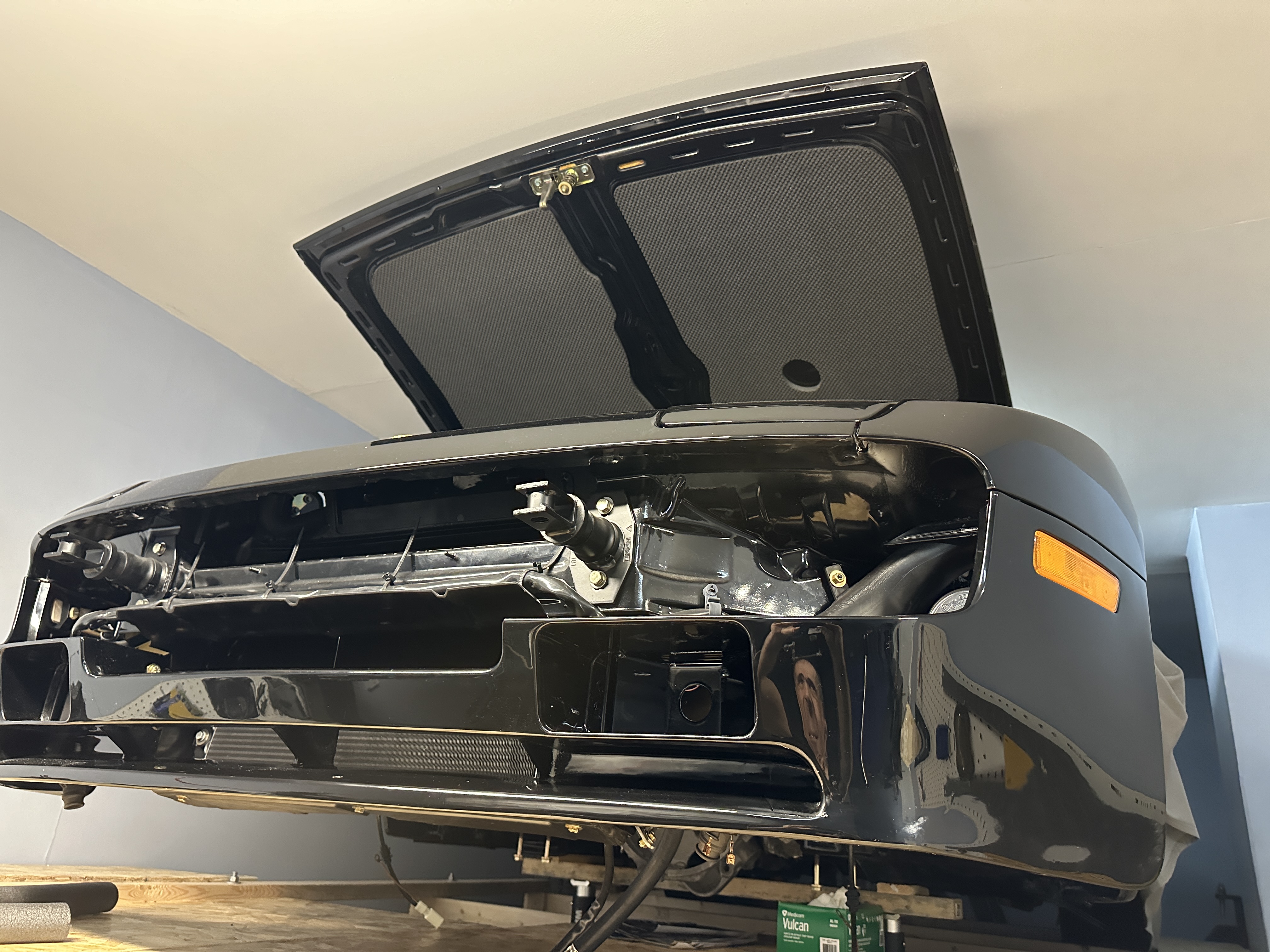

This week’s list of odd jobs completed:
I reassembled the manual steering rack components that had been painted. Although it was greased from the factory (it is a brand-new rack) I went ahead and purchased a small tube of the correct grease from a VW dealership and went over everything, just to make sure.
The windshield washer system had been messed around with a fair bit in this car’s prior life. The passenger-side check valve was connected the wrong way (with plastic zip ties), the pump was a different style to OEM that was just zip-tied loosely in place, and the return tube going into the tank had been plugged shut with a bolt.
To remedy all that, a repair kit and extra hose was purchased from 944online. The pump is an aftermarket URO item, which seems to have mixed reviews, but hopefully it will be fine for a decent while.
Tested the original jets with a syringe and they seemed fine, so went ahead and installed and clamped in all the lines. It looks complete and correct; however, I still have to connect the heating wires and under-hood light. It seems I de-pinned all five wires from the female housing of the inline 6 pole connector that goes in the hood, but have no idea what I did with that housing. Fortunately, they are still available, so I have one on order.
In between, I was also able to install the AC condenser air ducting as well as new hood insulation pads.
Finally, popped the wheel well liners back in. Quite pleased with how they look actually.

500 wrote: Mon Mar 11, 2024 9:08 am This week’s list of odd jobs completed:
Finally, popped the wheel well lines back in. Quite pleased with how they look actually.
I'm going through the same issues with the windshield washer system in my 87 S. I installed the same kit from 944online, found (what I think) was a good set of squirters from ebay. Hooked it all up and.......nothing. Pump seems to work, but I have a feeling either the squirters are wrong or one of the check valves is stuck or backwards. Now I get to cut off all those Oetiker clamps again and see where the flow stops.
I'm really enjoying your progress on this car. Keep it coming!
