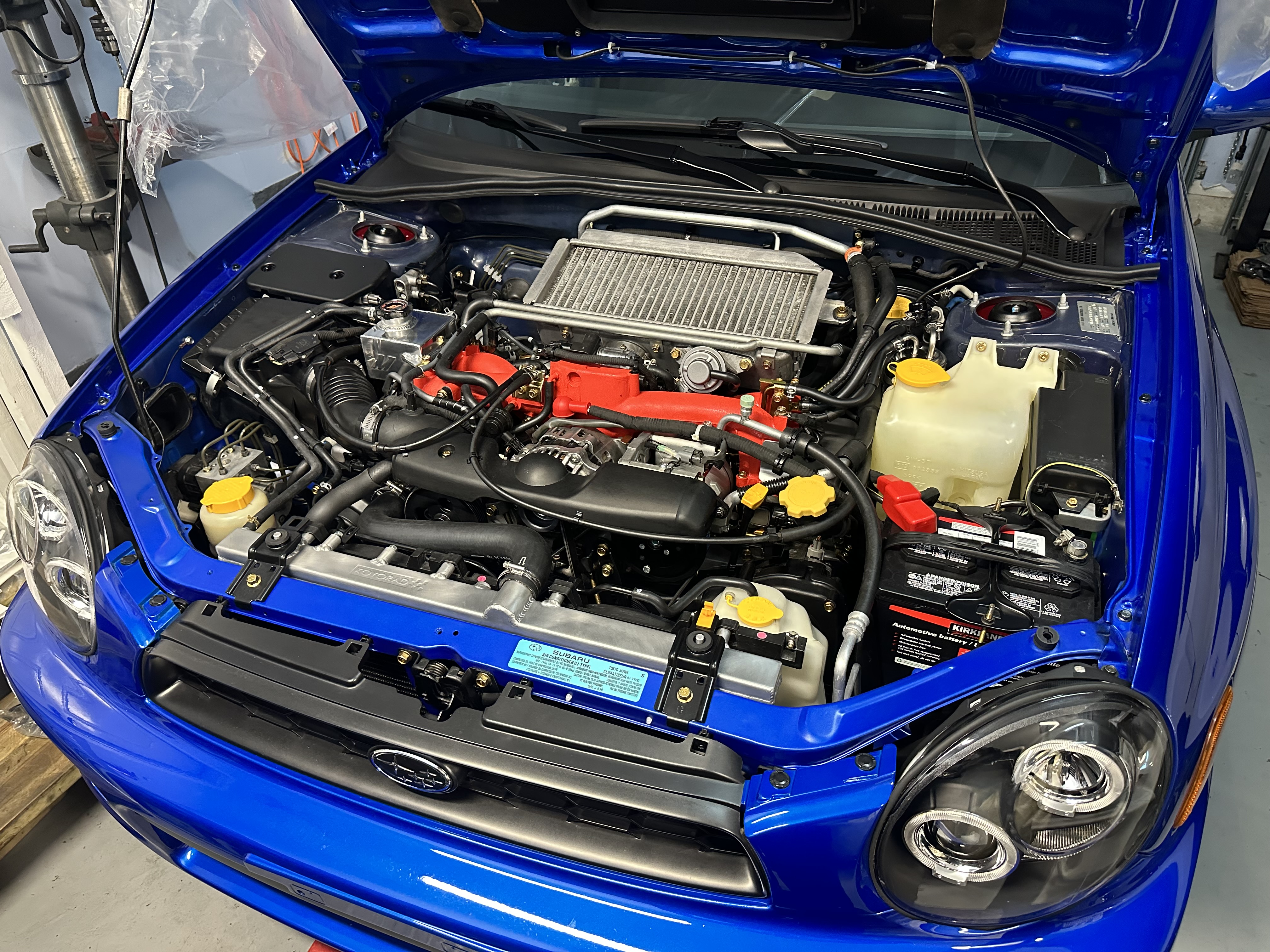

Most recently I have been working on a 2002 Subaru WRX, which was an unexpected project (longer story), but it is now almost done, so I am back on the 944 (finally). I really want to finally get this one done, and have a soft target of finishing this year.
Here is the 911 and the WRX just for fun:

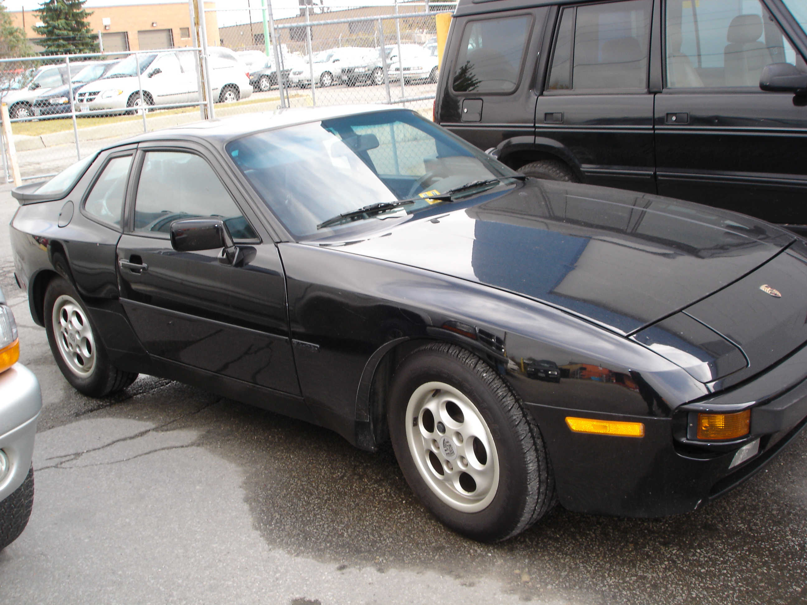

But now to the 944. This was the day I purchased it:

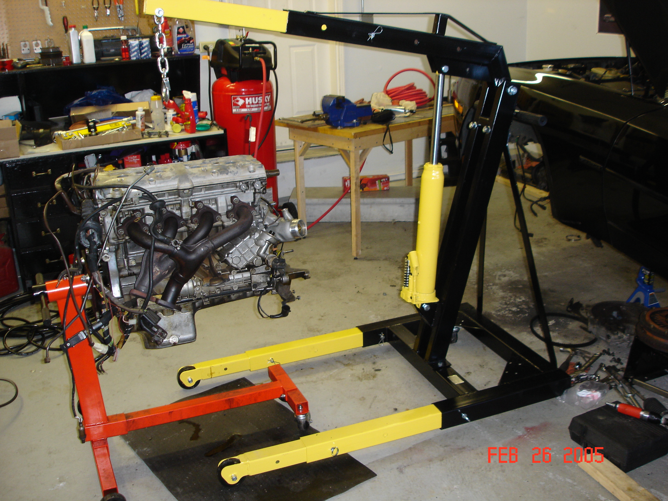

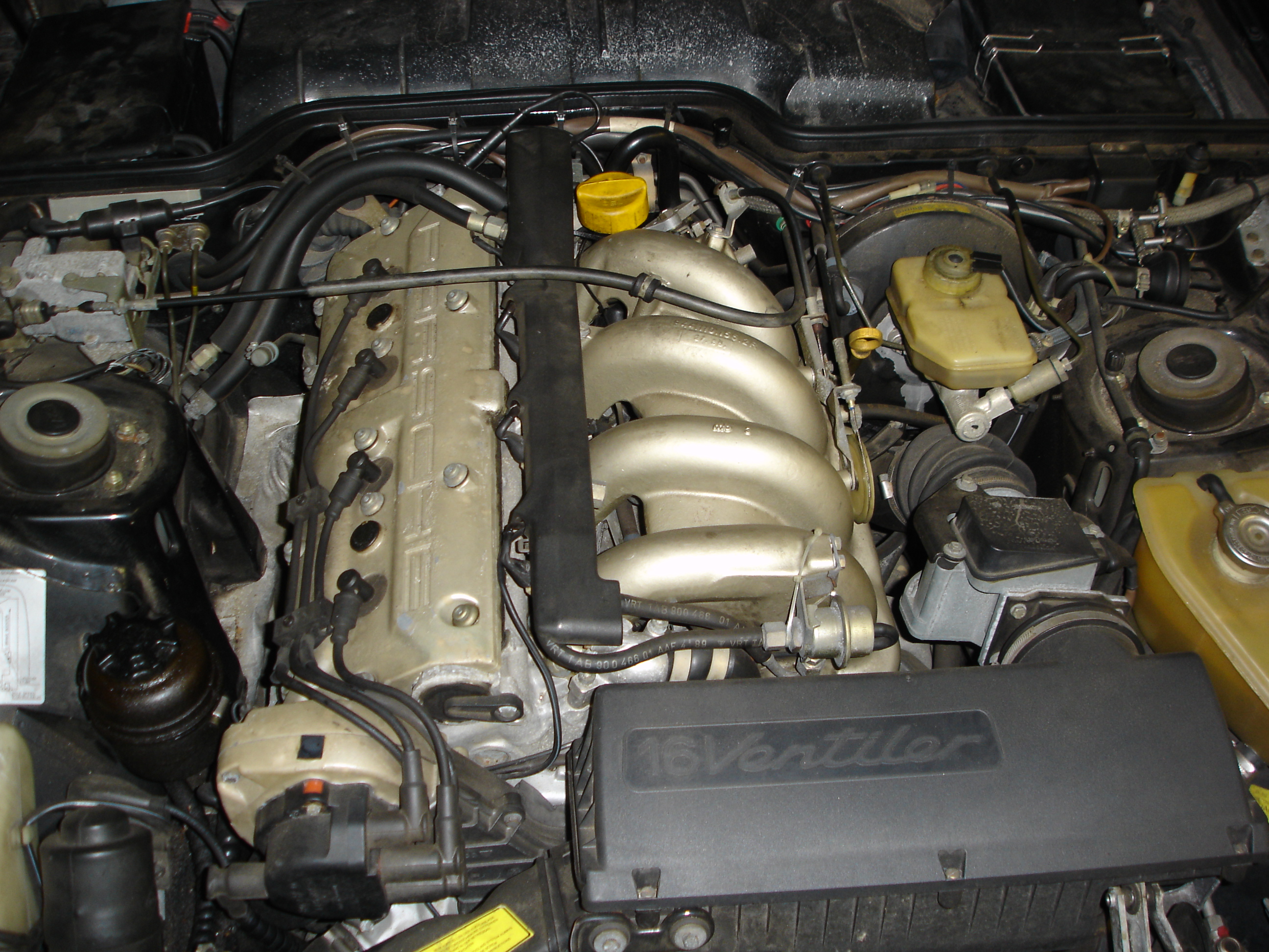

This was the engine when removed:

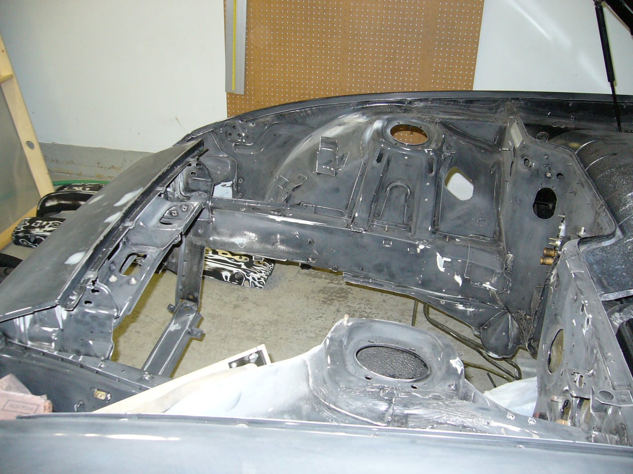

So, I spent a couple of months stripping and prepping the car. Here is the car as I was getting close to paint:
I had never painted a car before, but I spent a lot of time researching, and a lot of money on equipment (various spray guns, powered fresh air breathing system etc.) and also spent a small fortune on the paint products themselves (I used Glasurit products throughout). I actually am not a fan of black for cars, but I stayed original with the L041 Porsche black that car was from the factory.

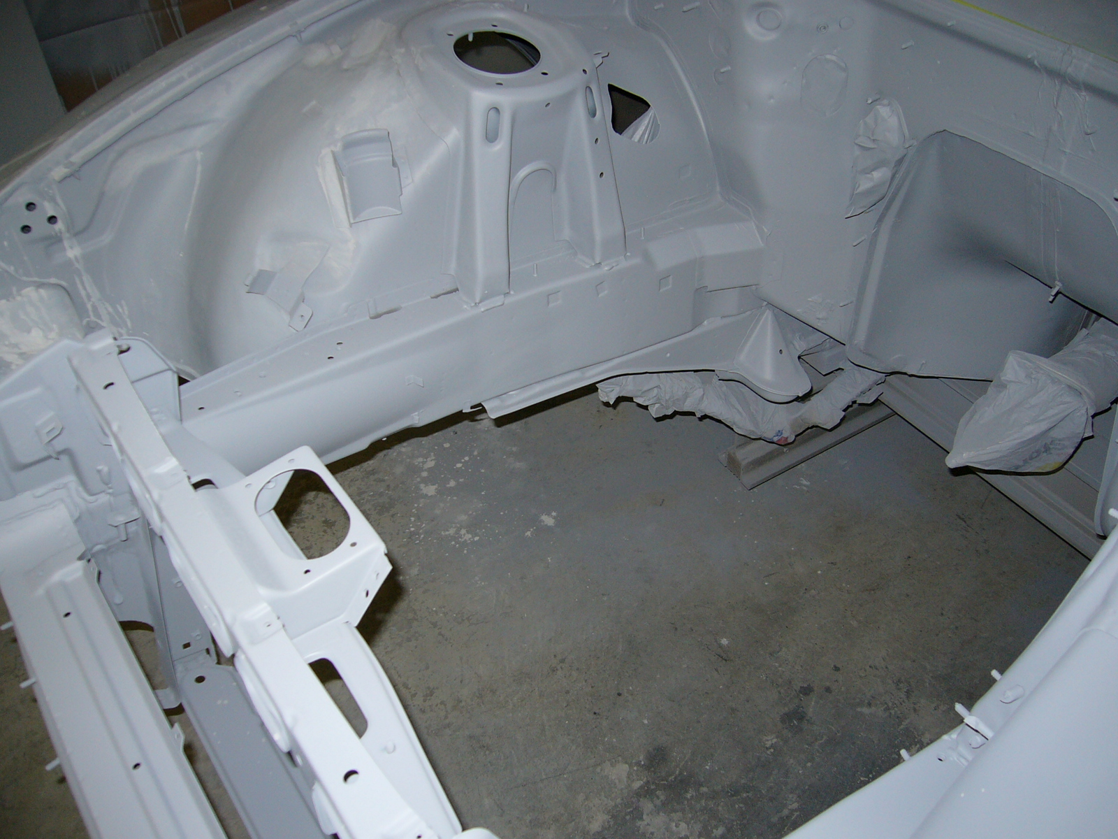

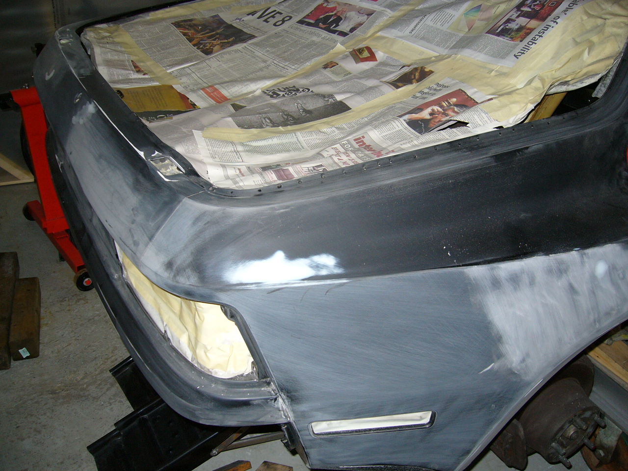

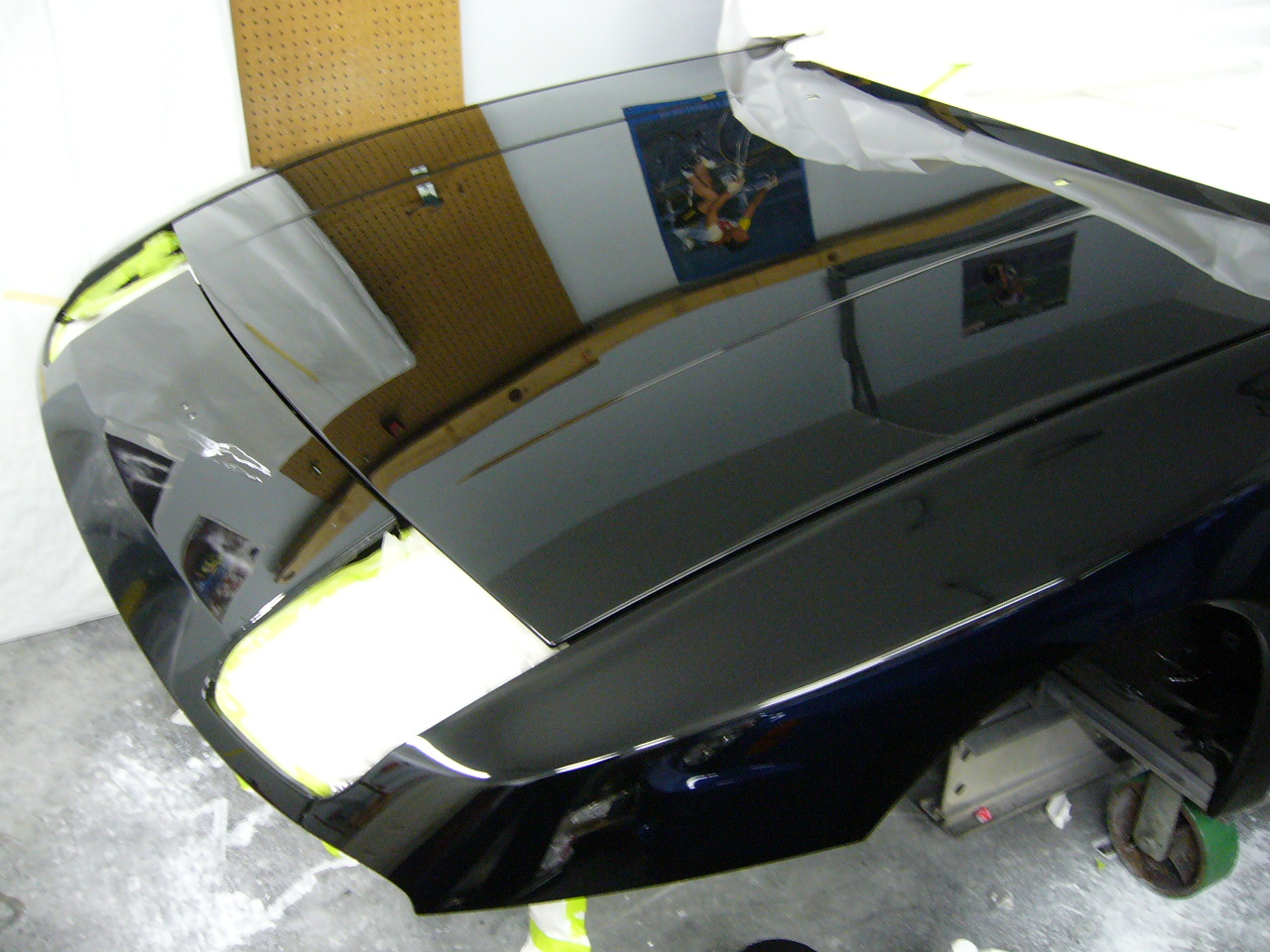

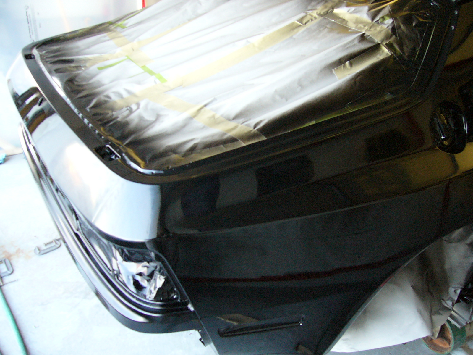

I built a booth to paint the car in, and started with the primer stages, which actually went pretty smooth. After letting the primer cure and then re-sanding everything as per the product data sheets, I was ready to paint. Although the car was originally painted with single stage, I went with the base/clear approach as it seemed from my research to be easier to fix mistakes with.
As per typical, I had to break the painting up into stages, the bumpers, mirrors etc., done separately and so on.
In primer:

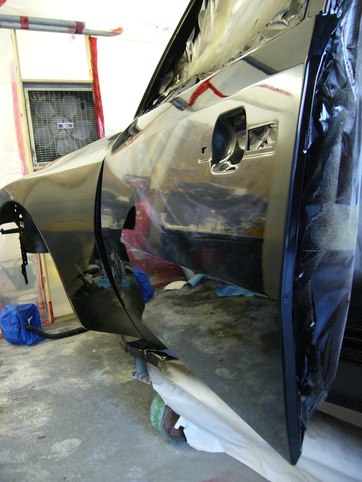

Main car in paint:
Although the day I took these pictures I thought I was almost done with the painting, there was still a lot to do...

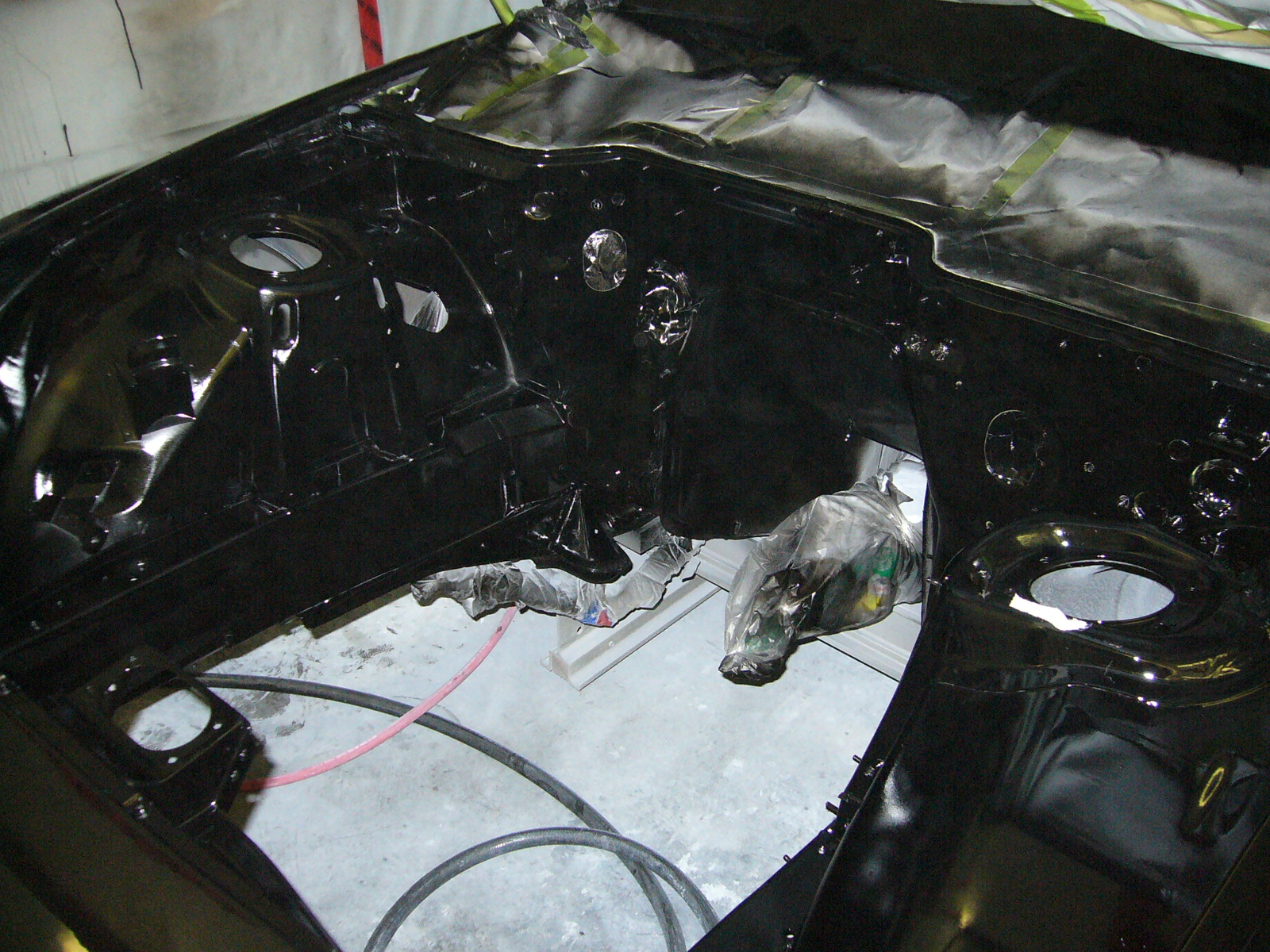

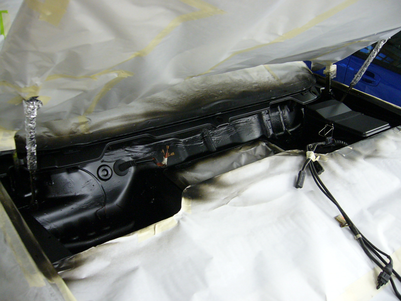

For the area behind the firewall, I had the idea to add the Glasurit gloss-reducer additive to make for a semi-gloss finish, which actually has turned out quite nice:

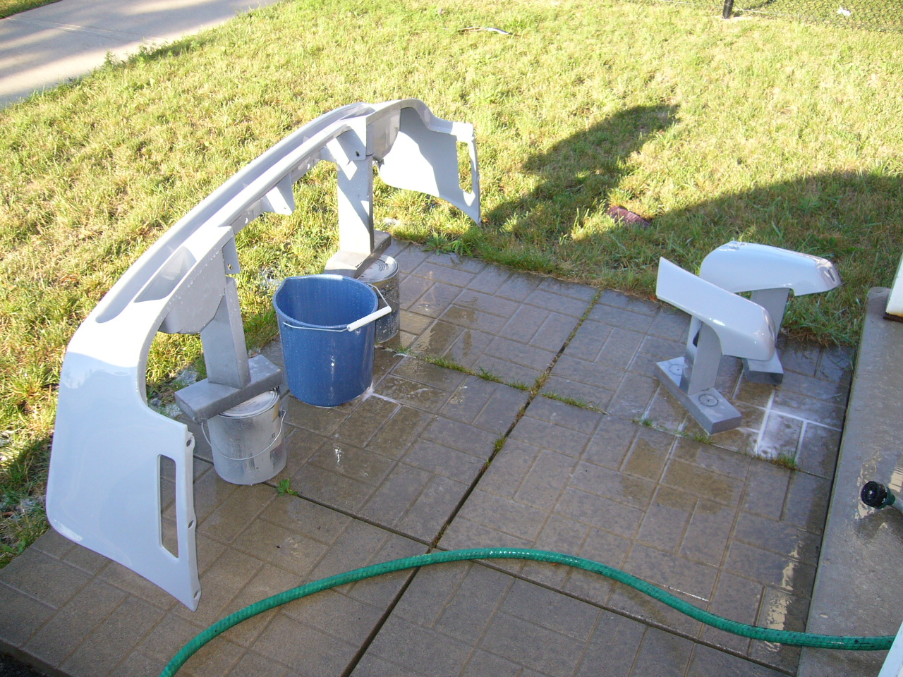

The plastic parts were painted separately as well, as they required an additional flex additive:

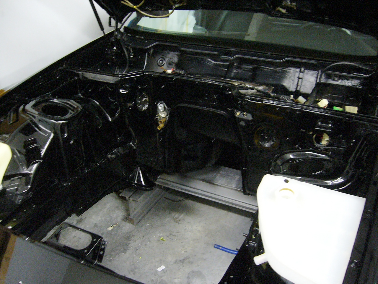

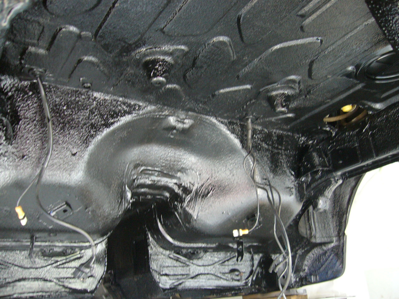

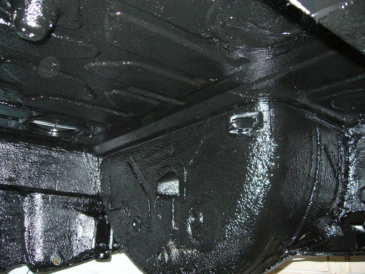

In between the paint-related work, progress was made in other areas. All of the rear suspension, transaxle, torque tube and fuel tank were removed. With all of that out of the way, I was able to refinish the underbody as well:

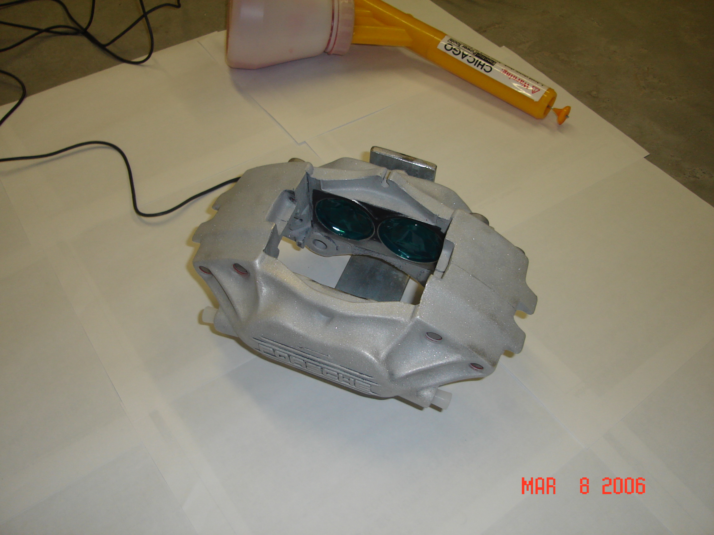

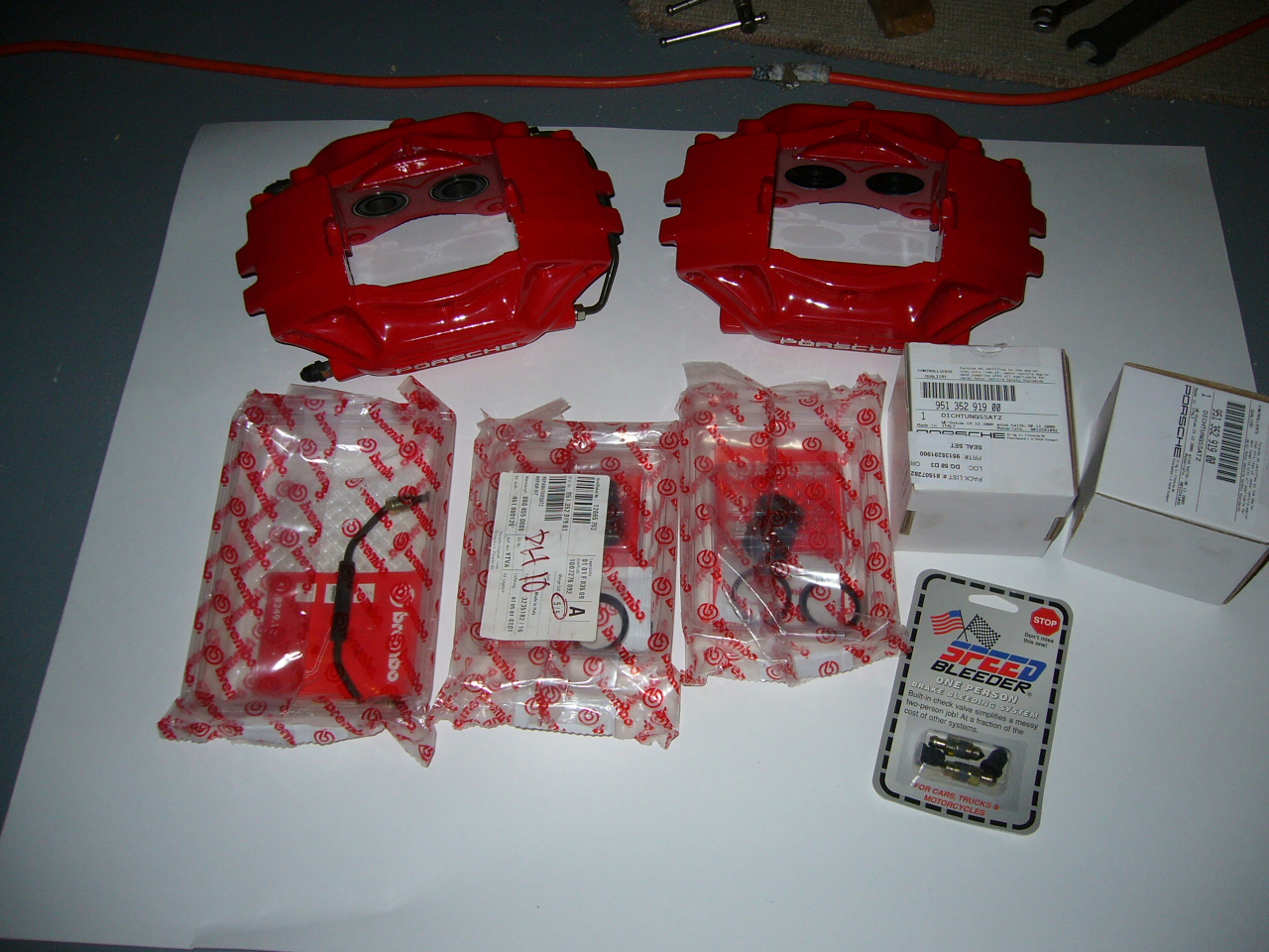

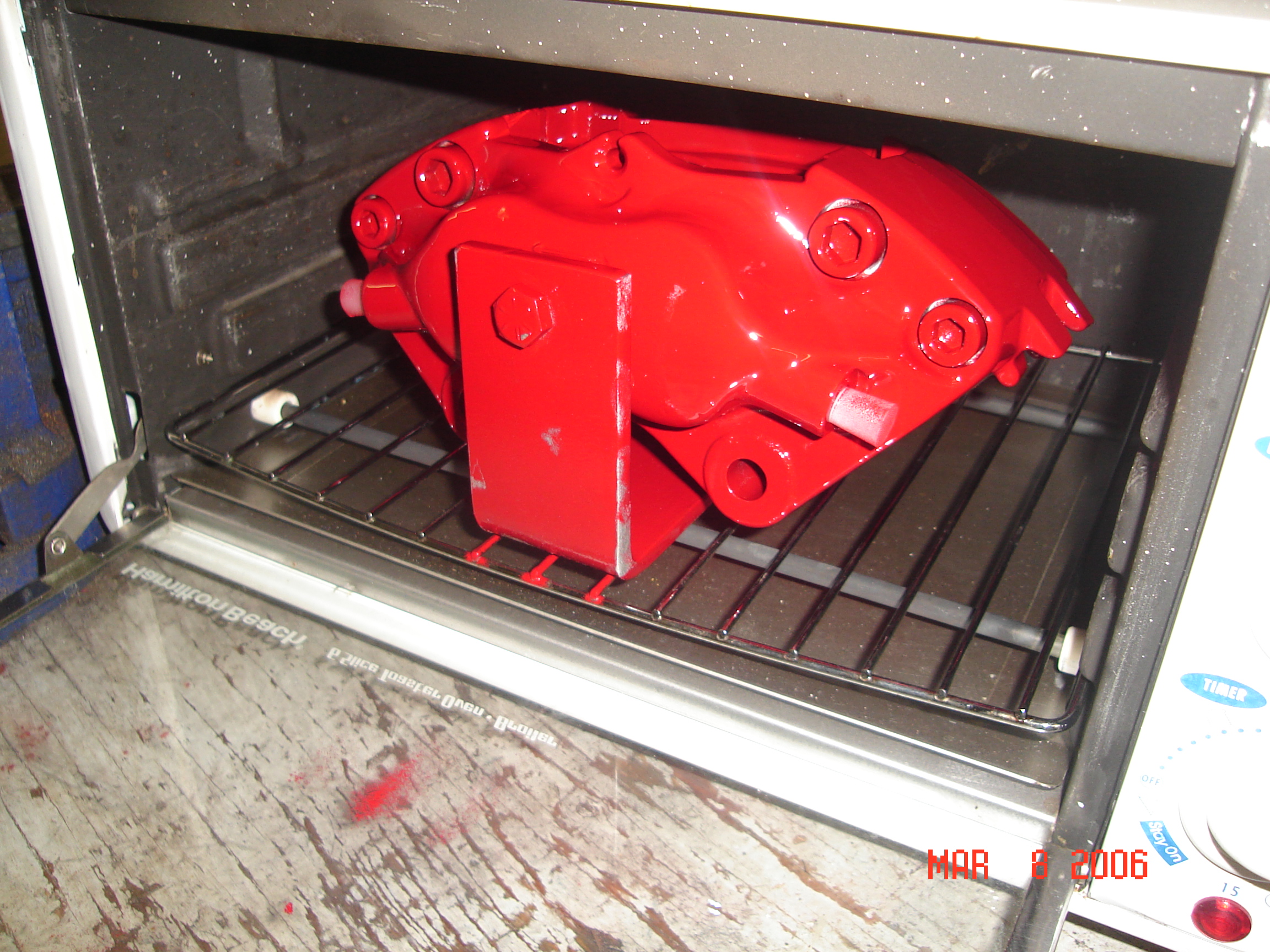

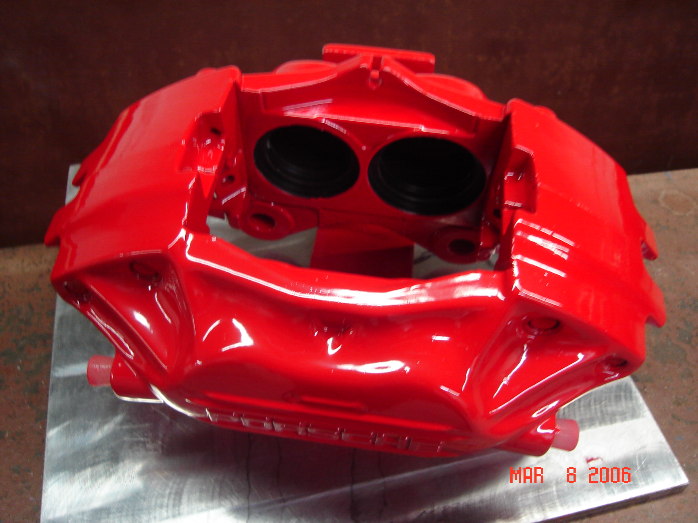

With everything being taken apart, it made sense to consider any modifications. One of the first items on my mind was brakes. I found a set of early 944 Turbo brakes on eBay to rebuild. They had been previously spray painted. Having a red caliper fetish, I wanted to powder coat them that color. I decided to powder coat them myself, having picked up an old toaster oven. Turned out to be a pretty easy and satisfying process. The hardest part was the prep.
Just to finish up on the brake calipers, I have since built them back up with new pistons and seals. Actually I only finished the fronts earlier this year!

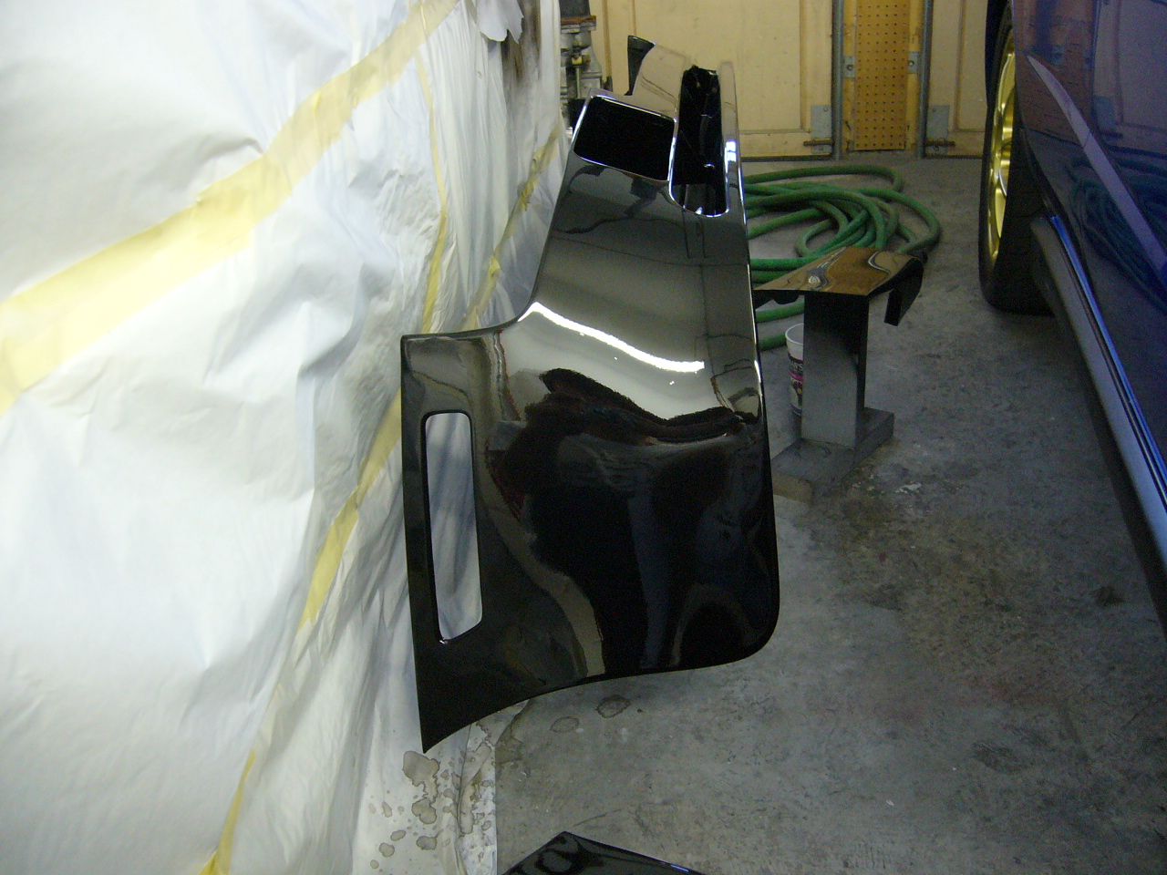

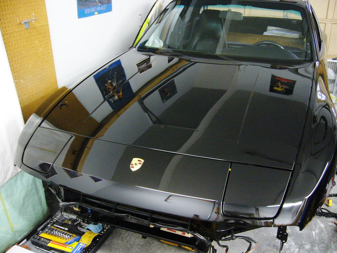

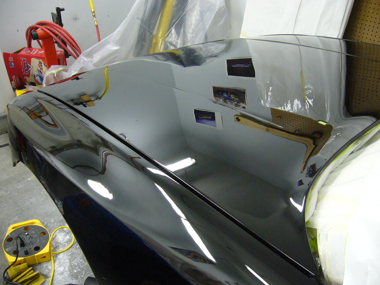

Despite the best efforts on the booth, there were still dust nibs in the paint, as well as a few sags and other imperfections. This allowed me to develop good ability in wet sanding, polishing and other paint repair techniques.
I have been able to get the paint to what I consider to be a high level:

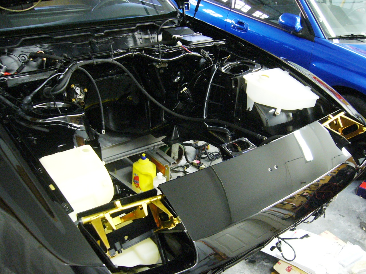

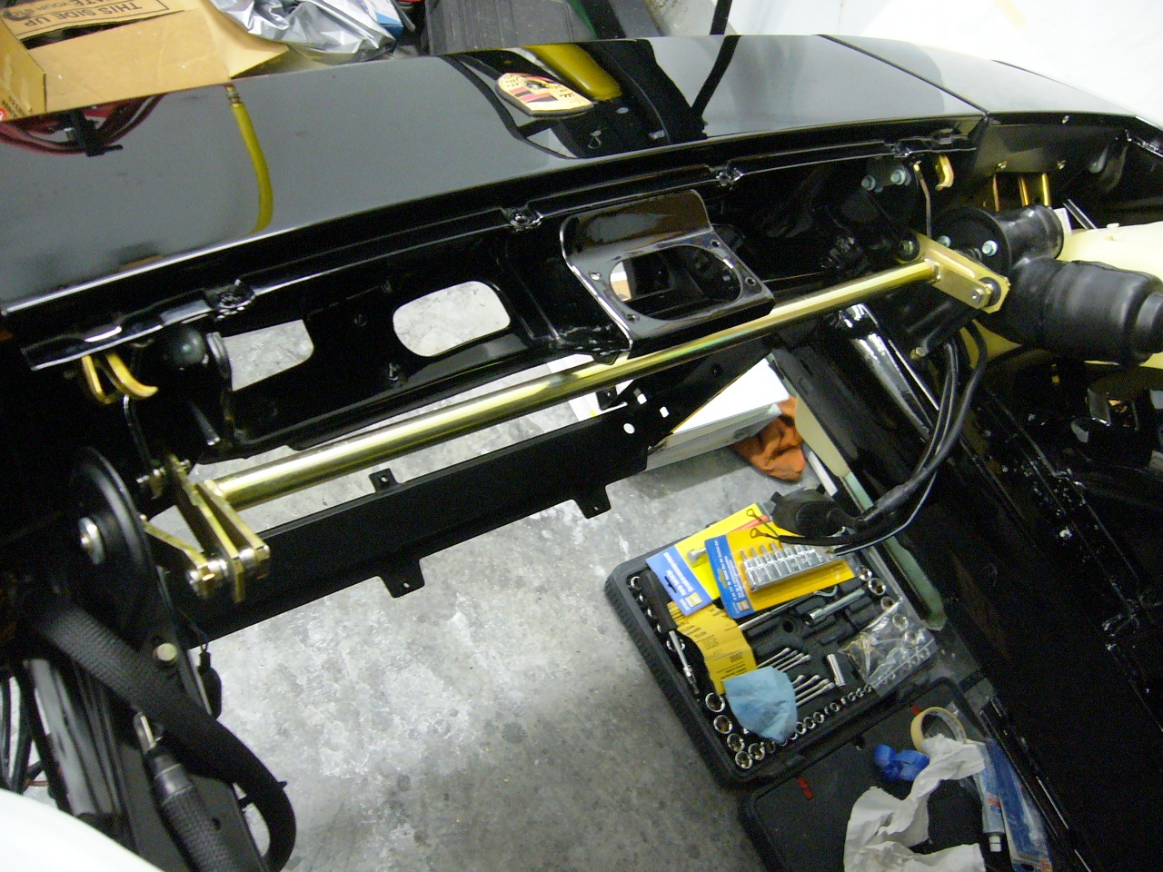

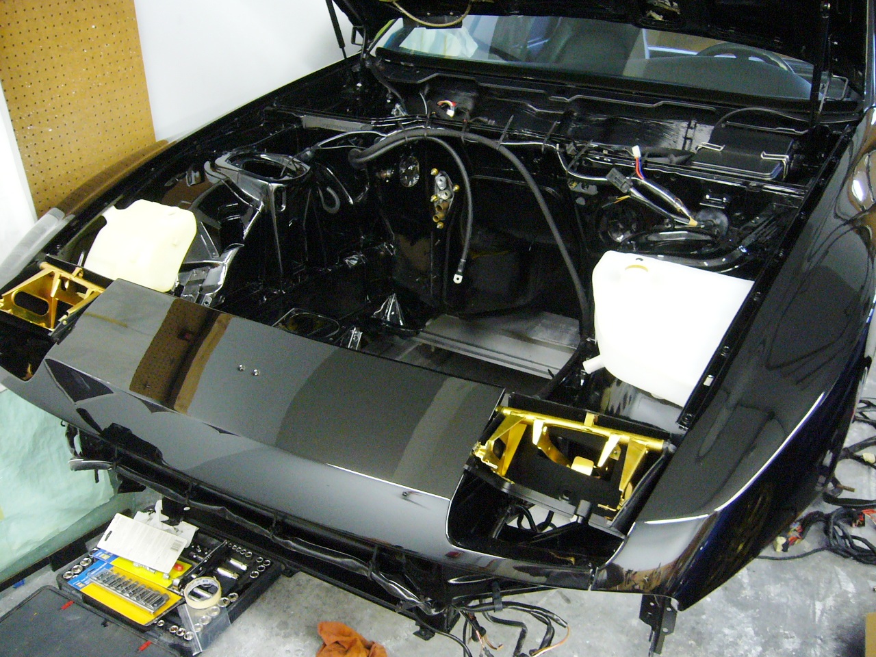

Once the paint was looking good, a few items could be reassembled. First was getting the front wiring harness in and the headlight mechanism back on. At the time, I was fortunate to find a brand new factory harness. Old and new:
Engine room just beginning to come back together:

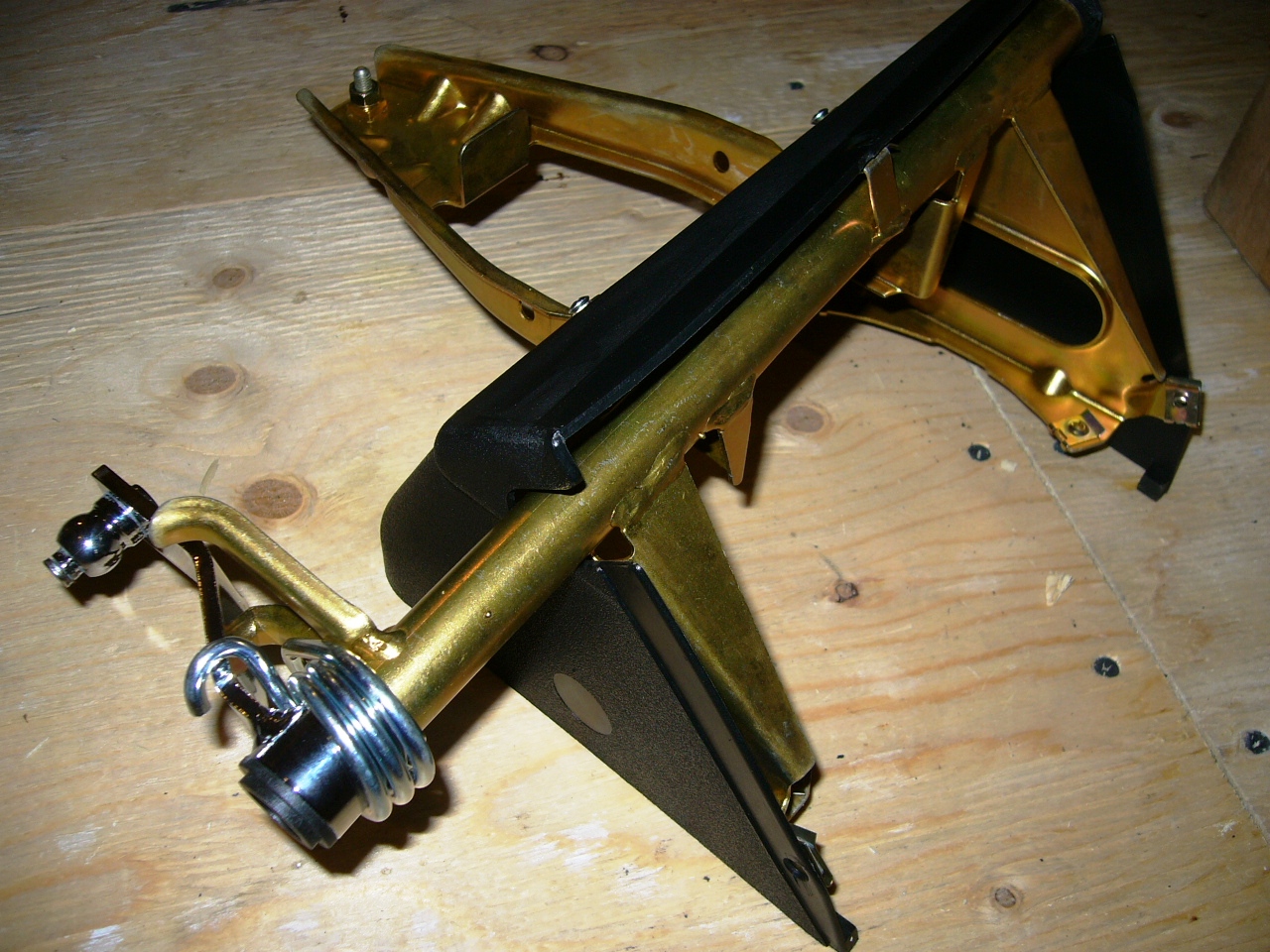

Many times over the years I have had batches of parts re-plated. Here the the headlight brackets coming back together:

One of the modification/improvement items I am fortunate to have is the "Iceshark" battery cable kit, which was the creation of Dan Wray (Iceshark on Rennlist) who sadly passed away very shortly after I purchased my kit. Mine must have been one of the very last. I emailed back and forth with him and he was very pleasant, so it was extra-sad when I heard the news (and as far as I know, it was completely unexpected). Some of the cables (with the braided sheath) from the kit are visible.

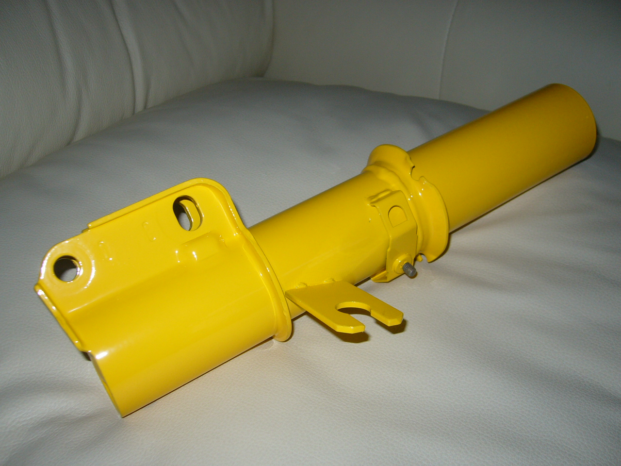

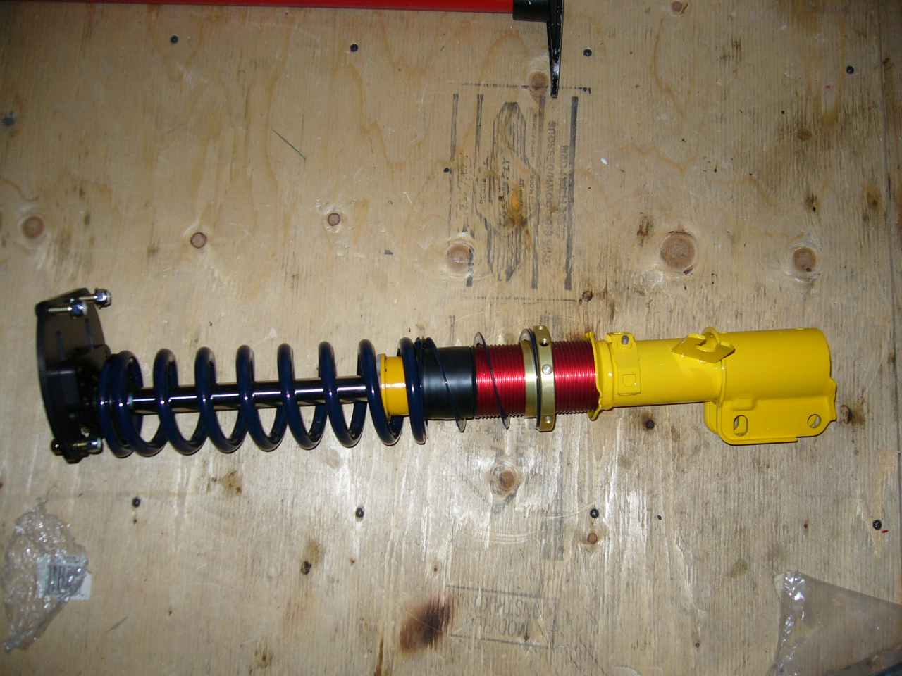

In between I started to consider what to do for suspension. I ended up going with the Paragon kit in which one modifies the OEM Sachs front strut housings to accept a Koni Sport insert and a threaded sleeve with a Hypercoil spring. I chose a pair of new torsion bars for the rear to match the stiffer springs up front. After cutting up the Sachs struts, I had them powder coated yellow:

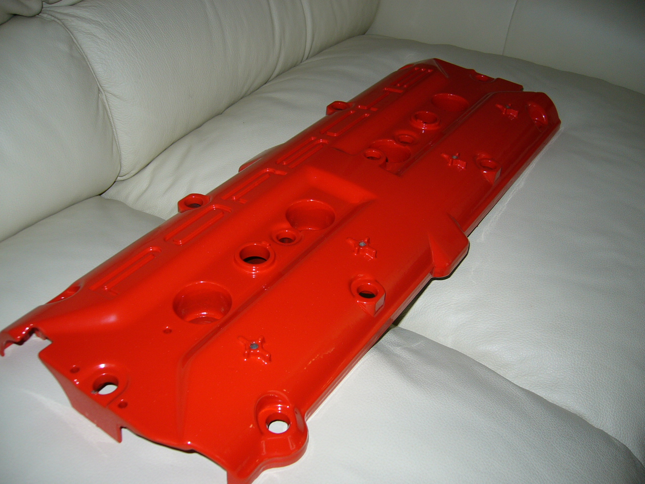

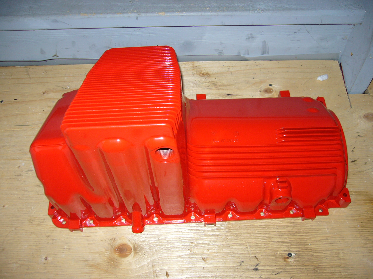

At the same time, I found larger sway bars from a Turbo and had them powder coated, along with the oil pan, valve cover and various other parts. These were all obviously too large for the toaster oven, so I outsourced them, though I did do the prep myself.
These are the struts. Initially I had chosen Ground Control camber plates (pictured here), but have since changed to OEM-style top bearings:
