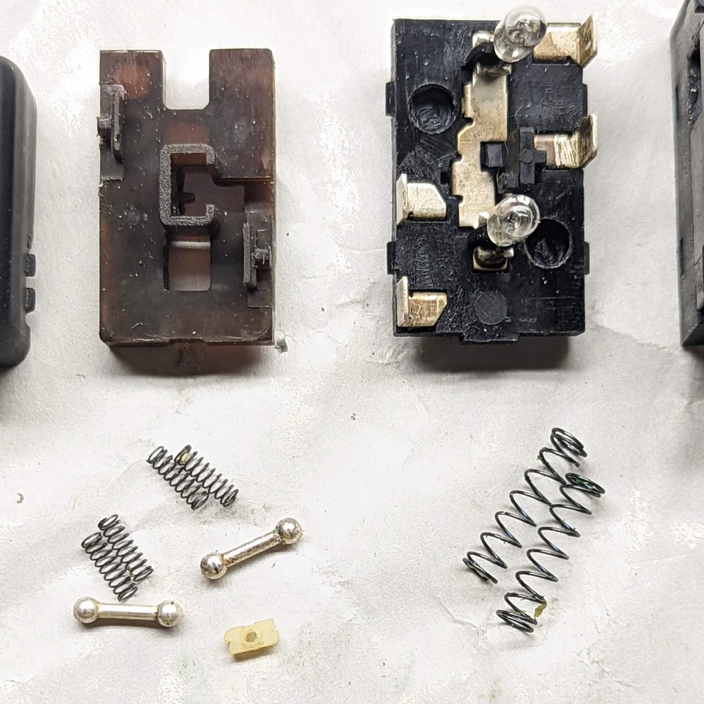

Snowflake Switch
Take care, this is an assembly with a high "boing factor"

Snowflake Switch Exploded
Small Springs and Conductive Bars
Conductor Barbells and Springs
