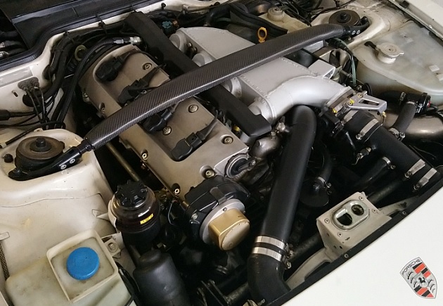

Here are the specs of my 3.019L 16V engine.
Bore: 104.5, Alusil
Stroke: 88
Pistons: Custom forged Mahle 16V turbo
Rods: Carrillo
Block/Crank: 968, closed deck
Head/cam(s): 968
Turbo: Garrett GTX3582R 1.03
Engine Management: Pauertuning's Vi-PEC/J&S set up with NGK U5015 COPs.
Other: Lightened TTV 60-2 flywheel, Tial 38mm MVS WG, LR full 3" exhaust, Bosch 044 fuel pump, KEP St. 2 PP with 930 disc, 4FF 16V intake, Audi 20V TB, Custom intercooler with @Tom's custom IC pipes.
