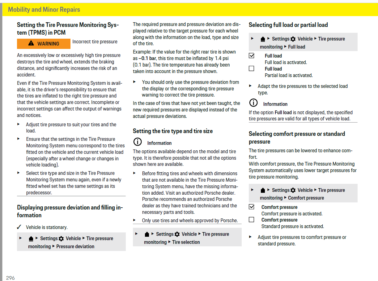

Does anyone know if switching over to 'comfort' pressure is a user-selectable setting -- or is that something the dealer has to do? My dealer tech told me he set my car to 'comfort' pressure (so that the tpms thinks 36psi is enough) but I'm not finding that setting...?
- Posts: 6089
- Has thanked: 4436 times
- Been thanked: 2411 times
It's on p296 of the 992 Owner's Manual.
- Posts: 8926
- Has thanked: 932 times
- Been thanked: 3994 times
Thanks Tim. The manual: who would have thought to look there.
I'll have to go back and look again -- I was right in that area of the menu and couldn't find it.
