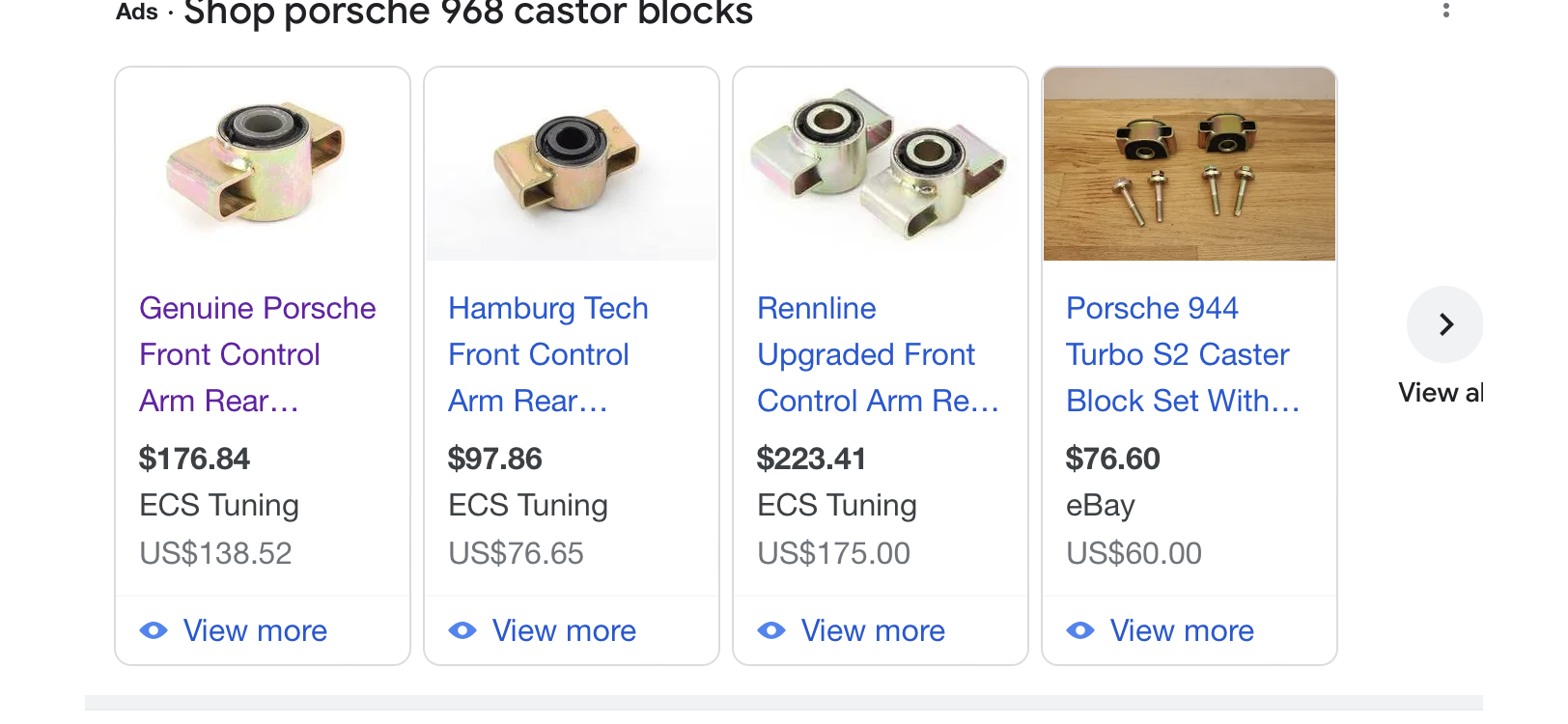

“Per Porsche TSB Group 4, Number 9303, 968 type caster blocks are required when running 17" wheels. The TSB also says to use new eccentrics and nuts.”
So I copied this link with a picture also. I have had Elephant racing castor blocks so I never searched for them. However as I am building Soloracer’s white 89 turbo his need replacement since they are original stock parts.
https://www.ecstuning.com/b-genuine-por ... gKp_fD_BwE

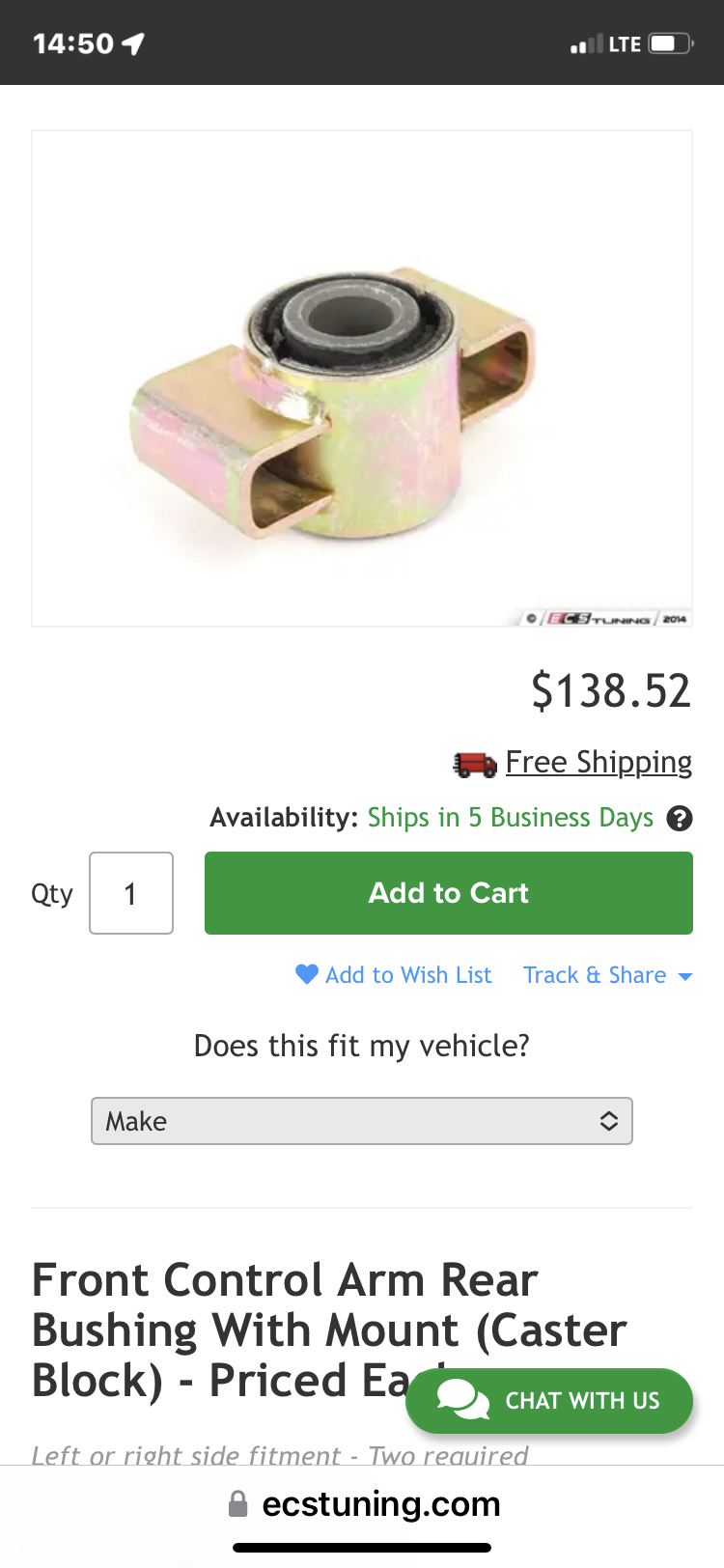

That price from ECS is a bit rough! it's only $100 direct from Porsche. Or, get the Elephant Racing version for $40 each like the OP has.

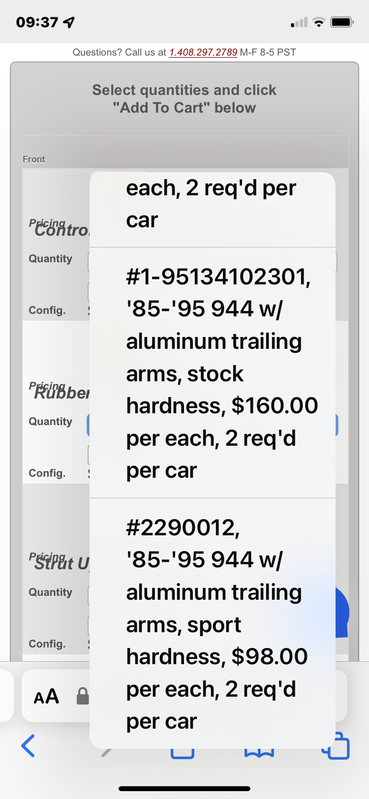

They are 160.00$ at elephant racing
Or 98.00 for sport hardness
The 40.00$ ones are for steel control arms

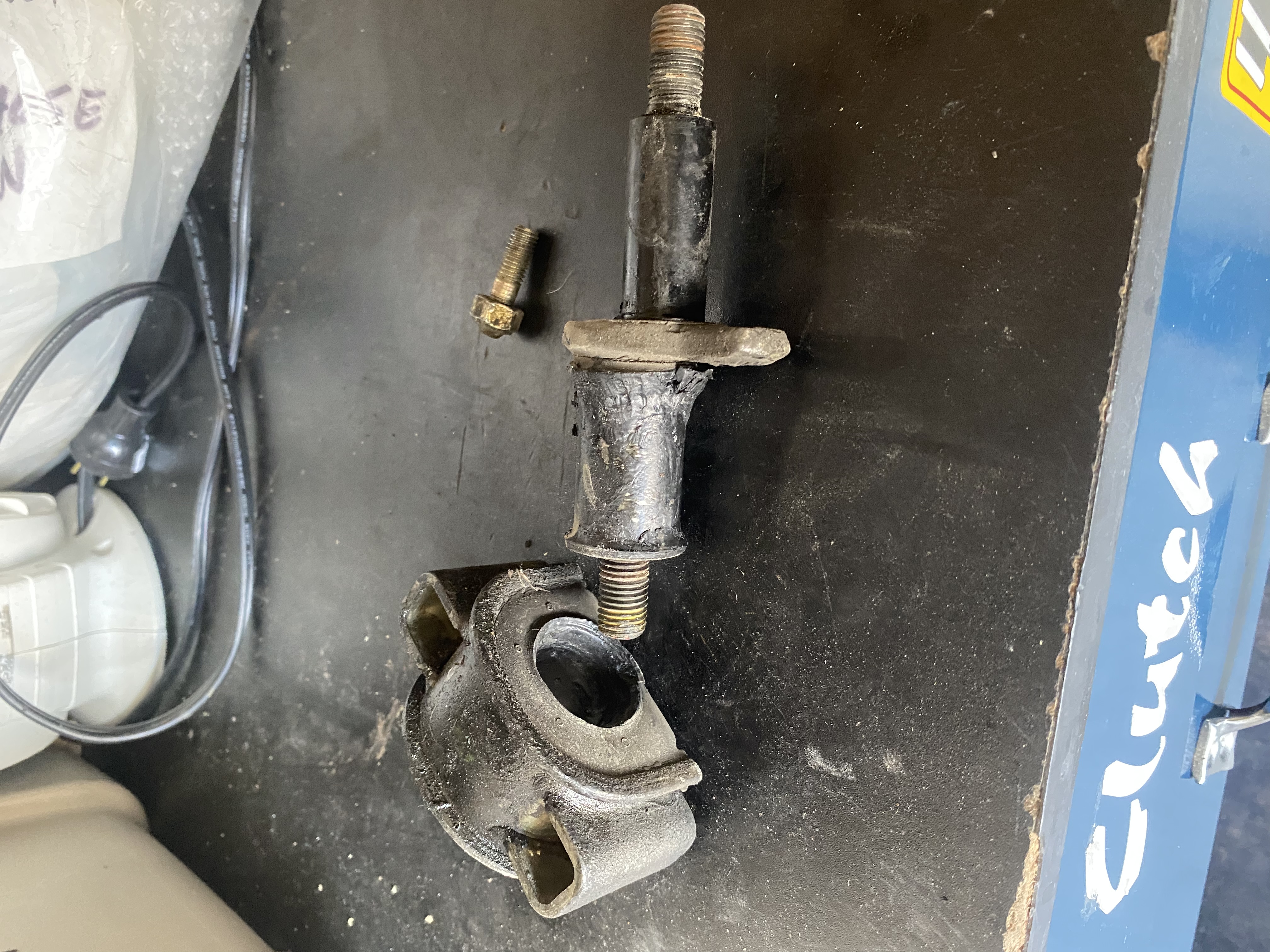

It really only caught my attention due to me needing to replace this for Erik’s car.

Much cleaner.
Now bushing removal and ball joint cleanup.
