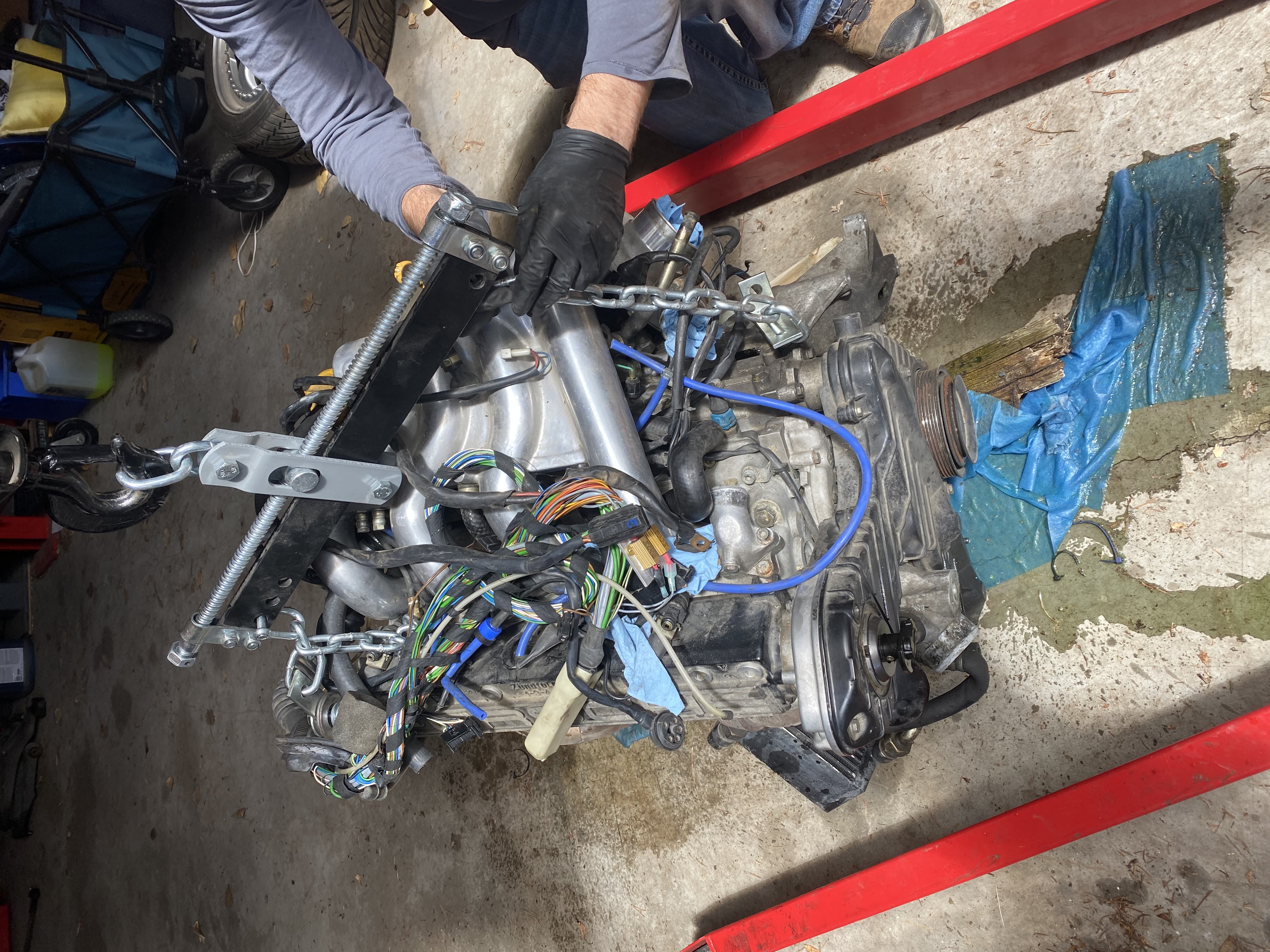

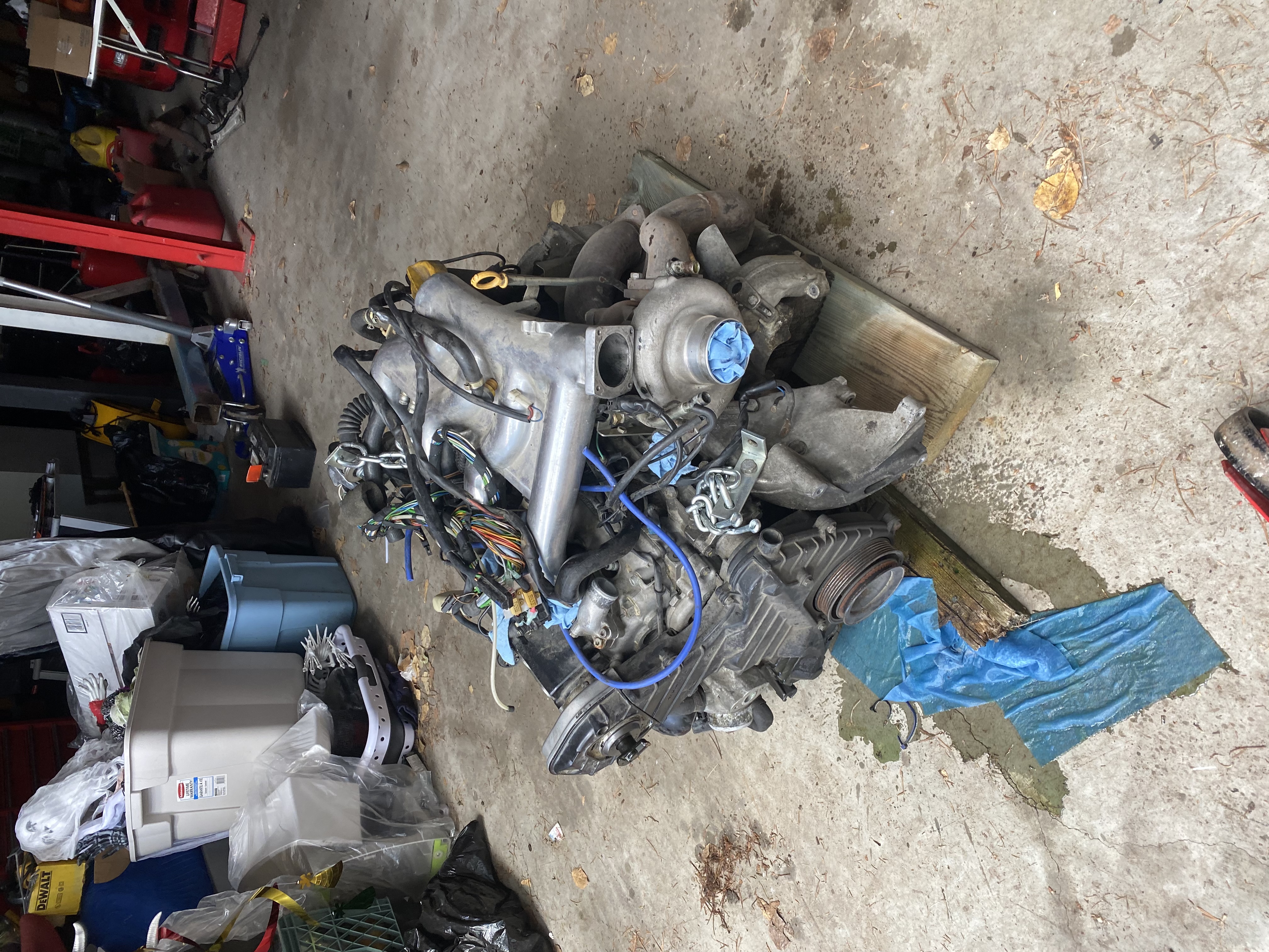

I just pulled the motor out of Soloracer’s 1989 944 turbo.
Lifts make things so much easier.
Rebuild time, cleaning and plating.
Getting closer to building all the engines together.
My 3.0L, my 2.8L stroker and 2.5L
Soloracer’s 89 stock block
And his 86 block in the pics.

Looking good. Motor actually looks pretty clean -- was something wrong with it?

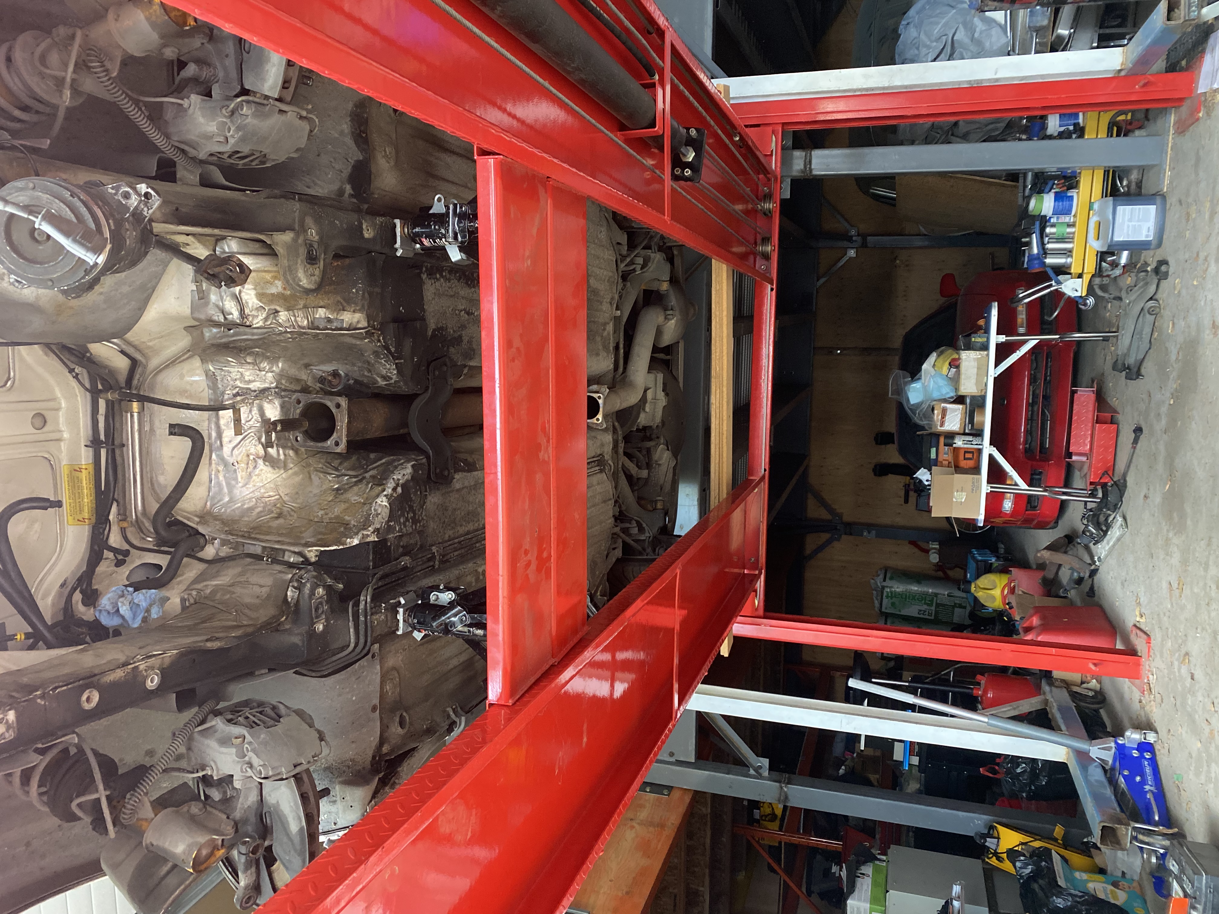

I have not yet pulled a motor now that I have the 4 post list. Did you use the cherry picker to set it on the floor then lift the car up and off of it?

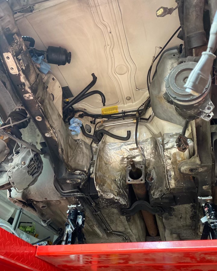

Yes
I used my engine hoist to lower it onto a couple 2x8’s on the ground.
Then moved the hoist out of the way and raised the lift.
Motor developed what he thought was rod knock.
I found metal on the magnetic drain plug so we will see.

Dropping the motor out the bottom is much easier than pulling from top.

The engine was dropped out the bottom 👍
When I raised the lift that was the car lift not the engine hoist

How long does it take with the 4-post lift? I have a similar lift in my garage and would love to reseal my engine - I have oil leaks seemingly everywhere.
