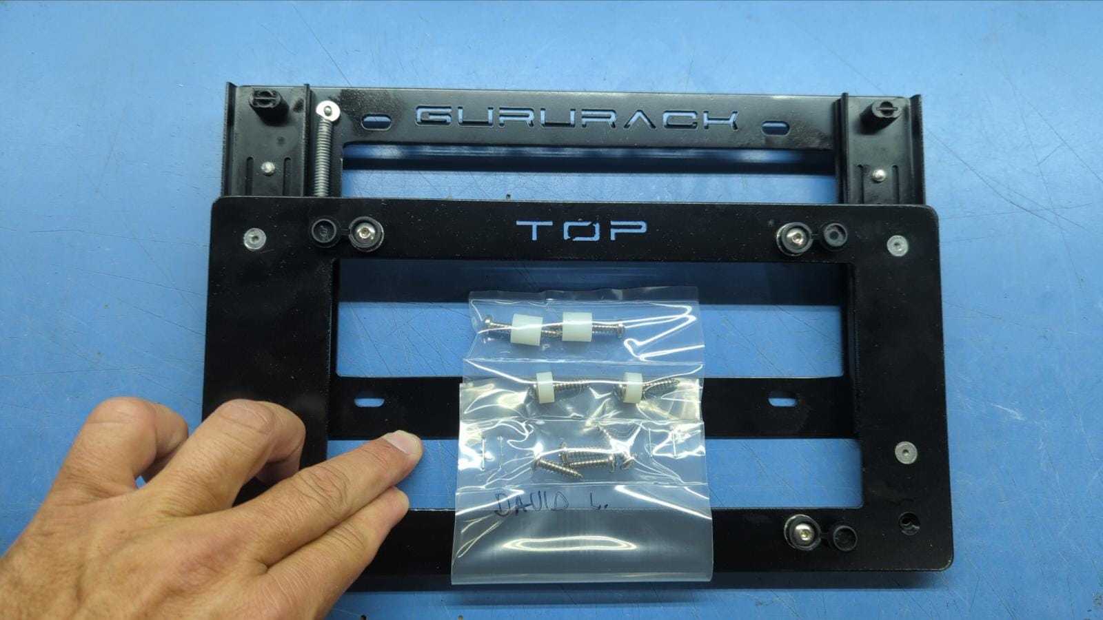

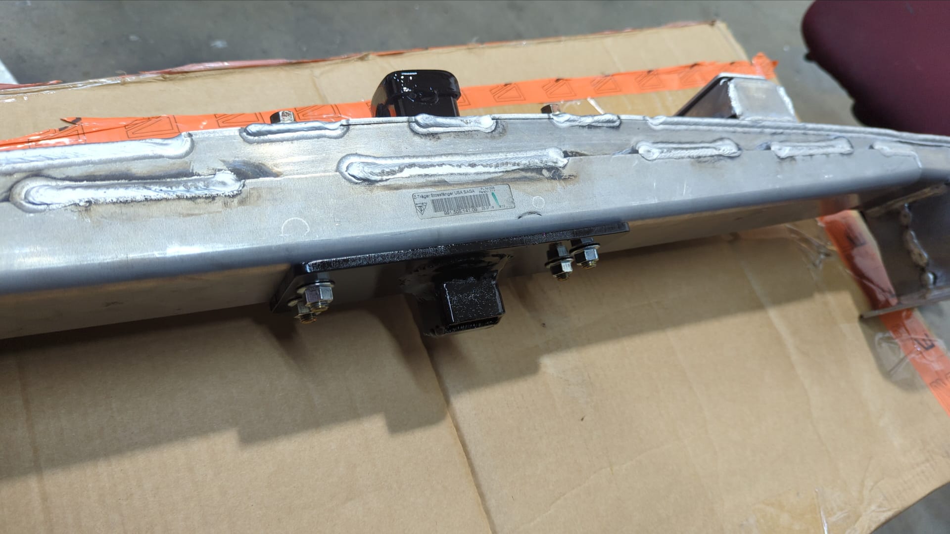

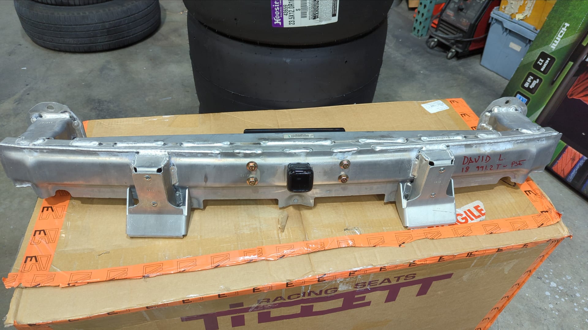

Ok - I’m sure some will balk at this but I am an avid mountain biker and this is my daily driver. I have roof racks and they are a pain. Found a solution for a hidden hitch behind the license plate. Ordered this - www.gururack.com from Miami - worked with Oliver. Being shipped to me now.
Steps will be to get the new modified rear bumper and swap with the one on my car. This was done with a core for a 991.2 rear bumper bar.
This was the only way I got my bike to a ride - looking forward to the new way.

Cost was 800 (700 for a self-install) and the core fee was 250 - or you could supply your own. Upon return of the core you get back the 250. Also - about 200 in shipping 2 ways. Would save quite a bit of money if you were local to Miami, FL.

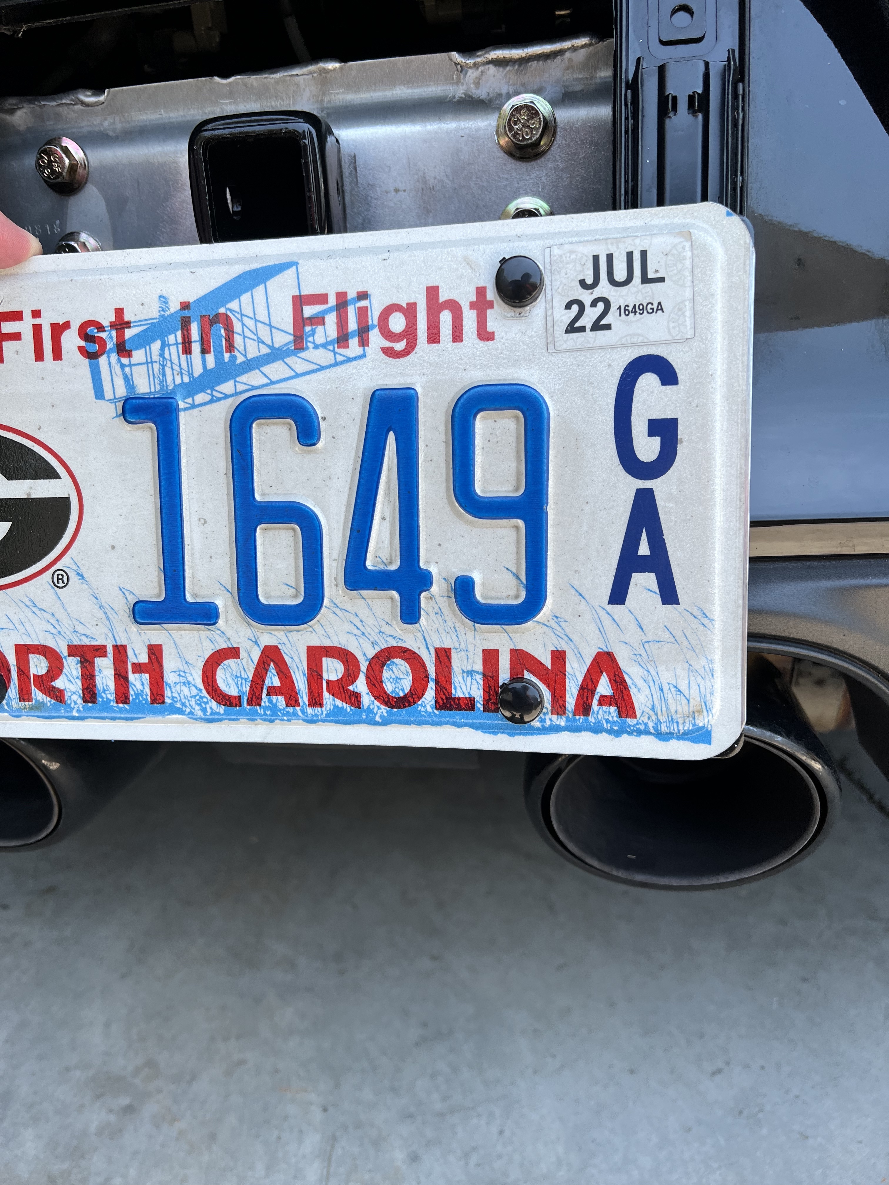

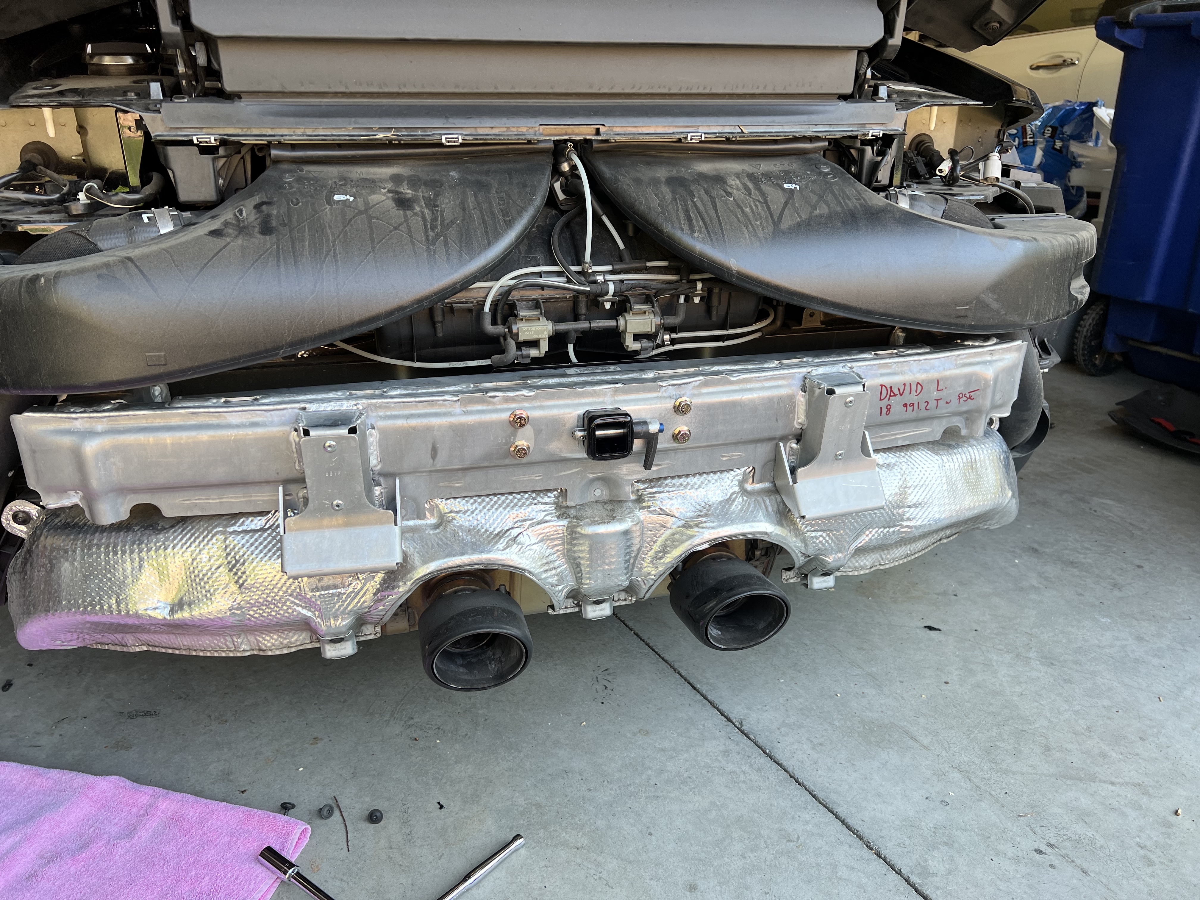

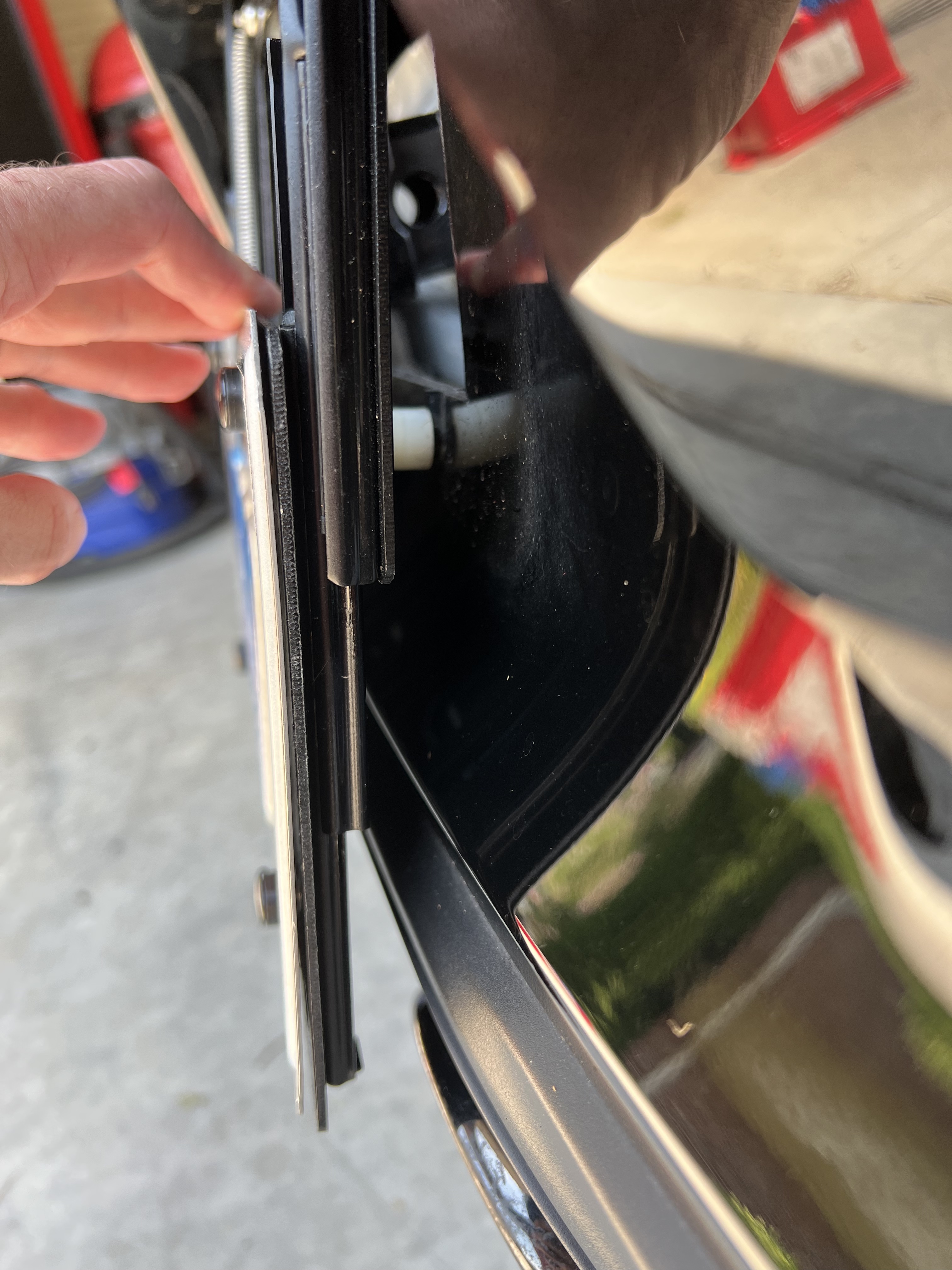

Okay everyone - so I have the hitch installed - I did this myself - took about 3.5 hours - main work was removal of the rear bumper. Now that I know how would probably take me more like 2 or 2.5 hours. Already returned the core and received a prompt refund of the core deposit. Oliver was great at communication - responded quickly - even on the weekend and called me to make sure I understood what I needed to do - great support!
PM me if questions or can direct to www.gururack.com - Oliver is very responsive!
Here are some photos:

Correct - they supply the hitch receiver - then you can mount you hitch bike rack - I will be using a OneUp Rack. Since I did this my self I was all in for 700 plus the 2 way shipping - another 180 - so 880. And - yes if you don't own a rack you will also need to buy one.

I know it’s not intended but can it pull a small trailer for track spares (tires, Jack, etc)? Also does this take the place of the rear tow point?

Yes - I intend to use it that way for a track day. I have a hitch pin and was thinking I could pull a small trailer to hold a set of race wheels and some tools. But - really small! In terms of rear tow point - yes - this did remove the rear tow hook behind the license plate - so for the track I think you could insert the hitch pin so you have a rear tow hook.
