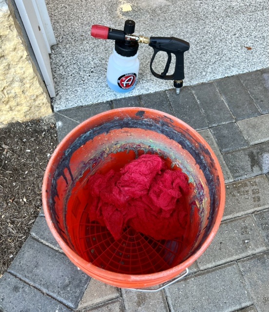

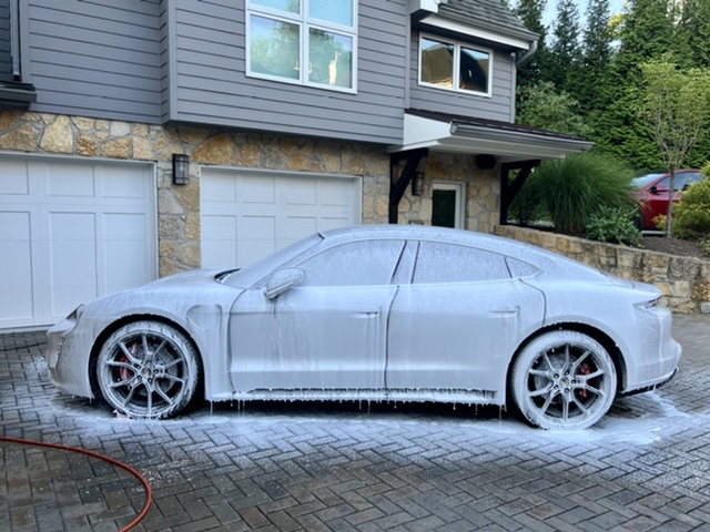

2. Thoroughly rinse then wash the car using the method of your choice. Many people like the 2 or 3 bucket method where there is a soap bucket and a rinse bucket with a grit guard on the bottom to agitate and clean out your wash mitt between panels. After watching Larry K from Ammo NYC, I have moved to use 8 thick microfiber towels in my soap bucket and change towels between each section. I usually use one on the roof, one for the hood and front fenders, one for the bumper and aero bits up front. Two towels per side, washing from the top down to the side skirts, and then 1 for the rear of the car. The towels get wrung out and placed in my old rinse bucket to keep them out of the way till I wash them. I prefer using an electric power washer and a foam cannon. Pick your poison for soap but I keep coming back to Chemical Guys Snow Foam. Reasonably priced and makes a ton of suds. (I used Adams shampoo on the Taycan since I had some left)

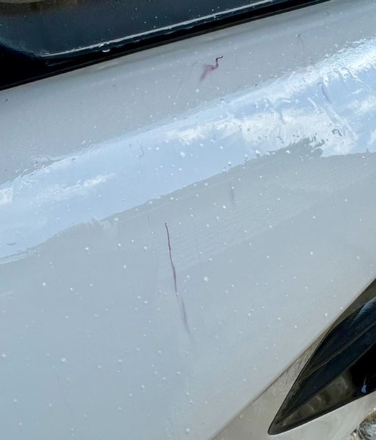

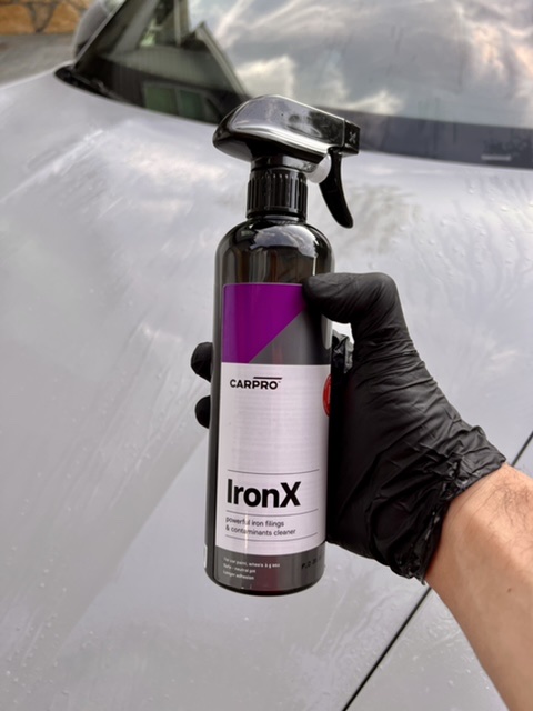

3. After the car is washed and rinsed, you may want to “decontaminate” the car next. I used CarPro Iron-X to remove embedded iron particles in the paint. This can happen from brake dust, rail dust if the car is transported via train, etc. You rinse the car well after the wash and then liberally spray Iron-X onto the paint and let dwell for 3-5 mins. You will probably see little purple spots as the iron particles react with the Iron-X. I then used another soapy microfiber towel to quickly wash the Iron-X and contaminants off the car followed by a good rinse

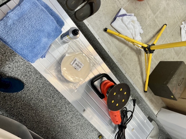

6. I pull the car into my garage and inspect the paint. The chalk paint on my car was in great shape with very minor swirls scattered about. I felt a single-stage polish would take most of them out and get the paint ready for PPF. Since I was going to be using CarPro Cquartz UK 3.0 ceramic coating after the PPF was done, I used their Essence Plus polish and white gloss pad. Easy to apply using my random orbital polisher and came off easy with multiple microfiber towels. The car looks amazing after.
