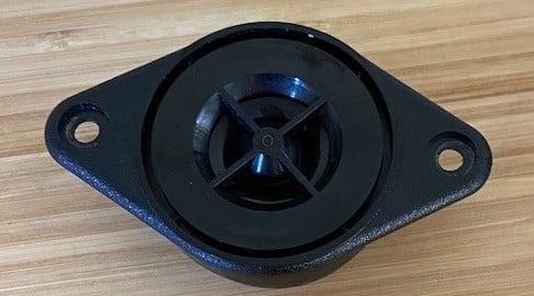

Darwin -- do you have a picture of the tweeters you need? I can venture into the wilderness of my shed and see what I have...

I think this is what they look like. I can't say for sure as I've never had stock units and I haven't ever looked for photos of themTom wrote: Wed Jul 28, 2021 4:56 pm Darwin -- do you have a picture of the tweeters you need? I can venture into the wilderness of my shed and see what I have...

is that front or back?

If my research is correct, on a 944 it's the same front and back. I have never seen a picture of a rear tweeter removed from the c-pillar trim so I cannot confirm, but from the rear they appear to be the same.
