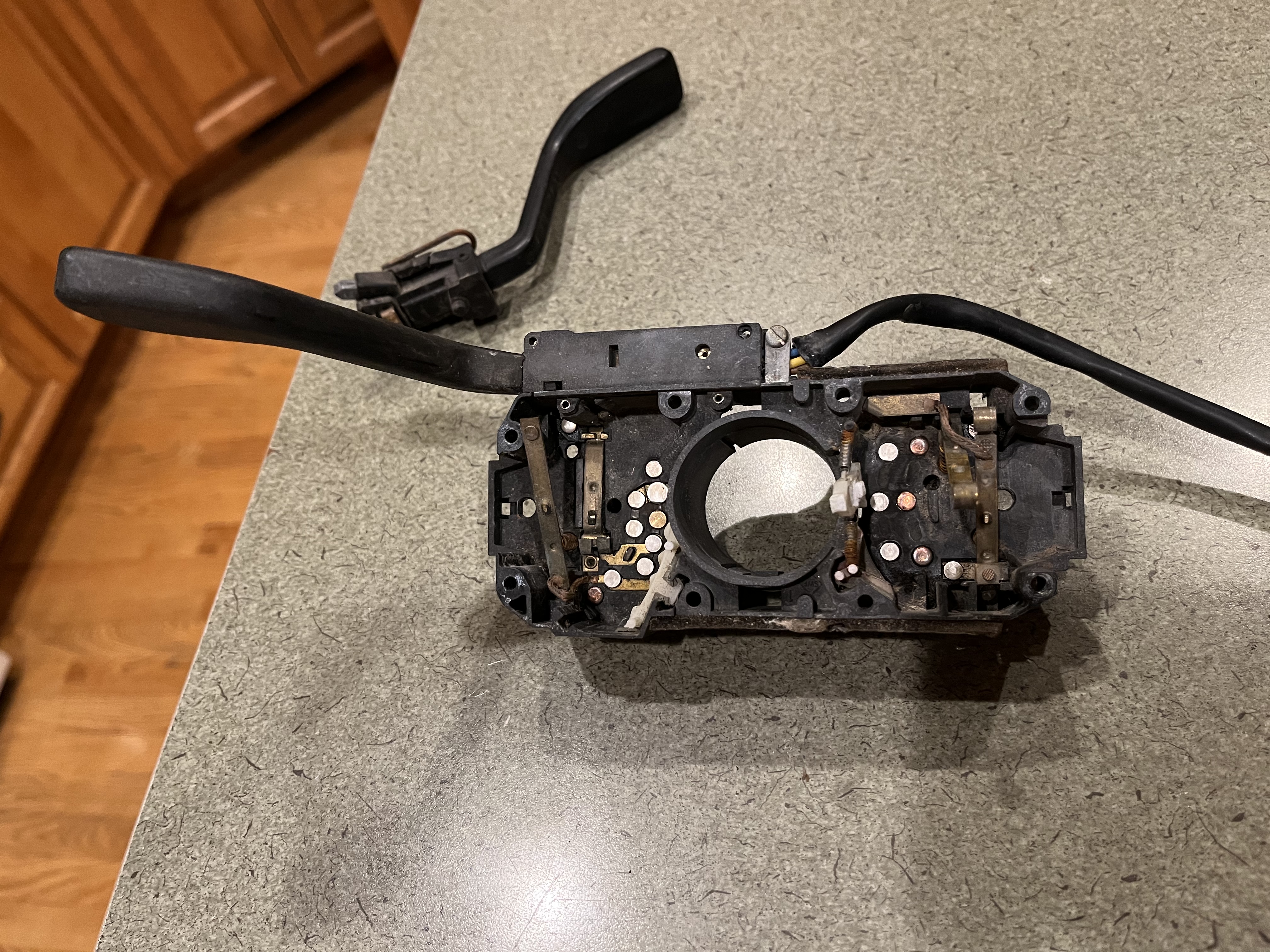

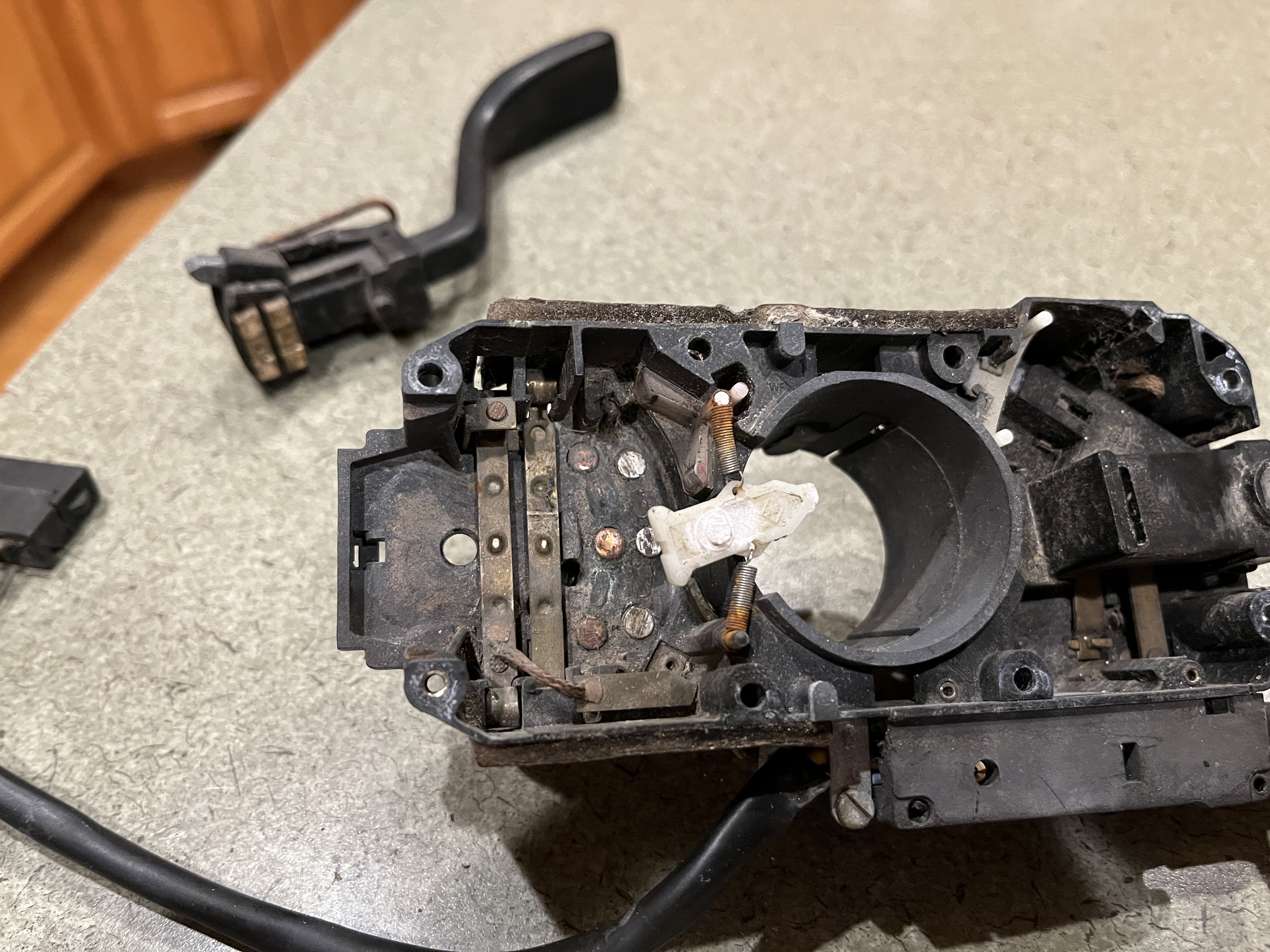

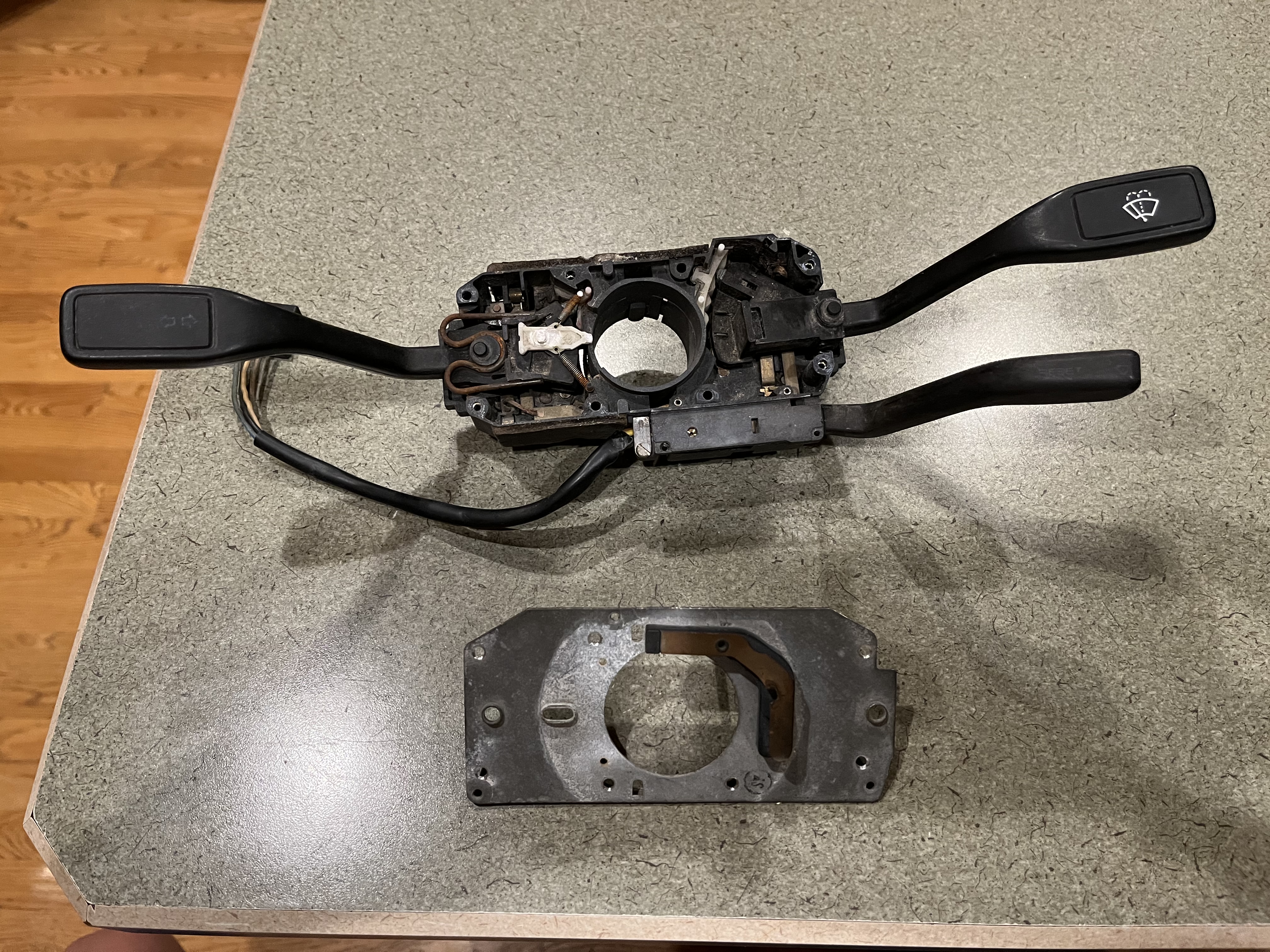

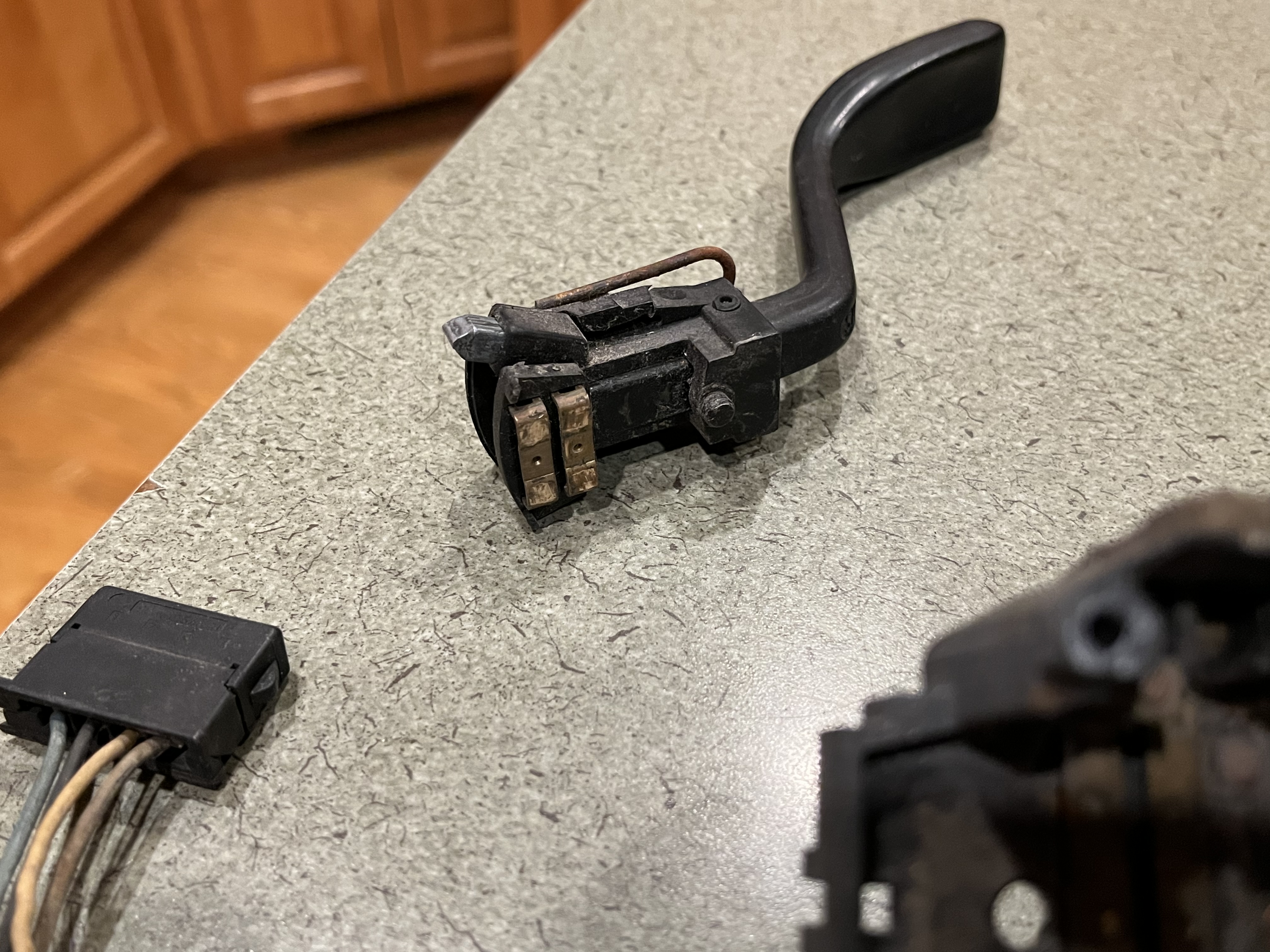

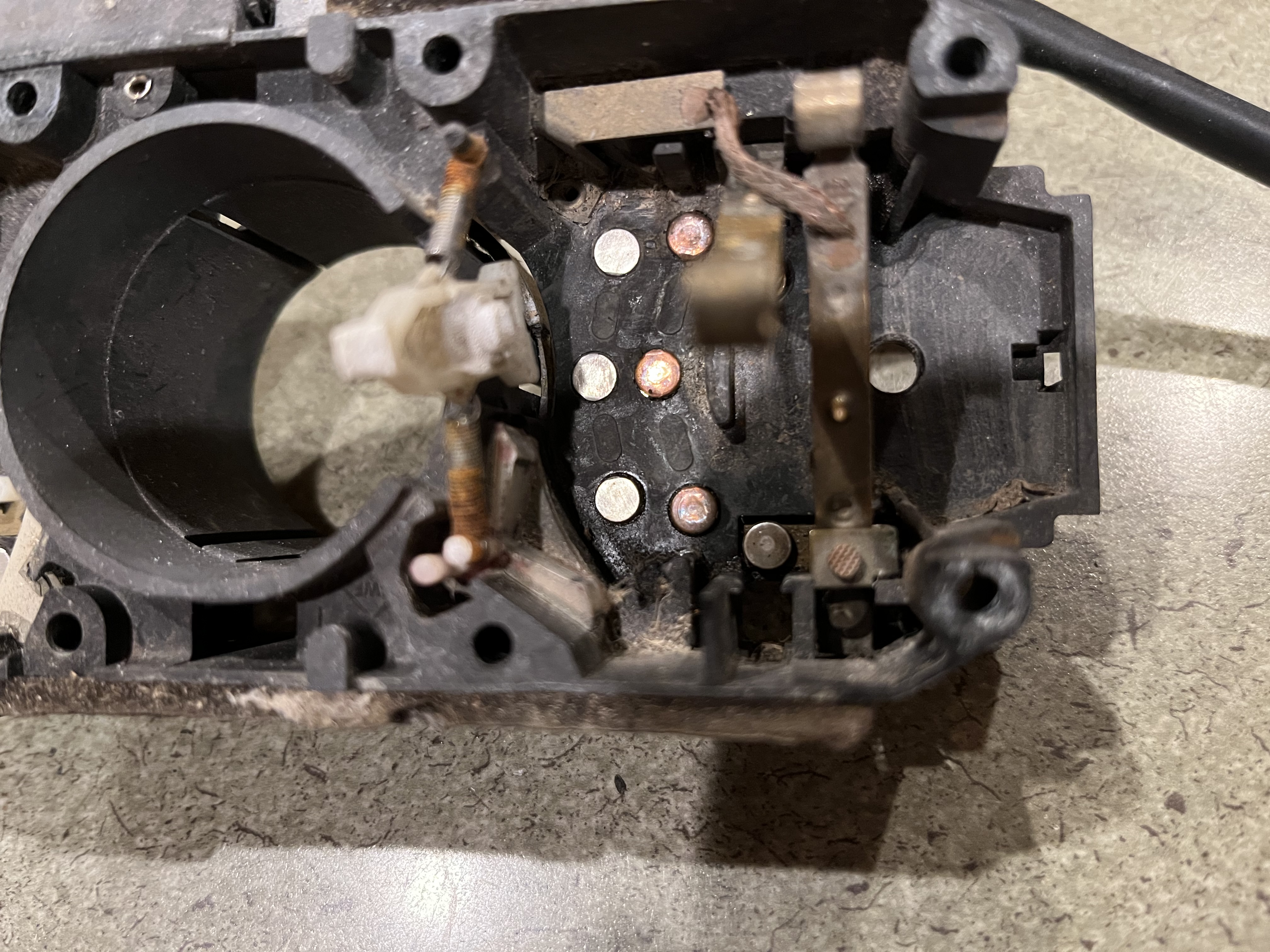

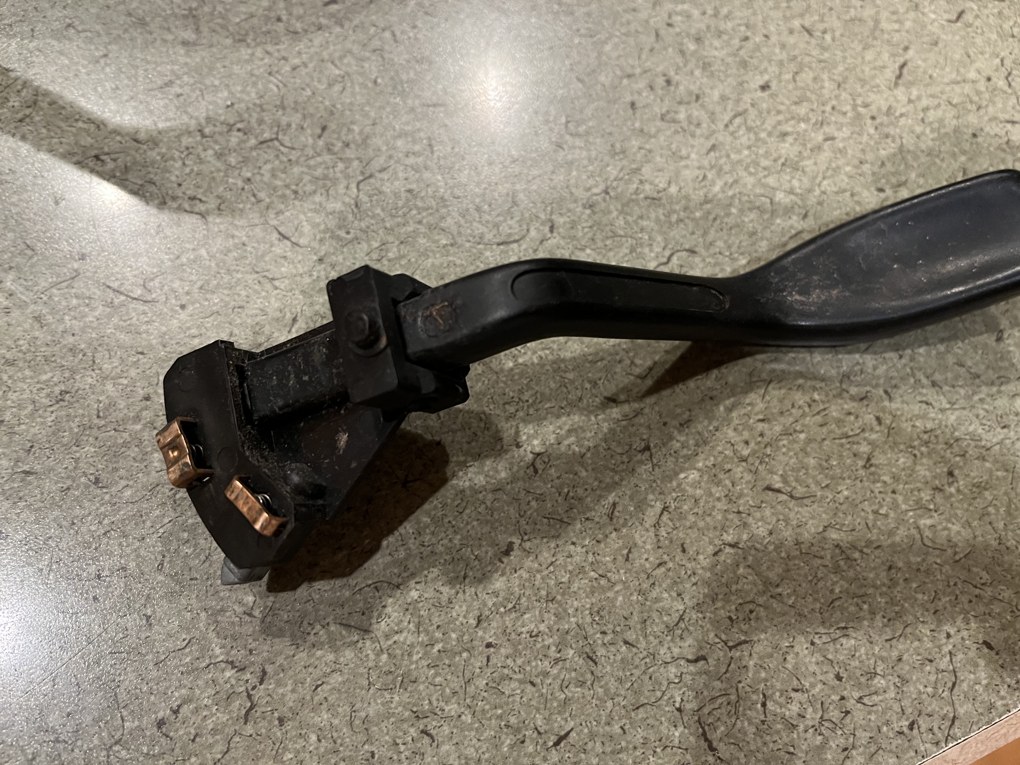

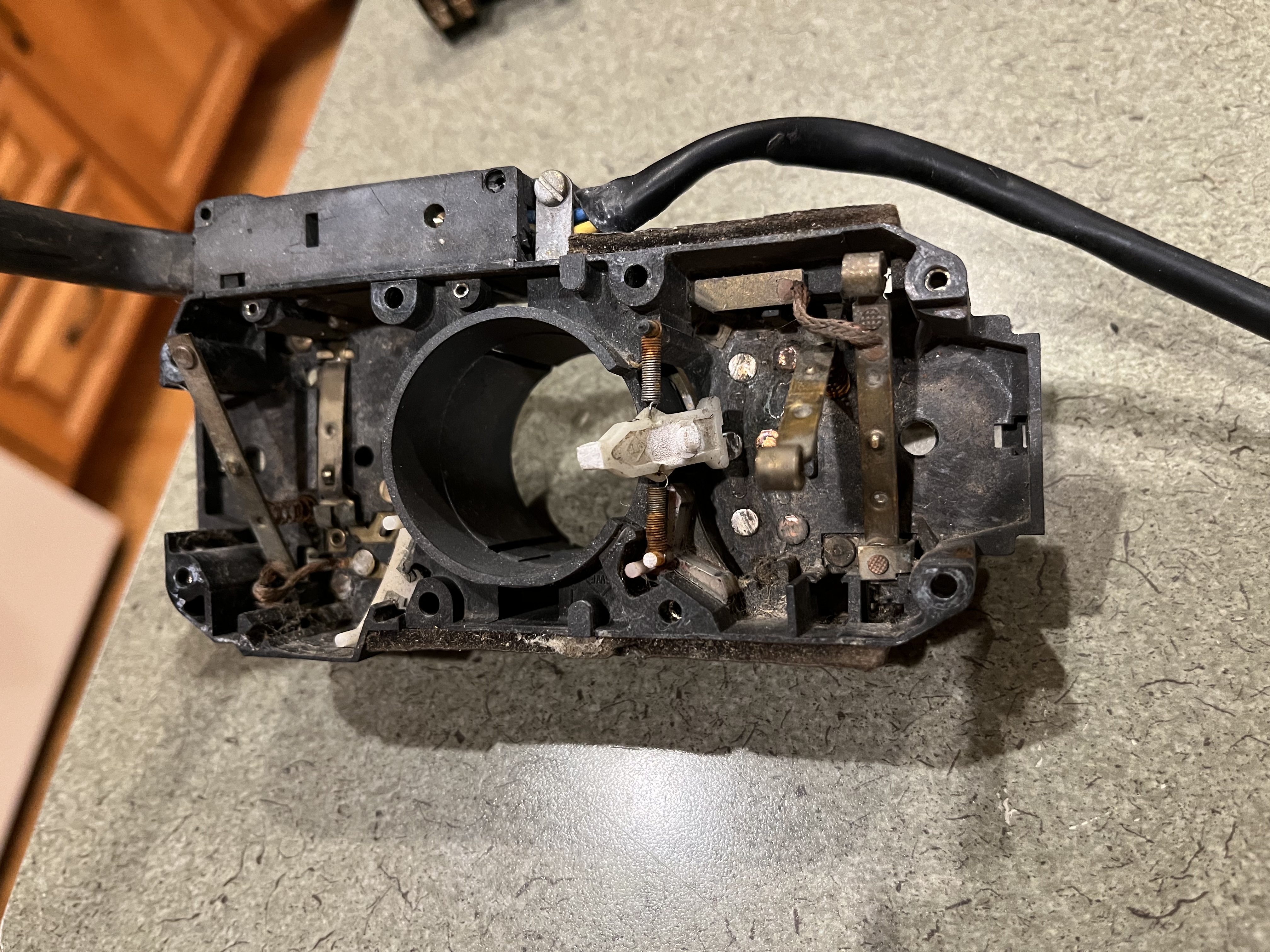

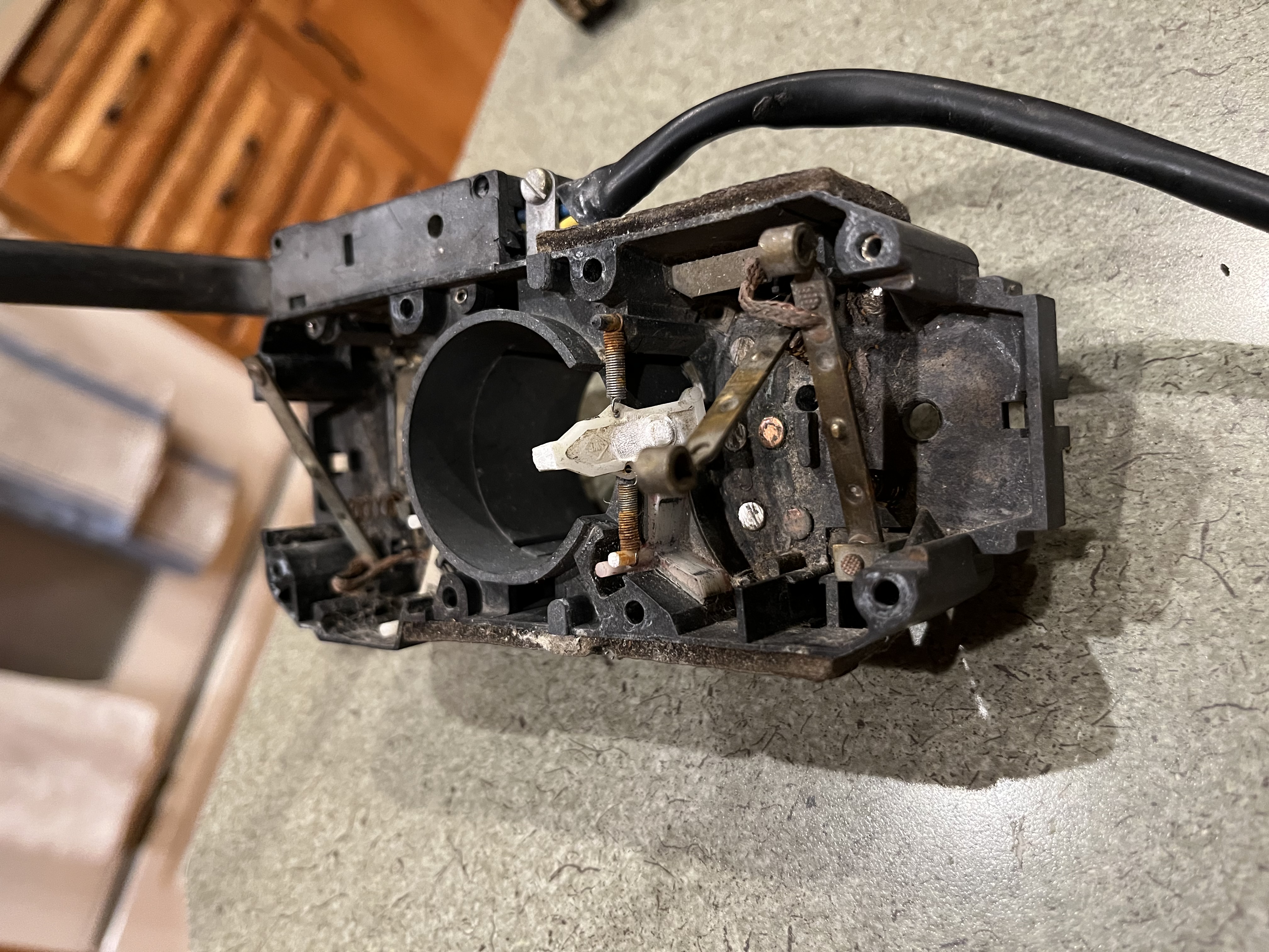

well, I decided to just tear into the spare combo switch to see what the insides look like. here are some pictures from before cleaning the contacts and after:

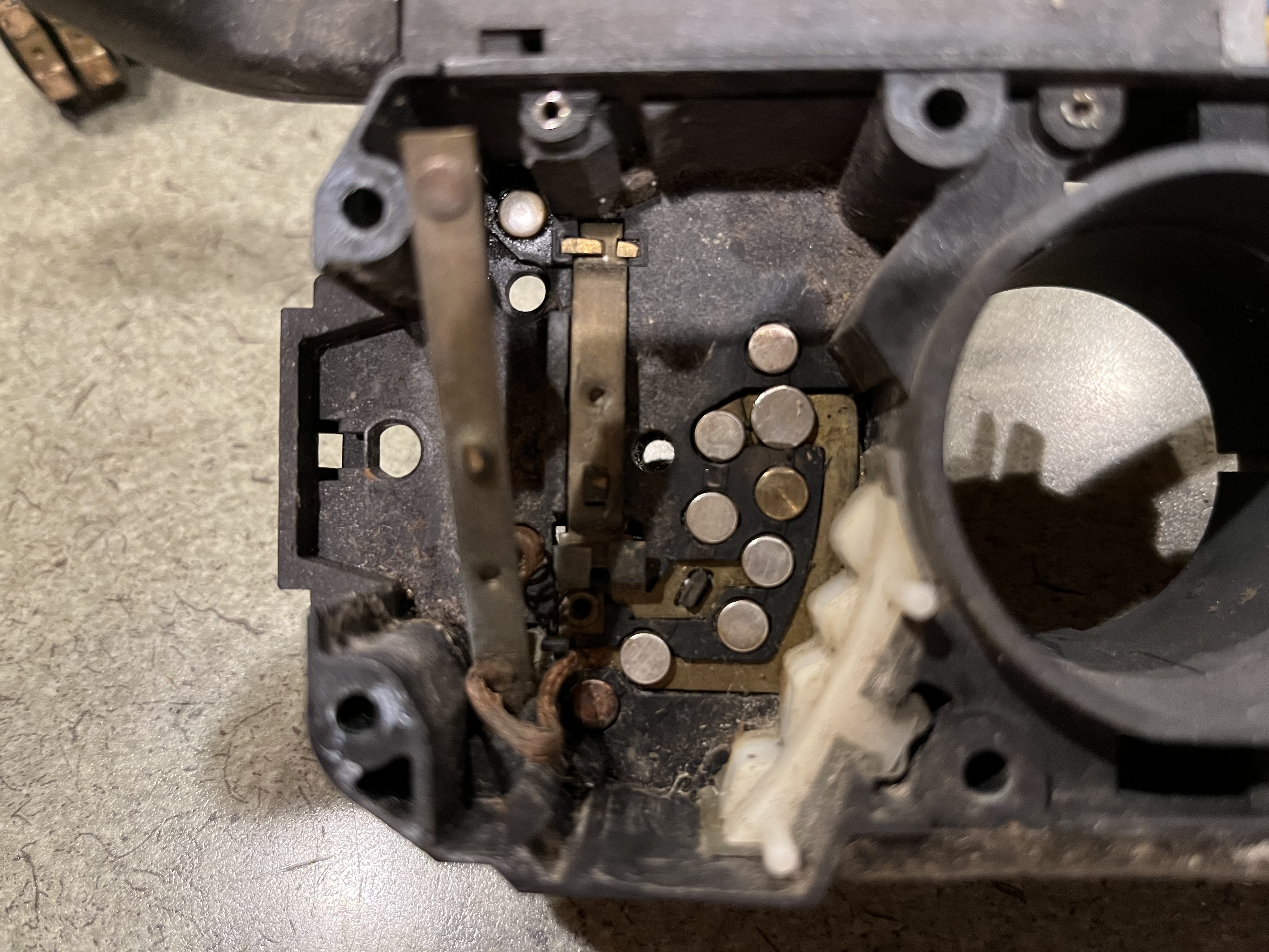

these last few are after cleaning the contacts:

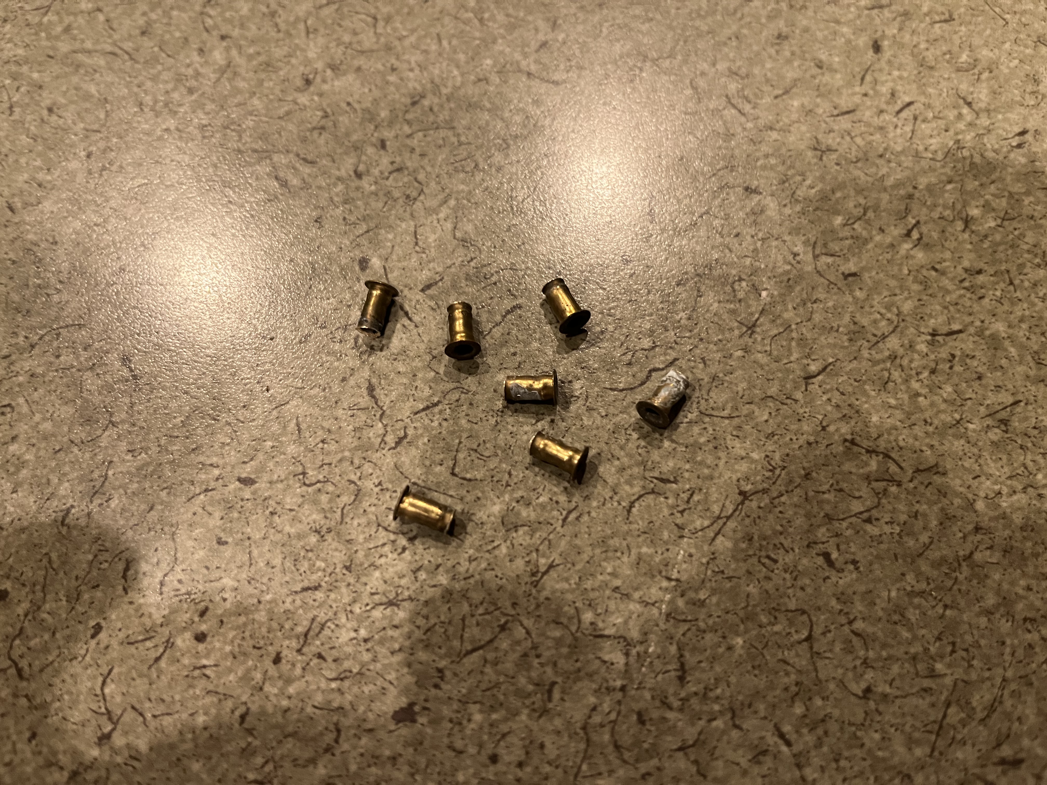

I think I’ll just use some small machine screws/nuts to hold it back together again in place of the rivets I drilled out.

Wow
That thing is in rough shape inside
What was the environment it was living in?
Humid climate?
Salt water climate?
I am going to take a look at the three I have removed.
Hopefully this week.
I know they look far better than that one
I will post my findings to add to info

I know, right? I bought it on ebay. The guy had two for sale out there and he sent the wrong one to me first, which was this one. Then after I told him that he sent the wrong one, he sent me the correct one and didn't ask for this one back. It almost seems like this one was in a flood or something... Luckily this isn't the one I'm using. The one in my car now is in better condition than this one - but I think I'm going to be taking that one apart like I did this one and cleaning it up too. I think I am going to use #2-56 flat head machine screws and nuts to put them back together. Probably will give the screws some blue threadlock too.
