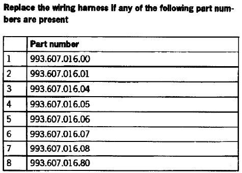

Here is the TSB:
W301-Replacement of Engine Wiring Harness - 993.pdf
(1.37 MiB) Downloaded 217 times
Wiring Harness Part Numbers.jpg (88.34 KiB) Viewed 2668 times

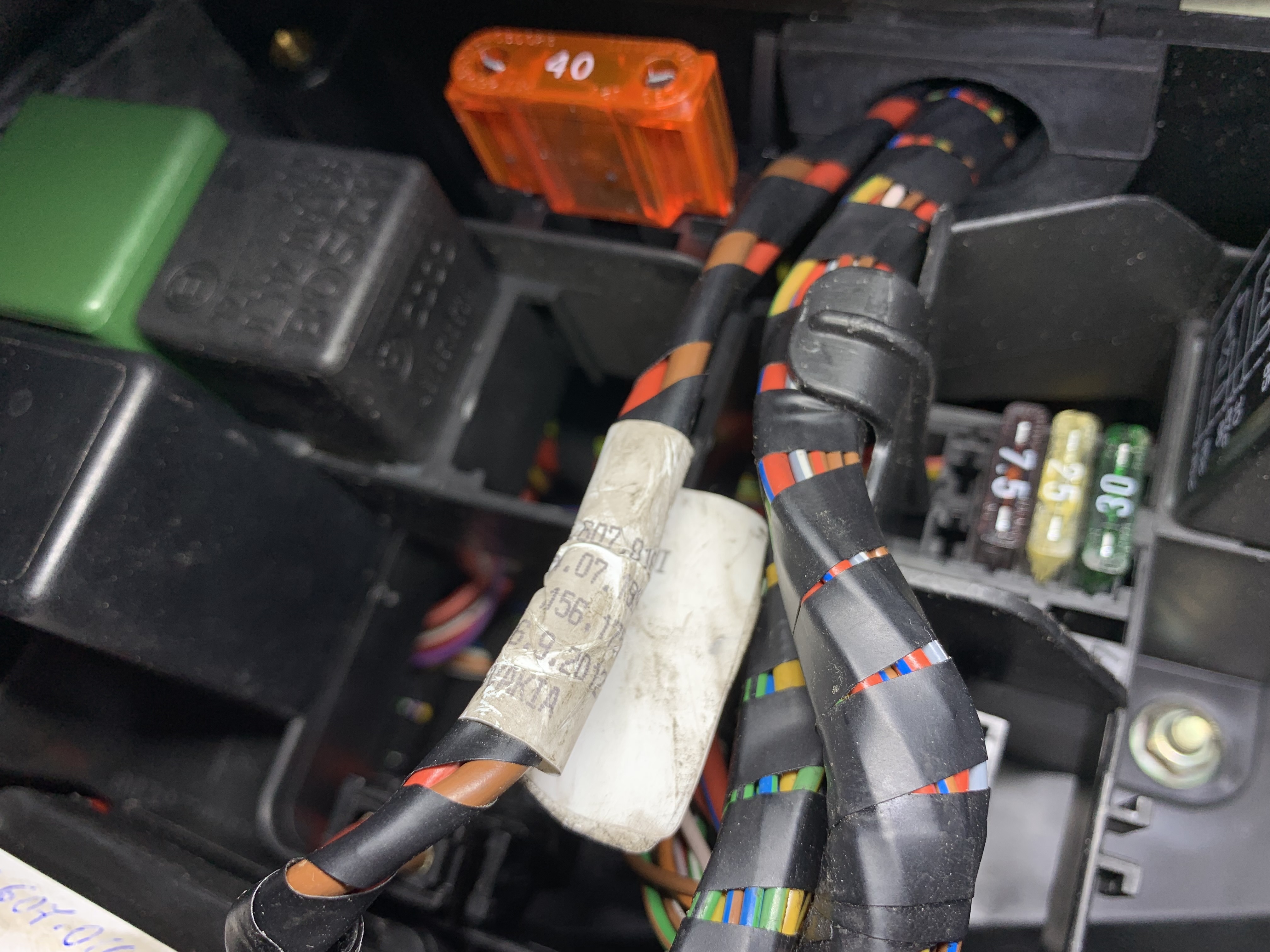

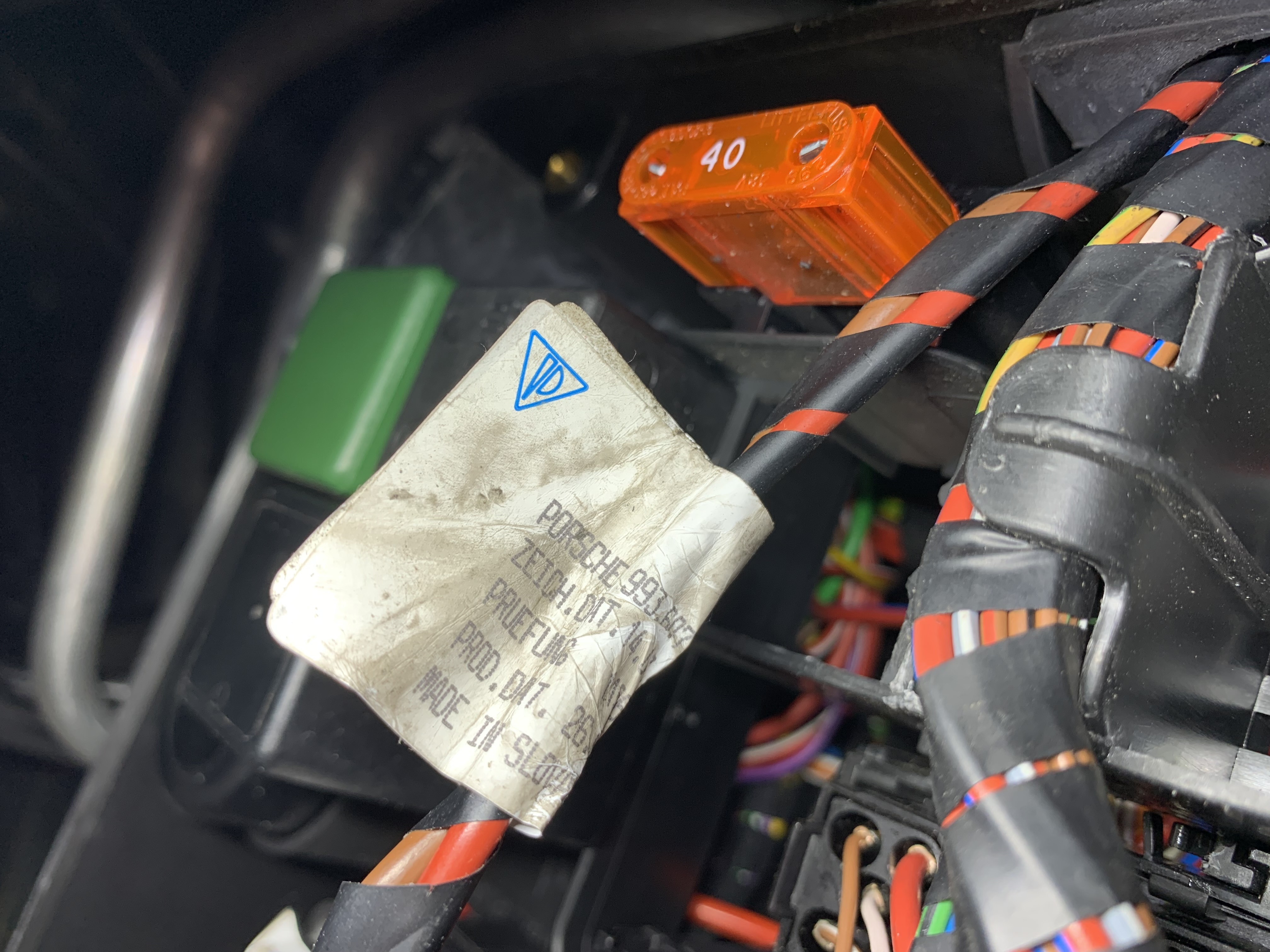

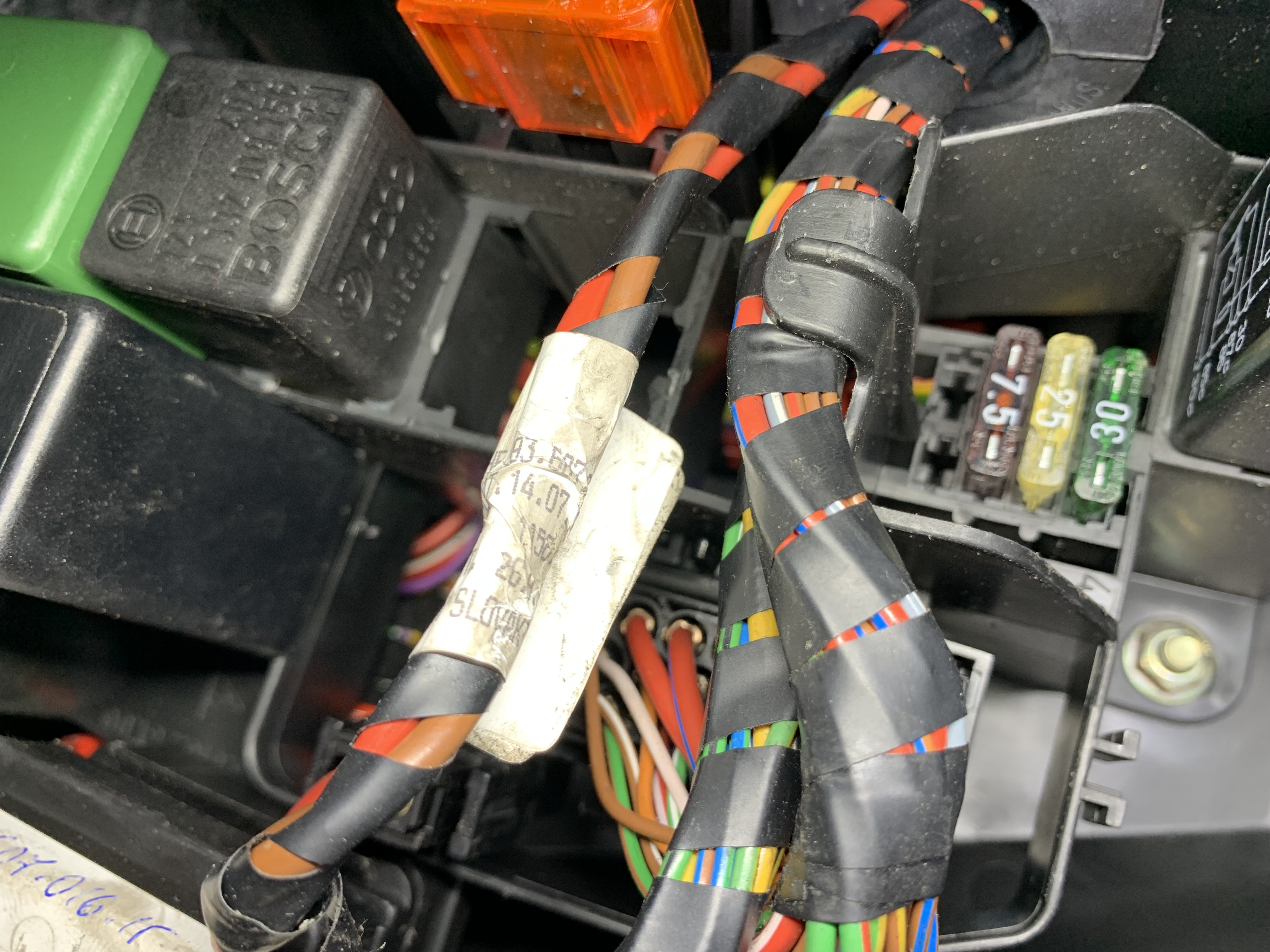

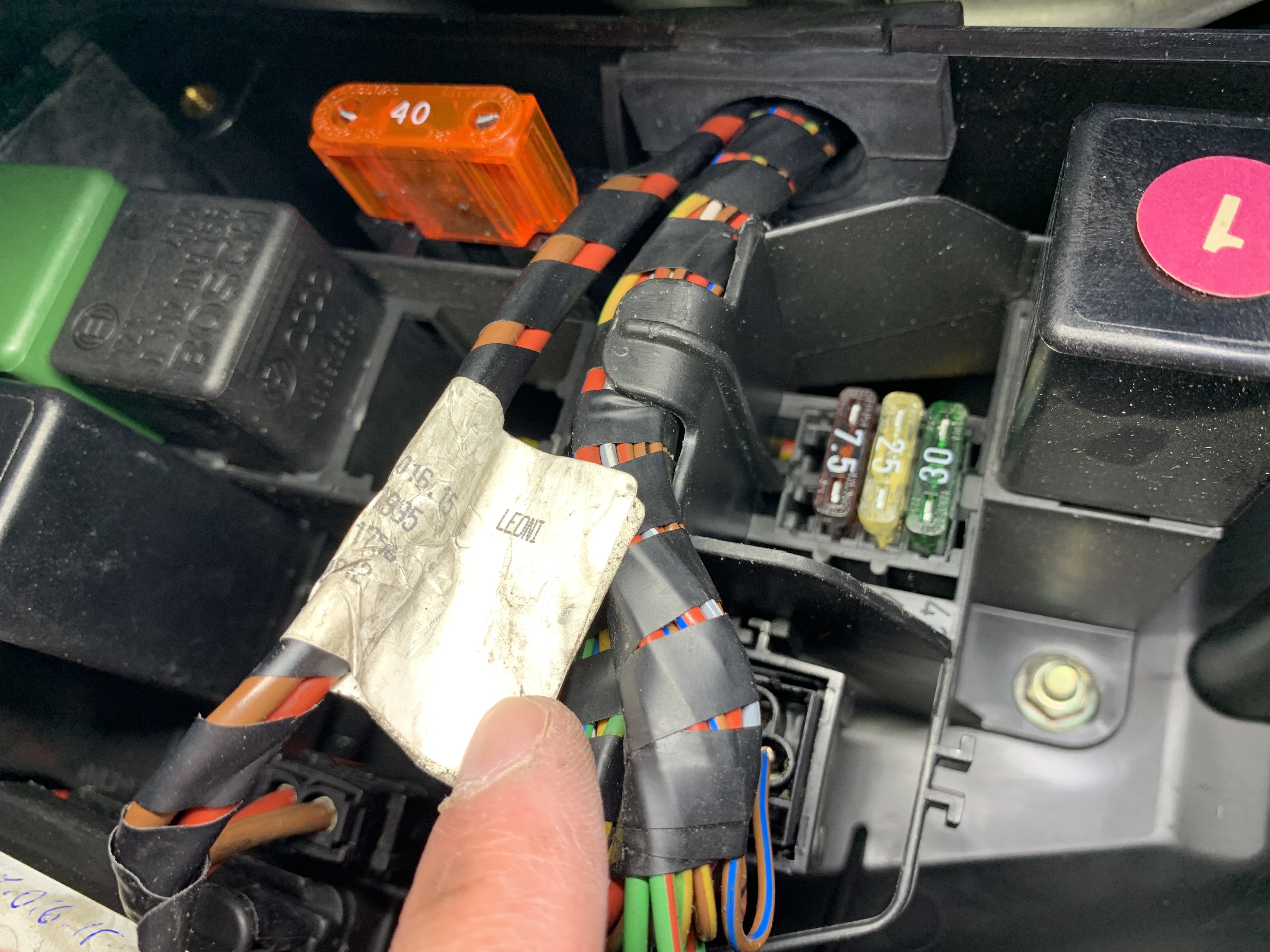

And here are pictures of the labels attached to my own harness (under the plastic cover on the driver's side of the engine bay.) You can see that the design date my my harness was in 1995, and the production date was in 2012, so luckily it was replaced before my ownership.
