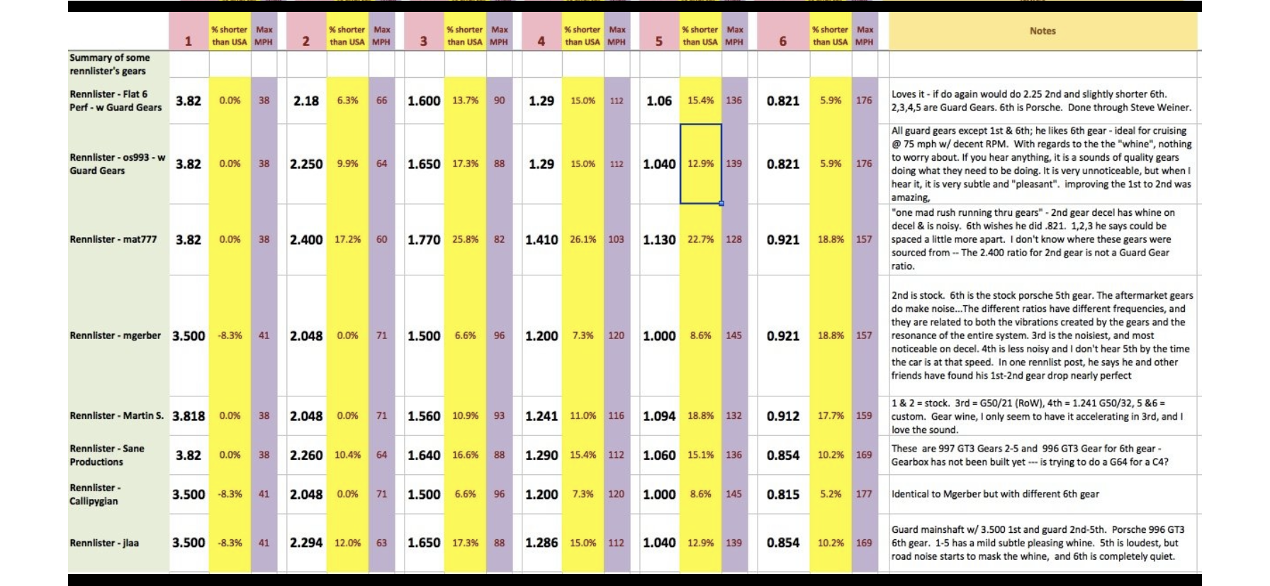

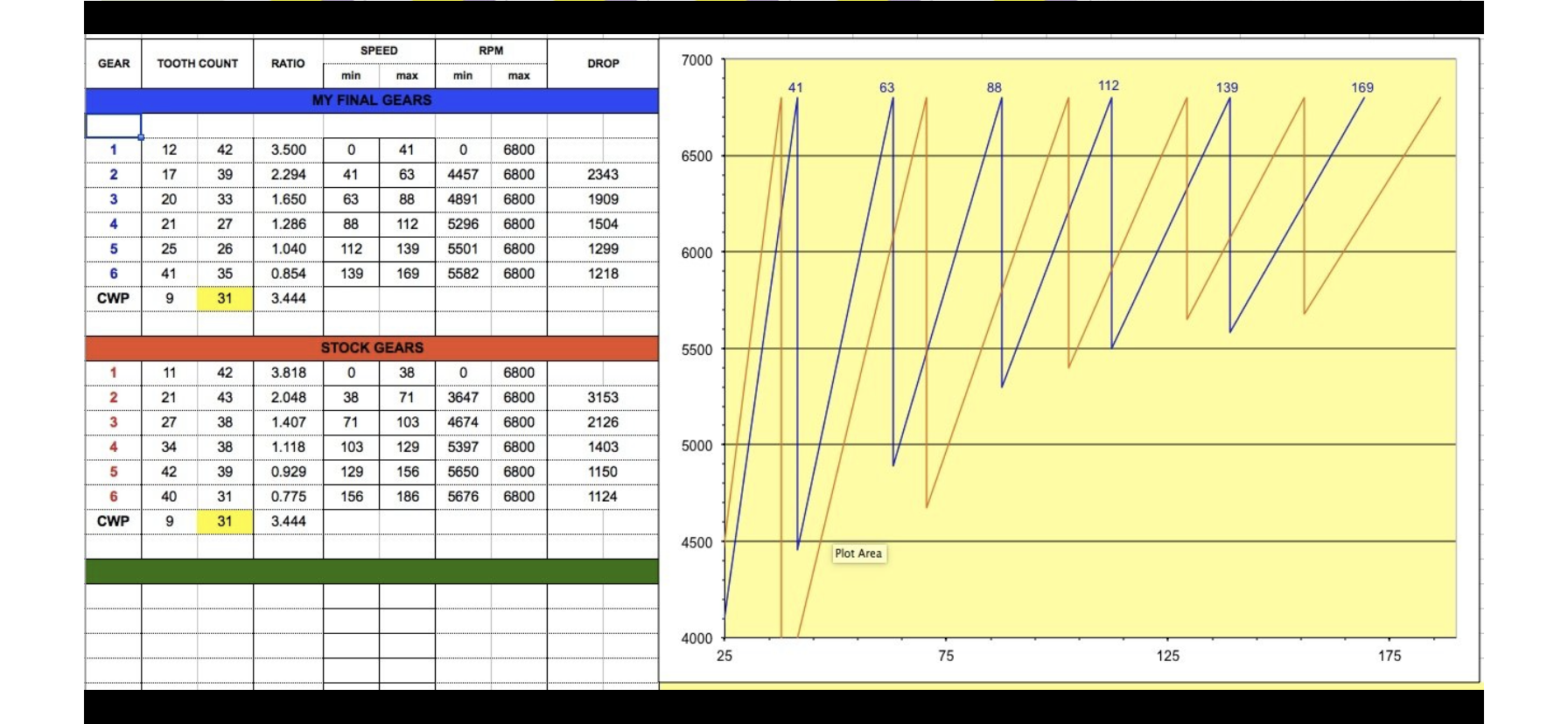

Some years ago I was dissatisfied with the overly long gearbox in my 1996 993. I decided to have it regeared.

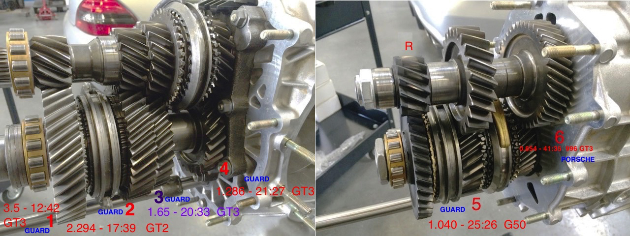

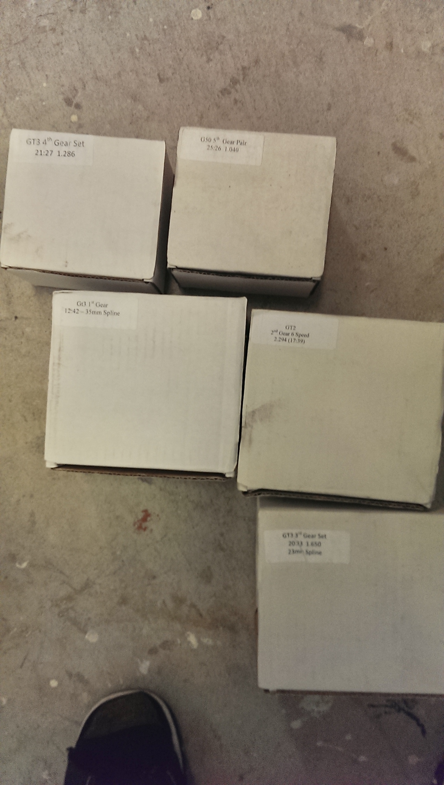

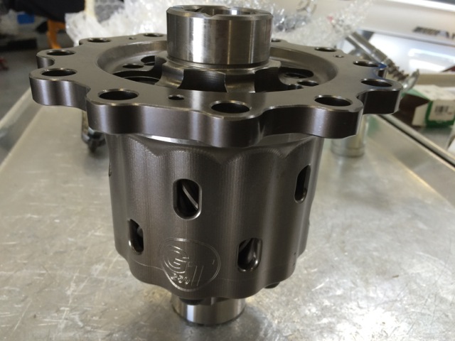

Bill Rader Las Vegas regeared the whole thing for me with various Porsche motorsport gears and GT Gears from Matt Monson. As well, Bill put in a Torque Biasing Differential from GT.
Years later and I find the transmission to be an endless source of delight. The car is very balanced and it squirts from curve to curve in a much more charismatic way than it did with the US gearbox. I have never felt the need to try and add power to this car.
