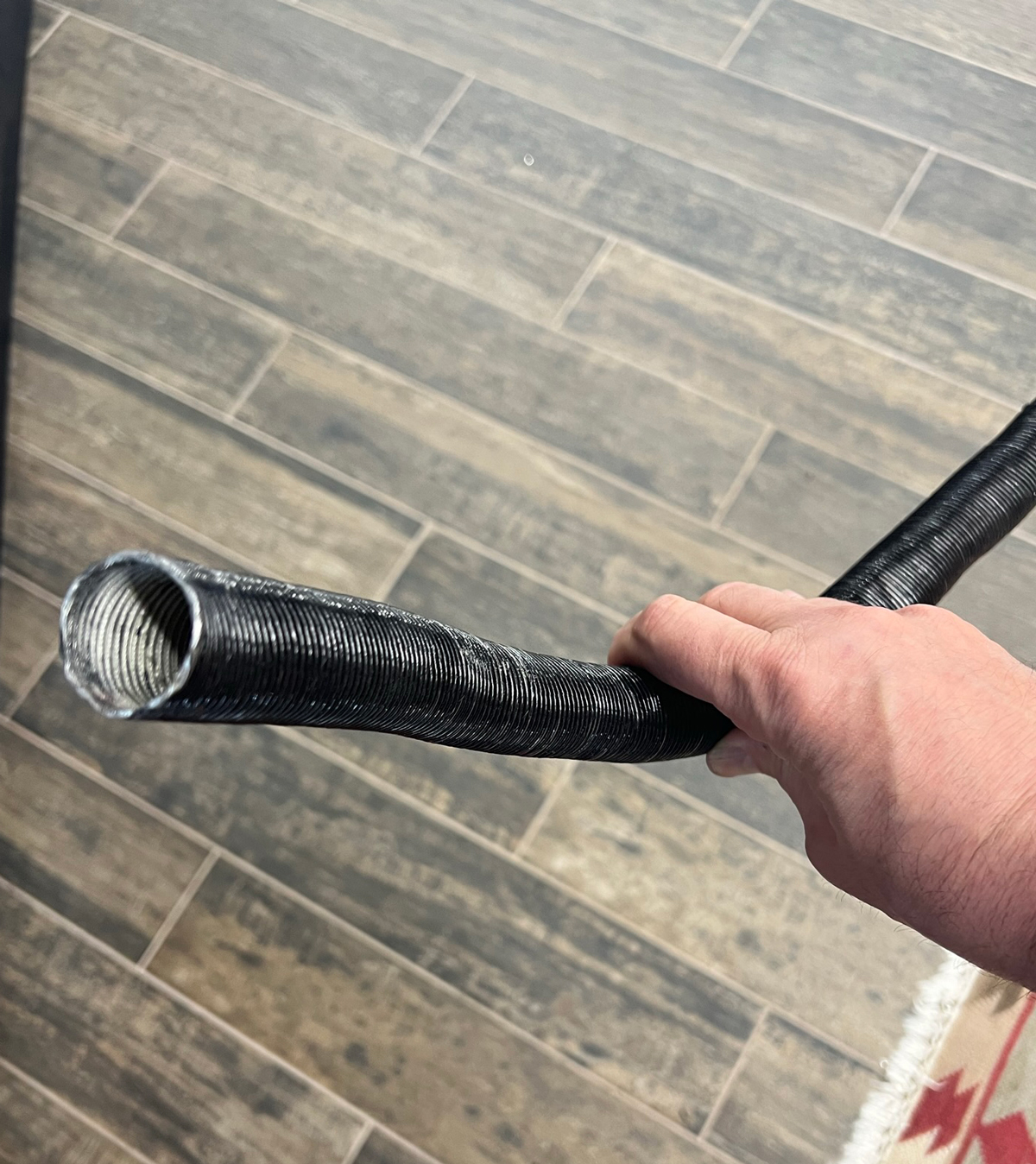

Look into using "fire sleeve" over the fuel hoses. It helps, especially over headers.

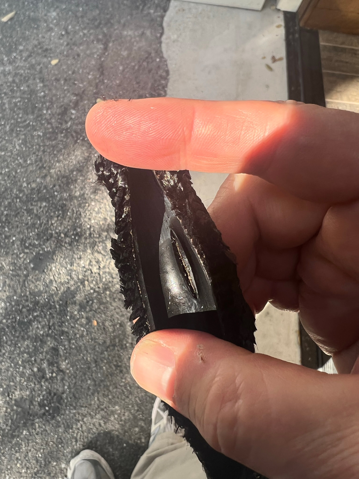

And the Oscar goes to.... the hose itself. See picture below. Maybe it wasn't made for e85? I got it from a very reputable grassroots 944 seller many years ago, and the overall quality seemed top notch. My first suspicion was that something rubbed at it and wore away a spot, but I was pretty careful about that and you see if failed on the inside -- the braiding on the outside was perfect and untouched. And re fire sleeve, I did have a metal heat sleeve over the hose from the rail to fender. I figured it would keep heat off the rubber and fuel, but also serve to drain the fuel into the wheel well should there be a leak on the engine-side of the fender wall.
