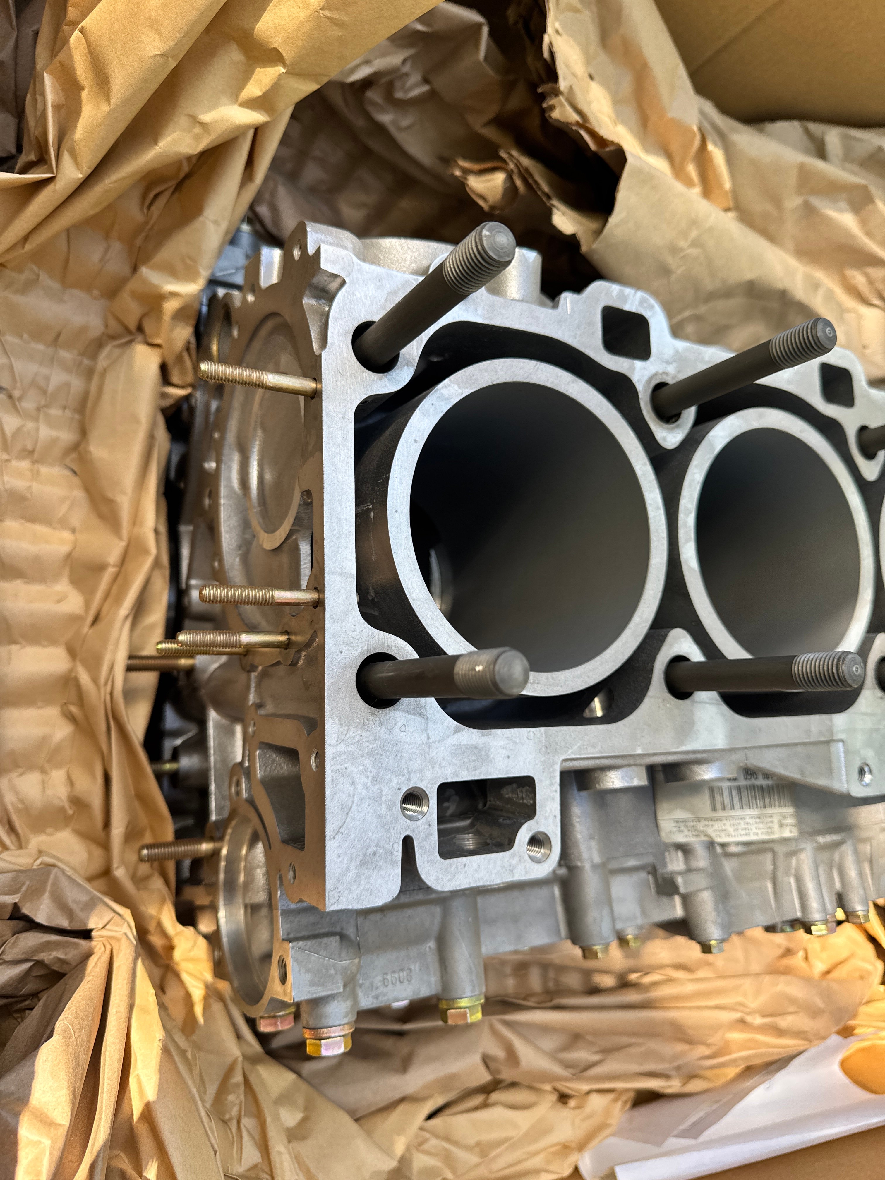

Anyone know what the latest news/ situation is with Wossner Pistons and stock Alusil bores…..Brand new block from Porsche
Mahle only have 100.5mm and 101mm unless anyone knows differently
Thanks
Posts: 9207
Has thanked: 961 times
Been thanked: 4160 times
Putting aside whether they (or anyone else) can make a gall-free piston for Alusil these days, I don't think there is much of a market for standard size pistons unfortunately. They list .5mm overs, but STD say sold out. Love the block though. Maybe custom order from Mahle?

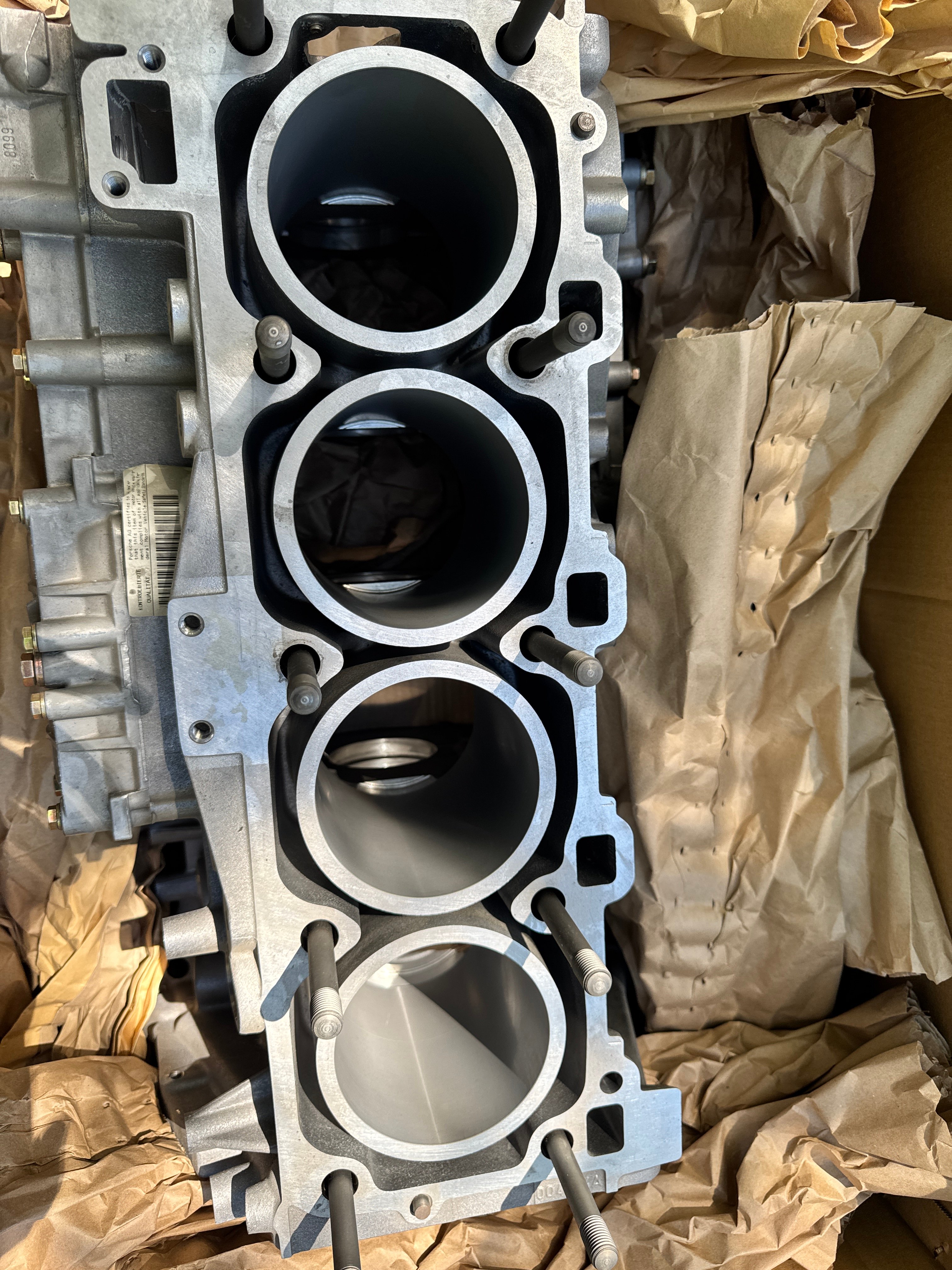

No I was confused, just checked my build sheet from mahle and the bores were 4.095", I think I mixed up the tolerance groups with oversized.
The tolerance group is stamped on the block face on each cylinder near the oil passages, you can see it in the pictures above.
Looks like yours is 1 as well so 100.0 pistons would be slightly small
