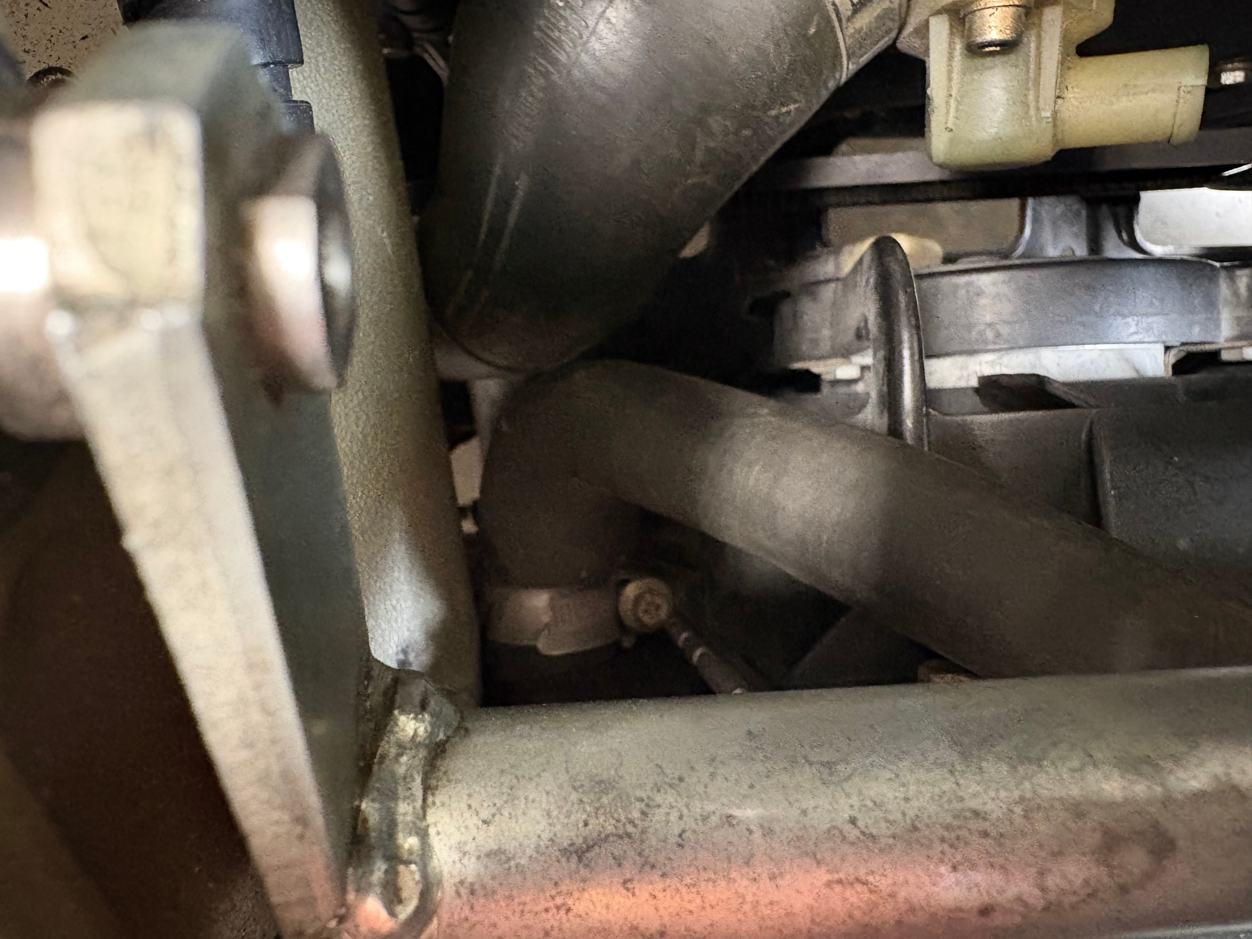

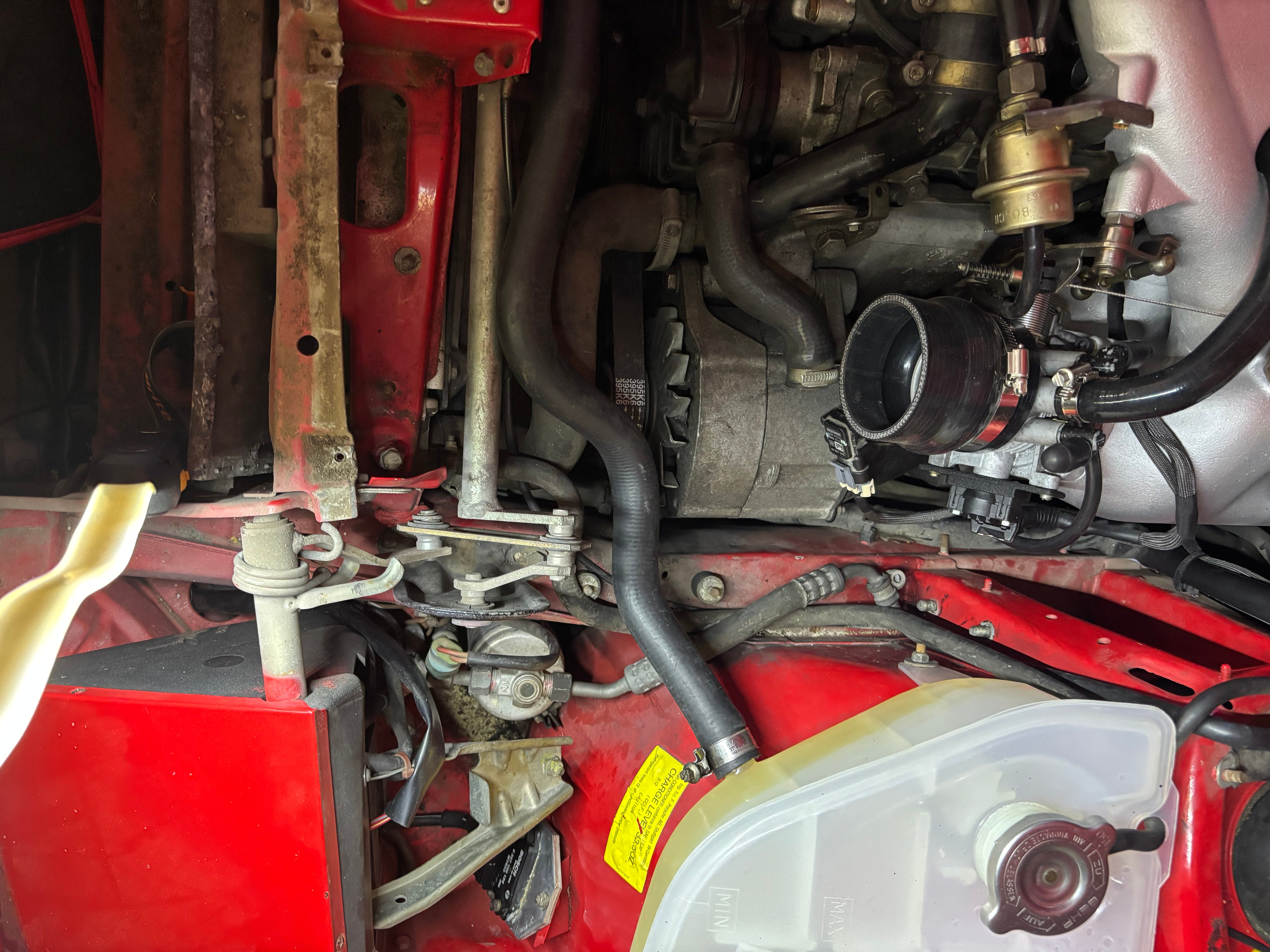

One of the things that could help, and I’m pretty sure is wrong is the coolant hose that runs to the reservoir. Even if I don’t go CAI, it would make me happier to know it’s tucked away appropriately and not in danger of getting chewed up by the alternator. Can anyone tell
me how to reroute this properly or show me a picture of it correctly installed?
