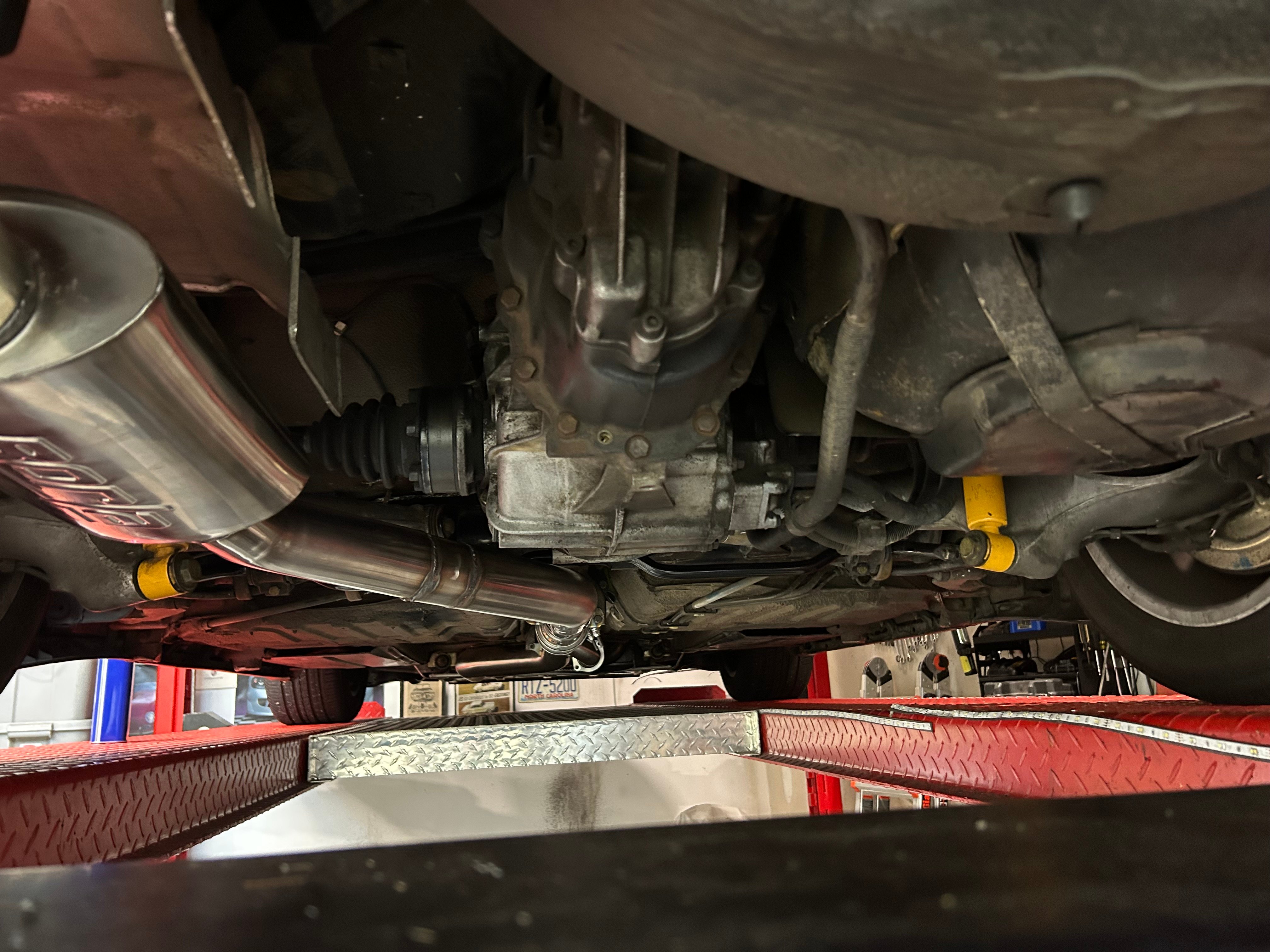

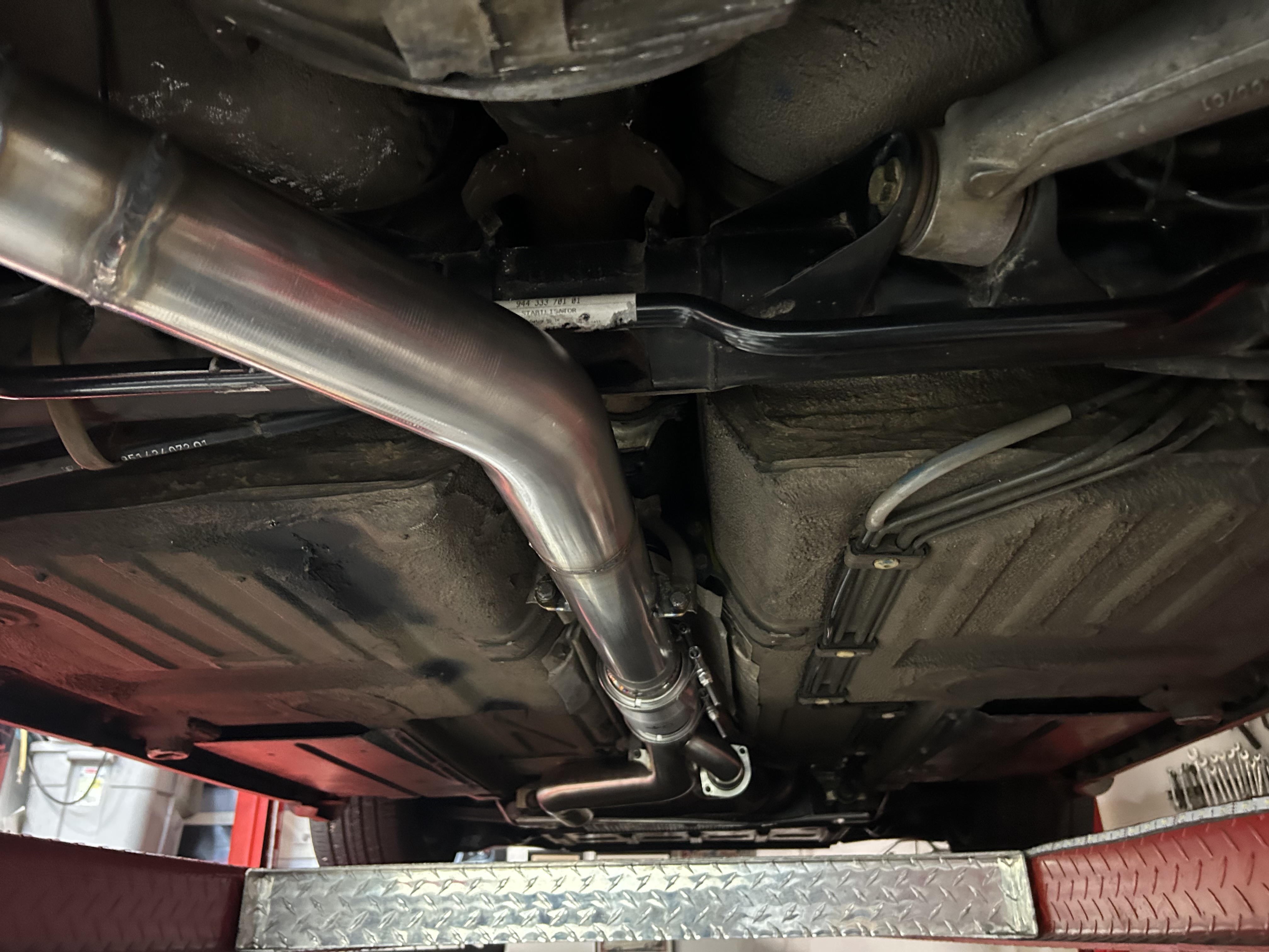

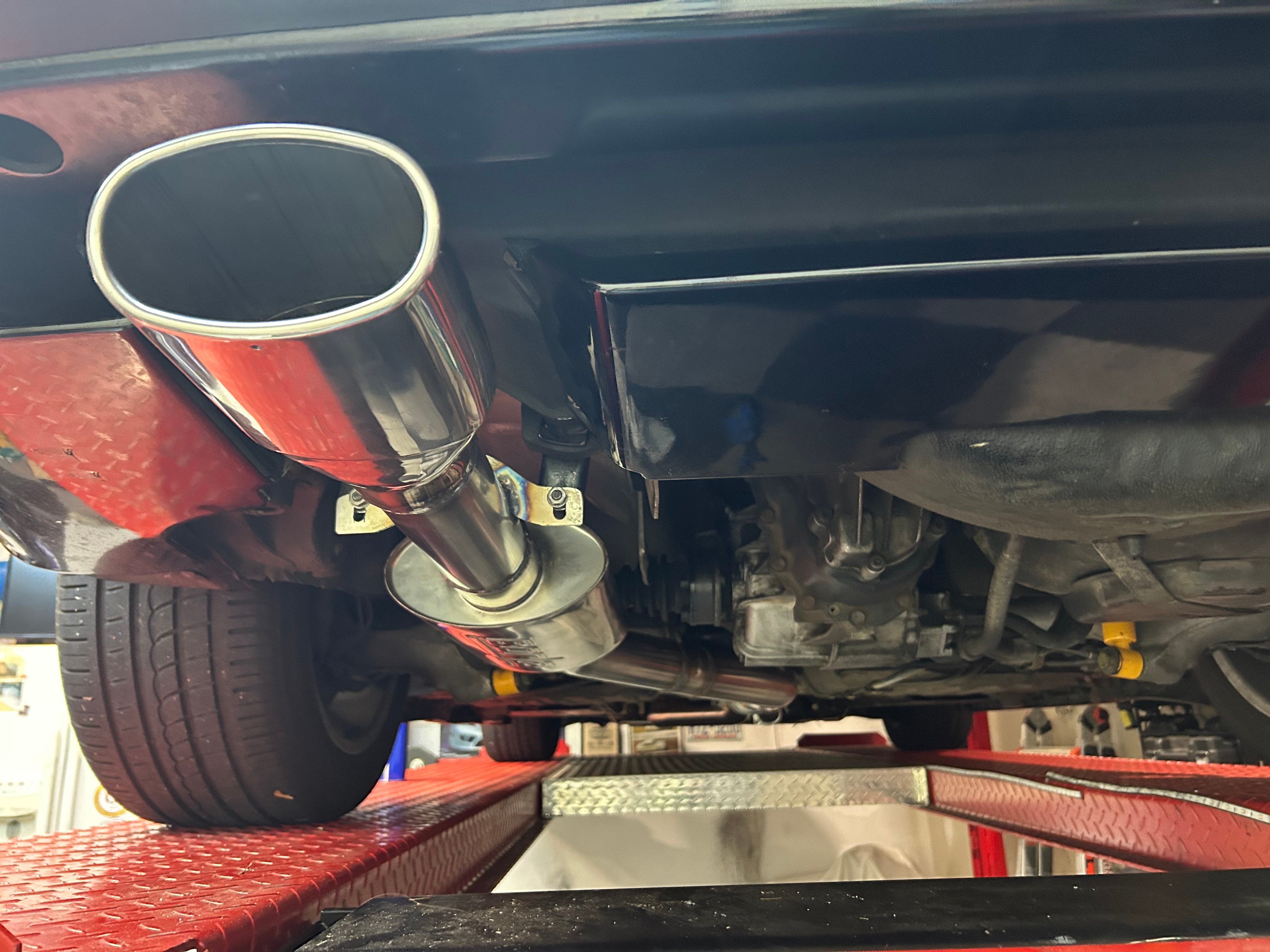

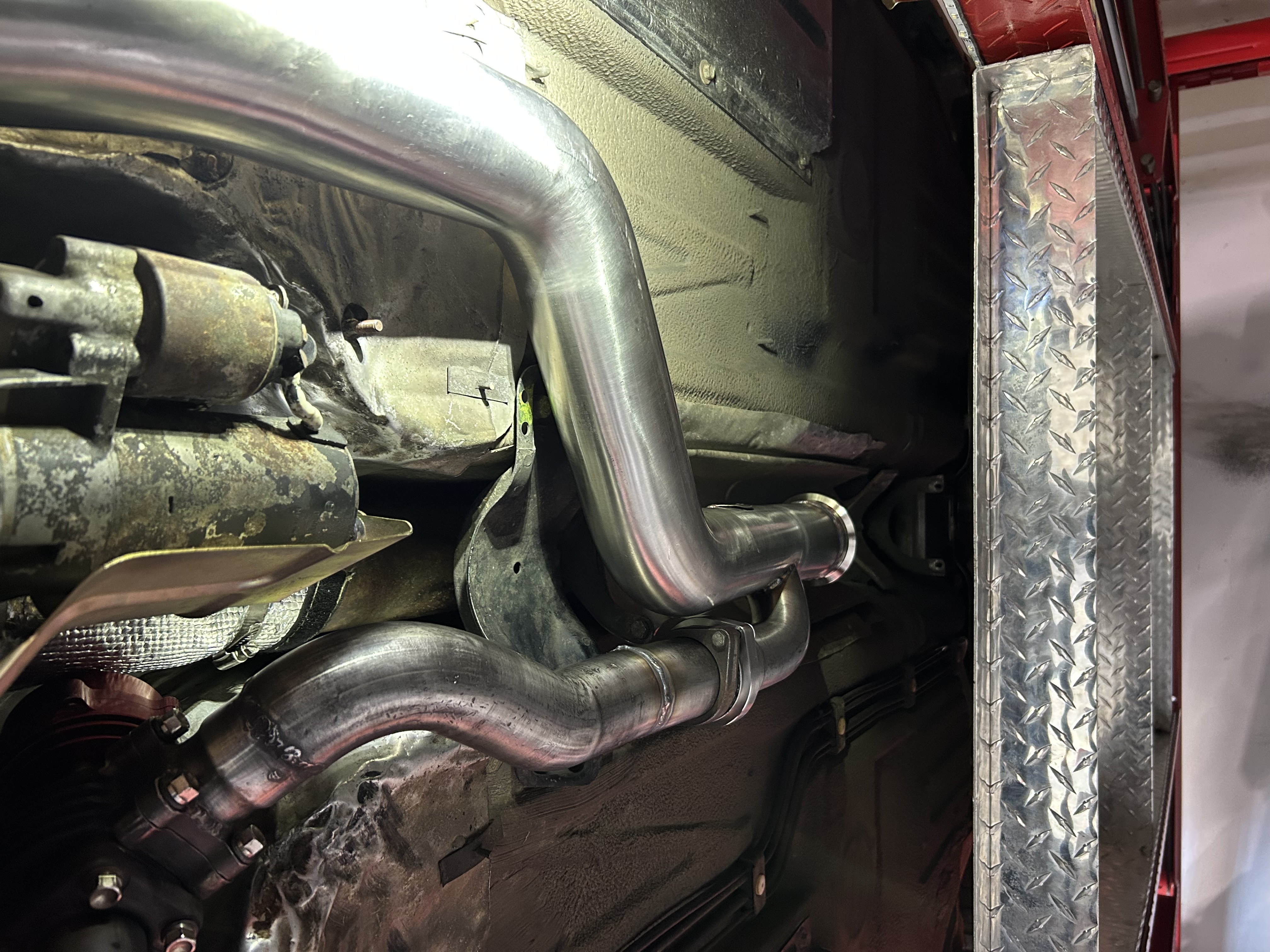

I have had a Lindsey 3inch for over 20 years and have never been satisfied with the fitment. I decided recently to teach myself to tig weld with the help and encouragement of a good friend. I just finished up my custom 304 ss custom exhaust. I started with a Fabspeed front section and welded in a v band for the high flow catalytic converter and then bought tubing from
Jmd tubes (fantastic quality), welded in a borla xr1 and a pypes tip. It fits so much better than before has an interesting sound . I will say the Lindsey sounded fantastic but hopefully I will get used to the sound of the new one. It’s much deeper sounding now. Overall it was a great project and I learned a lot.
Custom exhaust

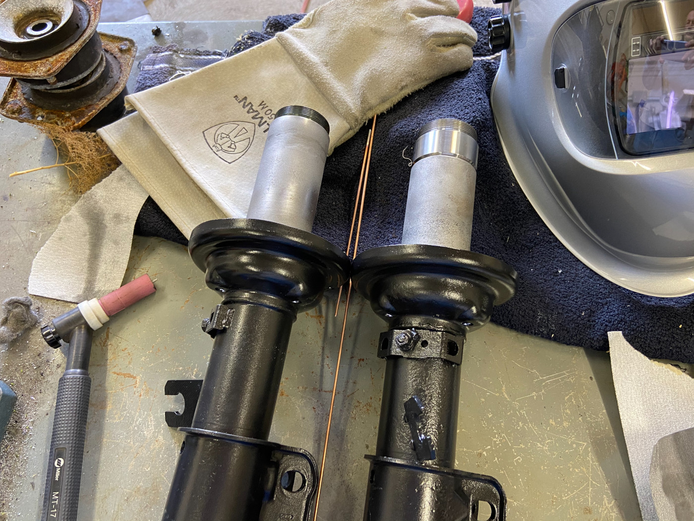

I'm also a (barely passable) hobby TIGist, but I managed to convert my original struts to replaceable Bilstein cartridges:
An auto-dimming helmet was the key for me. I never got the hang of flipping a standard helmet down without moving your hands.

The strut conversion looks great. I am a huge fan of the auto dimming helmet. As you said, so
Much better than the old fashion helmets that I used 30+ years ago.
