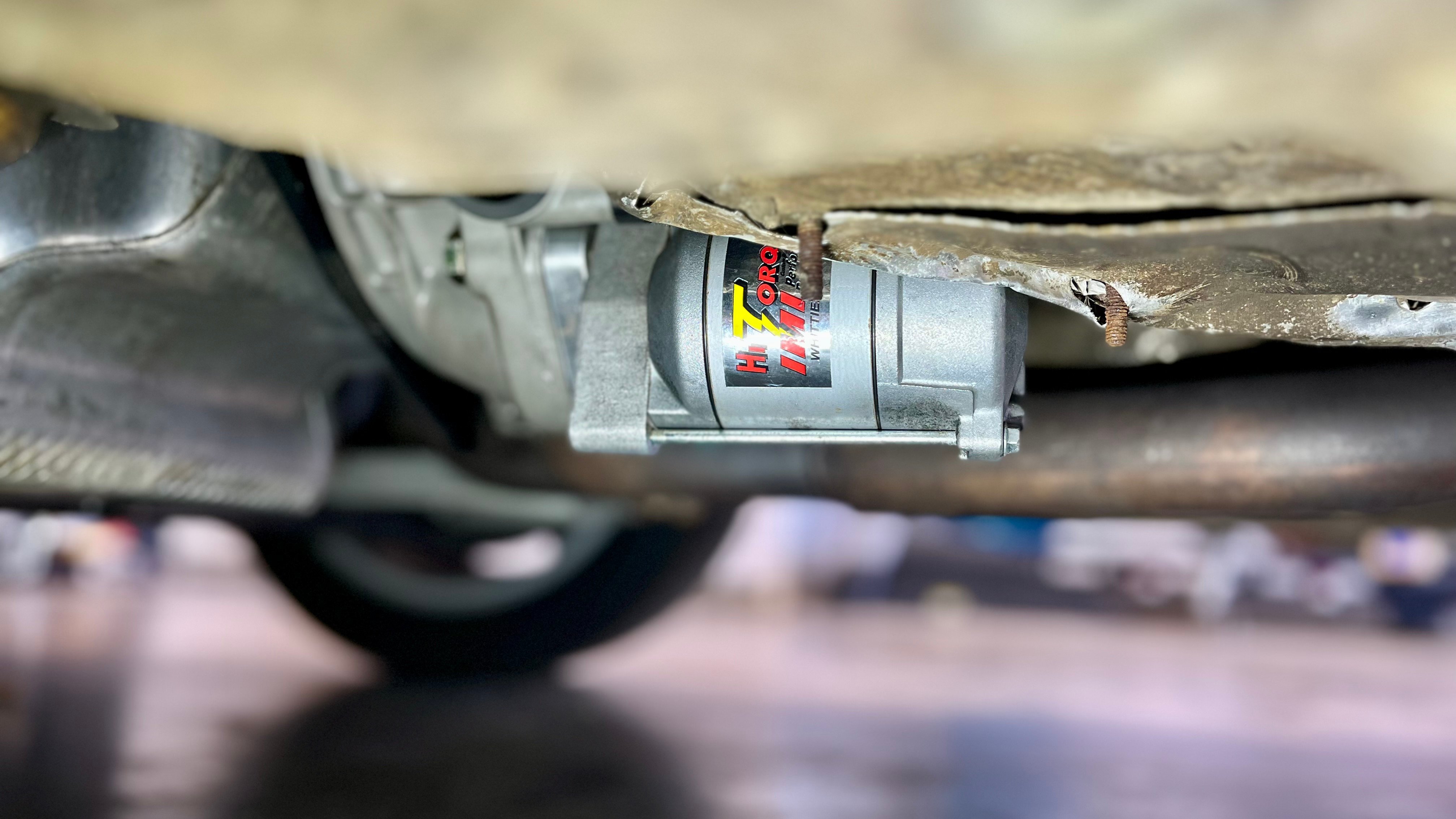

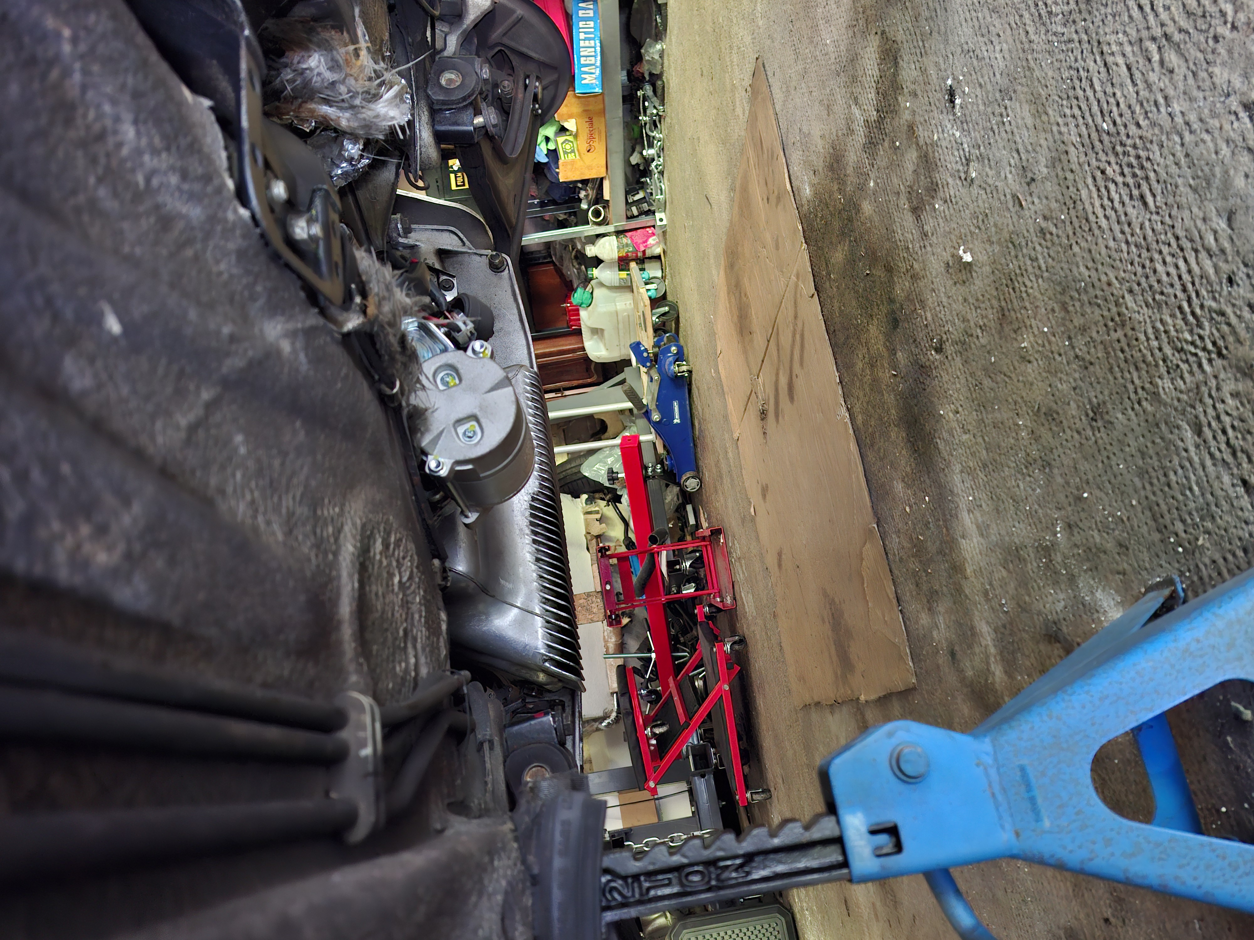

I have the IMI starter and so far its been good. In terms of the clearance issue, here is a photo showing how low it sits.
The blue arrow points to the solenoid, which hangs down due to how the starter needs to be clocked. I havent found another clock position that will work without major inconvenience, although the starter does allow for fully changing that position/rotating the starter. I do believe I played around with the clock position from how it came out of the box before finally just settling with where it is now.
Personally, with a lowered car, Im a bit uncomfortable with it being the lowest thing on the car with the potential for hitting road debris and it being directly bolted to the bellhousing/engine. If it were to hit something solid I worry that it could crack or severely damage the bellhousing, but maybe that fear is overblown?

Interesting... the IMI unit tucks in quite nicely on my 1988 NA. It has an extra 1/4" of ground clearance over the oil pan. I did not clock the plate prior to installation, just mounted it with the factory position. However, I did hammer the aluminum shielding on the left side of the undercarriage to flatten it out a little, as fitment was snug on that side.

NC944er wrote: Thu May 21, 2026 12:04 pm Interesting... the IMI unit tucks in quite nicely on my 1988 NA. It has an extra 1/4" of ground clearance over the oil pan. I did not clock the plate prior to installation, just mounted it with the factory position. However, I did hammer the aluminum shielding on the left side of the undercarriage to flatten it out a little, as fitment was snug on that side.
Ill have to see if I can get mine positioned like yours
