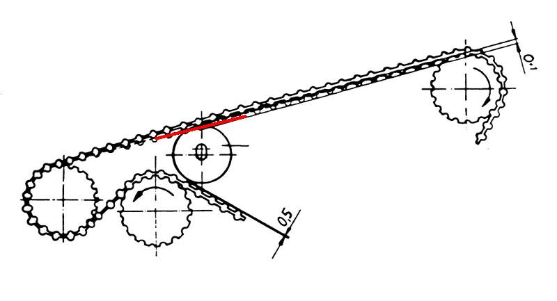

another point to note. Smaller microphones are sensitive to higher frequencies and the tone of a whining belt is usually amplified/exaggerated quite a bit. I have a hunch that some belts well in spec would sound whiney with a mic up close. So the audio references can be challenging. But I'm like you, my obsessiveness had me dialling in the balance shaft belt for a while. Don't forget the roller with the controversial spacing that can add to the noise. some say it should pre-tension the belt up to 1mm, others say in static position it should have no contact.
