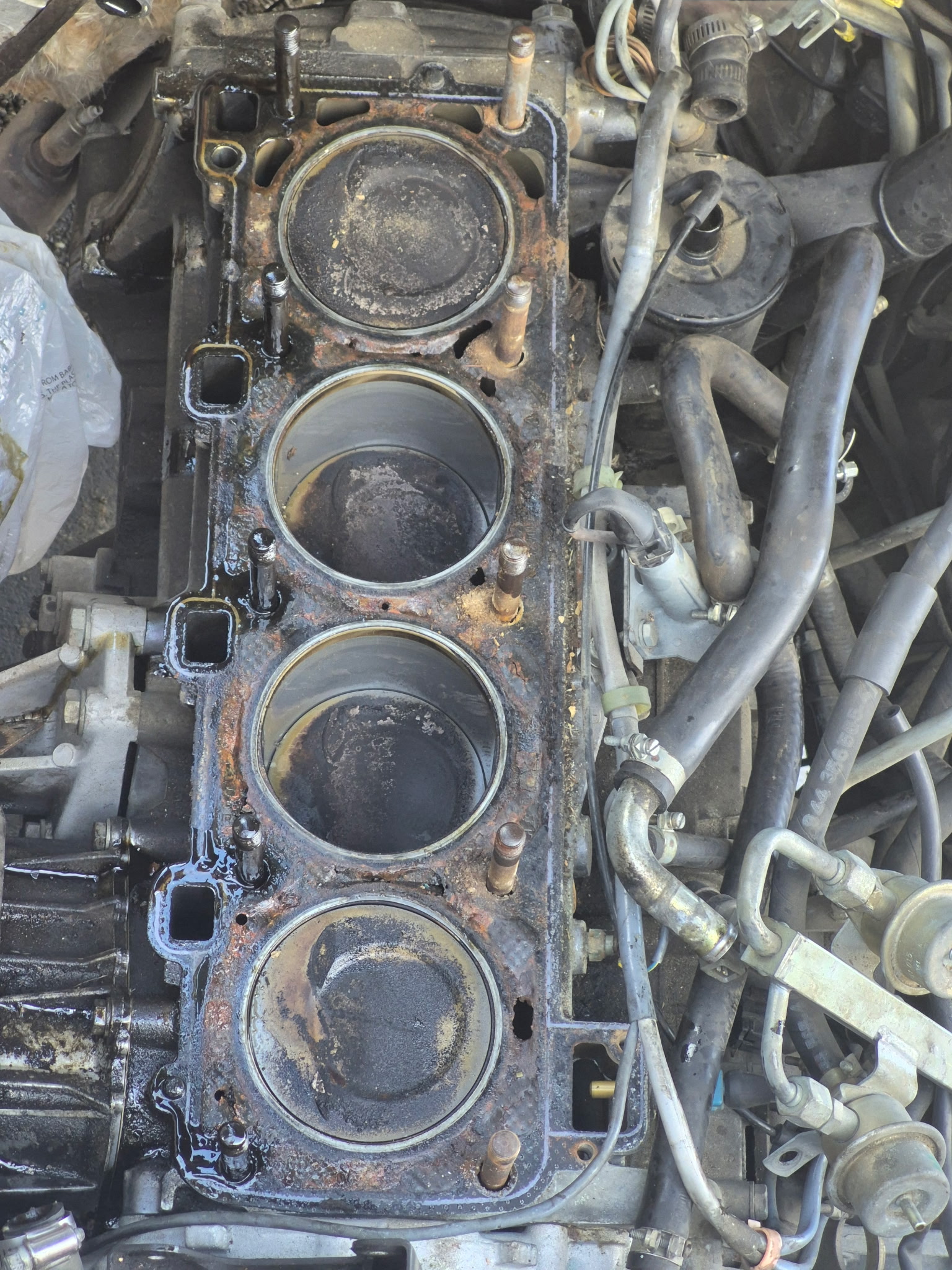

I recently replaced the head gasket on my NA 8v because of coolant seeping into the block. Could have been an uncommon issue, I’m not quite sure
