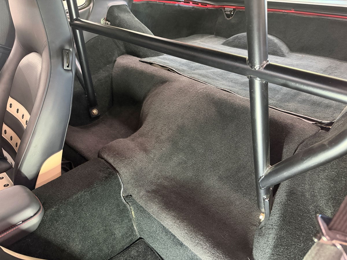

I removed my 951 rear seat when I replaced my carpet and sound deadening using the appbiz rs delete carpet kit. (Now sold by JWest Engineering).
If you don’t plan on doing a full carpet replacement, it wouldn’t be that hard to cut your own pieces for that area.
I put some hefty speaker boxes where the seats were and they sound way better than the rear oem speakers. I’ve seen other pics of diy storage cubbies as well.
Worked out well - only downside is that the gearbox noise is a little more noticeable.

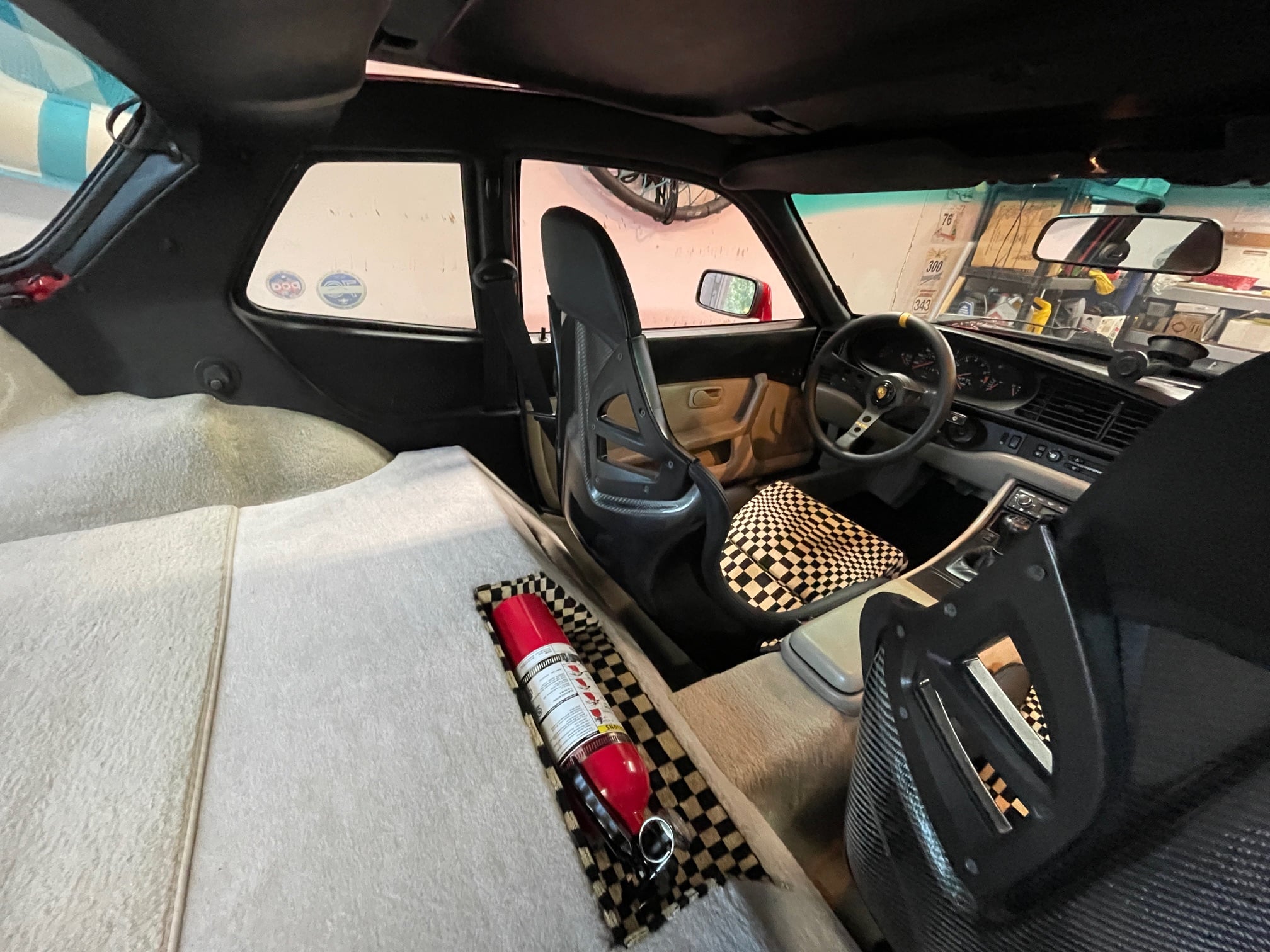

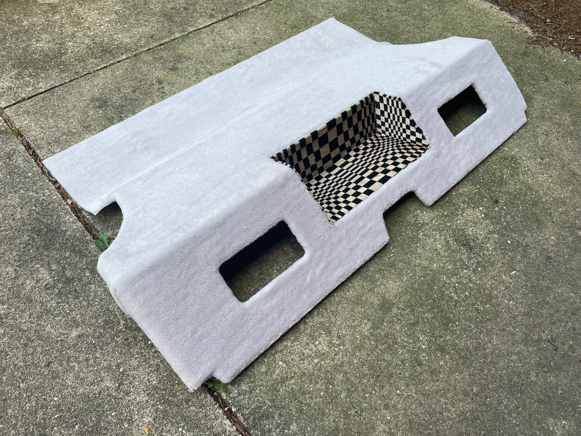

I made my own.
Very easy to remove rear folding portion and seat belts. I left the bottoms in case I want to reverse it, and I didn't want any extra road noise.
As for what I encountered: lots of birdseed. Last owner had rodents and this was their winter home.
If I had to do it again, I'd add the cross bar that the Porsche OEM one has to keep stuff from sliding forward.

VERY NICE clean look!!!! I’m looking to remove the lower seat cushions and build some sort of storage compartments just like the Club Sport…. The seats are weathered up pretty bad and I don’t plan on going back and having them replaced anytime soon…

@Aaron_N
I agree with Trouble, that is a really clean looking piece, and I like the cutout for a fire extinguisher...smart addition!
Love the seats as well!
