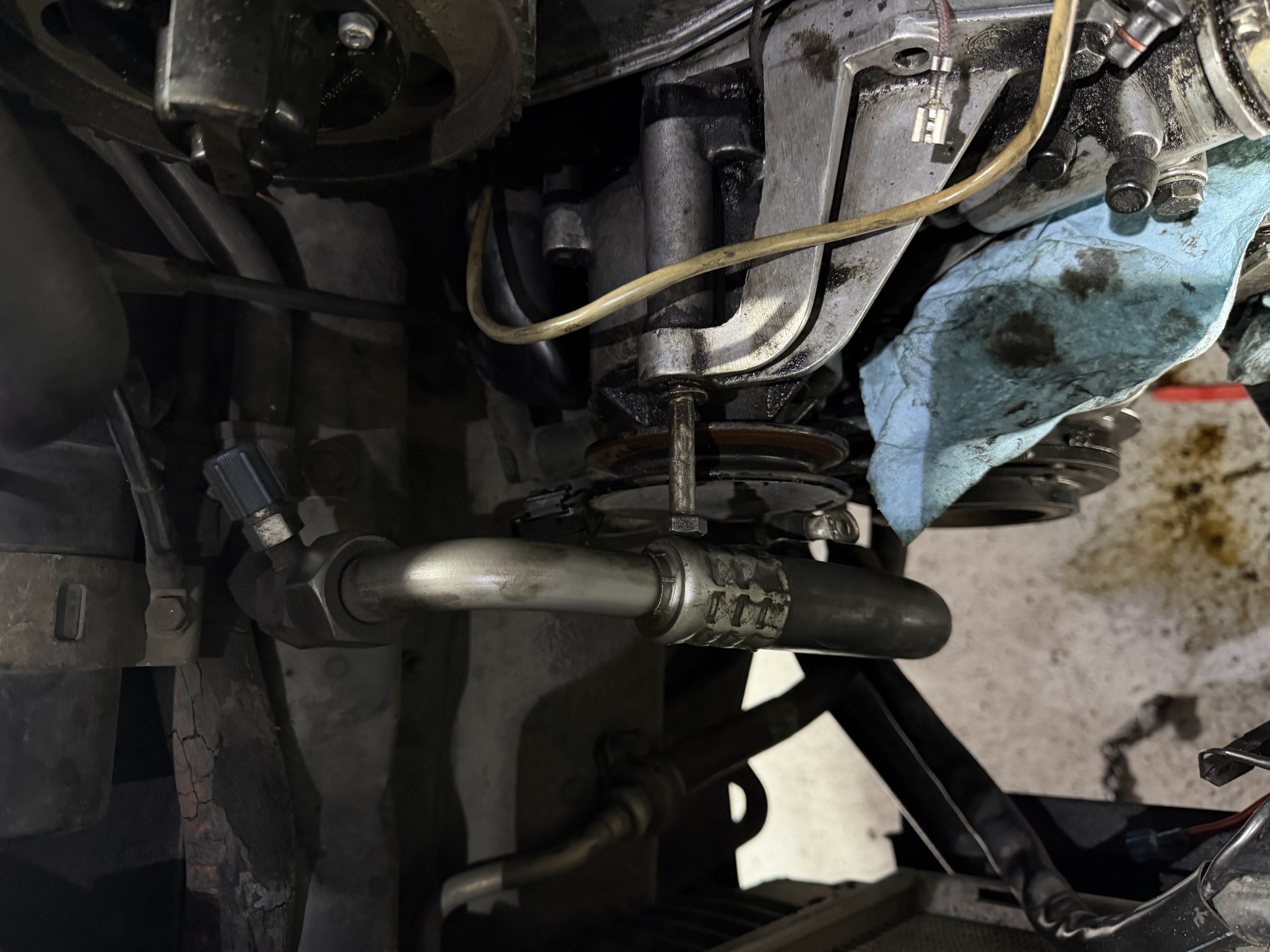

I did something maybe not the brightest when I was making room for my timing belt change. I needed to move one hard pipe a little to get one of the pivot bolts out of the way. Usually I’m super careful to see what I’m moving/ loosening but stupidly I loosened this on pipe a little too much and let some “ air pressure” out. Afterward I saw it was the AC LINE. I tried to look up if what I did was a big deal , little deal, or no deal but really couldn’t find the specific answer.
I seem to have R-12 Ac system based on what i see on the unit. ( see pic)
I guess my question to you guys is what should I do next ? Is this a AC Recharge issue ? I didn’t turn the AC on since the incident.
Thanks for the help. I’m really not versed in AC stuff.

How long did it hiss before you tightened it up? If just a second or two, I'd guess you're fine -- probably less than an ounce escaped. If it hissed for a minute or three though, that's a different story... I'd try the A/C and see if it's still cold, assuming it was before. Worst case, you'll need to have the system evacuated and recharged, which is not that big of a deal -- but for the fact that R12 is getting mighty hard to find, and finding shops willing to work with it is even harder. Most shops want to convert to R134a. On the 944, you can make that conversion without much/any decline in a/c performance, but I defer to the 928 folks here on whether the 928 is as forgiving....nagykurva wrote: Tue Apr 14, 2026 6:00 pm Hey Carpokes!!

Unfortunately it was more than a few seconds… I pretty much released all the pressure
I’ll give the AC a try when I have a chance.
If anyone knows R12 recharge source would appreciate the help.

Ah, in that case, sounds like you'll need to have it evacuated and refilled. R12 was banned some 30 years ago, so it's quite a challenge to find. You 'can' find left over supplies on eBay, but the price just keeps climbing and the cans just keep getting older. Technically you also need to be certified by the EPA to buy it (though not all sellers care/know about that). See, for example, this vintage can that will set you back nearly $50 after shipping....nagykurva wrote: Wed Apr 15, 2026 6:48 am Thanks Tom!

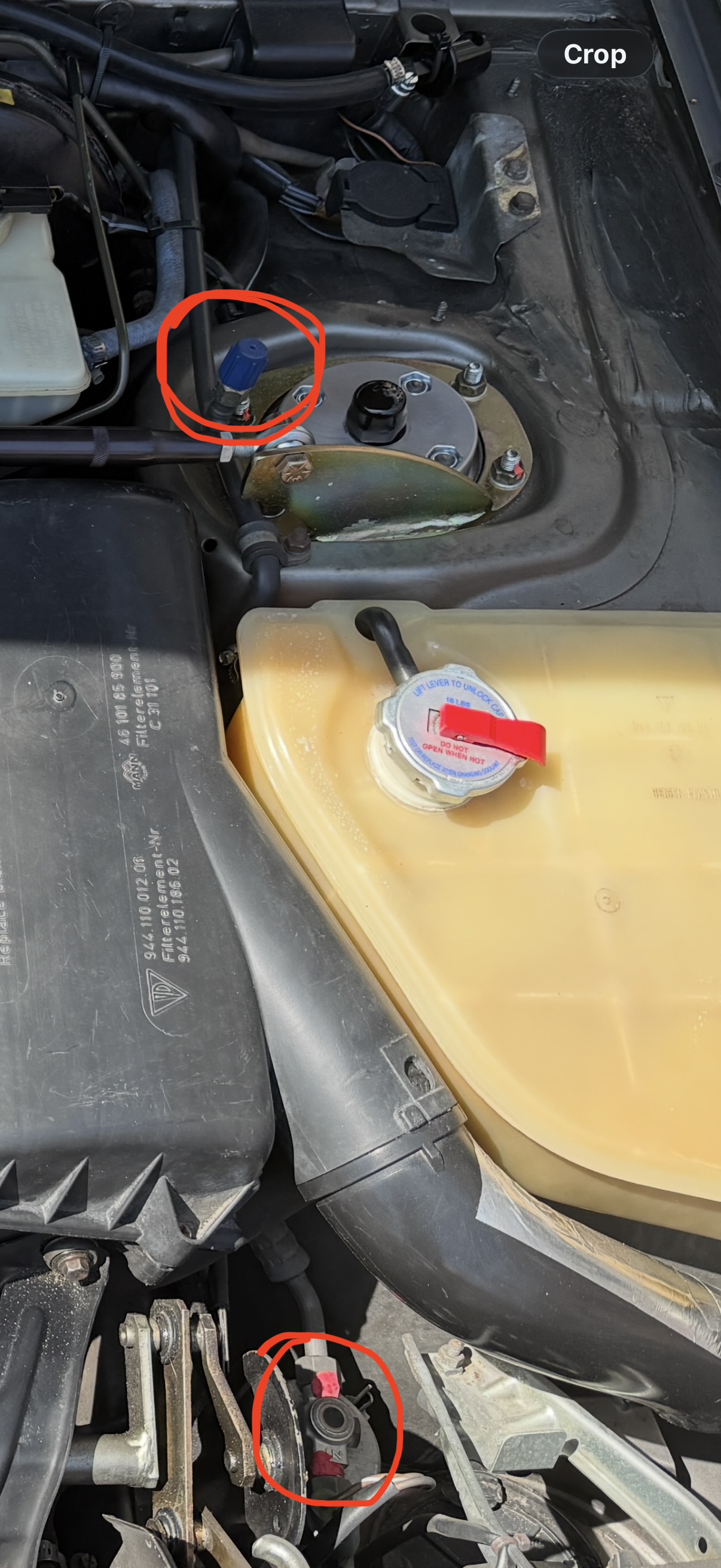

The bad news is that you did lose some AC charge. The not-so-bad news is that your pictures show a blue R134a service valve cap on that suction line above the compressor. It has had a conversion sometime in its past, so you should be able to take it to a regular AC shop for service. They may try to claim a "Porsche tax" multiplier, but for no reason really. The system is easily serviceable now, with service ports pretty easily accessible. The compressor is a very popular Denso unit too. Nothing you wouldn't find on a Toyota really. Other components are common Behr pieces fitted to other luxury European cars at the time.

-- The line in your picture is in fact the original suction hose, spec'd for R12 service. The replacement refrigerant has smaller molecules and, at least theoretically, will slowly seep through the hose wall. But a well-used R12 hose also has some oil soaked into the hose lining, and that seems to dramatically slow the loss of charge.

I looked at that and it seemed kind of black and Porsche-y..., but I guess the metal adapter under the cap is the tell?dr bob wrote: Wed Apr 15, 2026 10:16 am The not-so-bad news is that your pictures show a blue R134a service valve cap on that suction line above the compressor.

The original R12 caps are much smaller, black, and have a domed top shape. The R134a suction caps are blue with the ribs, while the smaller high-pressure side caps are red. The ring for the adapter under the cap is another clue.

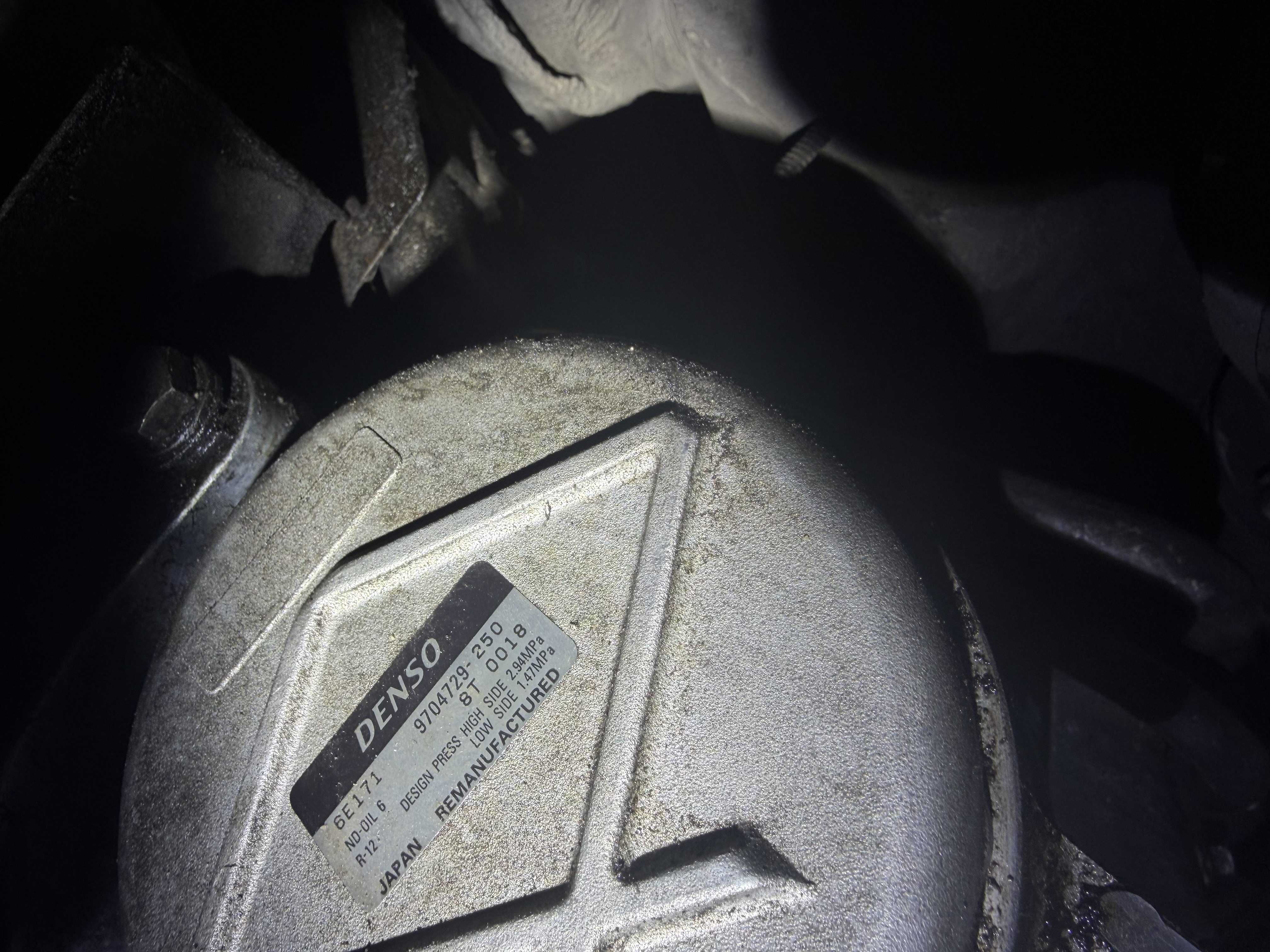

More - just revisiting your pictures, the label on the compressor shows it has Denso 6 oil, which is PAG should the question come up. So it's a native R134a compressor, a Good Sign. You don't share the year of your S4, which can sometimes be a help.
