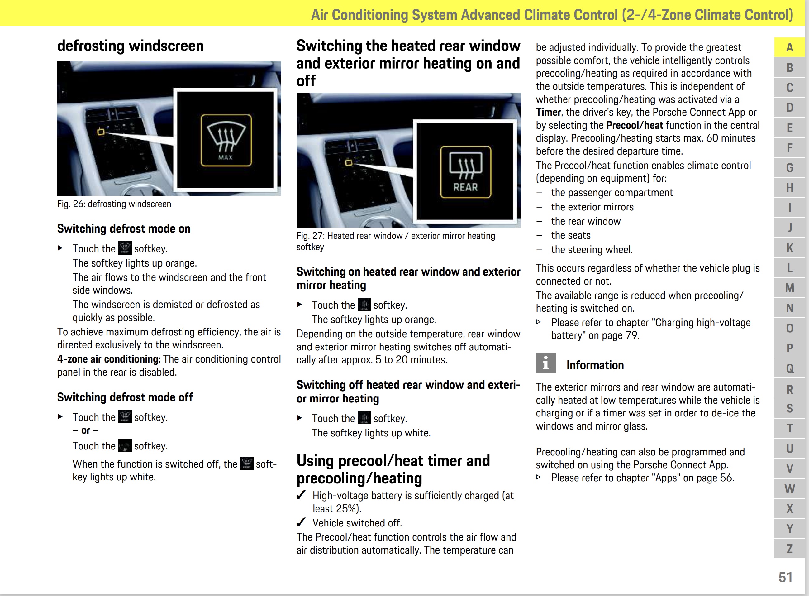

For most of the past two years, my Taycan has been in Georgia. It experienced its first winter in Connecticut this year. While in Georgia, I didn't use the rear defroster much especially since the car was in a garage. Up North and being parked outdoors, there have been occasions this winter when I tried to use the rear defroster. When I turn it on, the icon lights up for about 5 seconds and then turns off. The same thing happens regardless of the state of charge or the outside temperature. I had the dealer in CT look at it when it was in for one of the software recalls in February. They checked it and said they could get it to stay on by bypassing the sensor (so the wires in the rear glass are all working and there are no shorts in the system). They gave me a ridiculous excuse that since it was an EV, the sensor will only operate when the temperature warrants it and it has enough charge in the system. My personal belief is that the sensor is defective. Before I bring the car back to the same dealership for its 2 year service and ask then to change the sensor, I wanted to see if any of your rear defrosters stay on/work.

The owners manual says that it will turn off after 5 to 20 minutes depending on outside temp (but not after 5 seconds). There are other people reporting the same thing on other forums, and the solution seems to be a software update. :shifty: Either way, your dealer's answer sounds silly to me. :roll:
