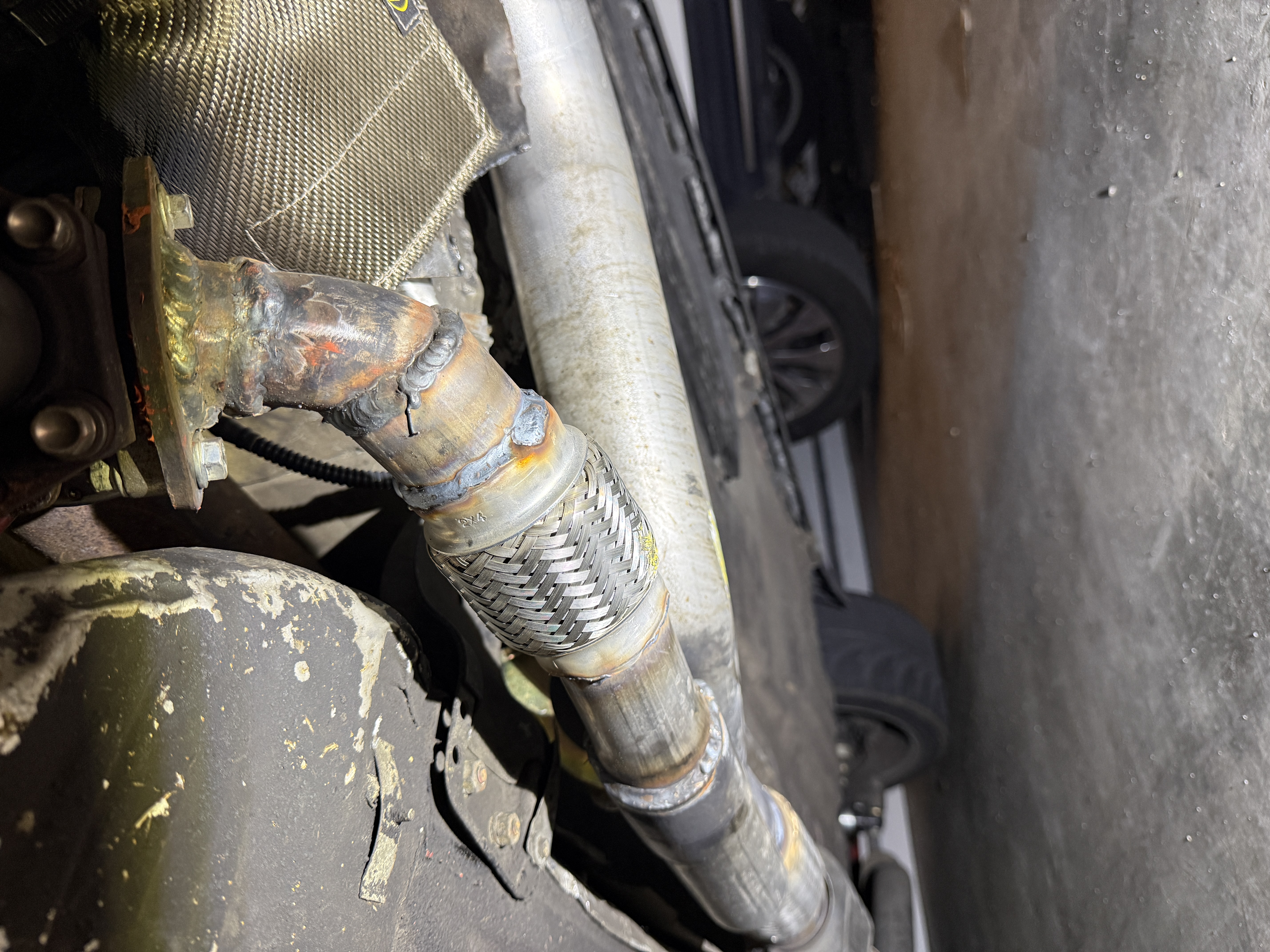

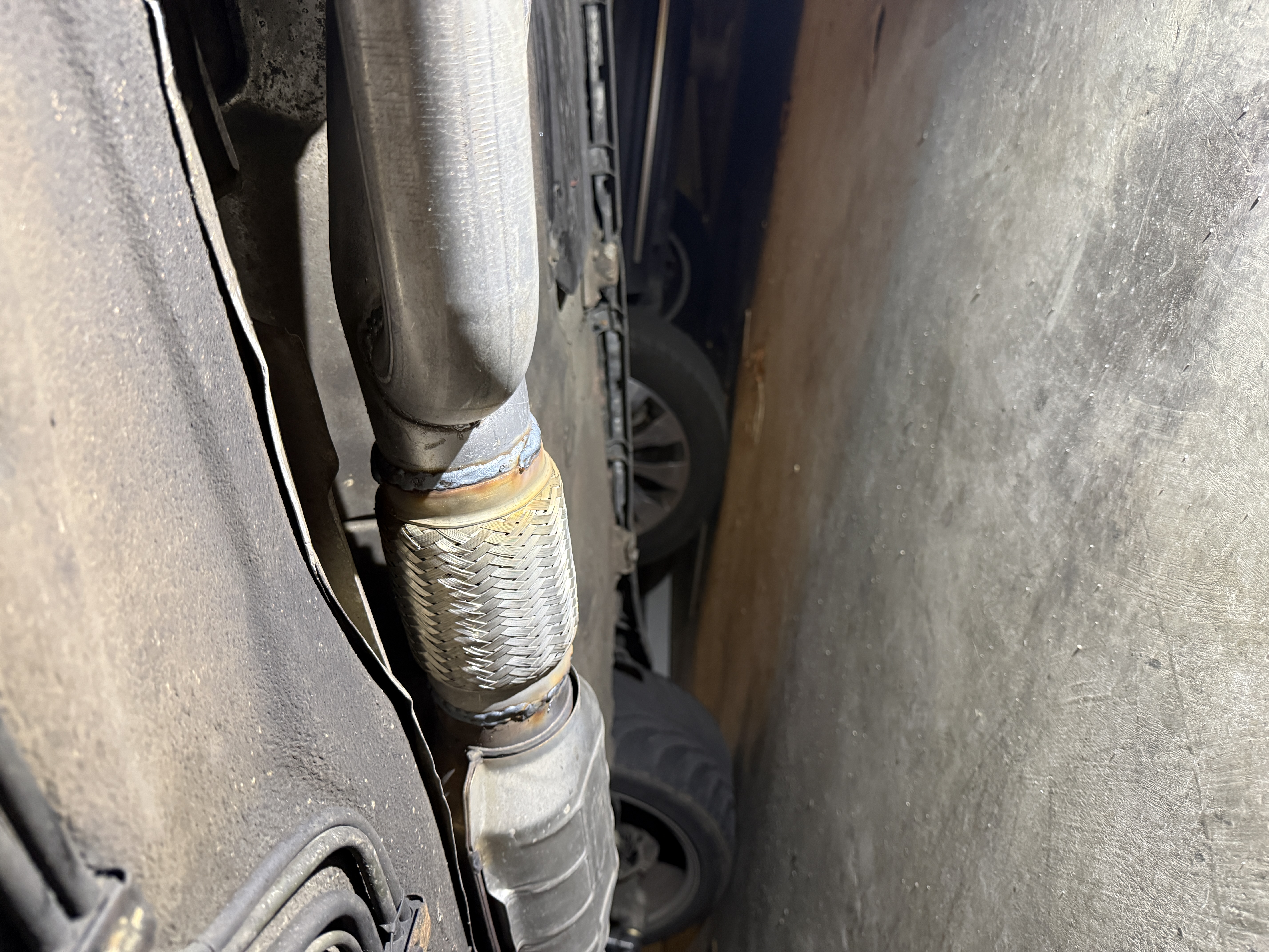

Any pictures of this? By 'drone' do you mean exhaust vibration/buzz, as opposed to harmonic drone from the muffler/exhaust? I do get a vibration/buzz and have it on my list to figure out. I was thinking it was the lack of wastegate bracket on mine, but now very curious...
I’ll add pictures tonight. But yes I mean all of the above. Harmonic drone, general vibration at all RPM range, and buzzing at specific RPMs. Basically, for some reason, the bigger exhaust pipes are perfect to become a tuning fork that amplifies the inherent vibrations of an our 4 bangers. So there is a science behind it. You can even buy an app that identifies the frequency in your car. You can then add a dedicated resonator for that frequency. Search for exhaust drone and flex pipe on YouTube, tons of info.

Actually correction, the flex pipe was placed before the CAT as you can see in the picture. Not the prettiest welds but they do the job fine.
I’m not using the wastegate bracelet/brace either.

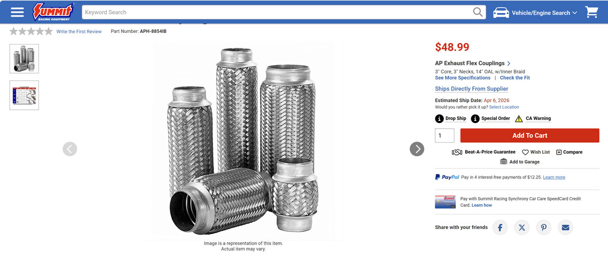

I think my rattle is different. Only happens when cold, and sounds like metal vibrating against metal. But I like the idea of the flex couplers in general. Summit has them in every size imaginable too for the DIY types..
