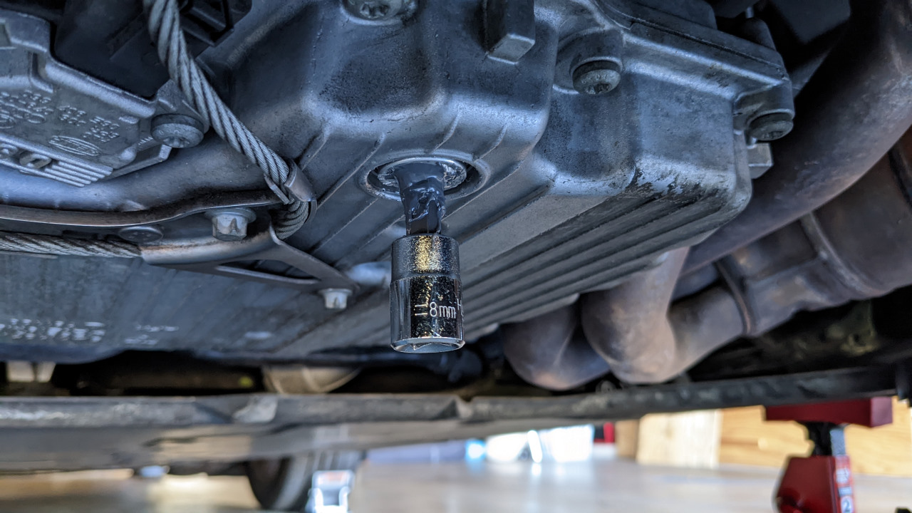

Rounded out the hole in the oil drain plug on my Cayman. Tried to dremel a slot and back it out with a screwdriver; no go. Tried to get it to turn with a chisel and hammer; nope.
Lesson learned--when faced with a rounded out allen head go straight for the JB Weld and a sacrificial bit.
Well that wasn't so much fun...

Yikes, not the Cayman you want to be messing anything up on, that's for sure. I did the exact same thing with JB weld maybe 25 years ago the first time I tried to get he 944 transaxle drain plug out. I tried oversized torx bits, chisel, slot, etc. The JB Weld was kind of a Hail Mary before more drastic measures, but it worked like a champ.
My lesson learned was to replace the drain plug with each oil change. That aluminum socket hole last for at best two oil changes. The JB Weld is a good Idea. I had the brass fitting slip out of my old 68 VW Beetle carb on the highway almost 40 years ago. FIRE HAZARD! Once I limped it home JB Weld fixed it and is still holding today!
