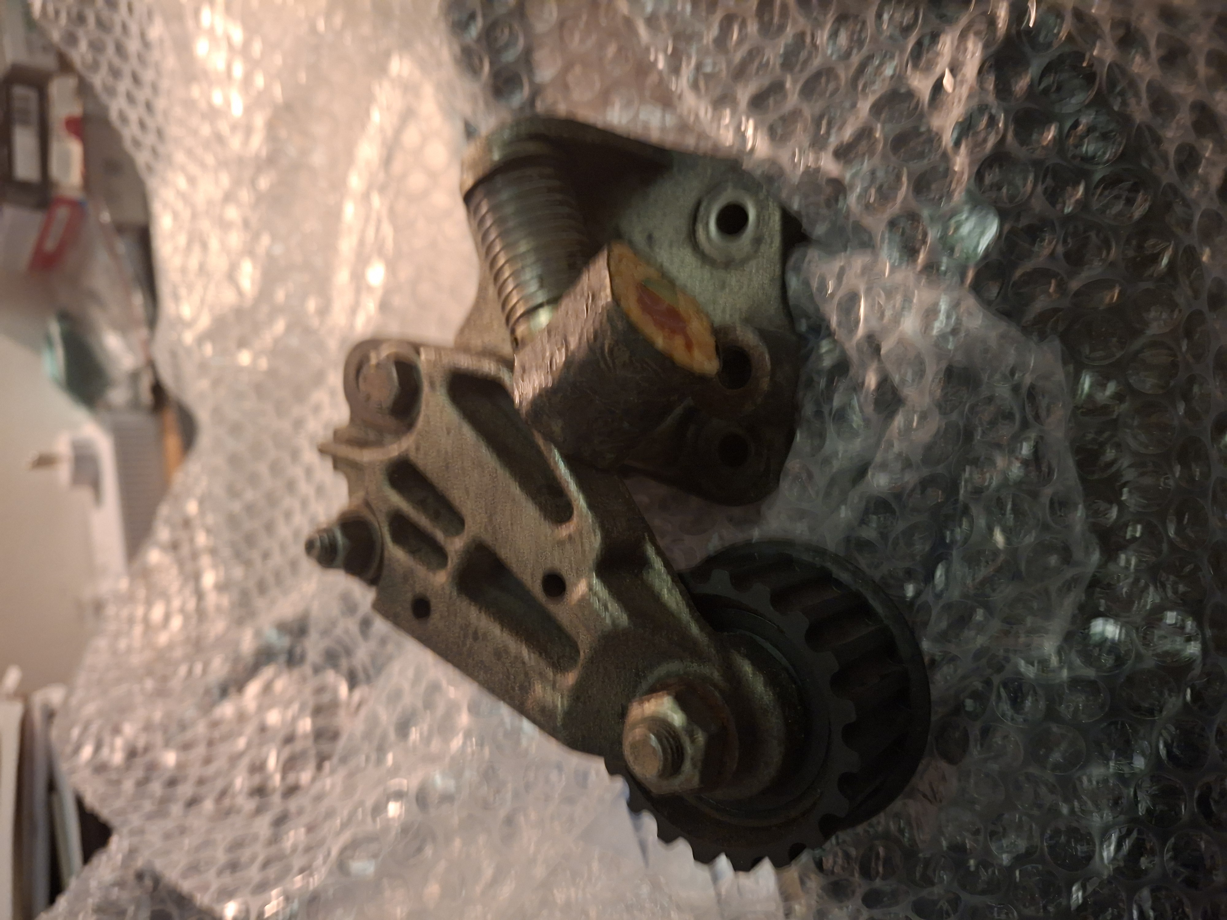

So now I've got a block with the latest updates, and among the things that are different with my existing stock of parts, there's the spring tensioner, and I thought I'd save a few bucks by looking for a used one, instead of ponying up 650€ for a new one, even though it's available.
During my search, I found a late alloy one, which turned out to have exactly the same problem as the one that Tom showed in his Wall of Shame post. A bad heli-coil repair on the pivot stud boss. Now I've got a couple of the second generation iron tensioners around (with the adjustment tool holes), and considering that stripped out stud bosses seems to be a problem with the alloy version, I'm thinking I might be better off using the iron one, even though it weighs a good kilo and a half (almost 3lbs) more.

Iron tensioner? Have a picture of the one you say is iron? Does a magnet stick to it? I've never seen one made of iron, so I'm intrigued.
For the life of me I have no idea how those threads get stripped. Makes no sense to me. Only thing I can guess is that people are wildly over tensioning the pivot nut -- but even that seems unlikely. I almost wonder if the factory helicoiled those threads for added strength and they sometimes pull loose when loosening the nut? Interesting that you came across a stripped one -- the one in the wall of shame is the only stripped one I've ever seen. In the grand scheme of what's reliable and what's not, I wouldn't worry about the spring tensioner being fault prone.

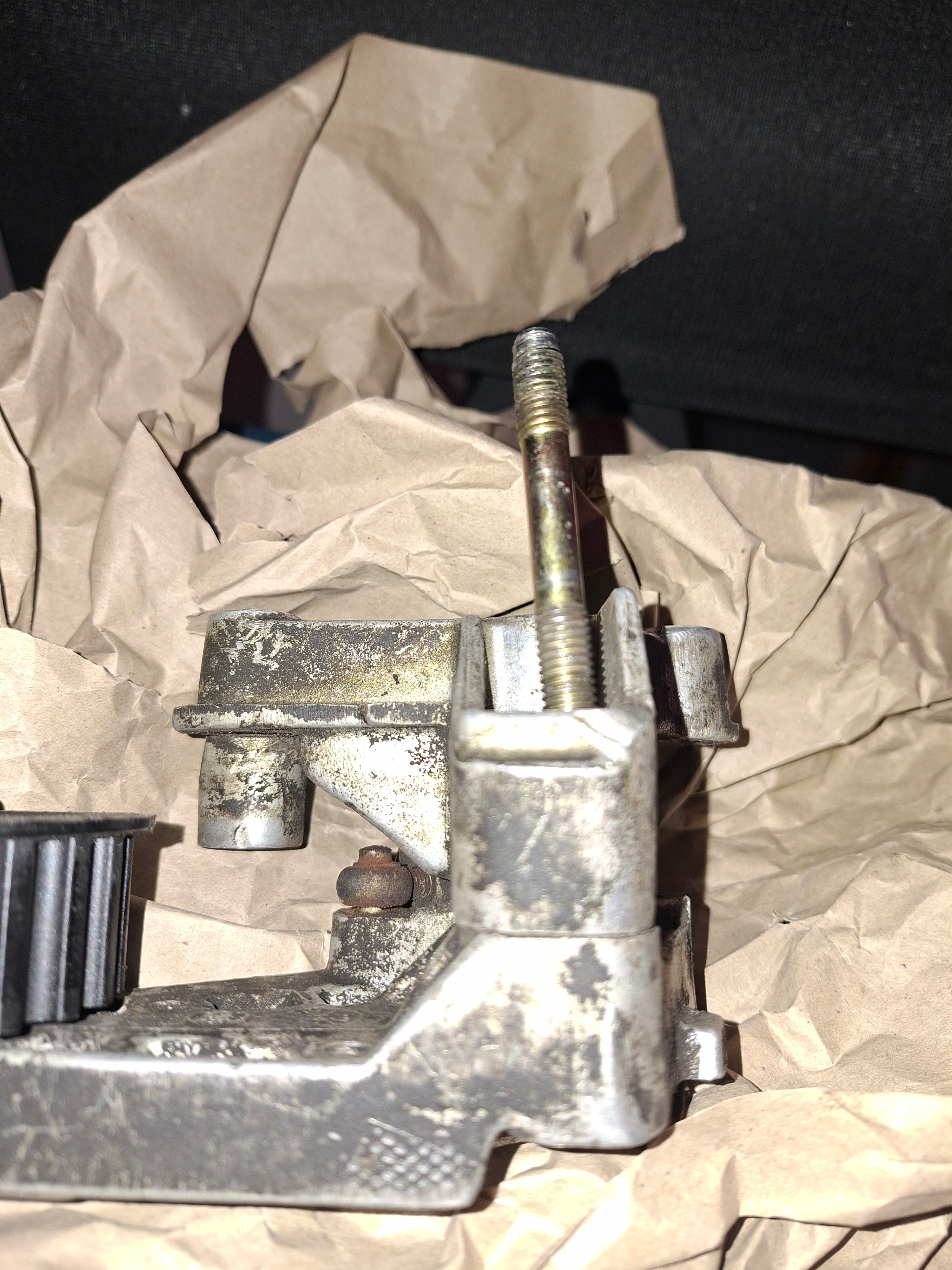

The stripped stud and a photo of the good side of the stud screwed in from the back, showing the heli-coil was not straight. The heli-coil was inserted from the back, and the tang was removed, but it wouldn't thread properly from the front side, so it looks like a previous owner/repairer just hammered the stud in until it stuck. When I got it, it was doing the "bobble thing" you described in your Wall of Shame post.
