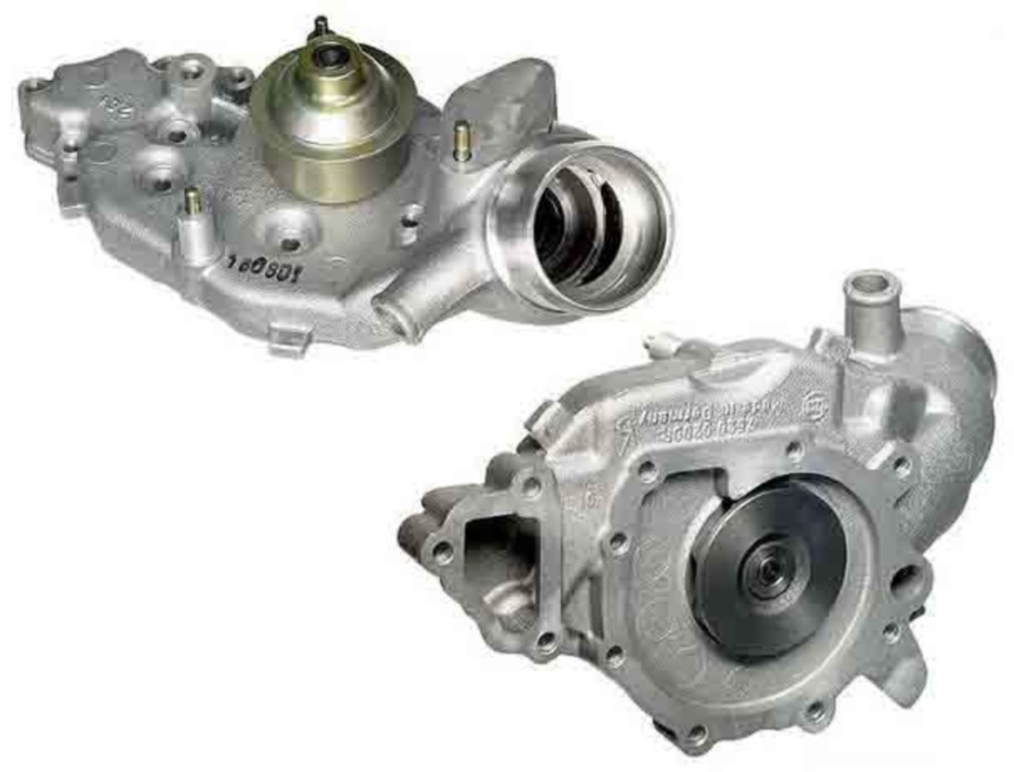

@CarBot here is a photo of the thermostat I have installed in the car. I would refer to the thermostat thread but the link isn’t working

BennSport wrote: here is a photo of the thermostat I have installed in the car. I would refer to the thermostat thread but the link isn’t working
That photo is of the water pump assembly, not the thermostat itself, so I can’t ID which thermostat you have installed from that image.
On your 1983 NA, the correct thermostat is normally the early style 944.106.019.00. The later 944.106.129.05 is for the later thermostat/housing setup.
If you want to confirm what’s actually in your car, the easiest way is to pop the thermostat housing and look at the thermostat you pull out, or post a photo of the thermostat and housing once it’s off. If you’d rather not open it up yet, a photo of the front of the engine showing the thermostat housing area and hose routing can sometimes hint whether it’s early or a later swap, but the thermostat itself is the sure check.
