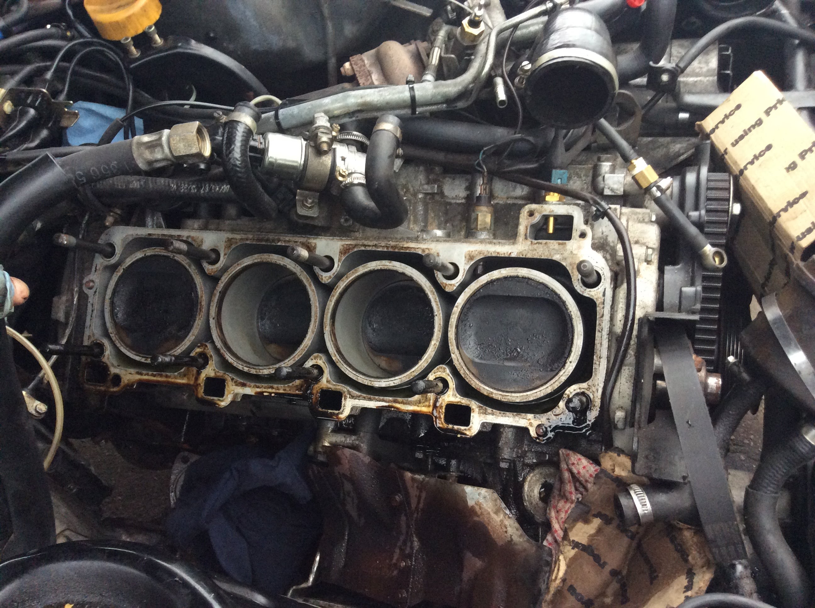

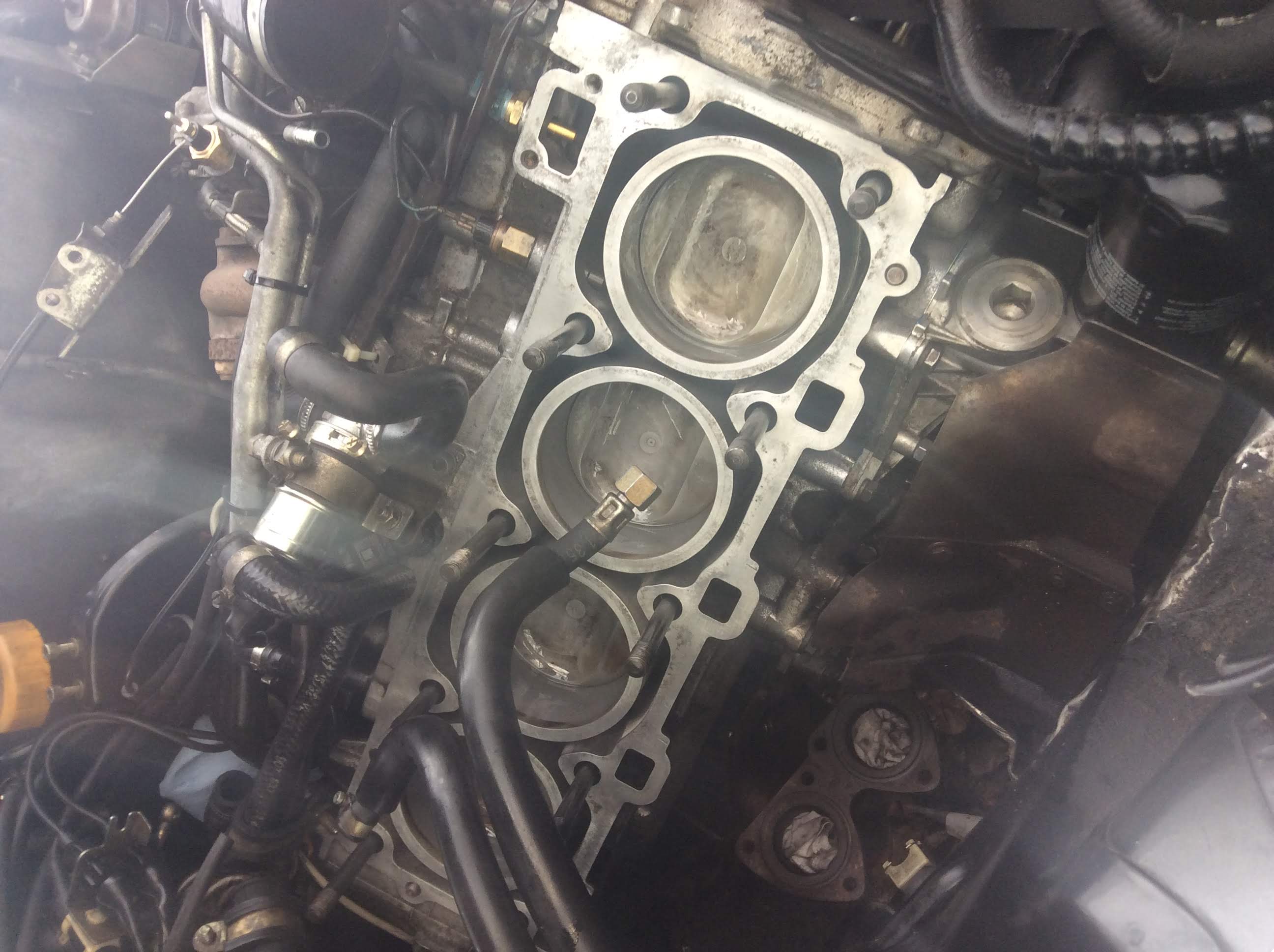

At aprox. the 200k mark I did my head gasket and this was the carbon on the top of the pistons..
I doubt any oil would have scrubbed that clean; took quite a bit of elbow grease and scotch pads..
I say wait until you need to open it up and clean manually. In the meantime, use proper oil like 10w40 or above and keep the bearings alive
