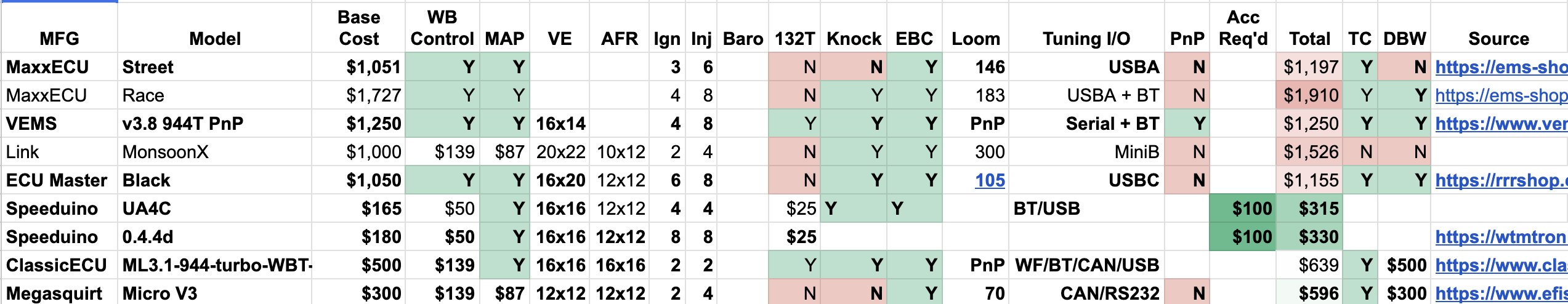

With that in mind, I evaluated every ECU I could find. From this analysis, the ECUMaster Black bubbled to the top for its features (IP67, built-in WB control, MAP control, and knock) and price point (esp. considering loom pricing which would justify an adapter loom at first, and a full rewire down the road), but still wasn’t plug and play, and sourcing male headers for both Motronic connectors was proving challenging.
Then I dove into Speeduino, starting contemplating printing my own breakout or daughter boards, and stumbled across ClassicECU who had already done exactly that, including the built in VR to use the stock speed and position sensors and 132T wheel. I got in touch with Dirk at ClassicECU and he was super responsive - AND it turned out I would be the first 951 customer, so could help him develop the base tune for our cars. That sounded like unnecessary fun, which is my favorite kind, and another opportunity for me to learn more about my car and tuning.

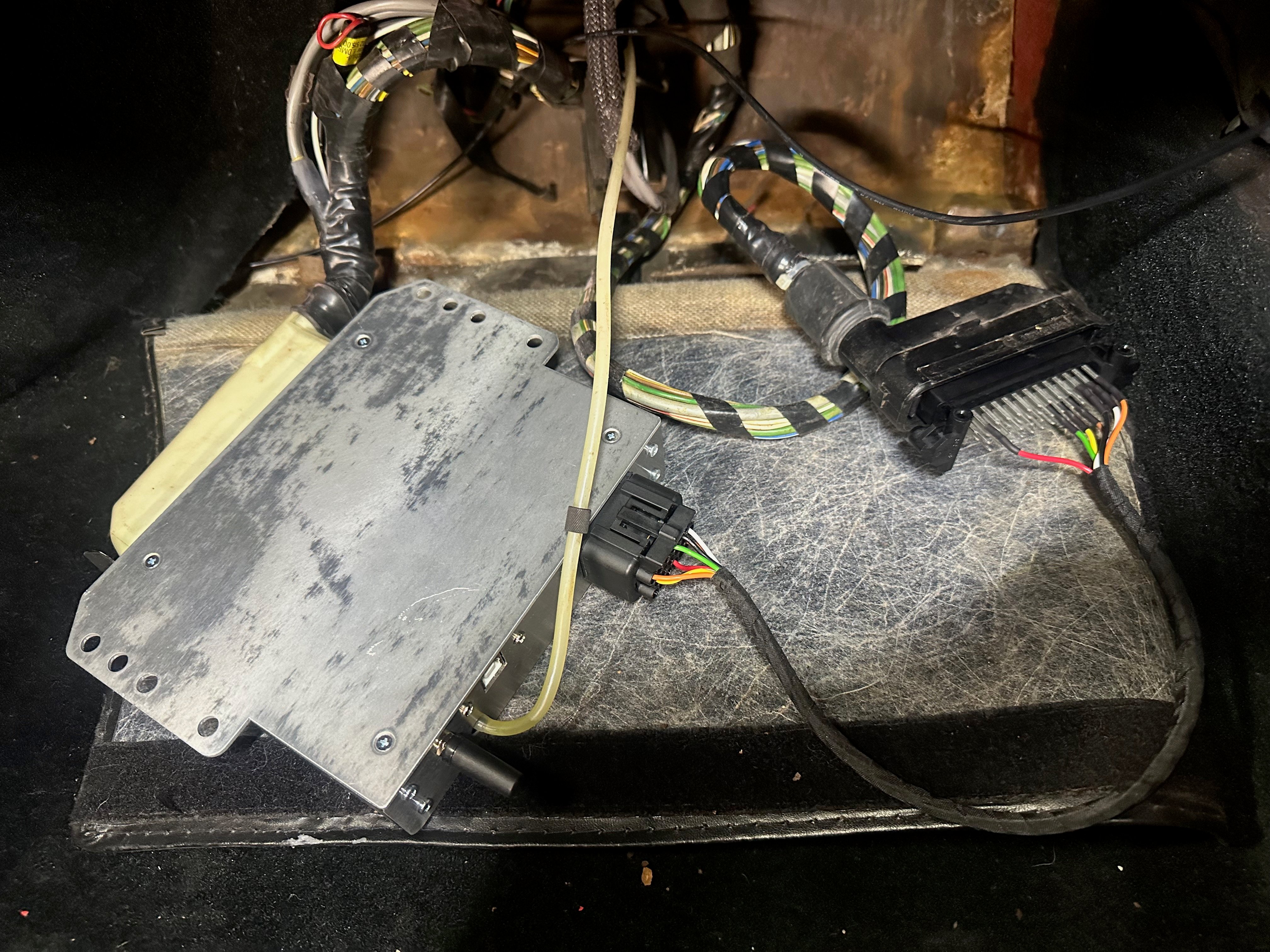

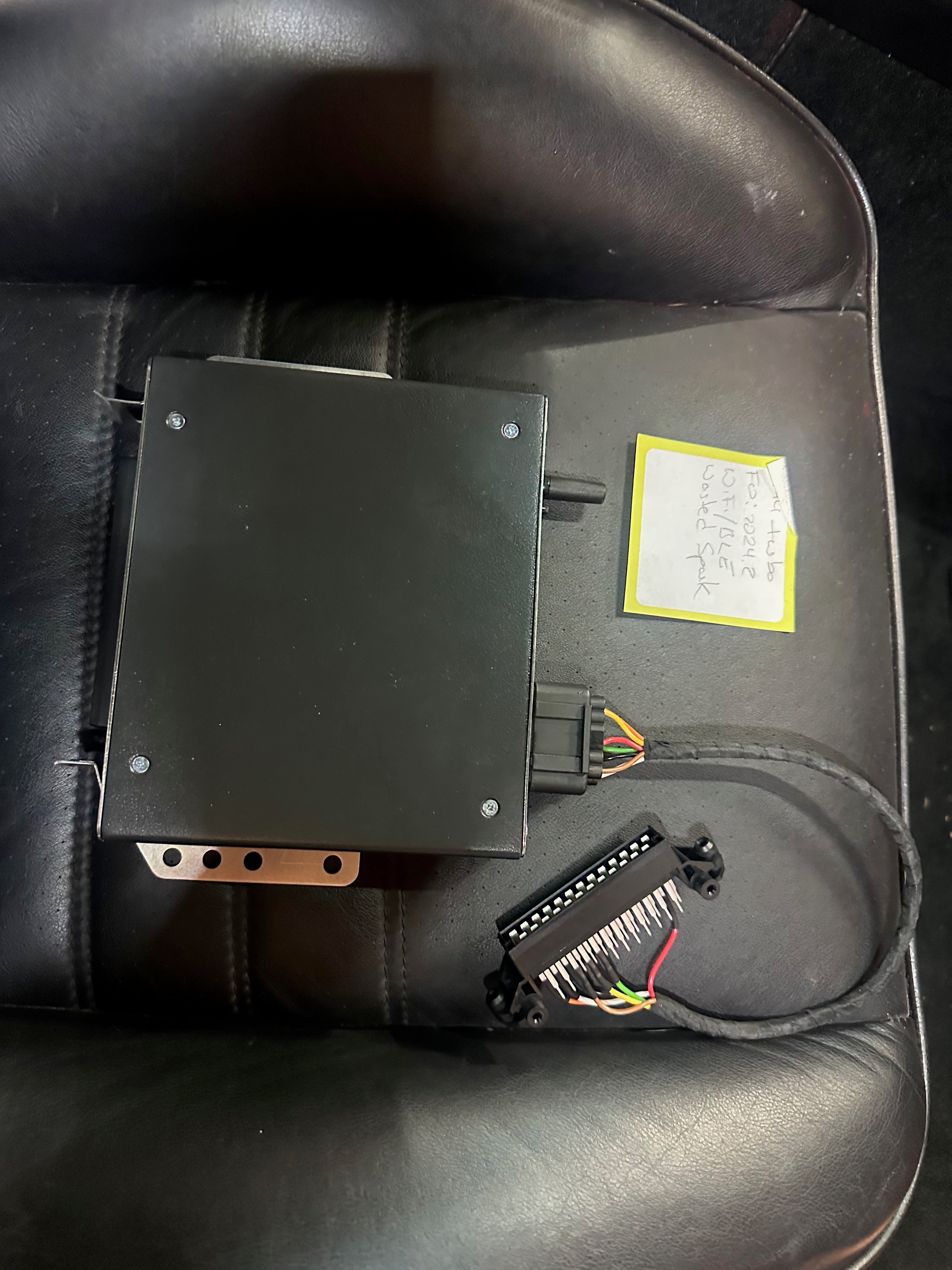

So this weekend, I finally got around to stage 1A. Aside, from discovering some unfortunate rust under the passenger side carpet, plugging the ClassicECU ML3.1 951 (henceforth "ML3") couldn't have been easier. It runs on the standard AFM, speed/pos sensors, and narrowband 02 so you literally don't even need to open the engine bay. ________________________

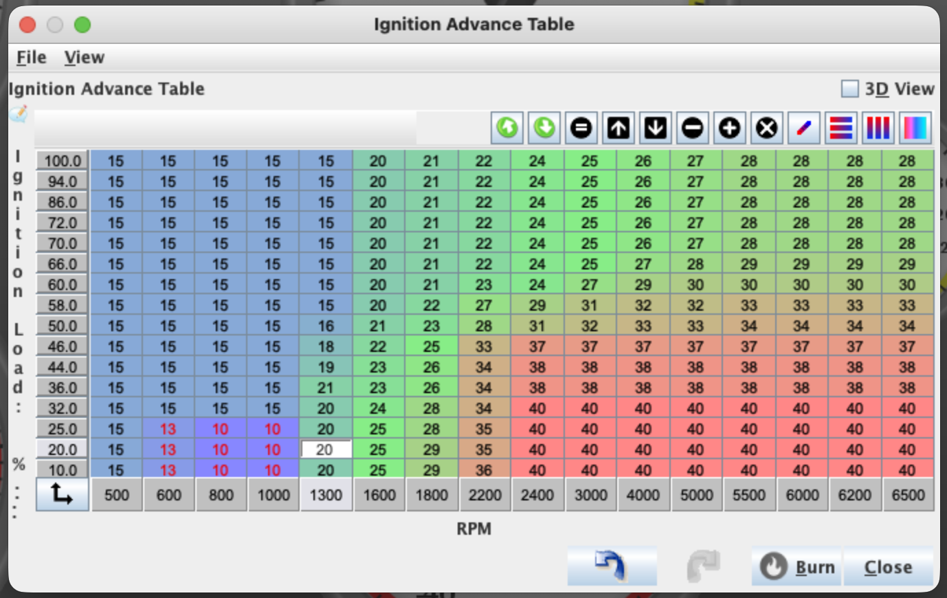

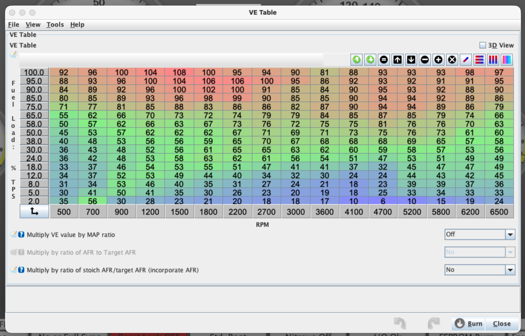

1. I started with the base tune provided: ML31_R102_T41_FW202402.2_944_turbo_2025_12_07_TPS.msq
3. I *then* went through an idle tuning sequence without idle controls as recommended in this YT video
5. Second discovery was that the fueling in the base tune was extremely rich at 50, I started at 30 and ended up landing on 15, which also allowed me to close the idle screw at the throttle a touch more, while still maintaining a smooth 800rpm at temp. My actual target is 850RPM, but I wanted the base setting a touch lower so the idle controls could actively manage it
Base: Adjusted: 6. Third change is that I lowered the ignition advance in the idle range significantly from base settings. Using the stock DME settings as reference, and based on some Microsquirt tunes, I started at 10 degrees of advance at idle.
This got me to a stable idle at least at operating temp. Next step was to get the Idle Controls working, but this didn't go quite as planned...

Confident in my base idle settings, I then turned on Closed Loop Control. The car seemed to run well, however:
Other side note is that the LSU ADV Pre-Turbo sensor I tracked down uses a non standard Male 02 sensor connector, so I ordered up the correct/standard female connector and will have to swap them and hope I get the pinout correct. It is a great deal on that sensor but I'm guessing they connectorize it differently to avoid mixing up the pre-turbo and post-turbo sensors on those BMWs?
- the car was warm so I wasn't able to test how well it tracks during warmup
- the idle advance table seemed to be running backwards in Tunerstudio. I know that sounds bizarre, but when the engine was running over target (e.g. 950rpm), Tunerstudio was calling that negative delta (i.e. "-100") and calling for more advance (e.g. "+2 degrees). You can see in this example image below, with the car at 0RPM, the idle advance is looking up the +200 and calling for -5 degrees of advance.
- because I was not confident in my interpretation of the table, I decided to stop with tuning for the day.

Cool project, here are a few thoughts
For closed loop idle, I think you need a PWM style IAC (such as is found on the S and S2) and I dont think the oem 951 IAC is setup that way (correction - @johnb confirms that it is PWM), since those still use a idle adjustment screw and idle isnt dynamically controlled with the ICV. Closed loop isnt necessary and open loop idle can work fine, so I might focus more on staying in open loop and getting my base tune setup and then come back to figure out closed loop as something you come back to once the car is running well.
Since you are running standalone EMS now, you can toss the AFM and change to a speed density setup (as opposed to the oem air metered system) or change to a MAF. Speed density requires a MAP sensor and IAT sensor (I am using a GM IAT) and ideally a variable TPS, which the 951 has. Doing so will remove the air restriction of the stock AFM, and replace with a dedicated IAT, which is a big benefit, especially on NA cars. Alternatively and more simply, you can incorporate a MAF, but either way, youll want to get rid of the AFM. I have read that on a turbo car you can potentially max out the MAF's ability to meter air, which is why speed density is preferred. Here is the kit I bought from diyautotune and the pipe with bung already welded (if you cant weld the bung yourself) - although you could run any IAT sensor as long as its calibrated in TunerStudio.
Idle timing advance may not be needed (could be turned off) since you already have that sort of built into your timing table (as you are already increasing timing below your target rpm in the timing table). I ran it for abit, didnt notice a huge difference, and I dont think timing affects idle speed as much as air (ie: your IAC settings) and fuel.
Also, since this is a turbo car you may want to increase your binning on all your tables to go above 100kpa (better to go to whatever kpa your max boost is, such as 200kpa). 100kpa is fine for a NA car though. 100kpa basically equals atmospheric pressure at sea level (which is the same as WOT on an NA car), below 100kpa is vacuum, above 100kpa is boost. I also notice in your bottom row of the VE table, you have the fuel drastically reduced. You may be better off using "overrun fuel cutoff" instead of reducing fuel in those lower cells, based on a minimum RPM and minimum TPS % (I use less than 1500rpm and less than 3% tps to activate ORFC). The reason is when you are cruising around parking lots, with your foot barely on the throttle, you may be using those lower cells so you may not want them overly lean (at cruising you can aim for AFRs closer to 14.7 or sometimes higher to maximize fuel economy) and it may want to surge or run poorly with that low of fuel.
I have gone through this process on my S2 running megasquirt/tuner studio. My tune isnt perfect and still has work to go. I have found running open loop idle works fine and I havent really figured out closed loop yet (ie: perfect mix of PID settings). Having a variable TPS also greatly helps with acceleration enrichment (imo, TPS > MAP accel enrichment)
Also, I assume you have a wideband O2 sensor, but if not, this is going to be absolutely needed in order to tune the car further. I am using the Innovate MTX-L, but any unit should work
Lastly, the Turbine Research videos you linked are good ones. I used the same to get my car setup
GM IAT sensor in place of AFM from DIYAutotune and a universal coupler

Fun project! I’m down a similar path with my MicroSquirt-based ECU. Definitely lots of learning left to do on my part.
Looking at your plan, overall I think it will be a great educational experience, but the way you’ve mapped it out it seems like you’ll be doing a lot of re-tuning at various stages, e.g. when you switch to MAP/IAT, then when you upgrade to a 3Bar FPR/bigger injectors, and then again when you upgrade the turbo. Might make sense to not go too deep on fine tuning (e.g. the idle stuff) in the early stages until you’ve got the basics of your setup in place.
In a similar vein, if you haven’t done it already, you might want to spend a little time assessing the state of your wiring harness, especially around the injector wires/connectors. My harness was badly eroded in a few places, with crumbling insulation and exposed wires. This can make tuning a nightmare. Luckily its relatively straightforward to patch up minor damage if you discover it.
I noticed you’re running with “incorporate AFR” turned off. Is there a reason for that? I assume this works the same in Speeduino as it does in MegaSquirt. If so, then in my mind, it doesn’t make sense to not take advantage of the logical separation it gives you when tuning the VE table vs. setting target AFR. Additionally, should you want to switch it on in the future, this would be another point at which you’d have to re-tune (although it is possible to back calculate it if you have the right initial settings).
- Dare
- Posts: 32
- Joined: Wed Mar 16, 2022 3:03 pm
- Location: San Jose / Palm Springs
- Has thanked: 19 times
- Been thanked: 16 times
The 951 IAC supports PWM and the DME is wired to be able to use this (although I don't know what the factory DME firmware does in practice).walfreyydo wrote: Mon Mar 09, 2026 5:22 am For closed loop idle, I think you need a PWM style IAC (such as is found on the S and S2) and I dont think the oem 951 IAC is setup that way (someone feel free to correct me if I am wrong here), since those still use a idle adjustment screw and idle isnt dynamically controlled with the ICV.
I have my IAC functioning in PWM mode with my microsquirt ECU, but I haven't spent any time tuning it. Indeed, since mine is a track car, I might end up ditching it altogether, since I don't really care about idle quality per se.
