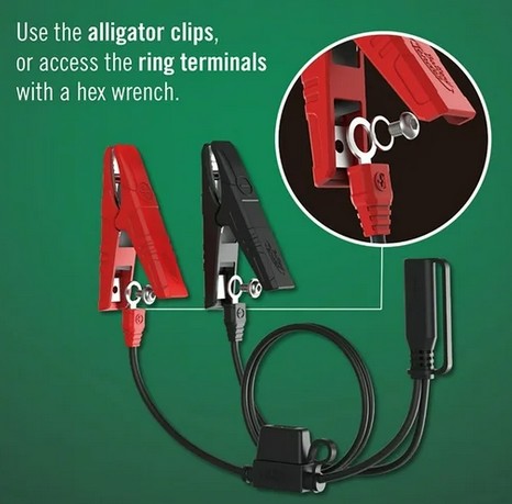

I just bought a Ctec 5 for my 85 Targa. My previous battery only lasted 4 years because I don’t get to drive it as much as it’s my weekend fun car and sometimes weather and life get in the way. Anyway, I was wondering if anyone here has experience with using a trickle charger for a G body as I’m not sure I should connect to both the positive and negative terminal or if I need to find a place to connect the ground in the frunk. Thanks
I use the battery tender on all my cars. They come with a wire that can be connected to the battery terminals, and the other end has a plug so you can easy plug and unplug.

Like Carmagic, mine is hard wired to the battery terminals with that little pigtail hanging free (up by the windshield wipers for easy access). If you do it that way, hooking up the charger is just a matter of plugging into the pigtail and turning it on. If you use the alligator clips, be sure the engine's off and key is out, and the trickle chargers is off/unplugged, then (for cars without a remote power post) clip the red cable to the positive battery post and the black to a chassis ground away from the battery. Gloves and eye protection are a good idea too. I'd guess most are way less careful, just putting the clips on the battery -- and you rarely hear of problems -- but no one ever regrets being too careful.
