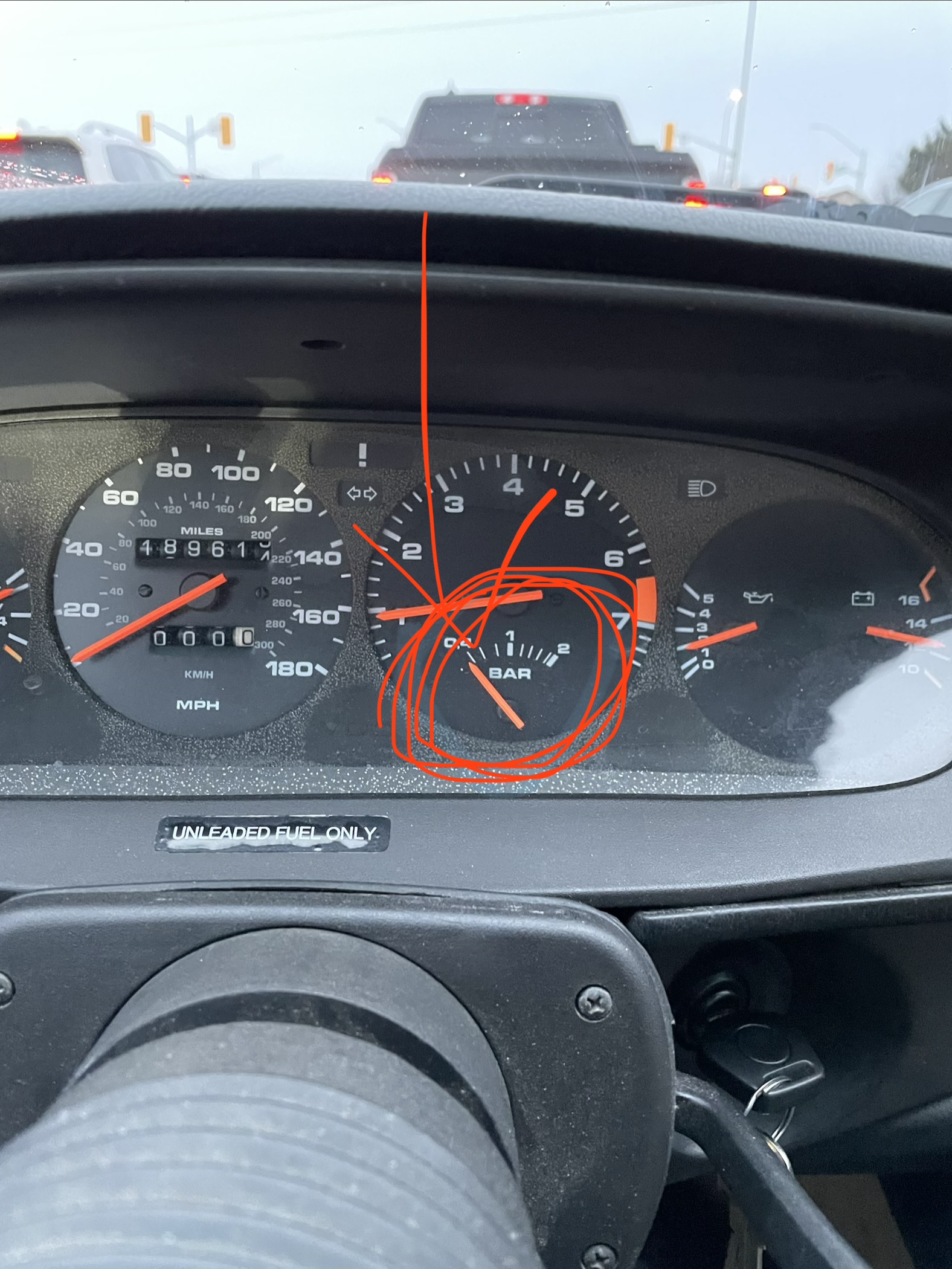

A restart and surging disappeared. Unplugging O2 sensor has no effect. Jumpering B&C at the diagnostic port (like when setting idle) results in significant idle drop.. but I won't adjust it until I check / fix vac & manifold leaks

Well it's a moving vacuum leak then as it's back to normal since the restart
It started on the highway so maybe a pattern will emerge during the daily drives this week

I was touching & moving all kinds of stuff including ISV (what I could reach) yesterday while the surging was present and nothing changed.

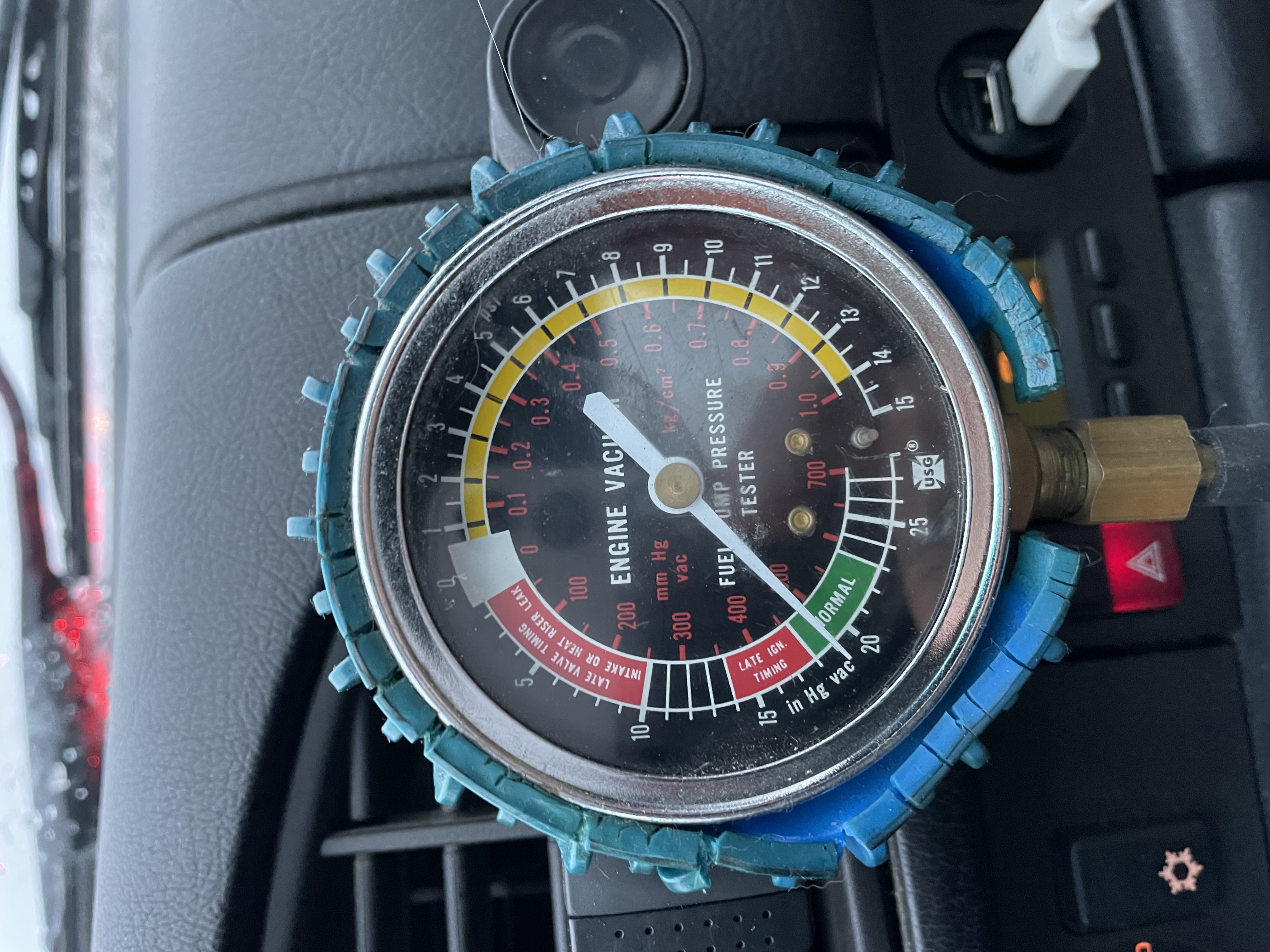

Today's drive in was uneventful.. and I also notice that vacuum is perfect; I seem to recall whenever I have a leak, gauges show a little less.. isn't that right?
