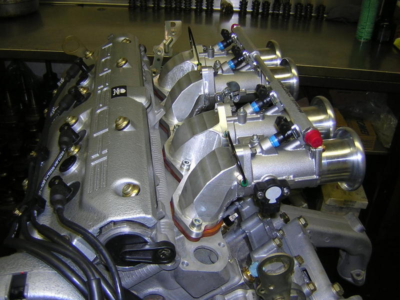

michaelmount123 wrote: Sun Jan 25, 2026 1:58 pm Targa944+200091292770901.jpeg
Looks like industrial art! Did you ever dyno with and without those risers? If there was a gain on that particular set up, I'd have to wonder if it was due to the heat insulation or just making the runners longer?

Tom wrote: Sun Jan 25, 2026 3:03 pm
Certainly pertinent questions, Tom. No, I never did any back to back on the dyno and therefore can't attest to the value. My approach back then was to make as many small potential improvements as I could with the thought that enough of them would result in a measurable gain.
