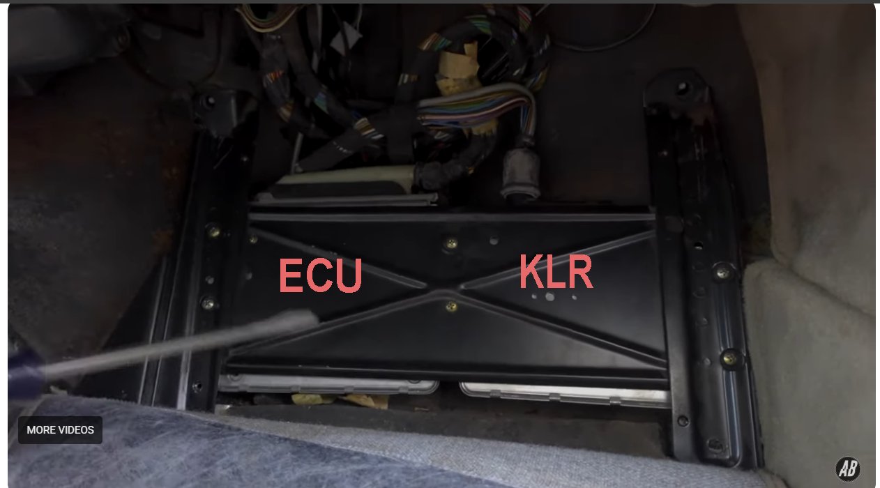

Anyone have a picture of how the OEM alarm module mounts in a 951 (with DME and KLR)?

I too would appreciate some photos. PO left all
Modules loose behind the floorboard, so I’m in search of some cheater pics too.

This picture might help... could not find any pix from the other side.
The alarm box is just clipped onto the metal frame.
944 TURBO ECU KLR MOUNTING.jpg (81.53 KiB) Viewed 215 times

See this post. :angel: It has detailed pictures of the basic 951 dme/klr orientation along with a good pic of the alarm.
https://www.carpokes.com/viewtopic.php?t=1792

I had my alarm module out last week for the first time. On the turbo, it's clipped to the back side of the bracket. If you unfasten the bracket (two normal screws on bottom and two plastic screw things on top) it's pretty easy to see how it fits back there. Although, you may want to just research how to do the alarm bypass with the two jumpers. If you are not using the alarm, then it is just a liability since when the module fails you will encounter a no start situation.
