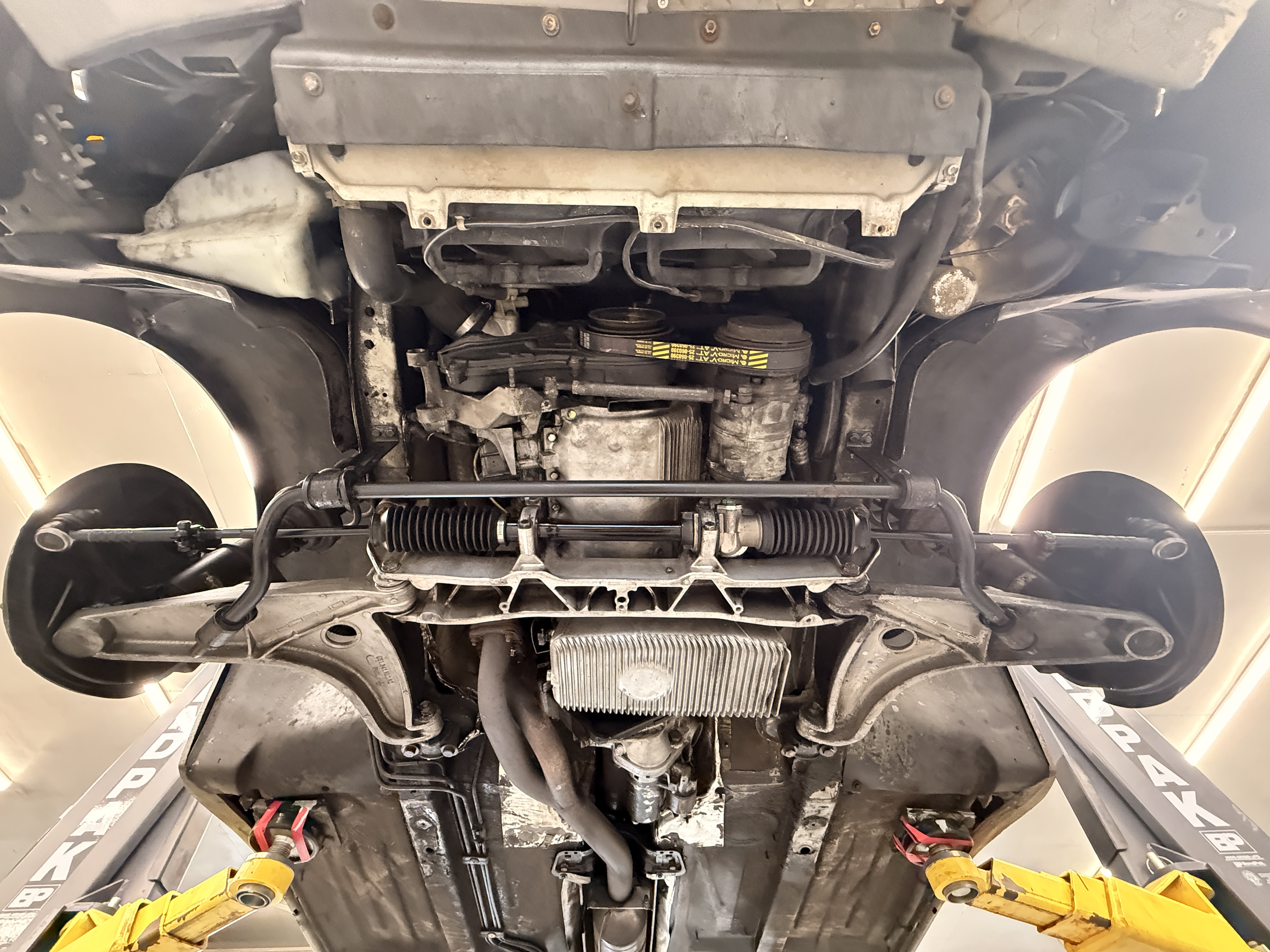

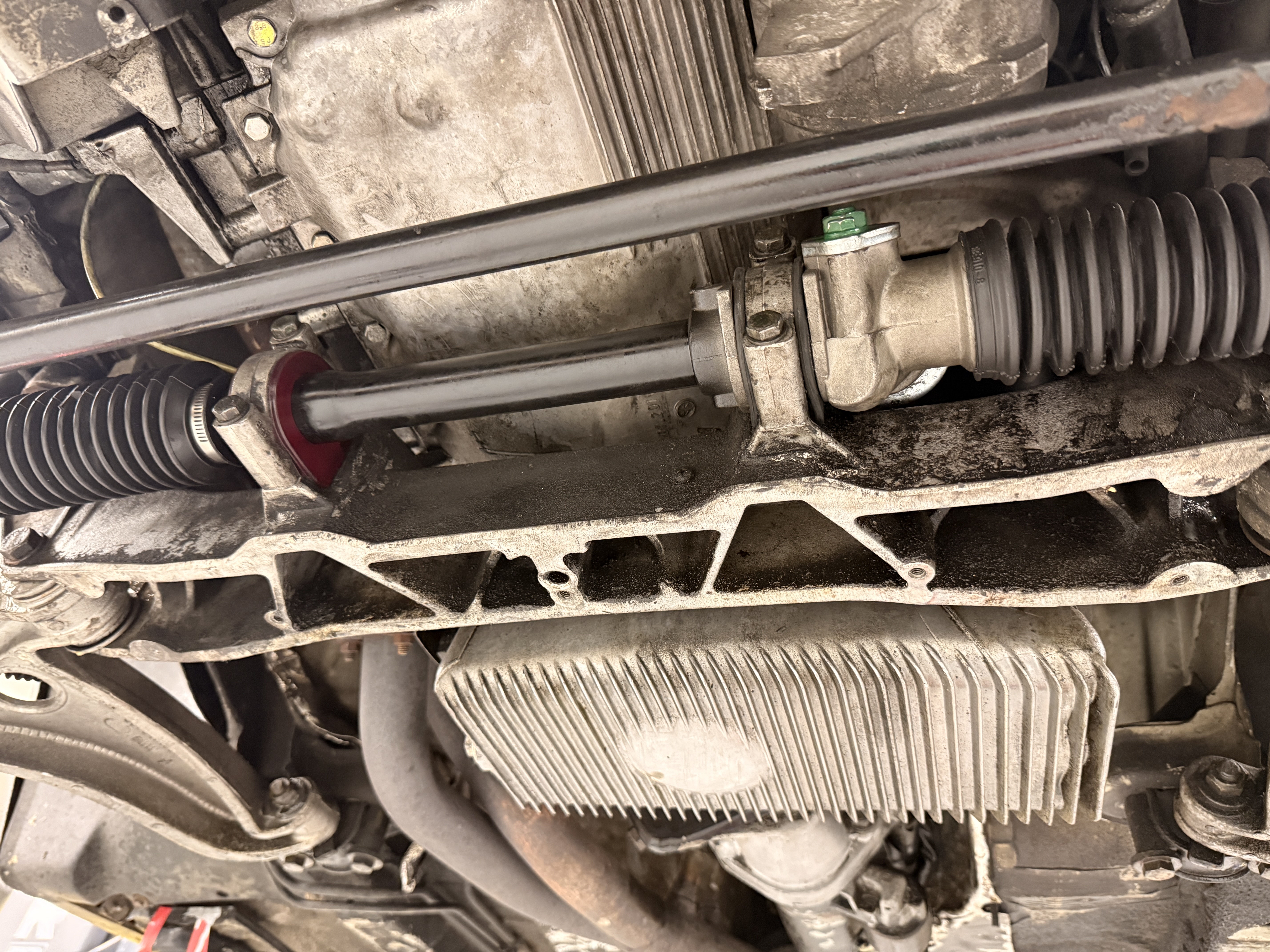

I converted my 87 NA to manual rack this year. I used a lift, made the job much easier to manage. Also had some friends/family come by and help. Anyways- I wouldn't recommend doing a dirty "depower", the rack internals are not really intended for that.
Not a sales pitch: I went with this kit: https://mwthemachineshop.com/steering-solutions
They were quick to ship and supported a few questions by text, which was nice. The kit is actually very nice! I followed up with a 1600 mile road trip along some intense back roads, where I really enjoyed the tighter steering and enhanced road feel. In fact, I was doing 90 at one point and felt the slightest of vibration, stopped, and found 1 lug nut just shy of tight... torqued, vibration gone.
Now, you will fight the car parallel parking. I replaced the stock steering wheel with a larger 380mm Sparco with momo mount. That helped a little. I also own 2 cars without PS, so Im use to it.
Here are some photos of the kit installed. If you look close you can see my bloated ass sway bar bushing from a many year shower of steering fluid...

I converted my ‘86 951 to this same kit two years ago. Fortunately had a buddy with a two post hoist - much easier installation. I would agree that parking lot type maneuvering builds your upper body muscles but once you are up to speed - corners are a joy
