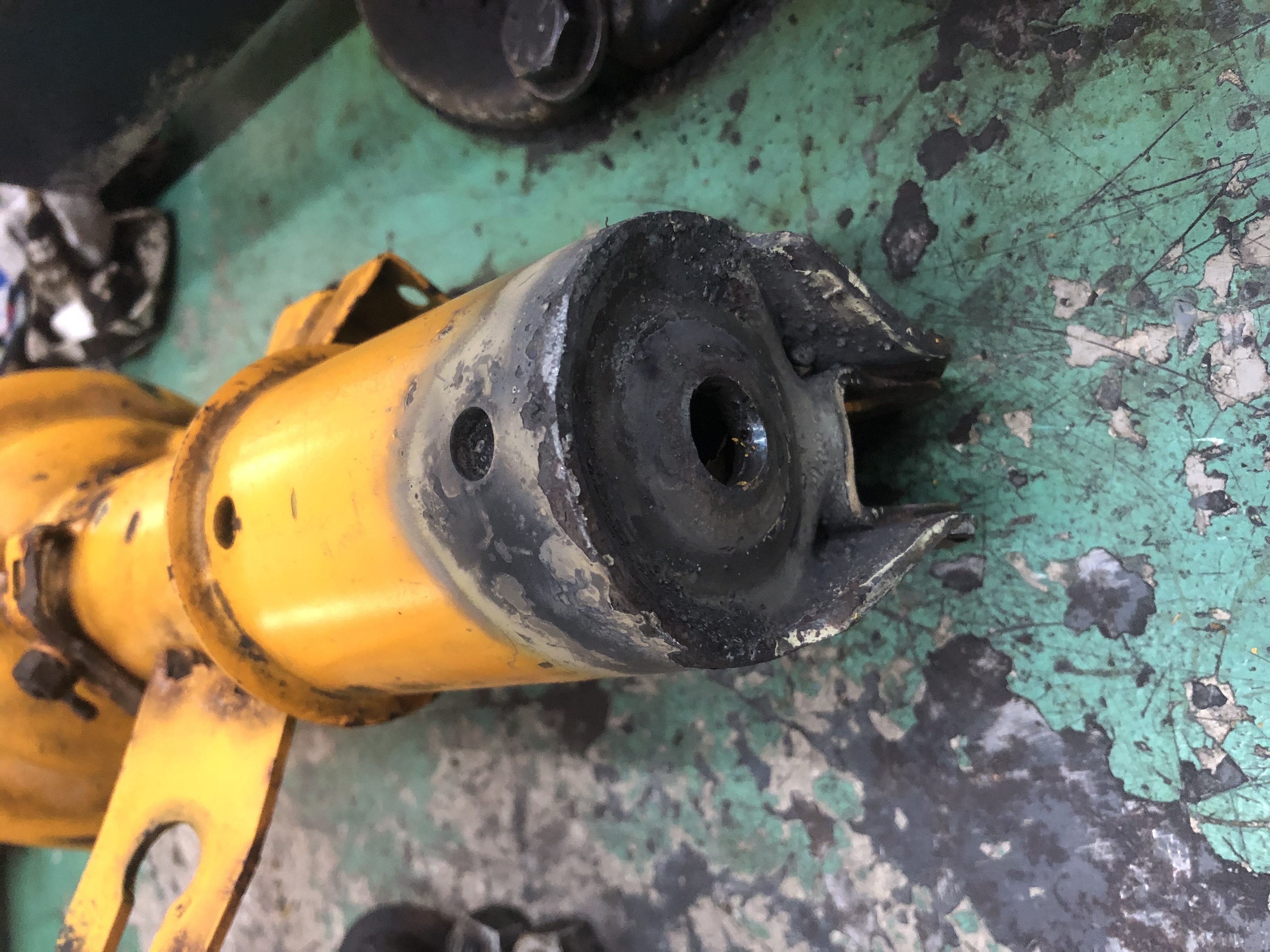

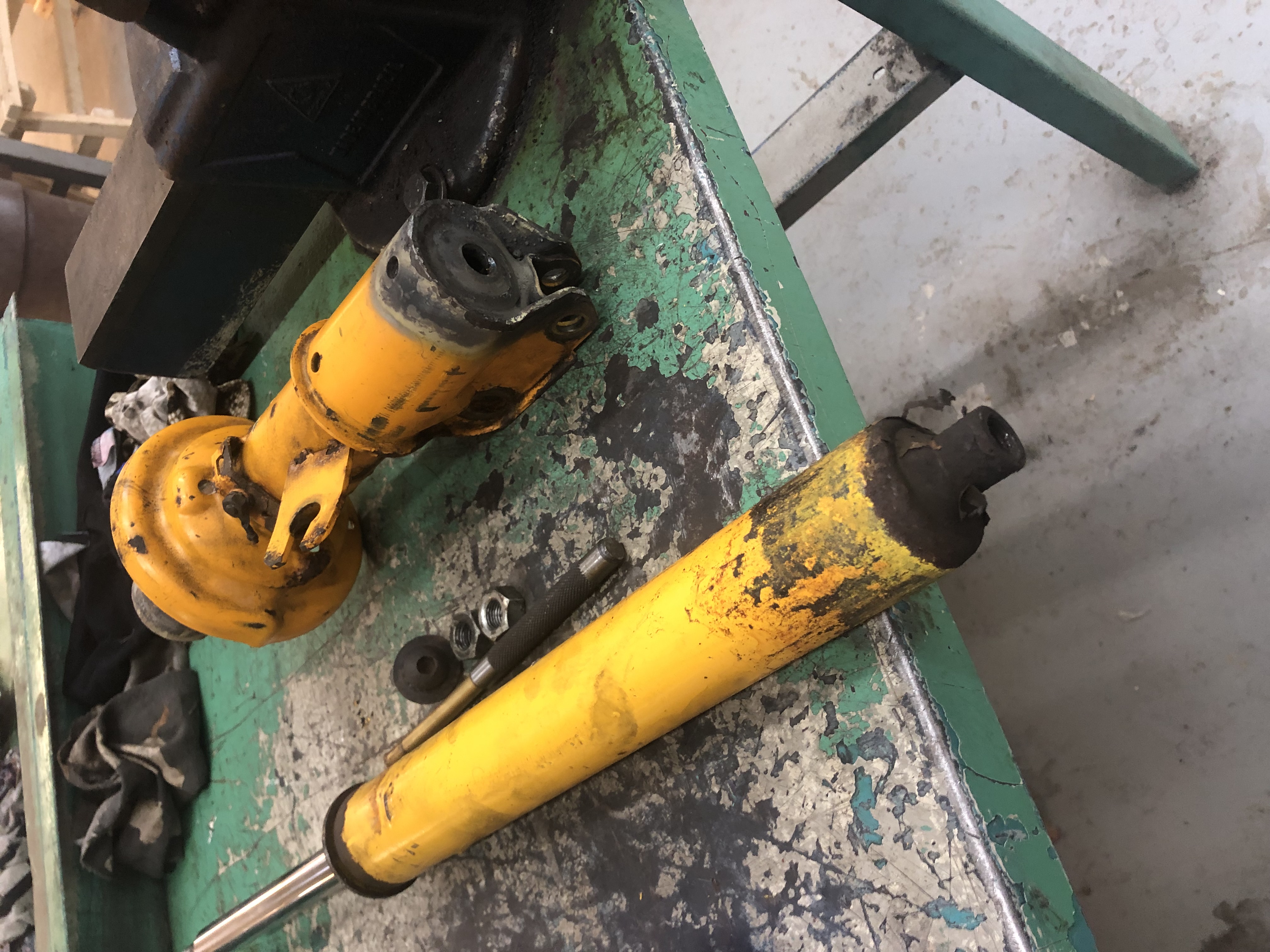

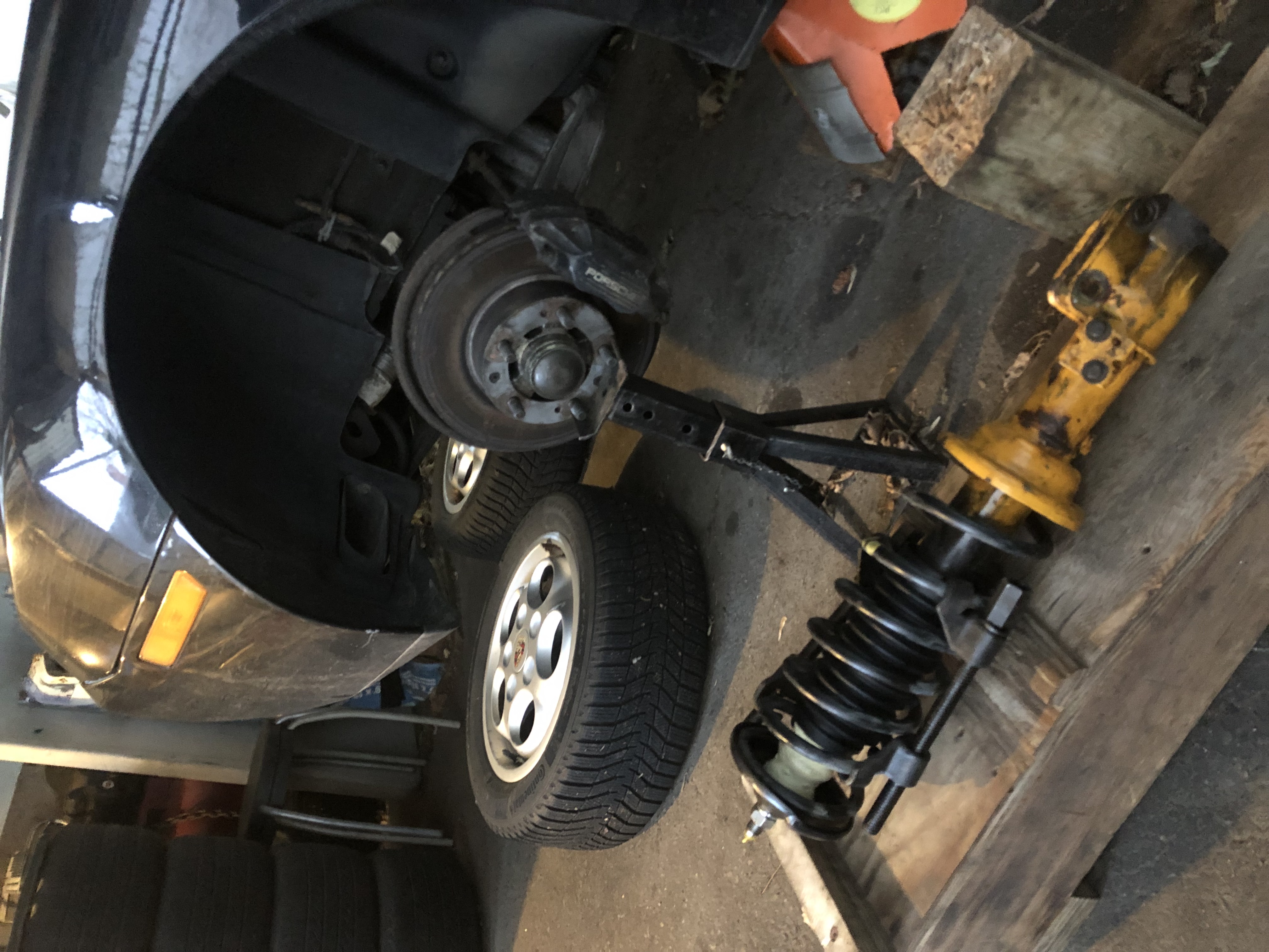

I can't get this 12 year old insert out

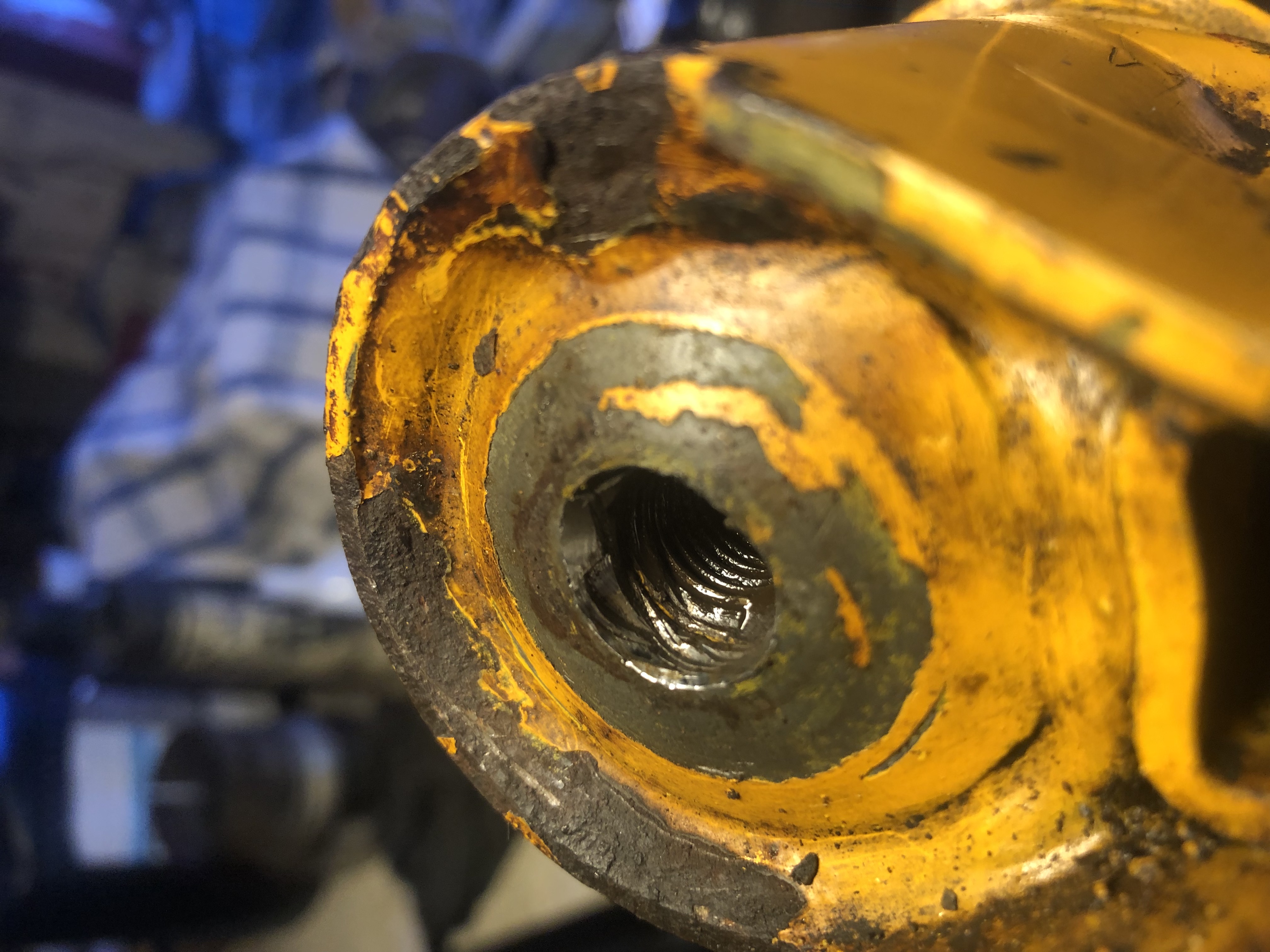

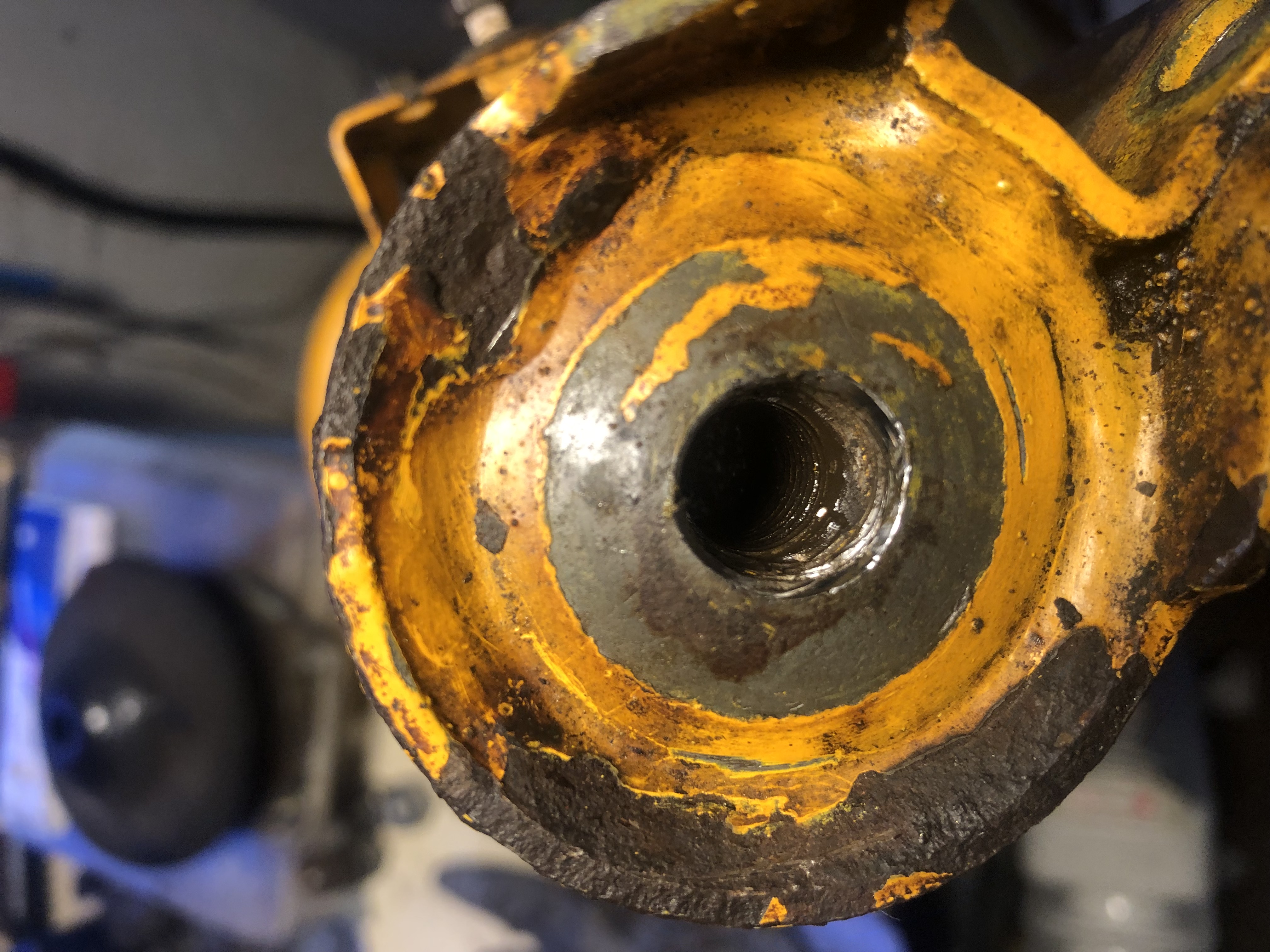

Seems to be rust-welded at bottom where the nut was
Tried drilling it a bit there just to expose it's now solid with the housing
Help

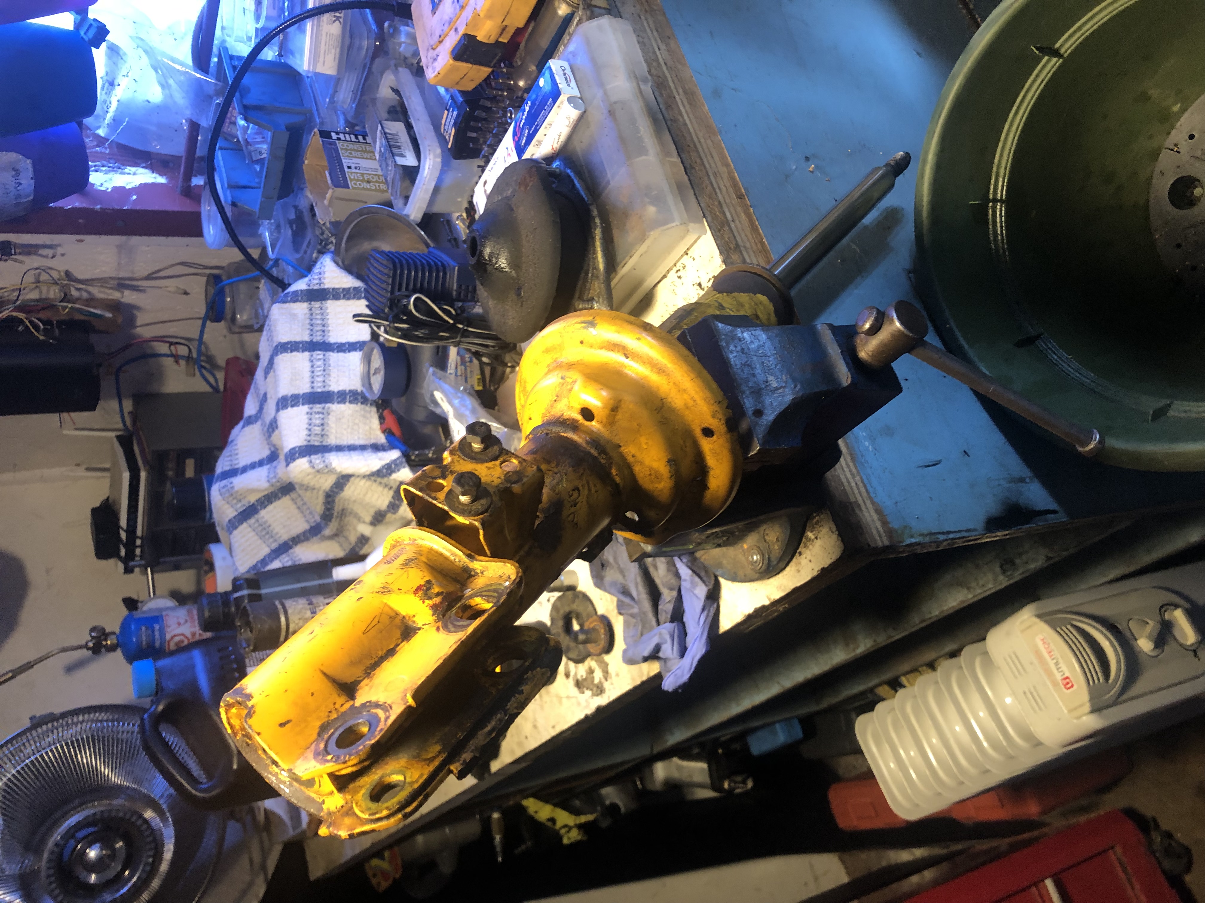

danmartinic
Posts: 291
Has thanked: 23 times
Been thanked: 41 times

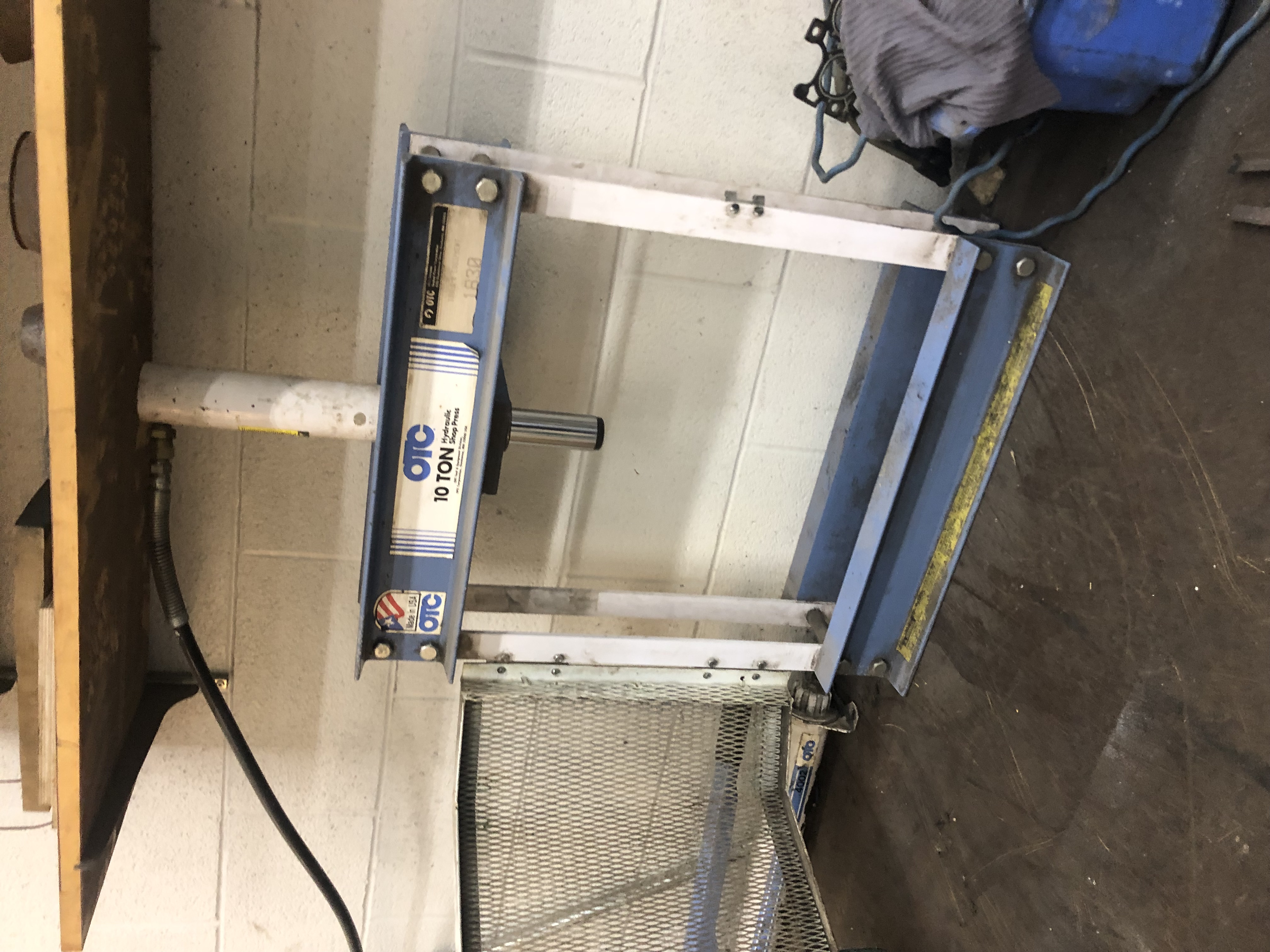

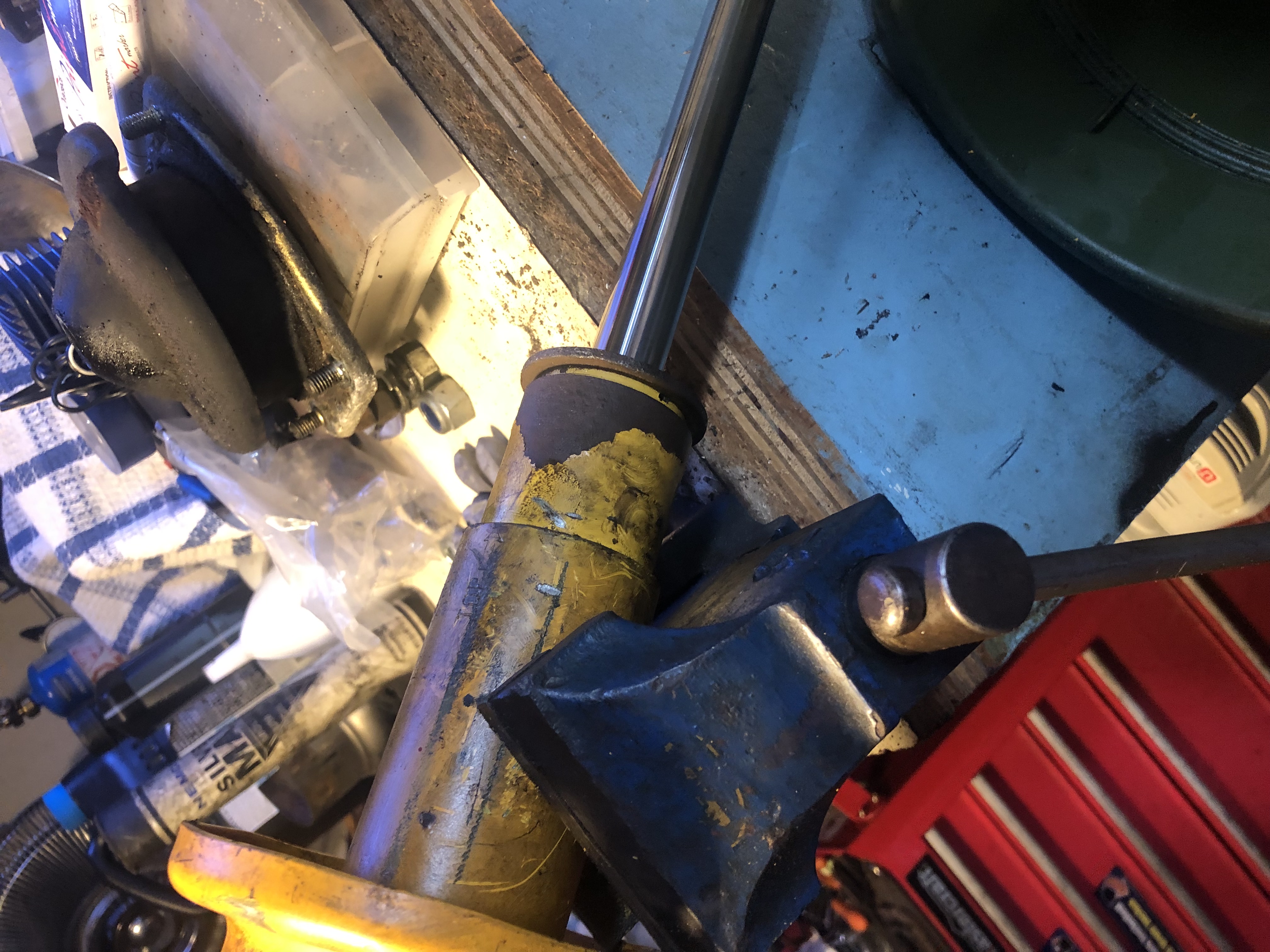

Got it
Torch + Press

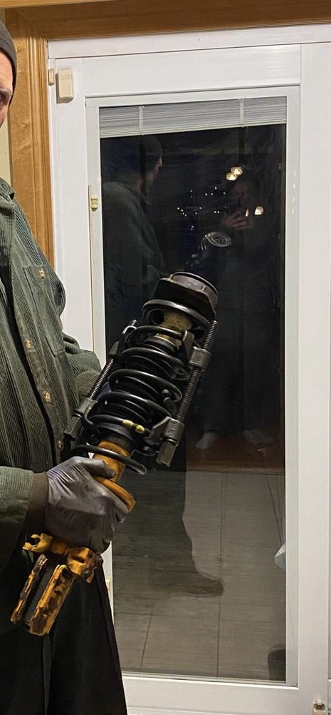

Installed last night with new inserts.. drives like a dream
Going on 18 yrs DD not a concern for them to look new

I really beat on the stuck one without damaging it. Very solid!
