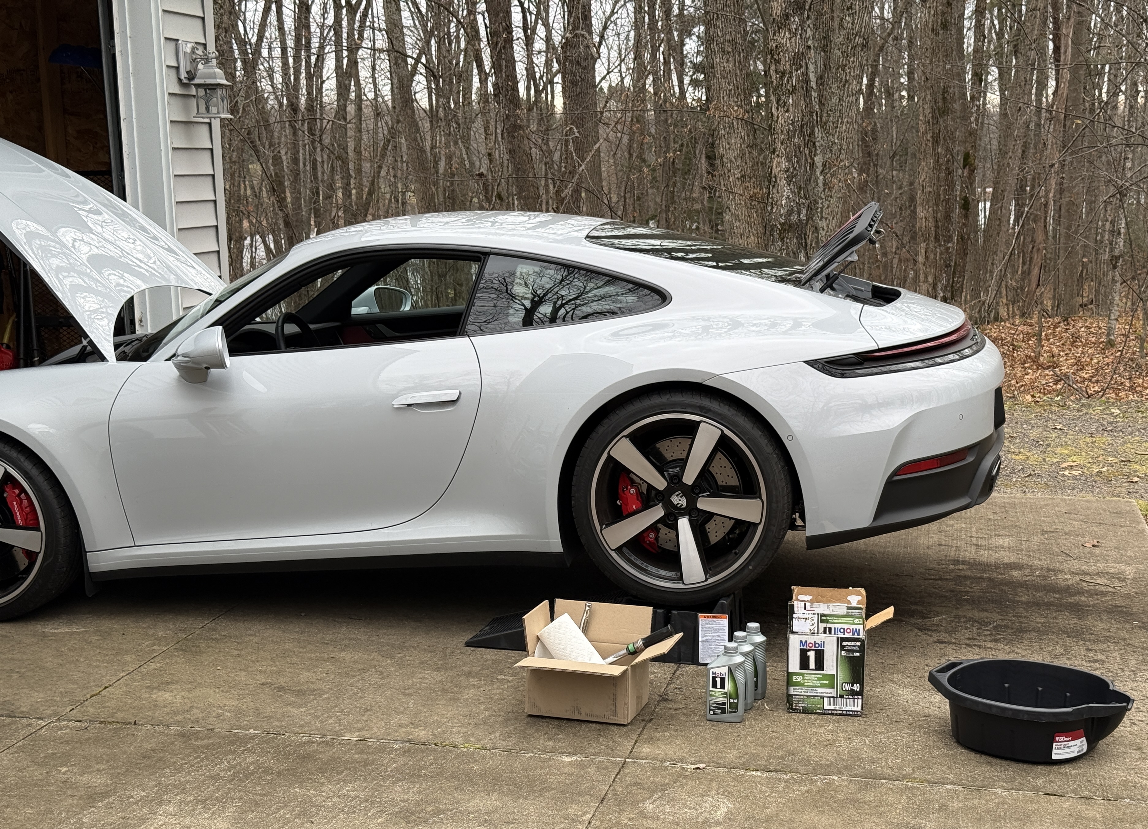

It really is easy. The 1/4 turn plug even keeps the hot oil from running down your arm.
And I really do need to pressure wash that concrete :shock:

Norville wrote: Tue Nov 11, 2025 3:27 pm It really is easy. The 1/4 turn plug even keeps the hot oil from running down your arm.
Nice! Any tips on jacking it up?

He has the rear wheels on Rhino Ramps. (I think that's what you were asking about.)

So on this model the drain plug is at the front of the sump ? I ask because of the angle of the car on ramps .

Tom wrote: Tue Nov 11, 2025 6:37 pm
I used ramps as it’s much easier and quicker than jacking up and using stands as you have to get under a little way.

996C438 wrote: Wed Nov 12, 2025 2:55 am So on this model the drain plug is at the front of the sump ? I ask because of the angle of the car on ramps .
Yes, towards the front. Some say the angle helps the oil drain better. I put the oil cap back on before removing the plug to slow the flow, then removed it to speed up the process.
Another note, on my 992.2 I did not have to remove the coolant cap for the top cover to clear, just the oil cap.
