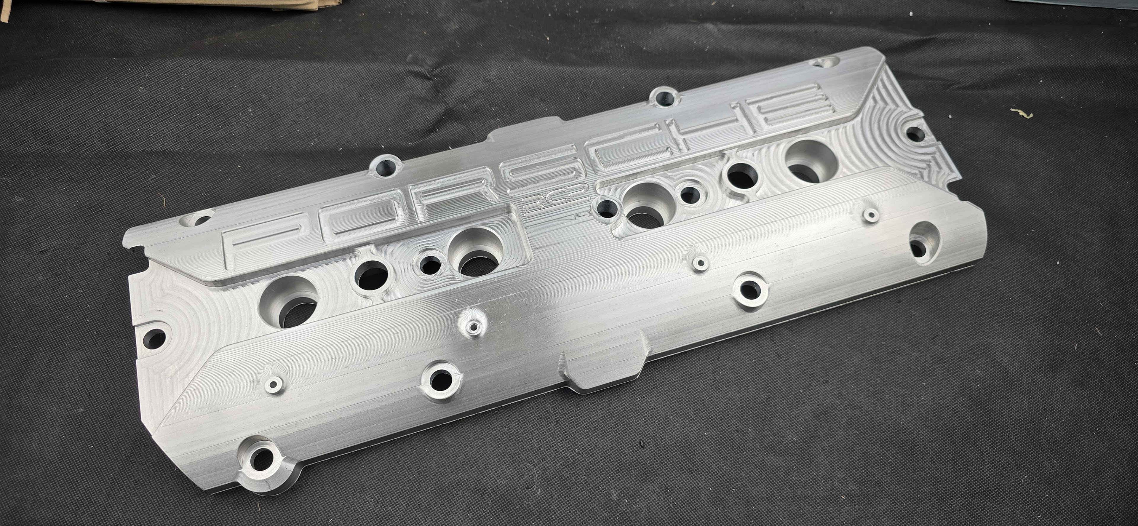

I've been trading some emails with Racing Custom Parts regarding their billet CNC cam cover for the 944 S2. It's a bit expen$ive as you can see in the link. My main reason to consider this item is to avoid having to repaint my original cover, which was powder coated quite a few years ago and has a lot of bubbles and flaws. Getting the new cover in black anodized finish would eliminate any future potential paint flaking.
I think it looks "pretty good" but does look a bit "rough around the edges" so to speak since I assume it's mainly aimed at engines used in racing.
Here are a couple of pictures. Let me know what you think.

For almost $1400, yikes! Id spend that money on a set of cams.
You may want to opt getting your current valve cover sand blasted and re-powdercoated?

Yeah, it's certainly not cheap, especially with the exchange rate, PayPal charges, etc. so, I'm going to pass for now. When I do get around to changing my cam chain next year I'll strip the cover, have it glass bead blasted, and see how it looks. I think respraying with a high heat paint may actually be better than powder coating, which really hasn't held up that well.walfreyydo wrote: Thu Oct 30, 2025 4:56 am For almost $1400, yikes! Id spend that money on a set of cams.
So, what cams would you recommend, CAT? I'm not really looking for any big increase in power as I have other cars that fill that need, so I'll probably just leave it stock. The S2 does have a "chip" I got years ago; I think it's a Weltmeister clone. And the Cargraphic exhaust with 100 cell CAT probably helps too, so maybe I have 215-220 HP?

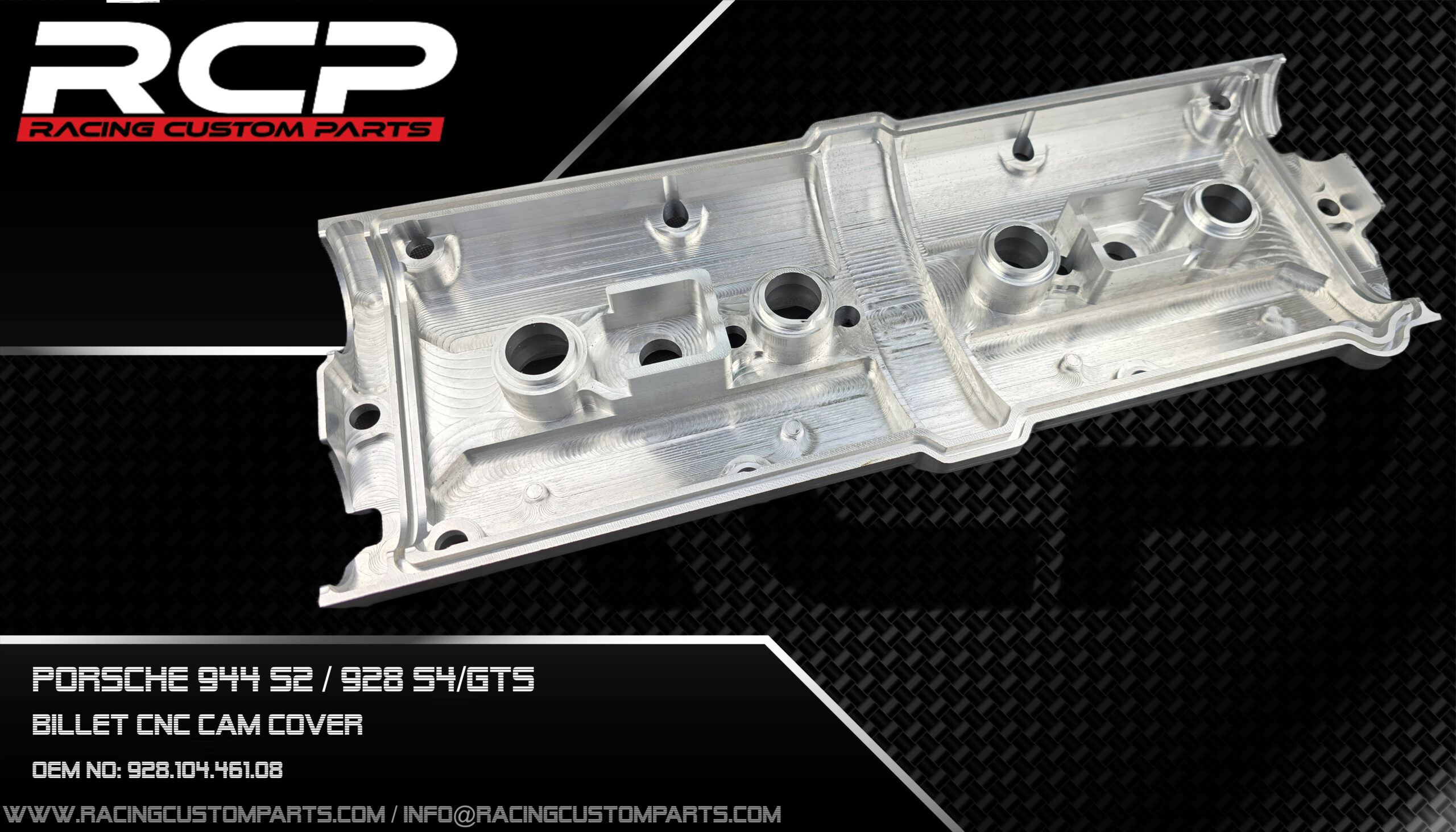

The extra "boxes" around the holes for the breather as used on 32V 928s is quite an interesting feature and probably helps a little against breather hoses filling up with oil as per the old issue of 32V heads filling up with oil under sustained high rpm/high load use.
