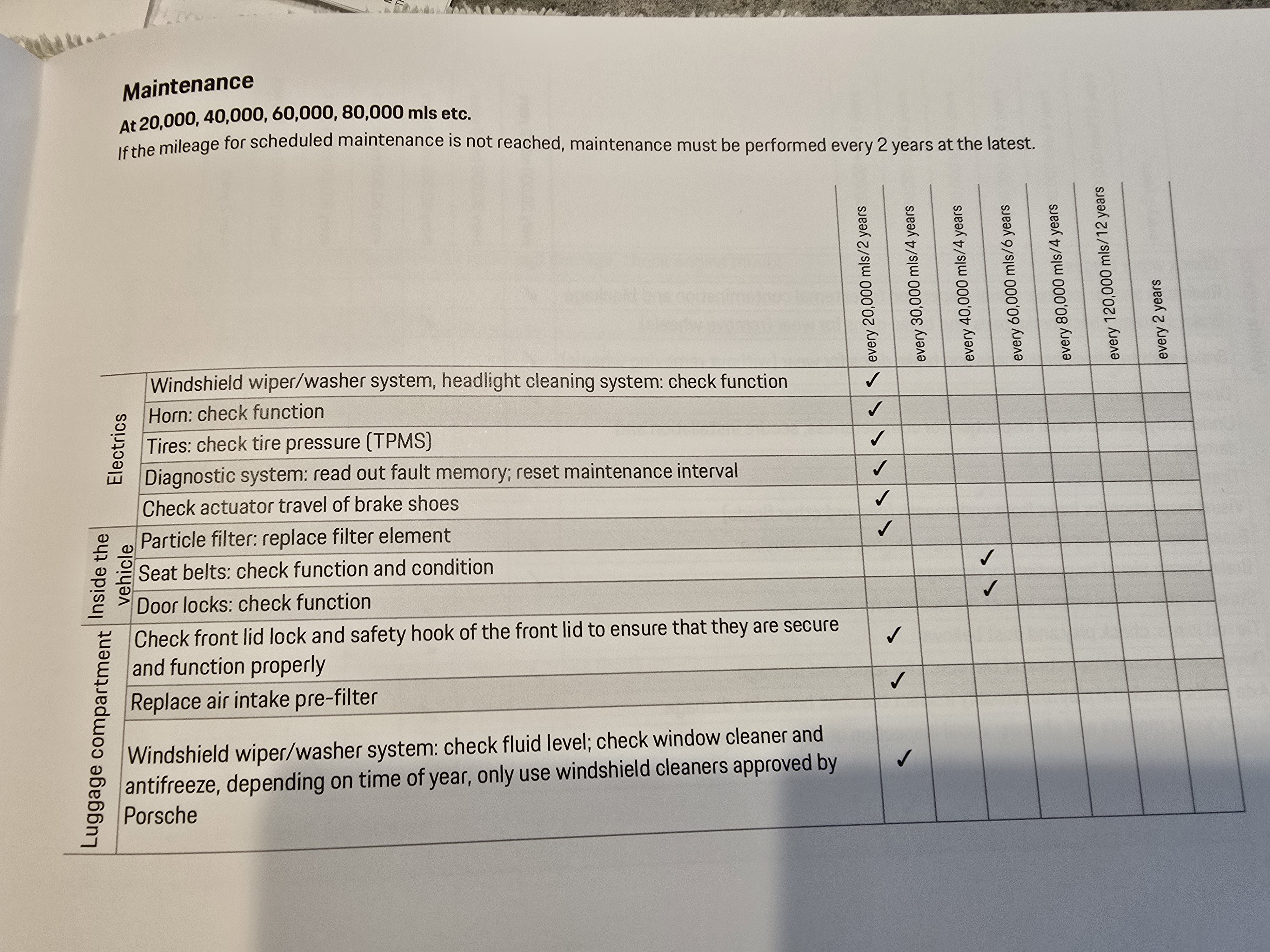

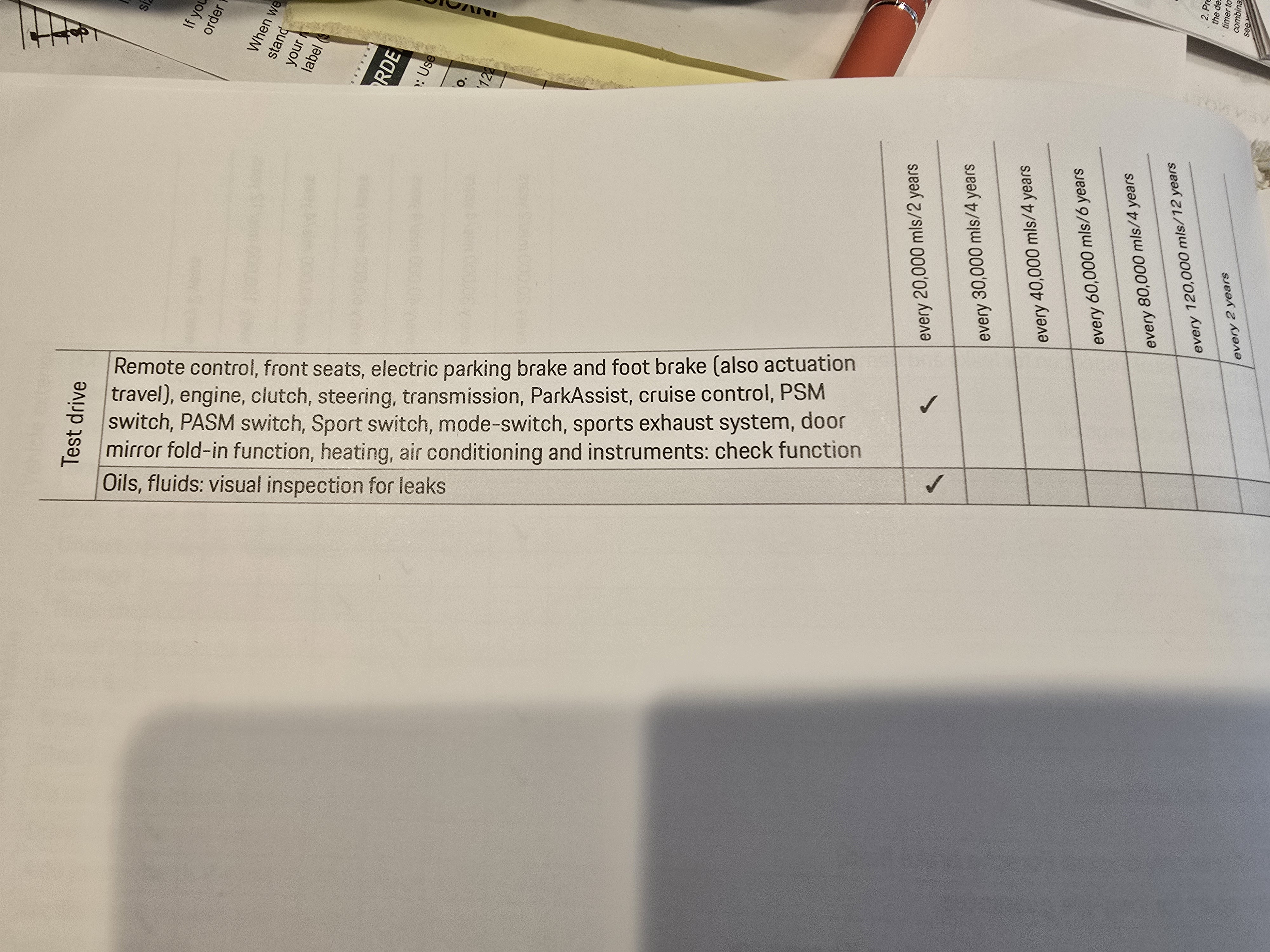

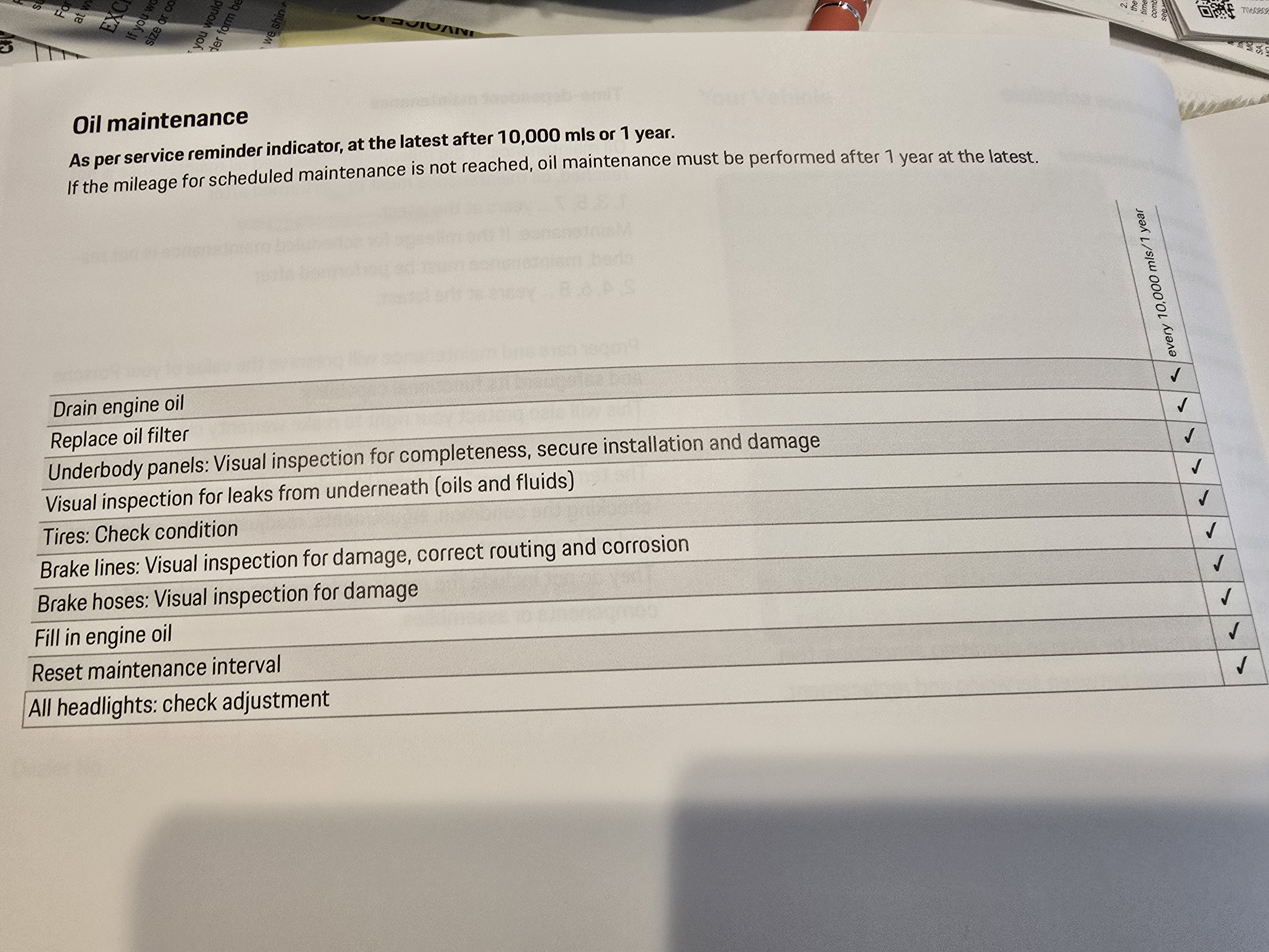

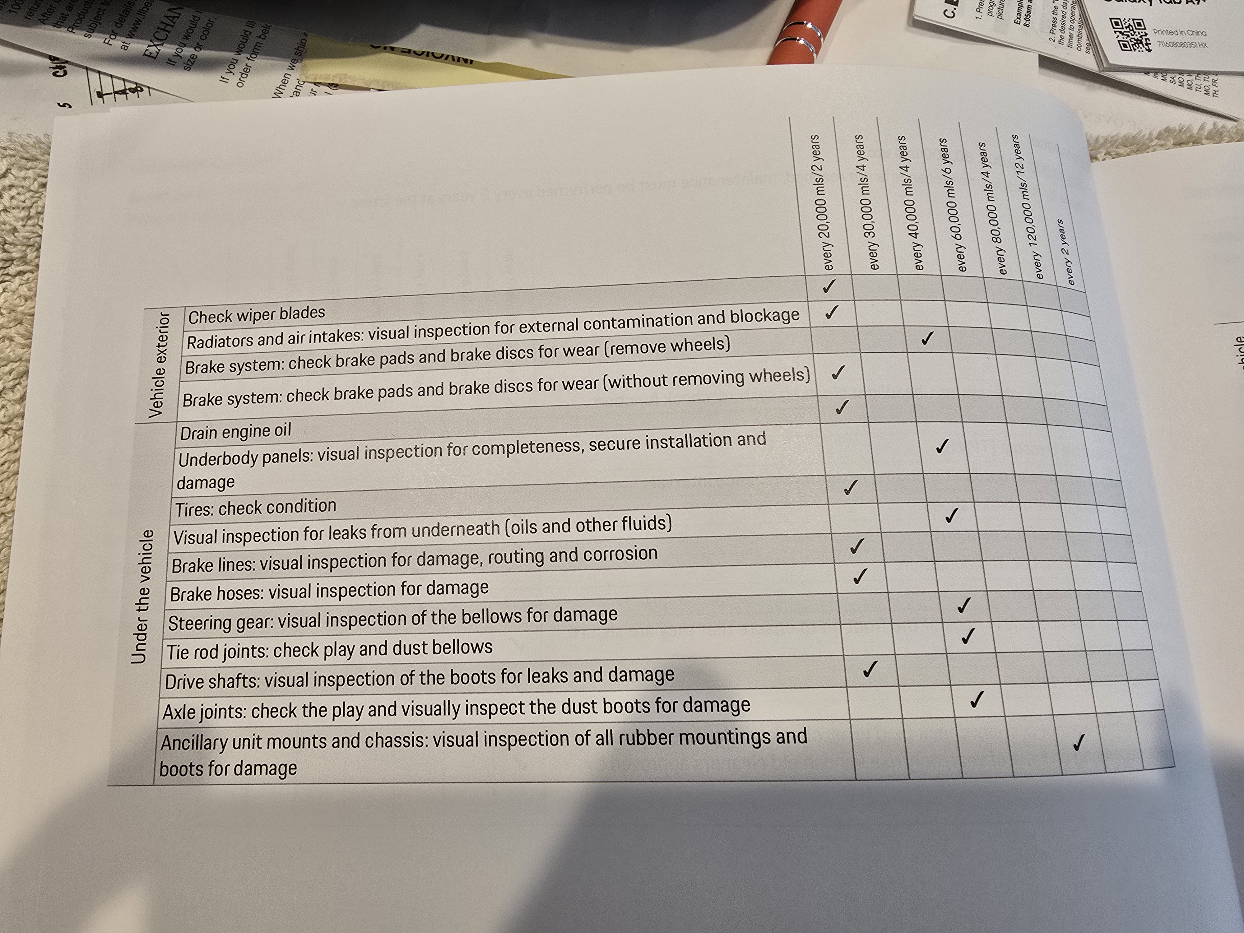

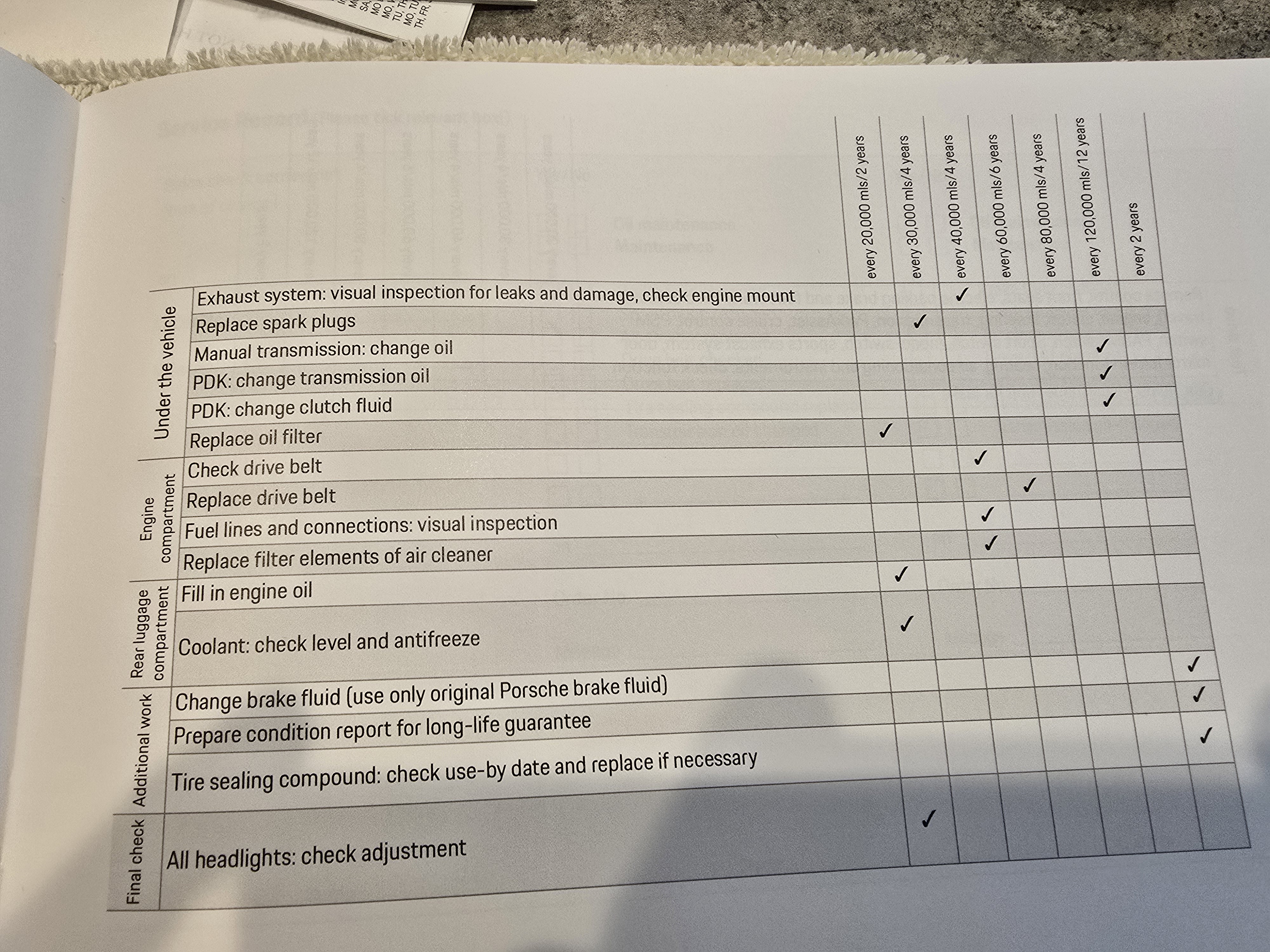

Could you do me a favor and take some photos of the maintenance schedule booklet for your Boxster GTS 4.0 and post here? I'm particularly curious about what they specify for the 4th Year/40k Mile service. But seeing what is required for the earlier ones would also be helpful.Stormy_Monday wrote: Mon Sep 15, 2025 2:46 pm I'm working on the fourth year of owning my Boxster GTS 4.0. I did not opt for the service agreement. And, this car has not had any issues except a couple of sensors go bad during the first year.

Oil MaintenanceRobertsmania wrote: Mon Sep 15, 2025 2:53 pmCould you do me a favor and take some photos of the maintenance schedule booklet for your Boxster GTS 4.0 and post here? I'm particularly curious about what they specify for the 4th Year/40k Mile service. But seeing what is required for the earlier ones would also be helpful.Stormy_Monday wrote: Mon Sep 15, 2025 2:46 pm I'm working on the fourth year of owning my Boxster GTS 4.0. I did not opt for the service agreement. And, this car has not had any issues except a couple of sensors go bad during the first year.

@Stormy_Monday Perfect! Thank you
