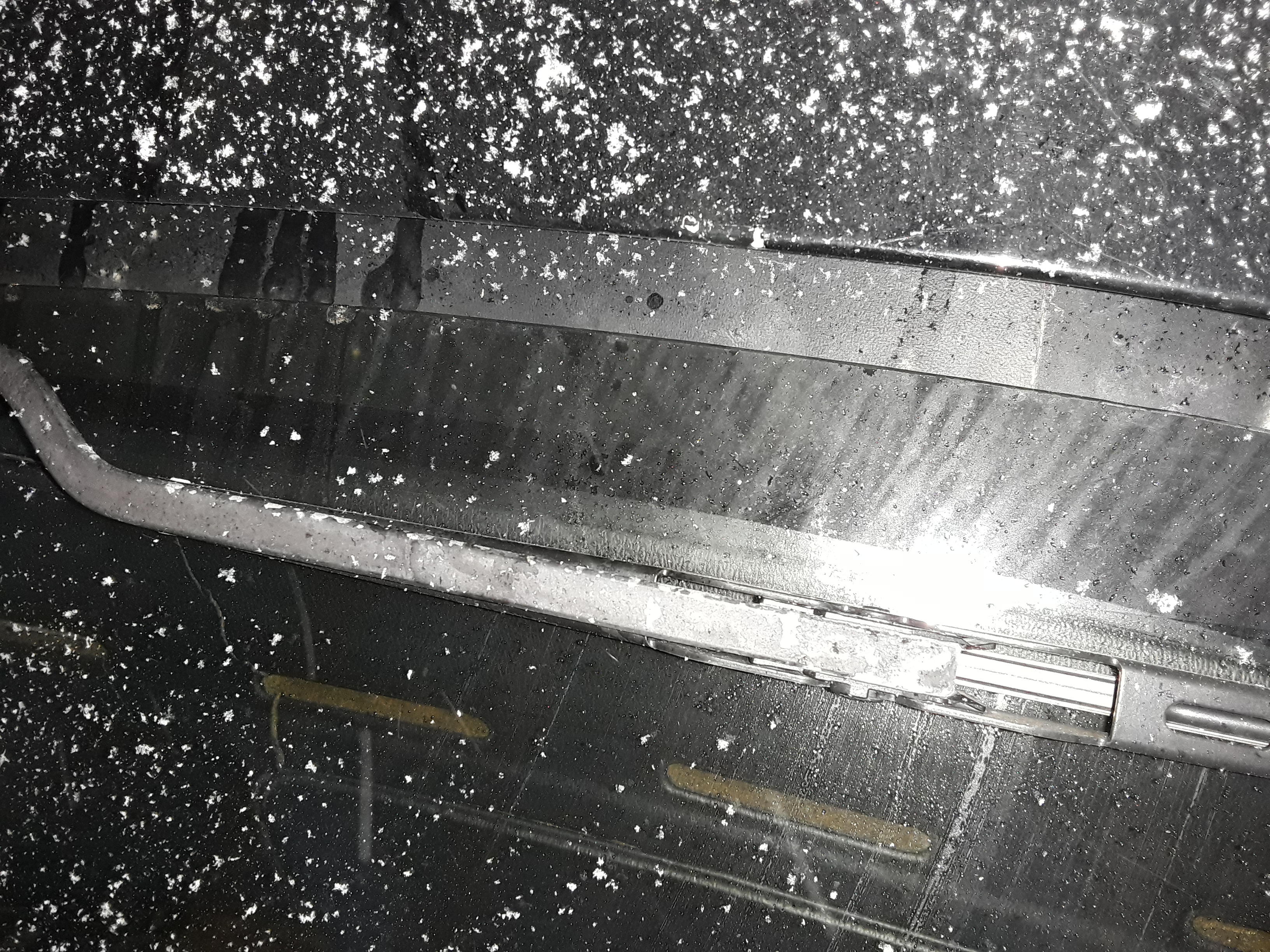

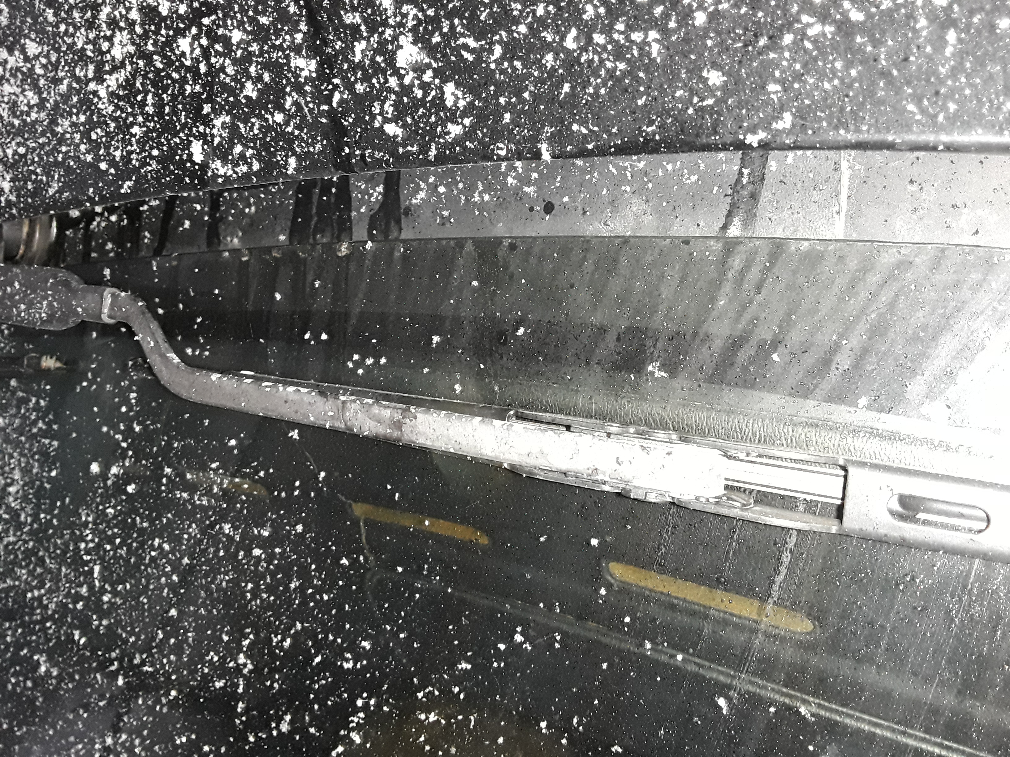

MY88 I have an even line all across... does not look like anything is off. Sorry for poor pics.. it just started snowing!

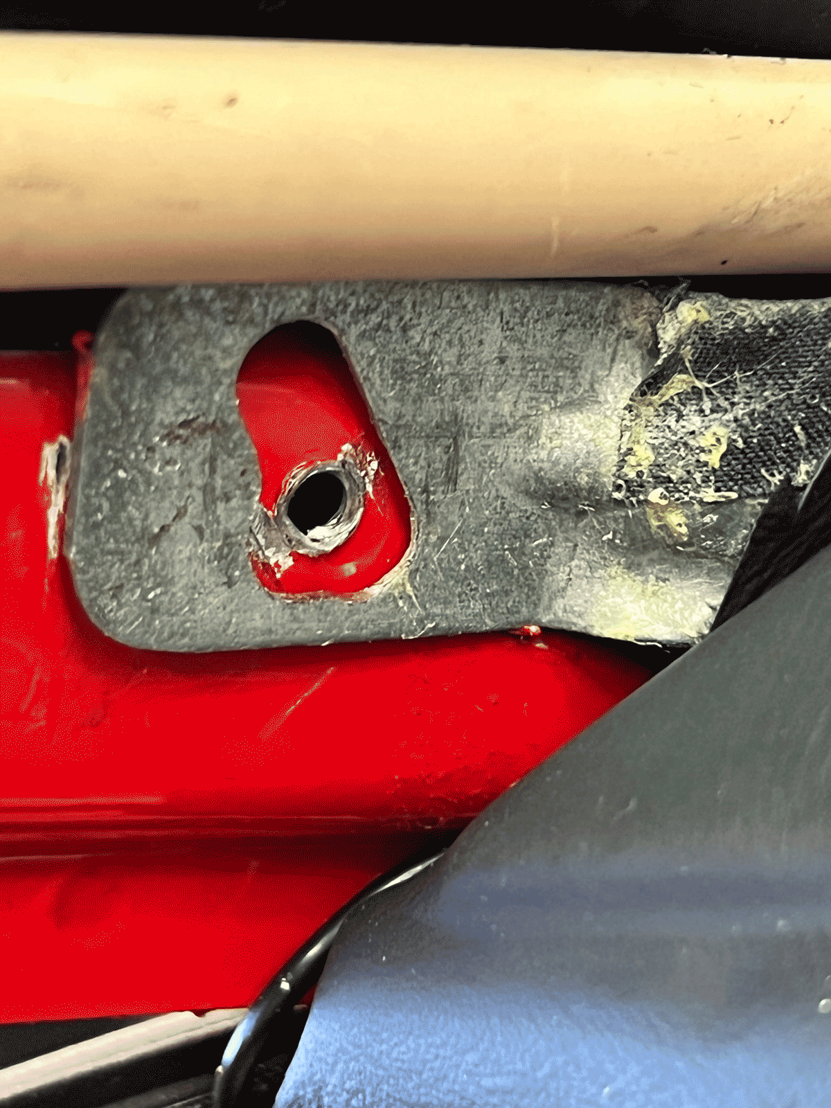

Thanks all, very much appreciate it! I was all ready to convince myself it was normal with the gap, but couldn't sleep that way. Based on mismatched screws, etc., it's pretty clear this dash has been out before and so I think I inherited someone's prior installation issues. Based on the mounting brackets and 'before' pictures, I'm fairly sure it's been this way since I got it. Not sure if those strap brackets got bent or if that's how it came from the factory, but there was no way the dash could slide all the in the way it was. So after mulling lots of overly-ambitious ideas involving the TIG welder, I decided to just hog out the strap bracket enough so the dash could push back all the way. With that, the gap is gone. :)
